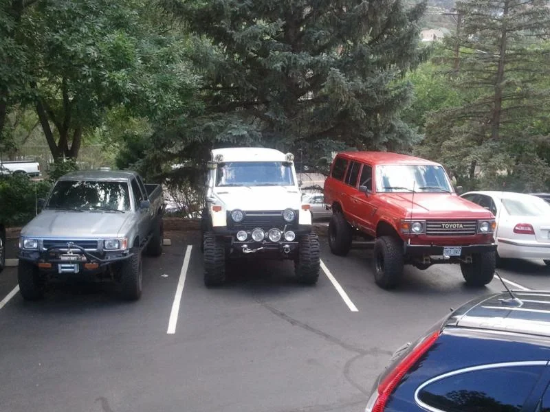

My pig was formally invited to participate in a wedding of a fellow cruiser-head, Ih8mud addict, and good friend. You get a lot of strange looks in this truck, but you really get some looks driving in a tux!

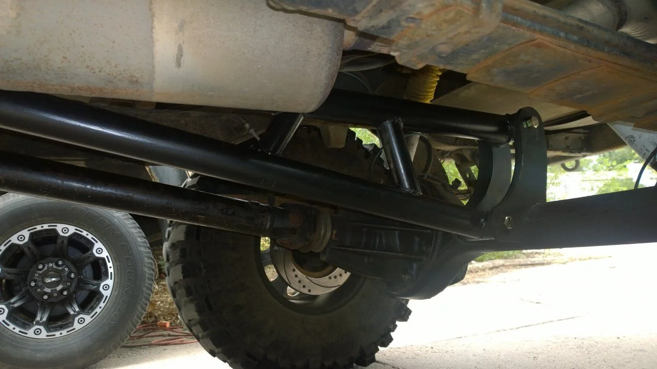

I have made some progress this last weekend. I remade my rear brake line. It was leaking at the "T" junction on the rear axle and I didn't like having hardline all the way to the calipers, so I got some stainless steel braded flex lines just like the ones on the front axle and put them in the rear. Made some brackets and welded them to the u-bolt plates and reflared the lines.
I also discovered the exhaust will have to be modified to clear the new rear axle traction bar, so I redesigned it as well. It will be close, but I do believe it will work. I was hoping to have the new traction bar done before the rally, but I don't think I am going to get it done in time.

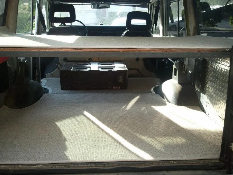

On another note, I got new carpets for the back. One for the back of the rear seat, one for the cargo area, and one for the top of the tonneau cover. I got them bound around the edges. I helps having a rug man for a father-in-law.

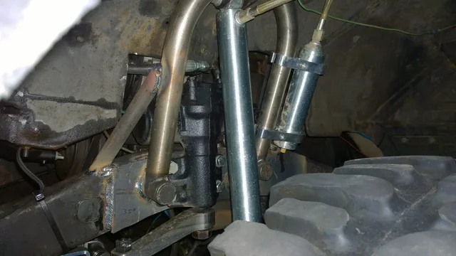

I finally made some progress. I removed the mini-truck power steering set up I was running and installed an FJ60 power steering box I had with a new shock mount. I am currently working on the shock mount for the passenger side also. I still need to paint it up with some POR and go try it all out. So far it is good. I think it turns a bit tighter then the mini-truck and center link would allow, so I am happy.shock mount 1.webp

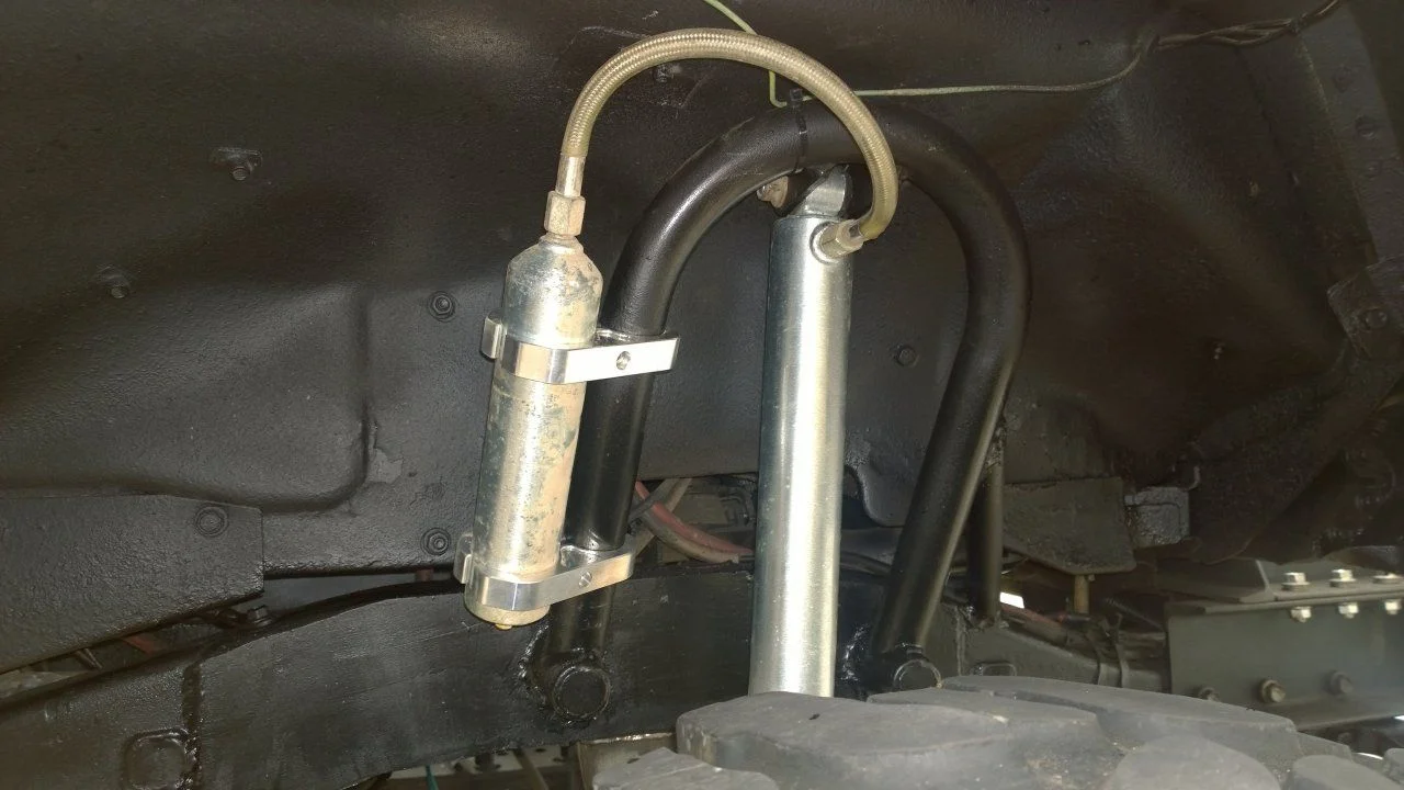

I made some progress. I have installed the right front scab plate and shock hoop and have painted both front shock hoops with POR15. I also had a small leak between the crawler box and the Orion transfer case. So I pulled the transfer case out and installed a new seal. The driveline is once again leak free. I also finished the track bar and painted it finally.
