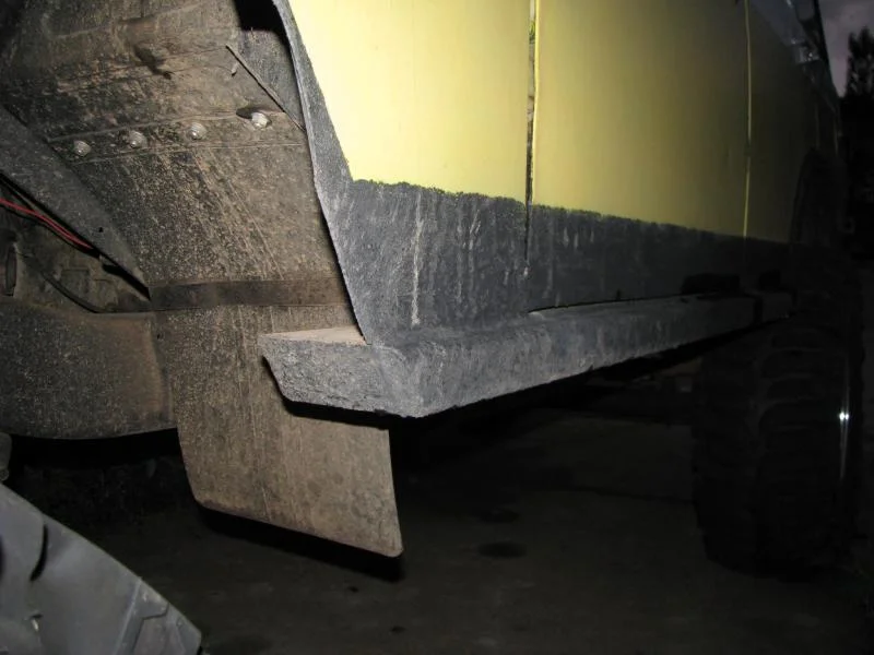

Converted the rust under the doors and tail gate to 5/16 2x6 rock sliders.

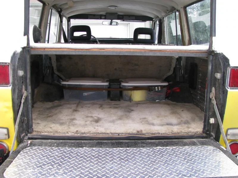

Put a Tonneau cover behind rear seat that secures to the sides in case of roll over. Camping stuff goes there.

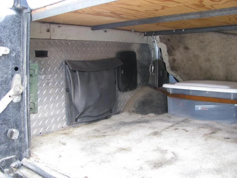

Replaced the cargo side panels and tail gate panel with dimond plate. Built a door in the right cargo panel for storage.

Nice write up and photos. I'm always curious to see interior pics, if you'd care to share some. How many miles on the original engine? How does dad feel about losing it?
Looks great! Can you post up some closer pics of your sliders?? Trying to get some ideas going for what I need to do. Great history to that rig!

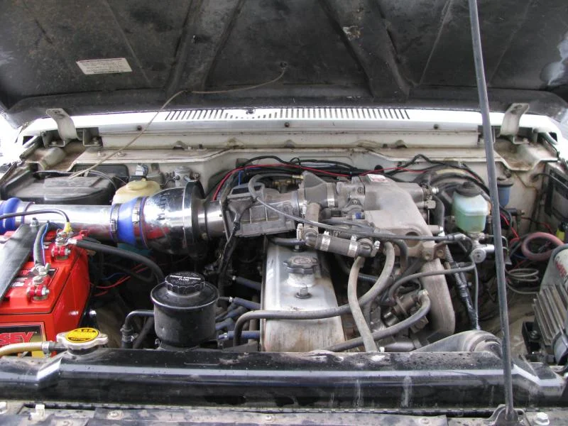

I don't have a thread on the fuel injection but I will run through it. I inherited a 3f with a rod hanging out of the side of the block. It was complete including a wire harness and ecu. I had a non-usa carb and distributor with the electronic ignition but I thought it would be neat if I could put this fuel injection on it because I didn't like the throttle body of aftermarket units and I wanted to stick with Toyota parts. So the first thing I had to do was make an adapter plate for the intake plenum. The carb intake holes are square where as the injected holes have a cut out for the injector to spray down into the head. Using 3/8" aluminium plate and the use of my brother (he is a machinist) we made 3 adapter plates, one for each pair of intake runners. The head side of the adapter plates is the square hole and the intake side is tapered up to the injectors. I figured it would be easier to weld the plates to the intake instead of having another set of gaskets to leak over time, so I tig-ed them together. Machined them down to match the flange of the header and installed it. I didn't need all the vacuum lines and the egr so I blocked all that off. Made it real simple. I had to put the 3f distrubutor in because it has the crank/cam position signal for the ecu. I had to modify the wireharness a little bit and make some of my own. The ecu fits great behind the glove box. Just clears the wipers, but is high and dry. My cruiser, being a '73 had a charge light instead of an amp guage. Since I put the welder and high output alternator in I had to eliminate it anyway, so I turned it into the check engine light. The only other modification was to drill and tap the termostat housing for the temp signal and time switch for the cold start injector. So far it works great and averages 10-14 mpg with no change in idle speed with bumps and off camber trails like before.

Here are some interior pictures as requested. I apologize for the dirty condition of the cruiser. We recently went camping and did some wheeling and I have not cleaned it yet. These are the rear under the tonneau cover. The drivers side has a pocket that I keep the tire pressure guage, air hose/chuck, and other small tools. The first aid kit is mounted behind that (the green box). All the boxes are my recovery equipment, jumper cables, some spare parts, ect. The right side has a door that has more spare parts, oil, coolant, brake fluid, gear oil, rags, and other stuff like that. Mounted under that is the four-way and chocks. There is also one of the fire extinguishers. The tonneau cover is held down by the four corners to eye hooks. In case of a roll over, all the stuff will not enter the passenger compartment. It is nice to put the rear seat down, put all the camping stuff on the top of the tonneau cover, roll out the sleeping bag, and camp. Plenty of room. I have even put the kids up there to sleep. When they were smaller, that is. By the way. You all may notice that I am missing the vent cover on the left side. I have been unable to find another, so if anyone has one that they want to part with, I am interested.

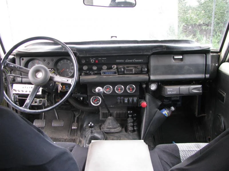

Here is the dash. Complete with the lower dash that houses the guages, fan switches, and arb switches. The cd changer is under the glove box and the welder is under that mounted to the fire wall. The glove box door handle is machined from aluminium because the old one finally broke off. The cb is on the lower left of the steering column. The mag light is mounted beside that. The switches on the right side of the steering column are for the lights on the front bumper, the rear bumper, and the rock lights. The lev-o-guage is between the stock guages on top of the steering column. The over head console I built has three cubbies that are stock Toyota from various models. There are also switches for the lights on the top and both sides. The visors are from a first generation 4runner, although I still don't have a drivers side one yet. I had to use those ones because they mount to a flat surface and the stock ones mount to a sloped surface. The mirror is totally after market - how embarrasing.
The rock sliders are mounted to the body. They are 5/16" 2x6 steel box. The is 3/16" 10" x 10" angle welded behind it and tied into the floor. I had to rebuild the front body mounts and repair the floors. There is also a 2 1/2 gallon air tank on each side that I will one day make skid plates for, but the slider offer quite a bit of protection for them as is. Sorry about the quality of the pictures, it was dark. And raining.

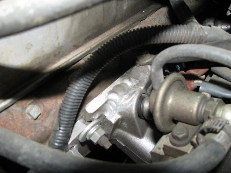

Do you have pictures of your adapter plate for the intake?

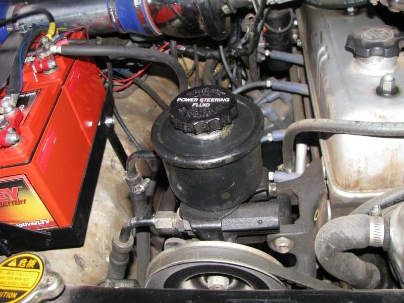

What PS pump are you running? Bracket?

I took a picture of the adapter plate close up. Its hard to see since its actually installed, but here it is. The power steering pump, lines, and bracket are all from an FJ62. Simple and bolt on. Since I went with four wheel disk, I installed an FZJ80 brake master cylinder. Years ago my brake booster rusted out and I happened to have the big booster from a 1976. The two work well together but I did have to space the master cylinder out almost 3/8". There just was not that much adjustment on the booster shaft. I naturally run the rear brakes through a adjustable proportioning valve although the rear calipers being almost as large as front makes the proportioning valve adjusted all the way out or close. But it stops. Really well.
