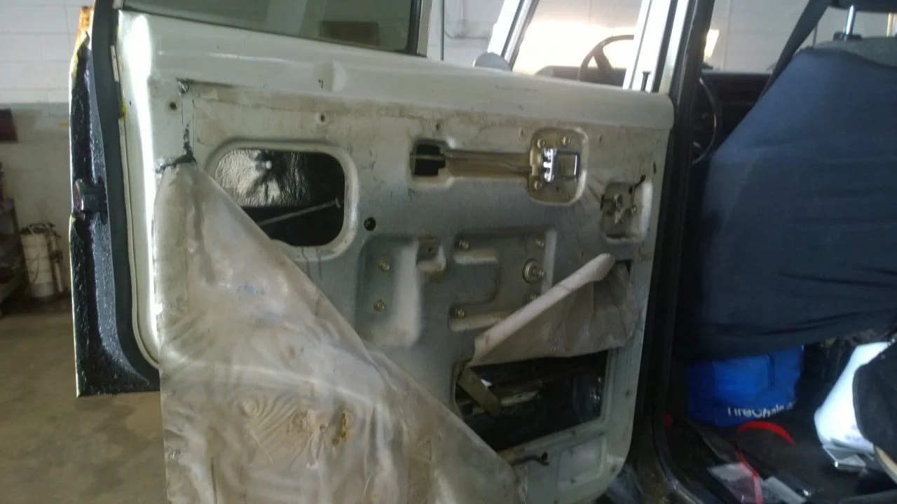

I started to refurbish my doors. I did the tailgate a while back. Cleaned it out inside, painted the inside with POR15 and put the Cruiser Crap sound deadening stuff on. I like it a lot. Before the tailgate made a "clang" when I shut it. Now it makes a "thud". Now I have disassembled the left rear door. Took the window regulator and latch out. Cleaned 40+ years of muck off of them, lubed them up and they work great. I have ordered the window run rubber and the door rubber from Slocruiser. In the meantime I will be cleaning up the inside of the door and painting it before applying the sound deadening.

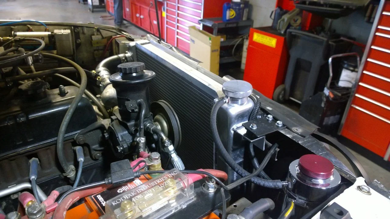

Getting ready to put in the high performance 2f when it gets back from the machine shop. I put in a different radiator to hopefully help keep it cooler than the fjz80 radiator I was using. I am still waiting on the electric fan I ordered to show up however. I cut out the corners of the radiator support and welded 1 inch angle iron in place to move the radiator forward about an inch. I don't know about you guys, but I sure don't have much room between the radiator and the water pump pulley. This gives me just over 3 inches for an electric fan and shroud. If it does not fit then I guess I will have to go back to a belt driven fan and shroud. Here is the pictures.

Getting ready to put in the high performance 2f when it gets back from the machine shop. I put in a different radiator to hopefully help keep it cooler than the fjz80 radiator I was using. I am still waiting on the electric fan I ordered to show up however. I cut out the corners of the radiator support and welded 1 inch angle iron in place to move the radiator forward about an inch. I don't know about you guys, but I sure don't have much room between the radiator and the water pump pulley. This gives me just over 3 inches for an electric fan and shroud. If it does not fit then I guess I will have to go back to a belt driven fan and shroud. Here is the pictures.View attachment 945617 View attachment 945618

I run my '74 FJ55 radiator in front of the 3FE fan w/ no heat probs, but I am not pushing big rubber like you are. I can't remember if you are running AC in yours?

The radiator that I was running was from a 1996 fzj80. I liked it but it was very close to the water pump pulley. I could only run one puller fan and one pusher fan. No shroud. It was fine until I would use compound low for an extended time in hot weather. I am hoping this new set up will be adequate or I may end up returning to a belt driven fan. We will see. Also no a/c at this time. Maybe in the future.

Since I am still waiting on the engine to show up, I got the rebuild on the left rear door done. All new rubber except for the fixed window, rebuilt and relubed the latch mechanism and window regulator, por 15'ed the inside of the door and added sound deadening material. The door works amazingly well now. Like a new car. Really. when you open and close any other door, it has the typical Land Cruiser Ka-thud with the resonating metal clanking. That door closes with a muffled thud and latched very gently. I know that it has never been apart before and now is good as new. The door panel is also looking pretty good for a 41 year old utilitarian vehicle. I look forward to repeating the process on the remaining doors.

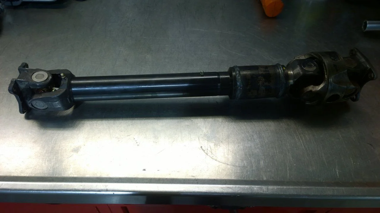

Still no engine delivered yet. I noticed the other day that my front drive shaft's lower u-joint had a bit of play in it. Not real good since I only have just a few years and not that many wheeling trips on it. It is a "creeper joint" from Trail Gear. Suppose to be this fantastic heavy duty thing that will last forever. Guess I was wrong or maybe I just got a bum one. Either way, the new one is in and we will try it again.
