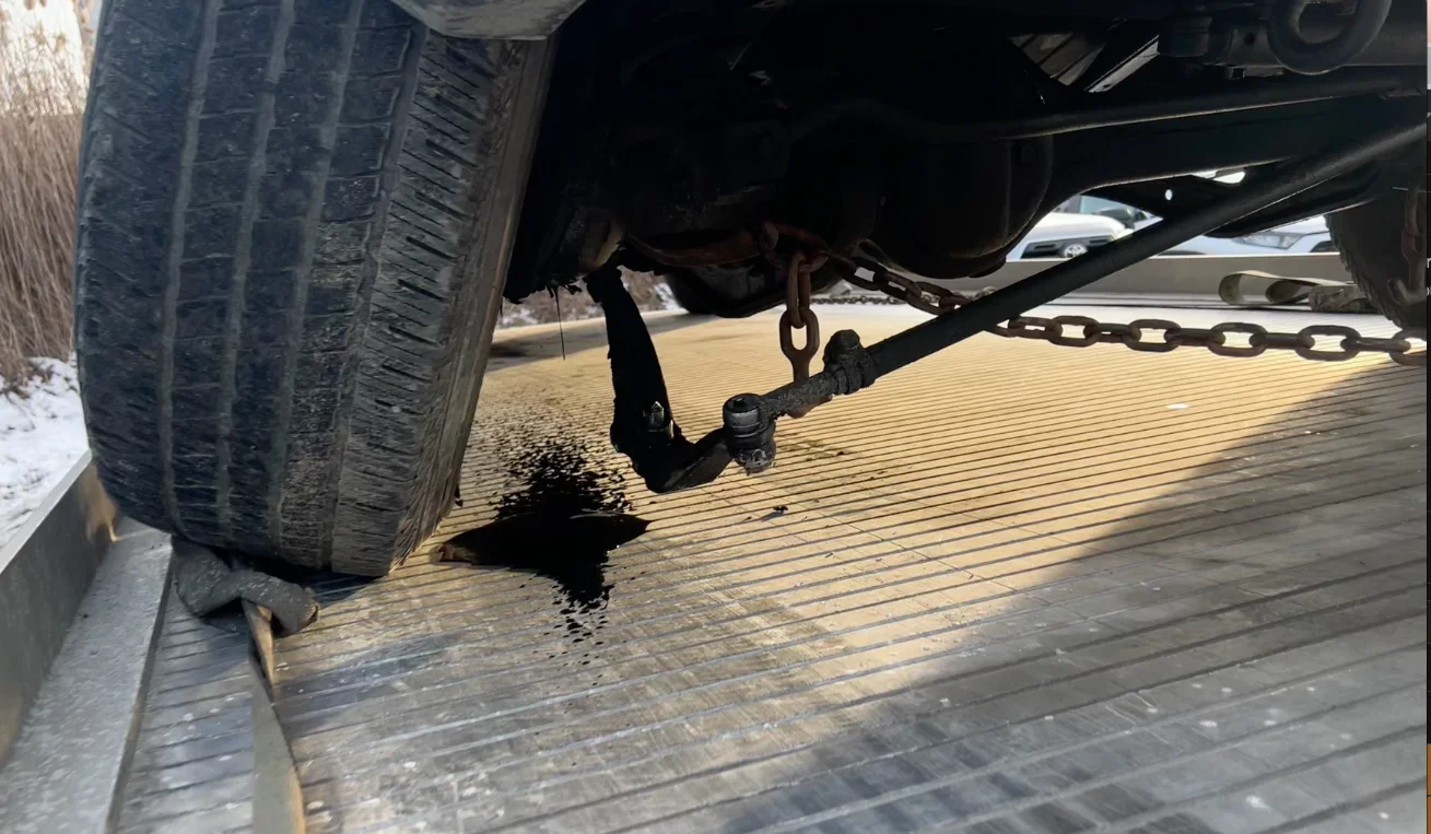

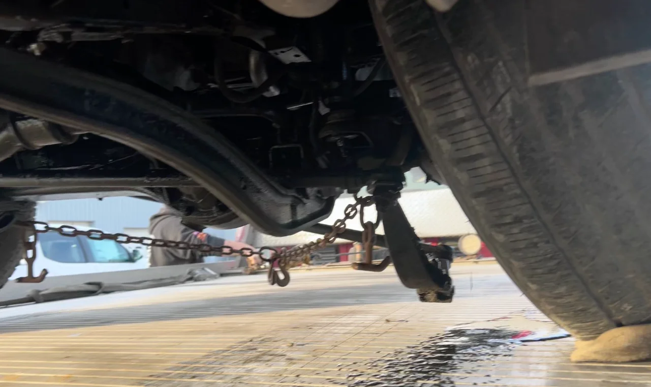

I noticed the Landcruiser was a little wandery when I drove it this morning. When I got in it after work, and took a turn out of a parking lot, I heard a big snap. And then couldn't steer. I had it towed to a Toyota dealer in rural VT. Looking to see if all the experts on here had any initial prognosis for what I should expect for a repair. To me, it looks like a tie rod or ball joint busted and everything came apart, wheel laying diagonally.

The individual repair is what it is, but this is the time to do the full knuckle job if it's been a while. You kinda have to get in there regardless. New studs for those lower arms, and the full bearing/seal kit w/ grease service.
Without seeing further detail in person, you could probably replace the hardware that holds the arm on and reinstall it to get back on the road, but I wouldn't let it slide like that.
Whether there was a recent knuckle service (doesn't look like it) and those nuts/studs weren't torqued properly and/or checked after xxx miles, or it had just been a long time and they eventually came loose, looks to me like that's what happened. Things get loose, and then shear under steering load.

Edit: Based on this, and your tires, there is probably a fair amount of other maintenance needing to be done…
That's pretty concerning. Catastrophic component failure such as that is in my opinion overall a red flag that many mechanical components on the vehicle may be unsafe for use, especially on public roads. For repair of the front end with replacement axles your probably looking at 3500 in repairs to get the front axle going. Front axle shafts/birfields which will also need replaced for this job are expensive from Toyota but high quality.

IT could be the studs fell out if they were loose and had not been tighten in awhile. Looks like you will be servicing the right side , Hopefully the studs fell out and did not shear you might be buying the knuckle instead of servicing it.

Well, good news is, everything is fixable. Bad news is, how deep are your pockets?? Good thing that it happened where it did..... There is an almost endless source of info/tutorials on here and thru simple google searches that will tell and show you all you need to be able to fix it all yourself. Like someone else also mentioned, looking at the tire wear you have a lot more going on that has been blatantly ignored for too long. Probably a good idea to have the drivers side pulled apart and figure out whats junk in there too. Im gonna have a set of knuckles, steering arms, trunnion bearings/races, etc for sale next week. Switching over to Hellfires, so if you need anything, PM me. I just did a full knuckle rebuild kit on it in like March I think, including the studs. I have MAYBE 500 road miles and (5) trail rides on everything.

In reality, most people don't do a front axle service as part of regular maintenance. It seems like about every 15 to 20 years is when the axle seals start to give out and start to visibly weep oil at the knuckle studs (when gear oil and knuckle grease start to mix due to failing axle seal). At this point, it is time to replace those seals and inspect (or replace) bearings. Most cars don't last 20+ years, so it's just one of those things that we see on long-lasting vehicles.
As others have said, it is a great idea to check torque on those knuckle studs from time to time. Lots of horror stories like this.

Typically, steering knuckles never have to be replaced. However in your case where the studs have failed due to lack of maintenance, the threads in the knuckle might have been damaged along with the steering arm that was fastened to the bottom of the knuckle housing. You're not going to know until you take a close look.
