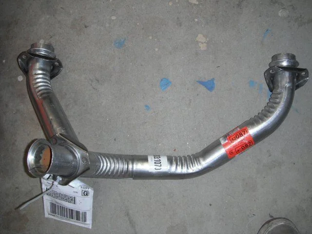

Cliff, just to make sure you have the ram horns with the center dump which dump straight down. Also it's hard to tell from the pics, but does the exhaust drop below the frame or is it at least level with it? Did you have to modify the y pipe 42087?
miller, saw you posted on pbgbottle's other thread, not by my truck right now, but I'm fairly certain the dump for the ram horns are not below the frame. But the Y-pipe most surely is because of the bends in the pipe to clear the oil pan. Also ,I'm not an expert, nor do I claim to be a mechanic, but shouldn't both exhaust manifolds dump the same(front ,middle, rear)? Might make it easier to find your y-pipe.
Center straight dump both sides. About level or above the frame. I haven't finished the rest after the y-pipe yet.

Hey Cdan what was your Dorman part number?? the same as the walker part # or different?? I am in the market for the one with the least amount of work involved....
Secondly I just did a search on rockauto for a 1960 C10 pickup with a 5.7L and it suggests the Walker 42087 pipe, so I am guessing its the same, I wonder why he had oil filter clearance issues??? I am going to see who can get it here the fastest and place an order today!!! :bang::clap::doh:
From Dorman to my door from rockauto. Applitcation was late 60s chevy truck. No oil filter issues.
