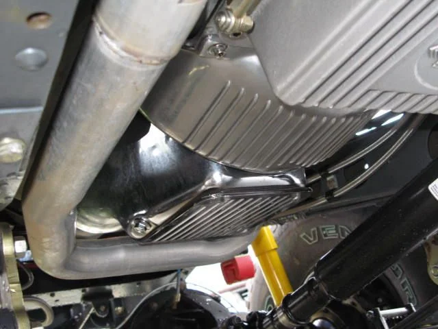

I was in GO-MODE over the weekend and made my entire exhaust in just under 3 hours. I went to put my front drive shaft in today and whaddayaknow, I have a new bumpstop
Took some measurements and there is about 1 1/8 inch before the DS smacks my crossover pipe. While I was at it I remembered the thread about the harmonic balancer taking a hit so I measured that as well and there is about 2 1/2 inches of leeway.
I measured my shocks and there is also only about 2 inches before they bottom out.
What is the best route to take here?
I know I have to modify my stock bump stops so they actually serve a purpose but do I sacrifice travel (not like I have much left) and make it so there is only 1 inch of space?
I was planning to just re route the cross pipe forward (front of car) in the little pocket area that would buy me another inch or so totaling 2 inches of clearance. Kind of a PITA to undo everything and have to grind down and repaint but is this the best route?
What do you think? Re route the exhaust + lengthen the stock bump stops and leave about 2 inches of play since thats what my shocks will allow anyway?
