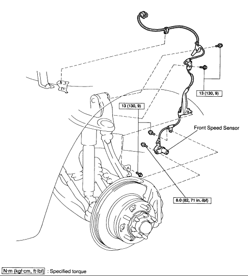

Yup. Everything else aside, the big questions seem to be what axle, housing, diff, what link set up, how do make ABS keep working, and how to keep 5 lug hubs.
There are lots of other issues to address, but those are the three that seem to have everyone at a stand still.
ABS sensors can be adapted and ditch the 5 lug wheels for 8 lug units. Ditch the rear for a 14 bolt with coil buckets and mounts welded on, shorten the rear shaft etc.

The sensor is the easy part, the reluctor ring would be a bit more challenging. Does anybody know if it has the same pulse as the 80 system?

or could a reluctor ring relocater kit be used if modified to work on another axle?

That's interesting, it would seem that the 80 system can provide the correct input since they both use the same kit.
I am assuming that most of the tundra SAS's, as well as Tacoma SAS's, etc eliminate the ABS system as part of the swap.
