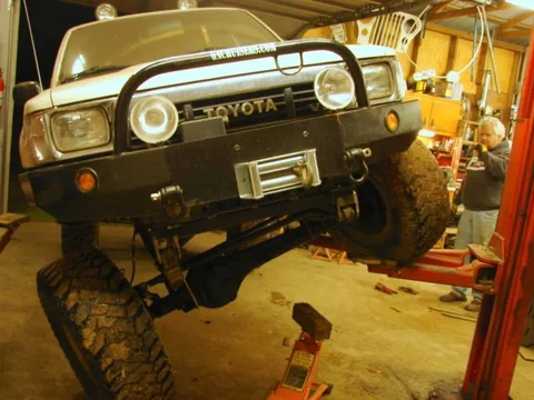

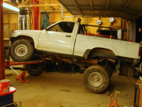

Here's a few more poser/flex shots. I have to say the 33's now look a little goofy on there but I'll fix that problem soon enough.
It measures 4 ft from floor to back of the front wheel well at full flex.
Nearly 6 ft from the floor to hood near the doors at full flex
And plenty of droop in the rear springs. :clap:
