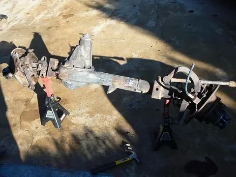

Got started on it on Friday in my driveway. I "tried" to drain the sludge that was in the axle but the crap just did not want to come out on it's own. It was kind of windy on Friday and a lot of this black crud ended up on the driveway instead of in the pan so I ended up having to break out the pressure washer for the spillage. Downhill Dave later dubbed it Groil which is a combo of way too much grease and way too little diff oil. Obviously the seals are shot and need to be replaced (Any suggestions on where to find?)

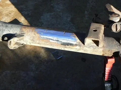

I cut off the anti-wrap hanger and the sway bar tabs as "un-needed" distractions. I cleaned these up and got it all nice and smooth.

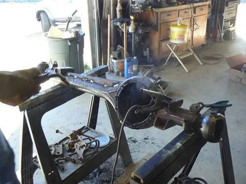

Got the axle disassembled and cleaned up. I added the gusset to the long side as found on the 84-85 axles trying to be careful not to warp the axle housing with too much heat. My booger welds really need some work
