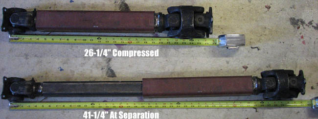

Going the Square route (:hillbilly:) for the extended slip joint and cost effectiveness. Parts needed are +/-30" of 2" x 1/4" wall square tubing which we have already and +/-36" of 2.5" x 1/4" wall square tubing which I found at Metal Supermarkets in Norcross, cost $29. I'm buying a little extra just in case.
The object is to use the joints from my old drive shaft which is now far too short and weld them to the square tubing. The trick is getting these mounted as "square" as possible to eliminate the vibes if 4WD is ever used on the highway. I don't think there's any such thing as balancing a square drive shaft but if you read in the instruction below the guy actually adds sand to the inner shaft to help out. :meh::meh: Don' think I'll do that but thought it worth mentioning.
Throw in a couple of Zerk fittings for lubrication and call it a day.
This is the goal:
Instruction on how to do this can be found here:
http://www.rocketcityrockcrawlers.com/memberstuff/al/85 Toyota 4Runner Square Driveshaft Project.pdf

Looking at your driveshafts, dunno if you know this or not, but you can take the stock drive shaft and get the flanges milled down to except a standard size tubing. Thats what I did with mine. Cost about a hundred bucks per drive shaft but still cheaper then ordering from some where, and you'll like the results better then the square tubing. Just my thoughts on it.
That's kind of what the plan is, remove the old joints and clean them up as much as possible, then mount/weld those to the square tubes. The problem I have is not the tube but the amount of slip in the factory DS, it's only about 2". TG sells a 10" long spline shaft but it's nearly $200 and even their website says it can't be balanced. That said, you probably know something I don't though so please spoon feed me.:idea:
With the square shaft I can increase the slip to roughly 12-14" of which is plenty. I have to admit, I'm not the biggest fan of the square but given the slip and the cost it's very attractive at this time. I think I'll have about $40 in the drive shaft when done, oh, plus lunch and :beer:
