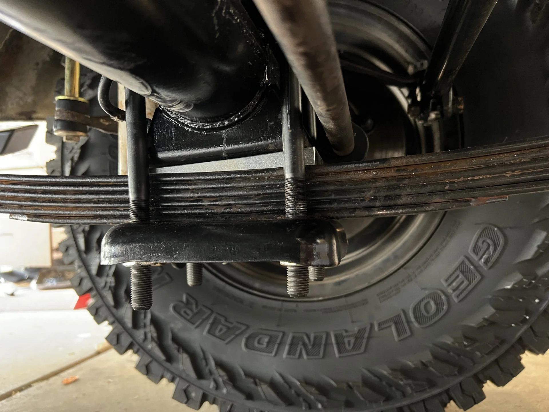

After my lift on Falcor I put in 4 degree shims and it made a world of difference. No more random wandering on slightly tracked freeway sections, return to center felt better and virtually zero bump steer. I really like the ones that Valley Hybrids offers, they're super high quality.
Go straight for 4*.

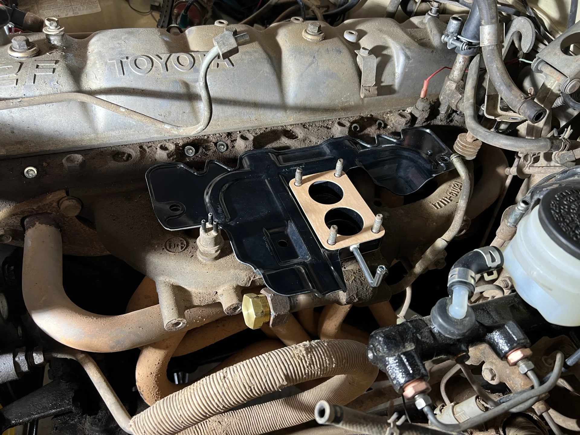

New carb insulator:

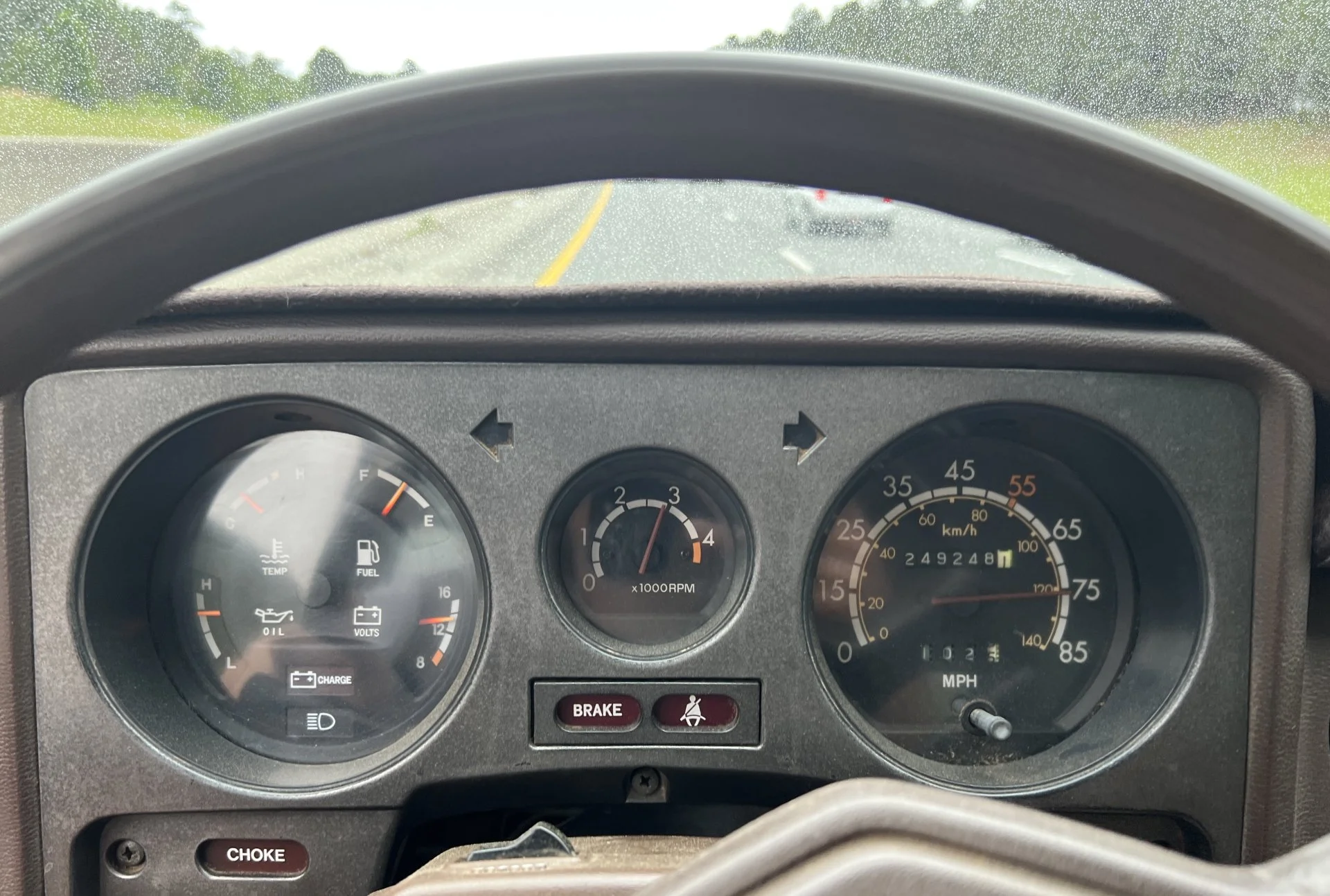

Seems to run alright. Going to get a vacuum gauge to dial in the tune as much as possible. It's amazing how much better the driving experience is with the H55. So much better on the highway and around town. GPS was 85mph here and it was cruising happily with more in her.

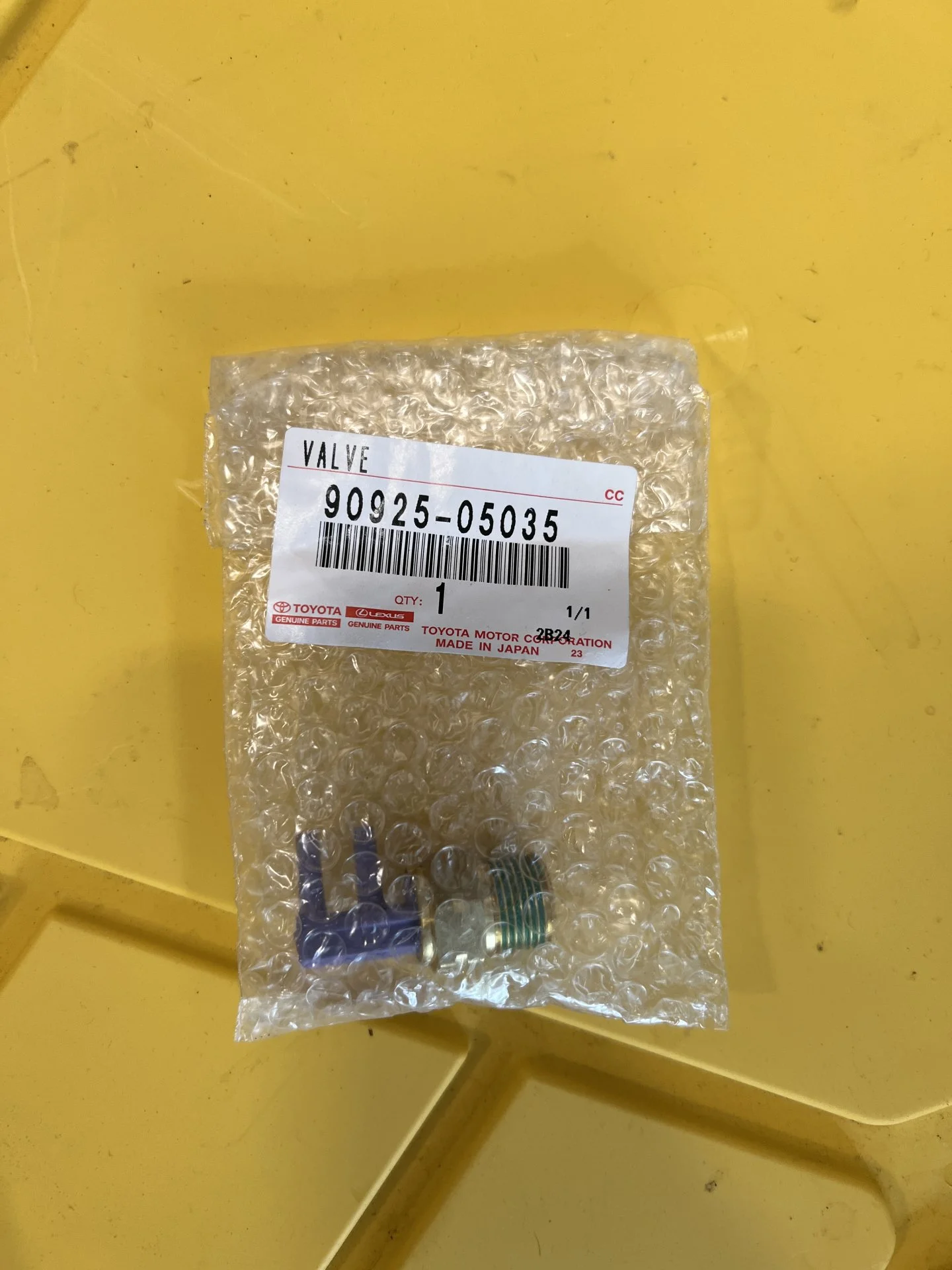

Completed my desmog with a new BVSV(1) valve from Toyota and plumbed it in. I also replaced the carb secondary diaphragm after talking with @mattressking and it's a good thing I did. My old one was very hard and didn't move too well. When I had it apart originally, I figured that's how they were since the carb was "recently rebuilt" but again, it wasn't really rebuilt, or it was poorly rebuilt. @mattressking also was talking to me about the mechanical opening spec for the secondary and I adjusted mine there also. Mine only opened 1mm mechanically and so I adjusted it to 2mm. I haven't driven the truck yet but between that and the diaphragm change, the truck should drive a lot better!

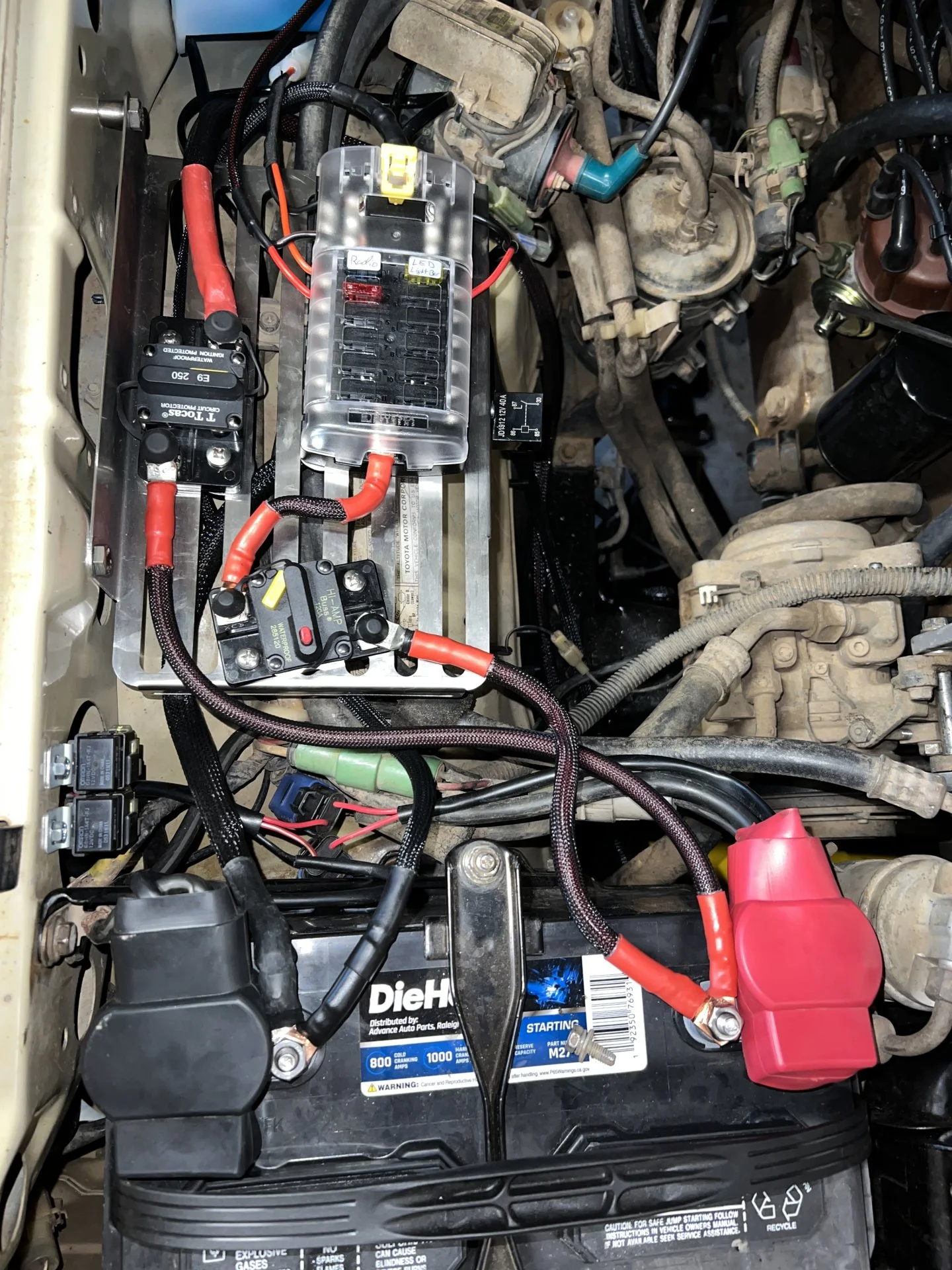

Then worked on finally wiring in my fuse block and other items. I have a M8000 winch and couldn't find a good amperage rating online so I wired it to through a 250A breaker. If it keeps tripping, I'll change it for a higher rated piece.
I used the @CruiserTrash bracket which is a great piece!

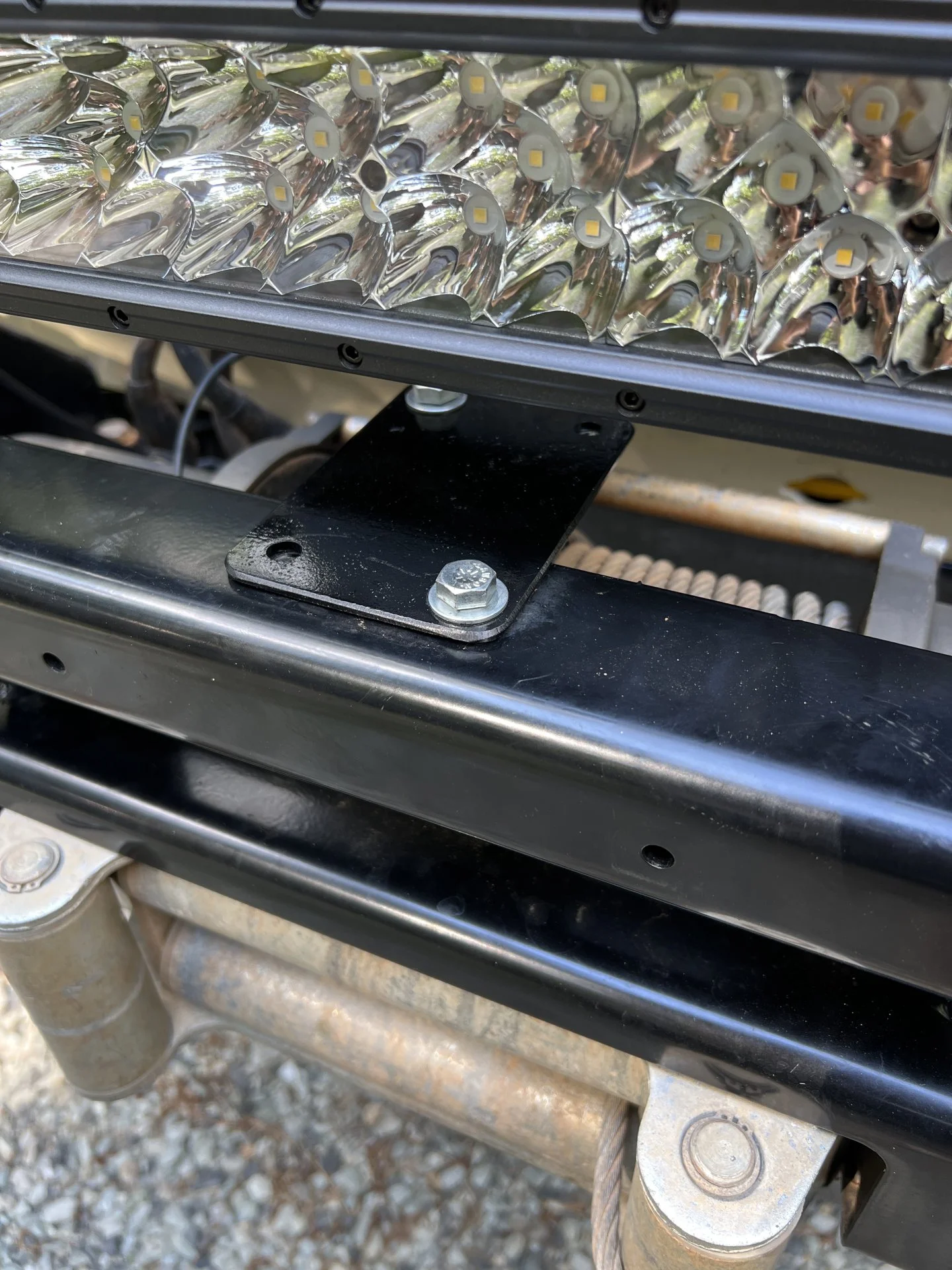

Then I added a *gasp* light bar
The light bar took the place of where the winch controller was mounted so @GLTHFJ60 was kind enough to cut me a relocation bracket on his plasma cutter. (Just test fitting here, yes there will be 4 bolts)

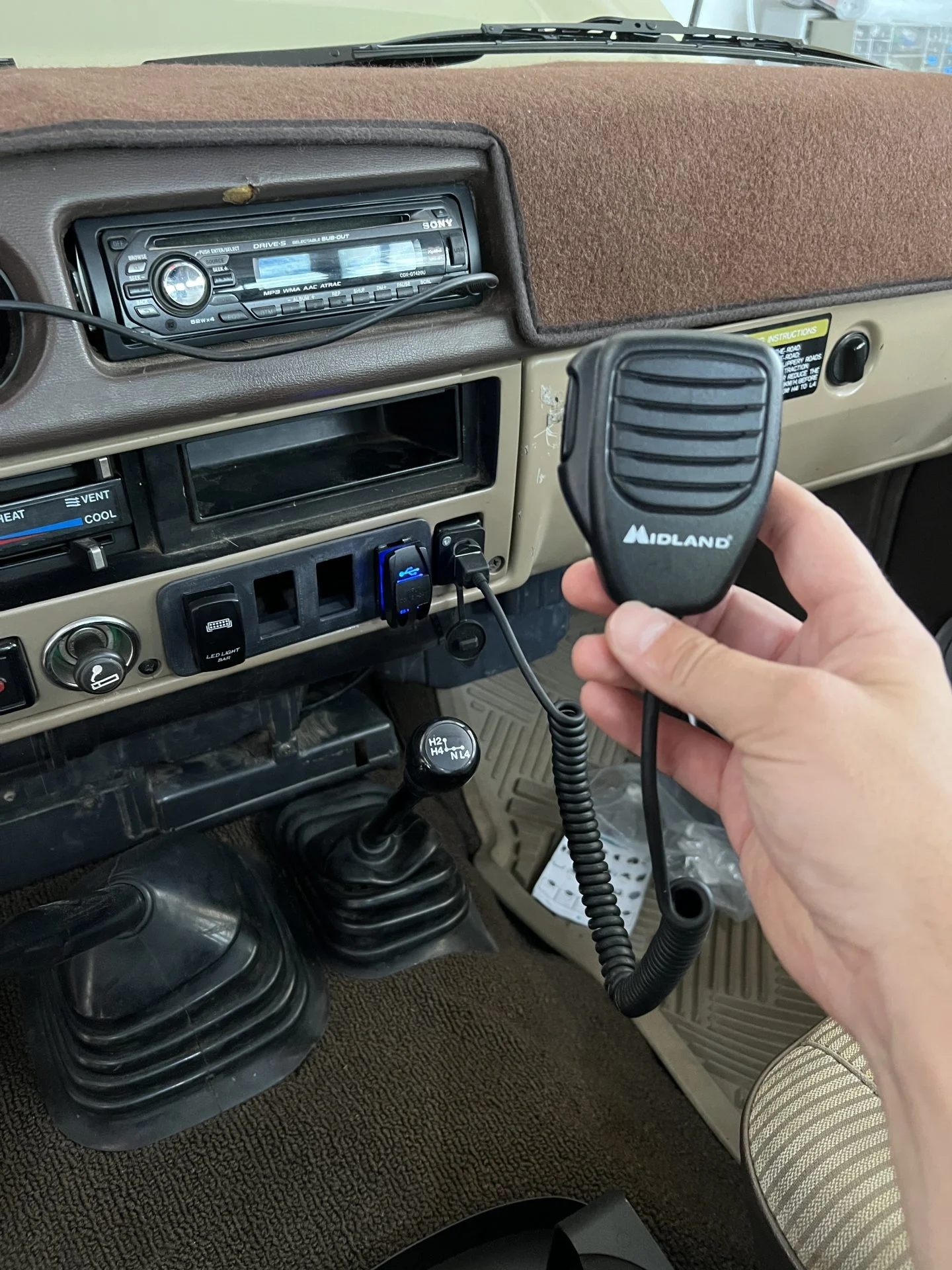

I then wired in my 40W Midland radio. I ran a RJ45 extension cable up to the dash so the handheld can be mounted easily on the dash and unplugged when not being used to clean up the interior a bit.
I still need to clean up and tuck the wiring for some items but it's all in now!

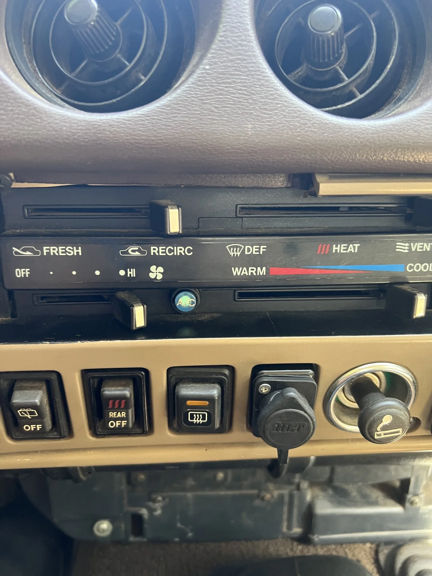

We have AC!
Got the truck converted from R12 to R134A with new o-rings and a fresh charge. Prior to doing this, I verified the compressor engaged, idle up worked, and the light on the dash worked. However, I don't think there was enough pressure in the system to activate. After the charge and conversion, it works great!

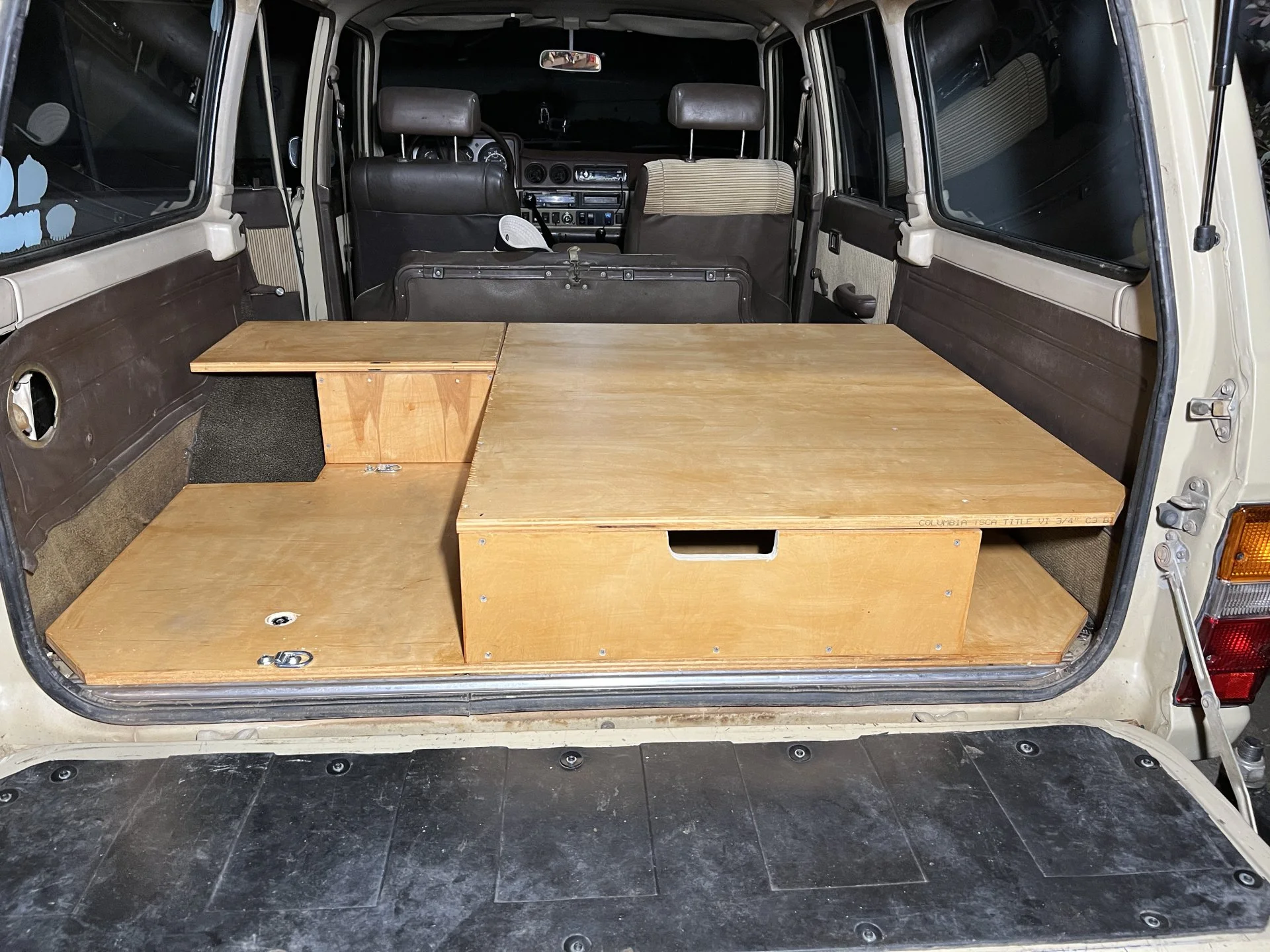

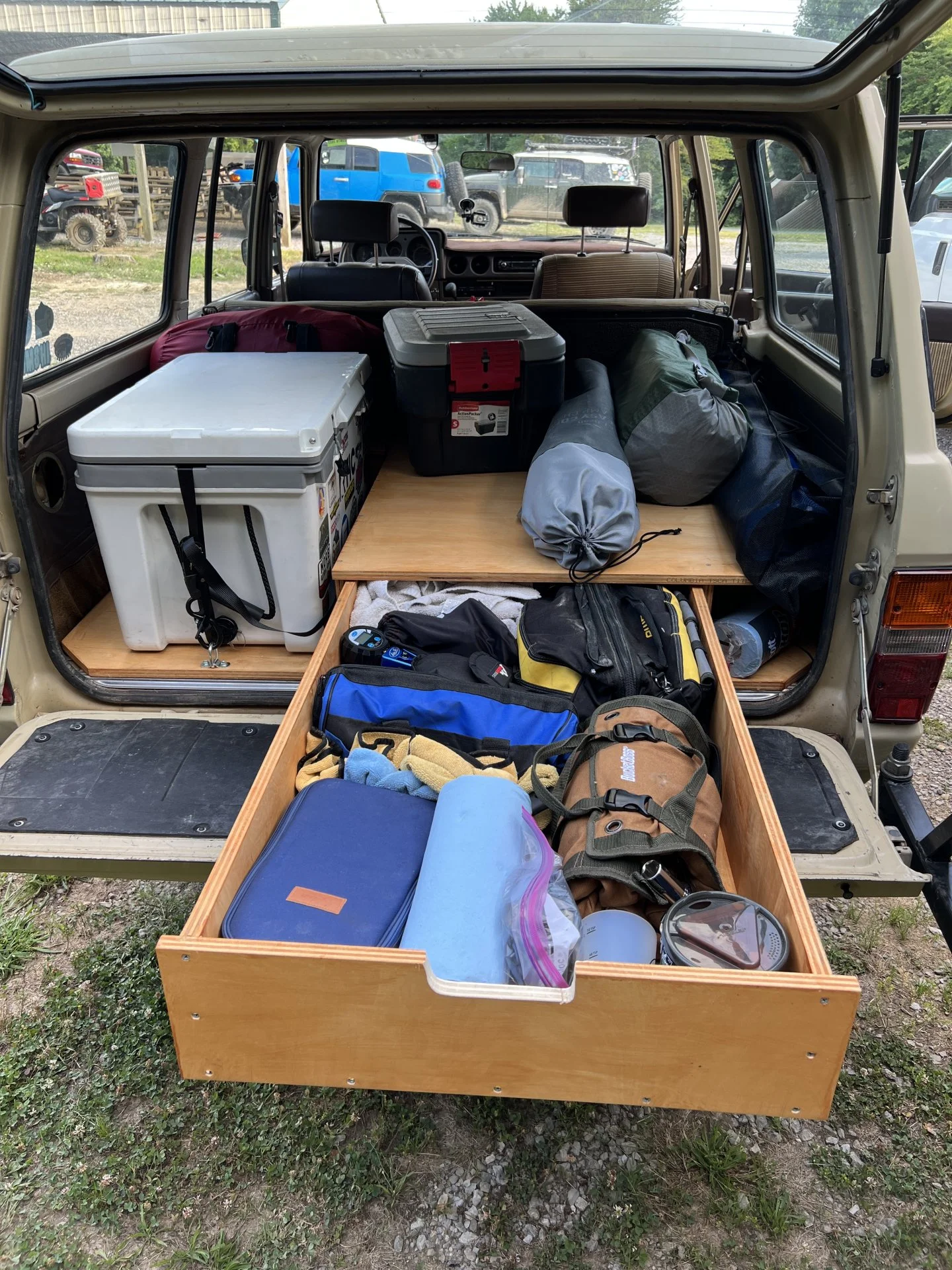

Also built a rear platform/drawer setup for the trip. One big drawer and dedicated cooler/fridge spot. The board behind the cooler is another compartment as well. Gave it a coat of stain and called it a day. Still need to find a way to do an extended platform to sleep on but that’s a project for when I get back.

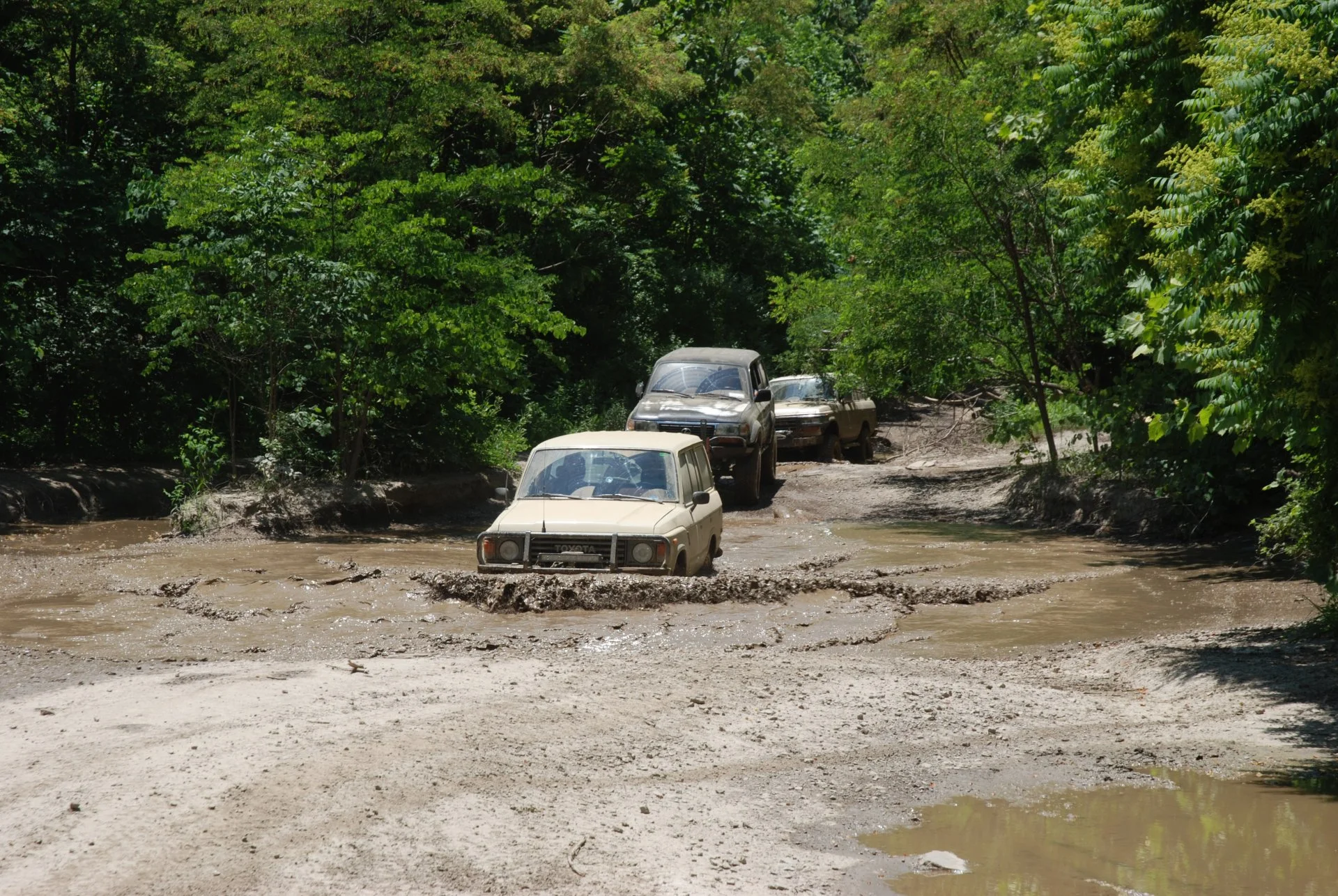

GSMTR was a huge success and a ton of fun. The truck drove over 800 miles at 70mph+ on the highway and did days of trail riding with no issues. I'm really happy with how the truck has come along and how it performed. Was a lot of fun to get the truck on the trail and break in the sliders.
I also got to meet some folks that I'd talked to here on mud and on instagram which was cool. Definitely looking forward to next year's event!
Also didn't hurt that I won a Rigid light bar at the raffle!
Some pics:
Sandy hanging out with Camo and Moonshine at camp.
