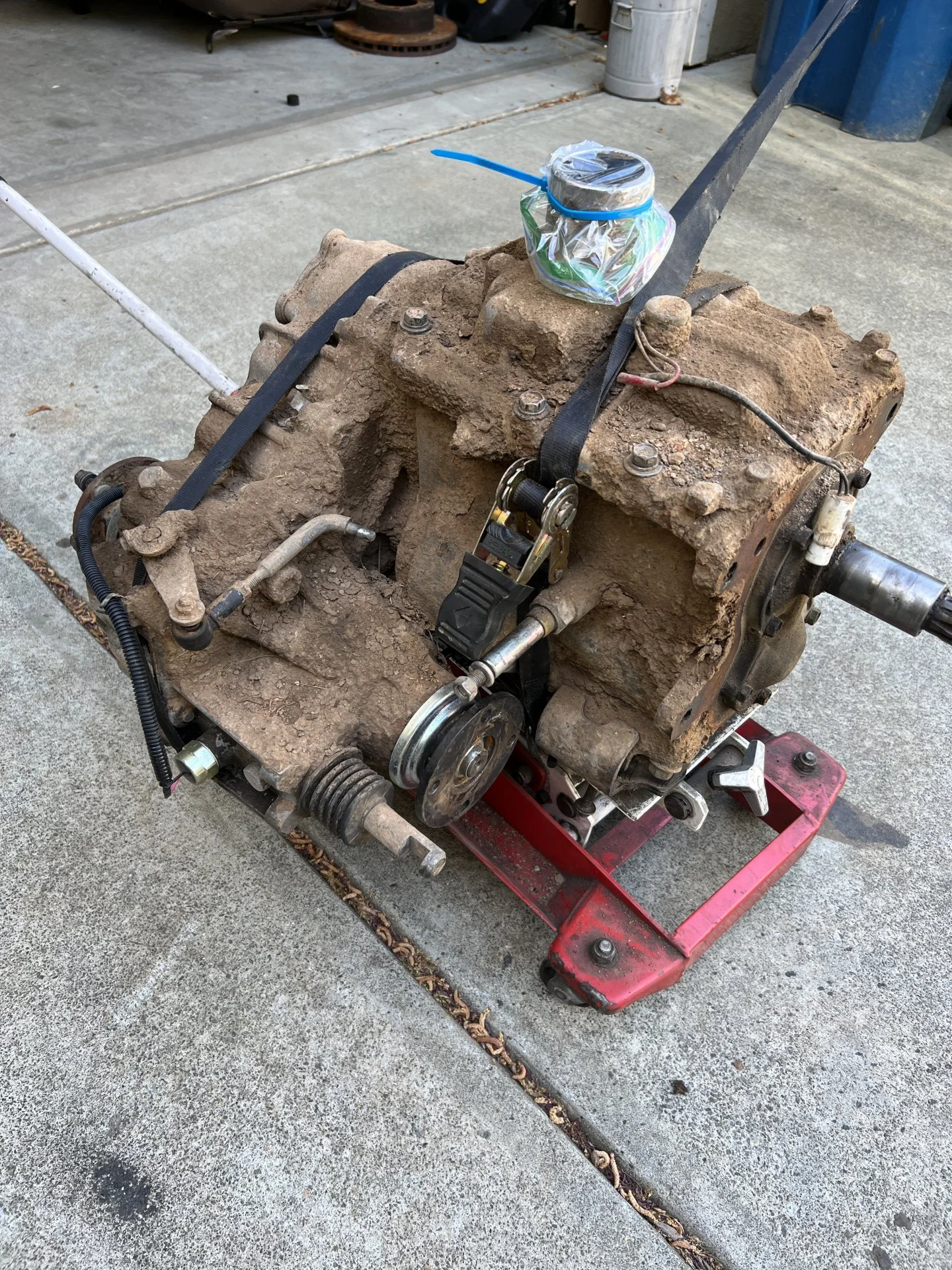

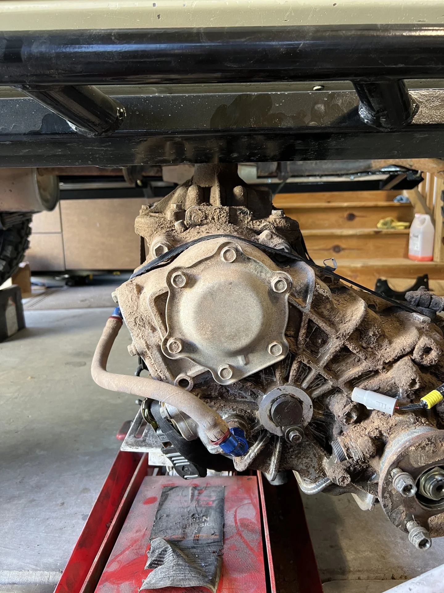

Got the trans pulled yesterday. I did notice that there was a new leak after the latest road trip. Looks like a good time for a rebuild!

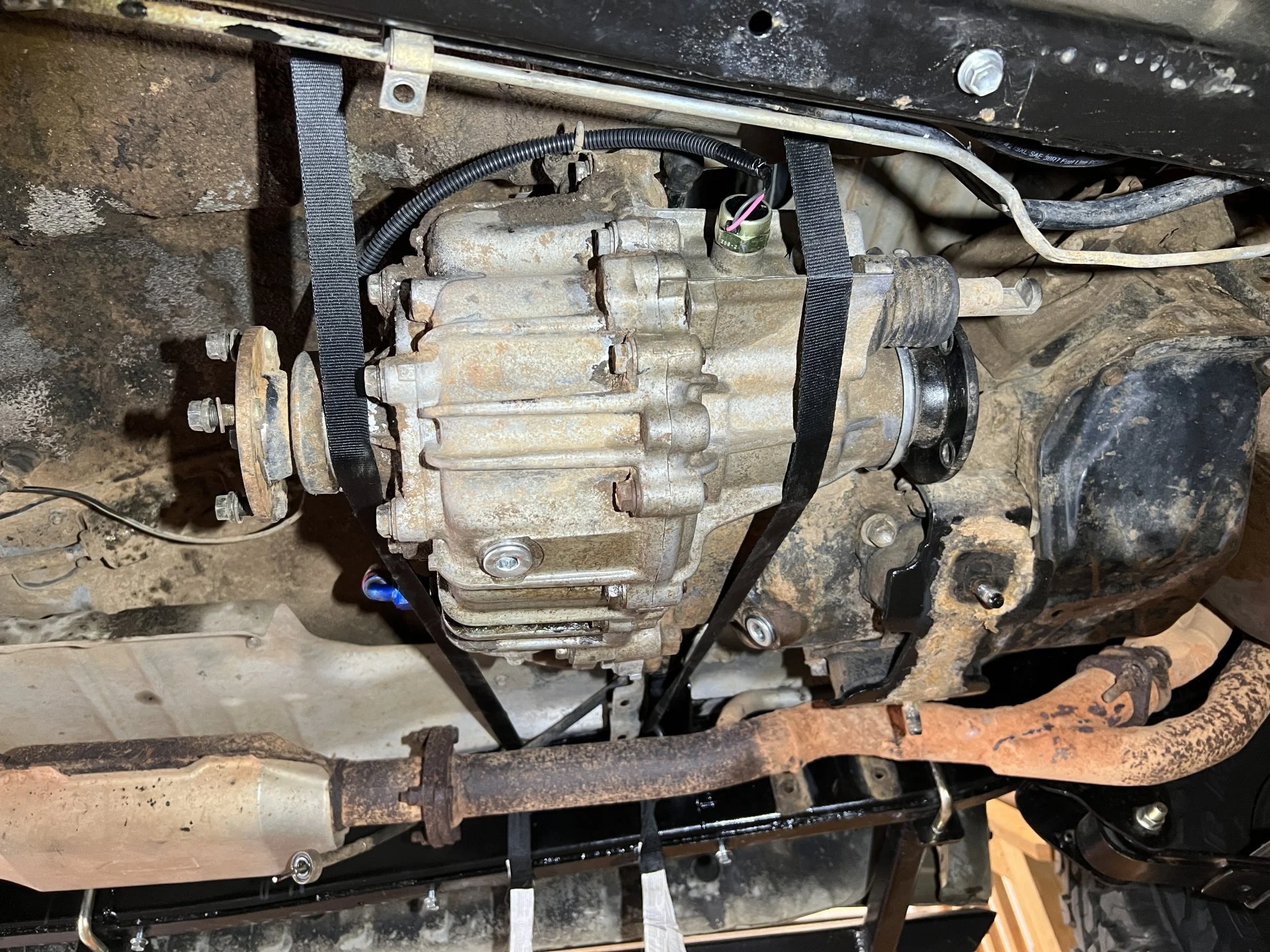

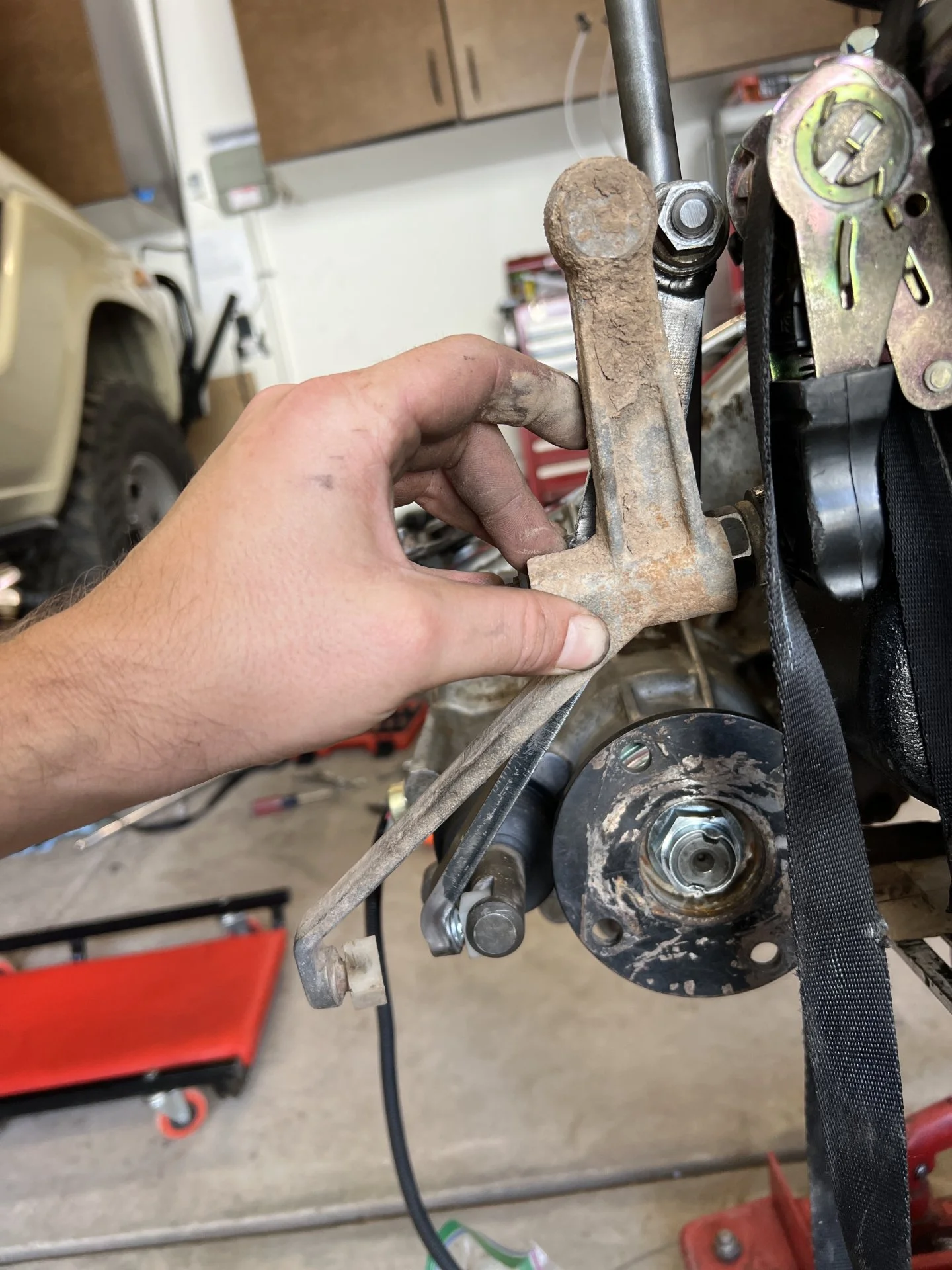

I couldn't fit both my regular jack and the transmission jack that @GLTHFJ60 lent me so I used some strap to support while I took the crossmember out. Worked great!
Even with the truck on ramps, the trans needed another 1-2" of clearance. Got the ancient Hi lift jack out and put it to work.
The bypass hose will be removed once the t-case is rebuilt.

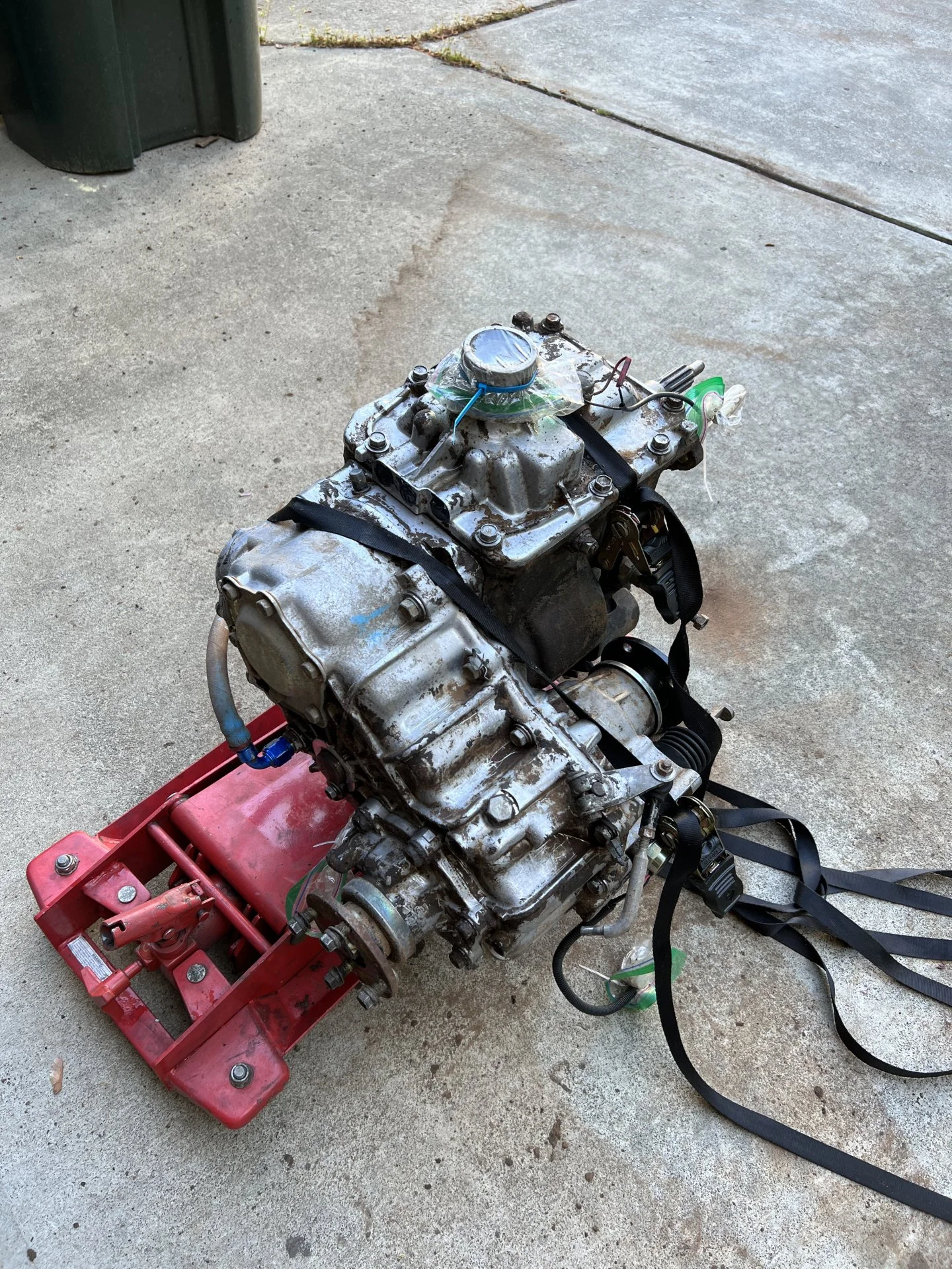

Trans and t-case out! It's very muddy so I knocked off the majority of it with some degreaser and a pressure washer.

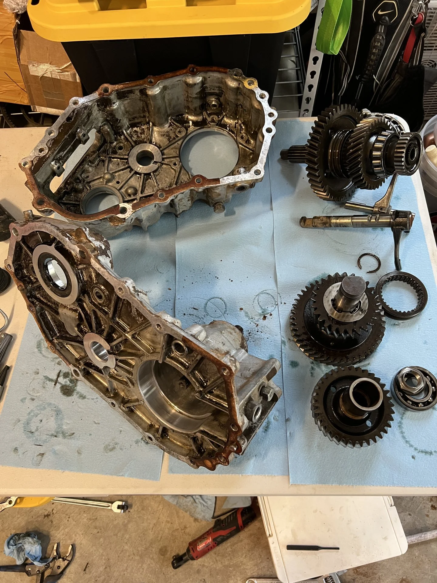

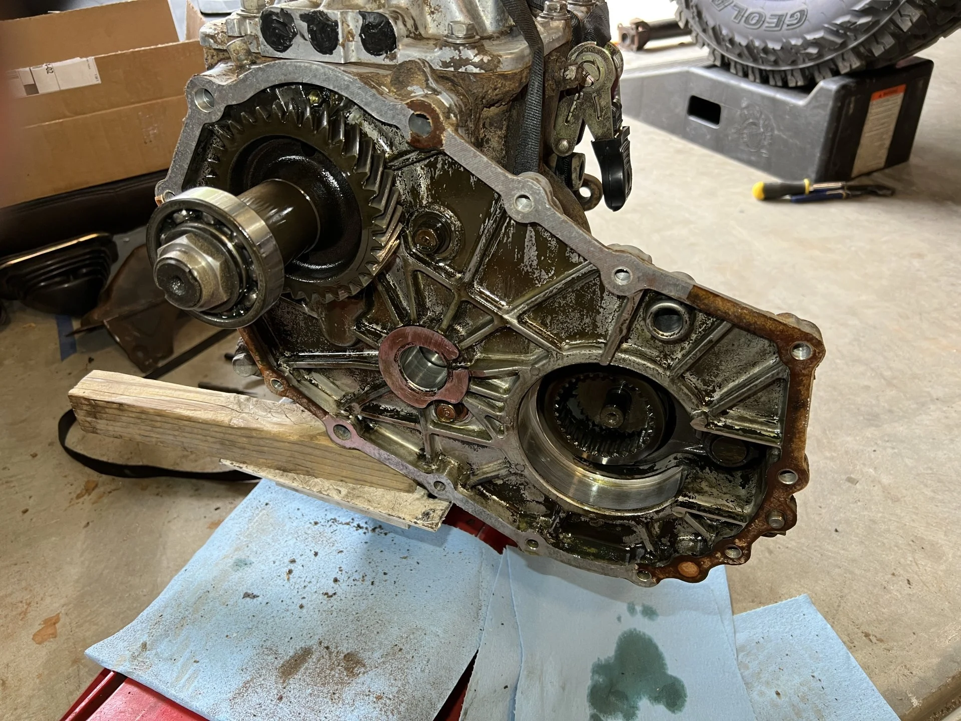

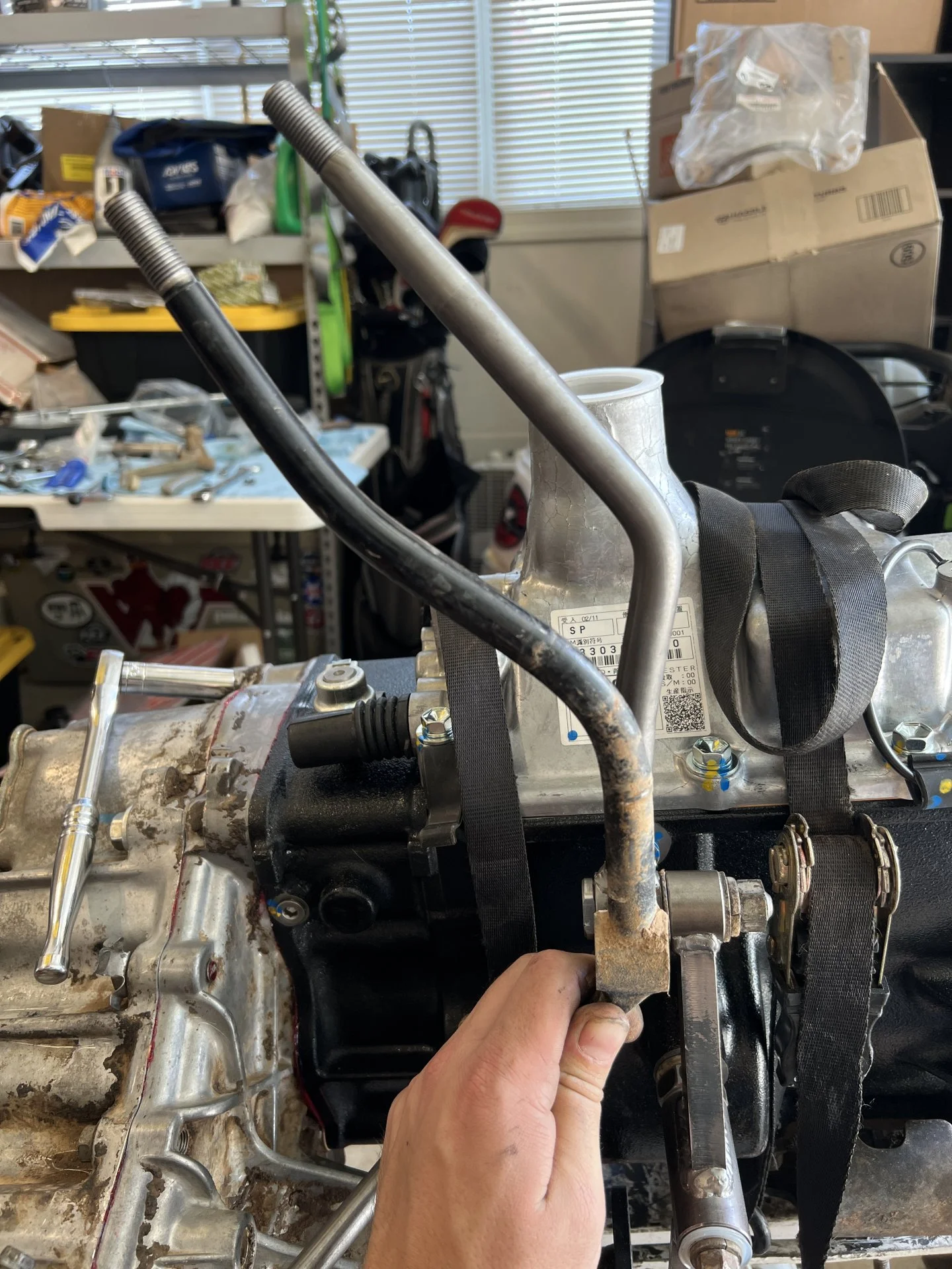

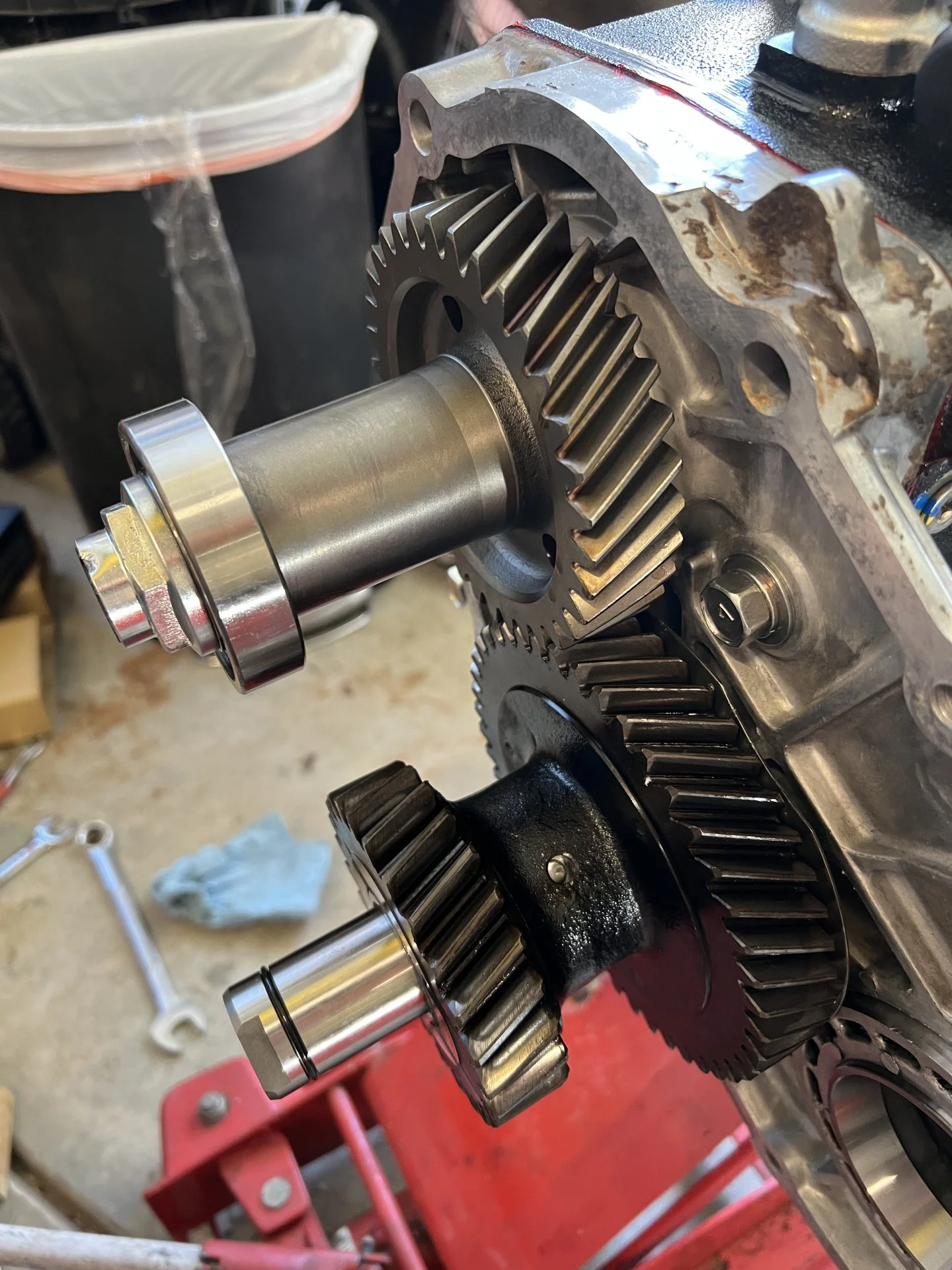

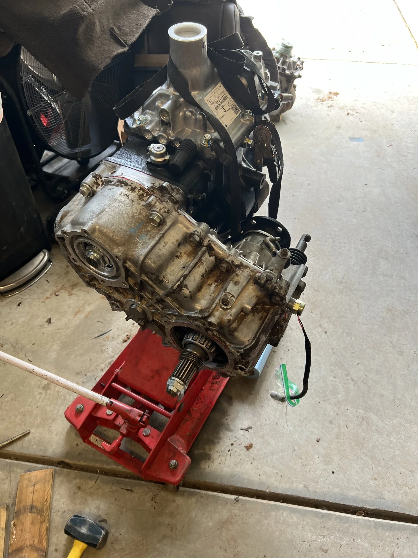

Then today I got the trans and t-case torn apart and separated. First time taking a split case apart and it was a breeze. Some of the parts to be used. I went with @TRAIL TAILOR shift linkage kit for the t-case and @orangefj45 told me about the extended spline input gear as well so I picked one of those up.
Inside was pretty gross. The transfer case will get a good cleaning inside and out during the rebuild. @GLTHFJ60 also pointed out that my t-case doesn't have a PTO gear. Did any of the early trucks have them or were they standard in the later trucks?
Ready to start cleaning and rebuilding the t-case.

Most of these cases had PTO gears. I think everything from 05/85 and up ( including the vacuum shifted cases in the FJ62s ) had PRO gears.
Some of the early cases did not

Thanks for the info. My truck is a 1984 and a 10/83 build date so mine may have preceded the PTO gears. I just say it's a race modification to reduce unsprung weight to improve acceleration!

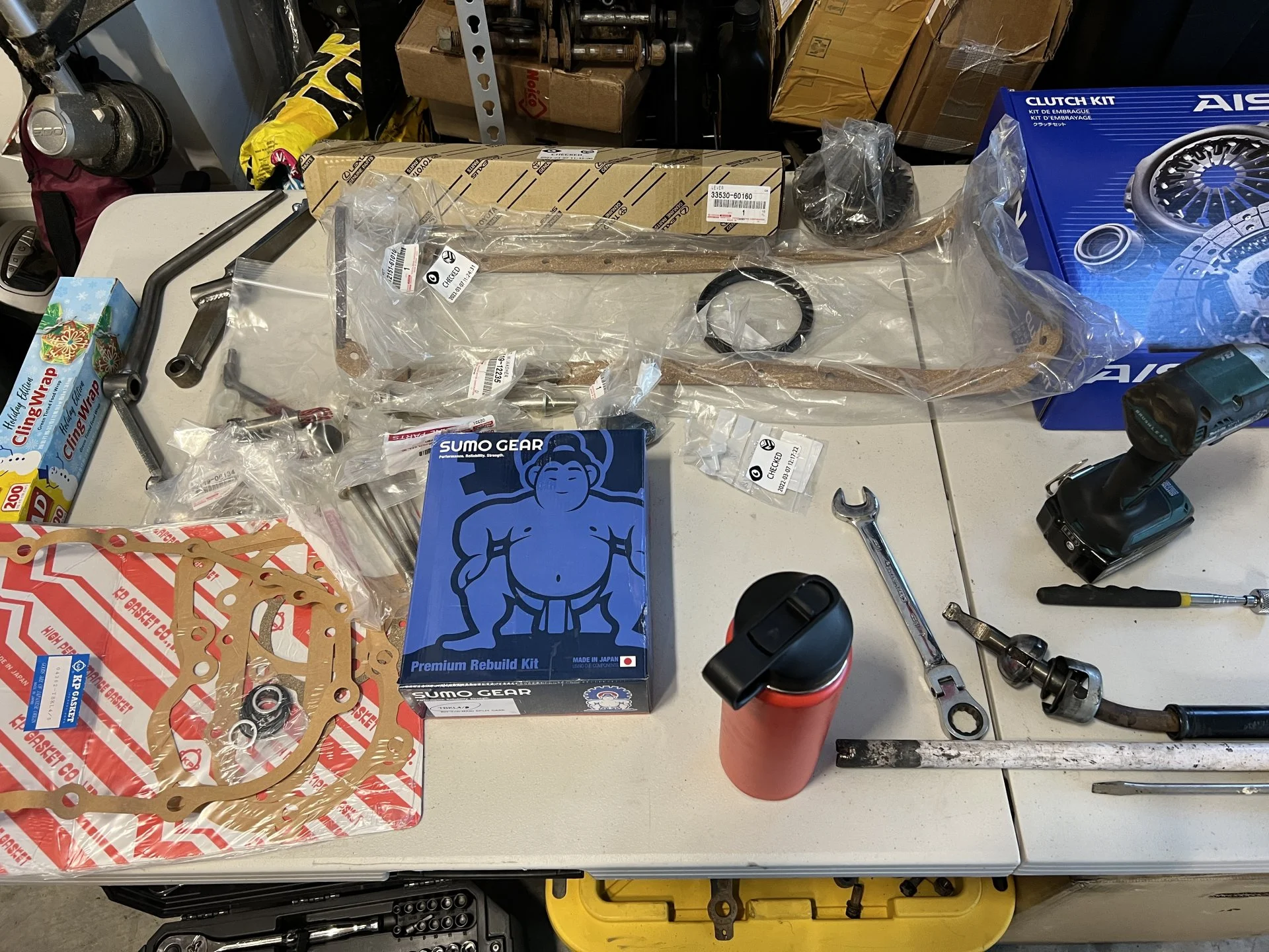

Bit of an update. Waiting on parts currently.

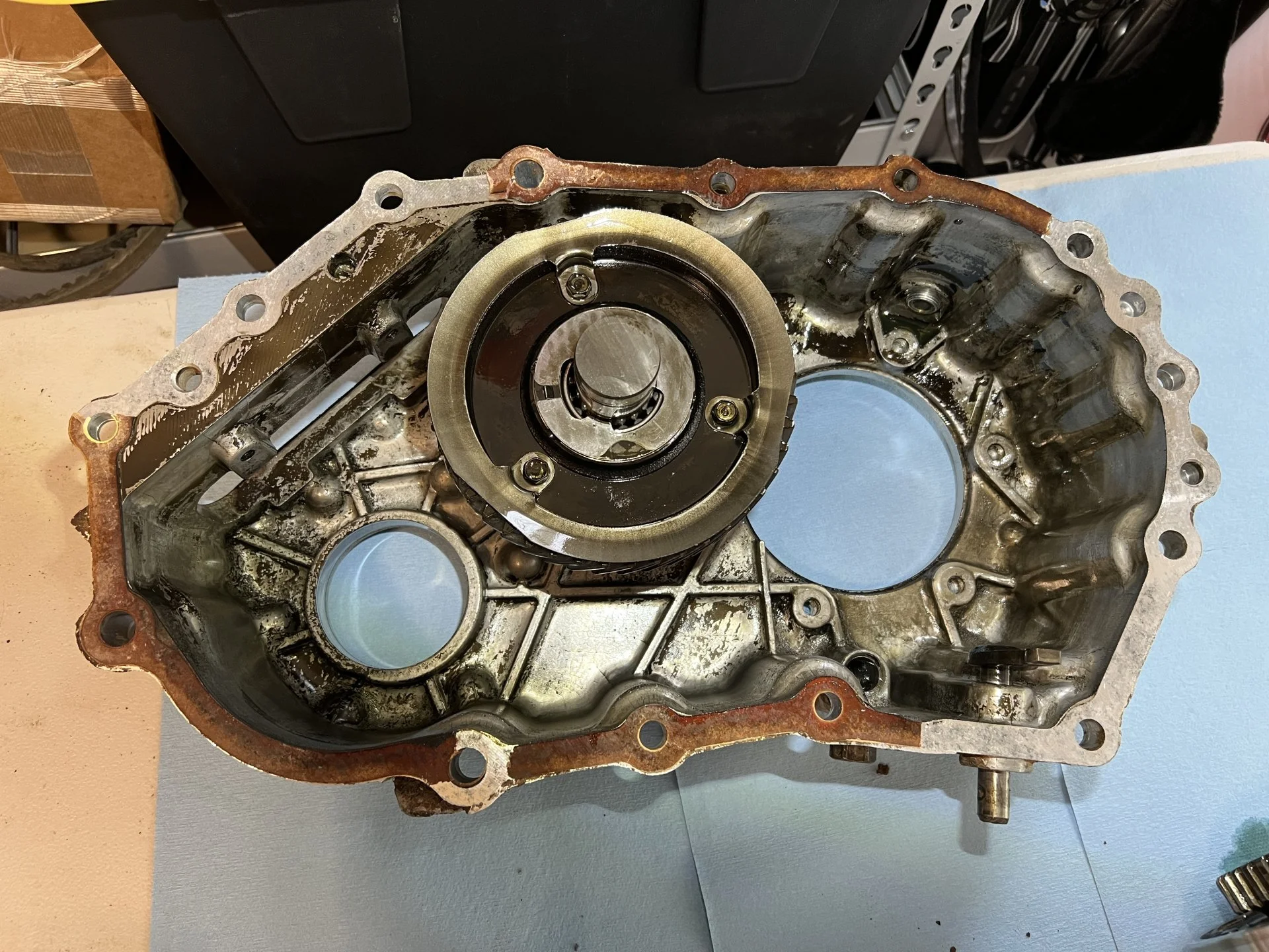

Inside of the case is now clean, flywheel resurfaced, and the two halves of the case are mated. I went to go measure the bearing preload on the output shaft and it's way under spec. Measured at 1.5 in-lbs so I'm waiting on shims to come in so I can get that into the FSM spec of 13.0-21.4 in-lbs. The rear bearing race had a #5 shim in there so I ordered up a few to get it dialed in. Ordered a #7, #9, #11 and a #0 so that I have some on hand for later or other local guys needing them.

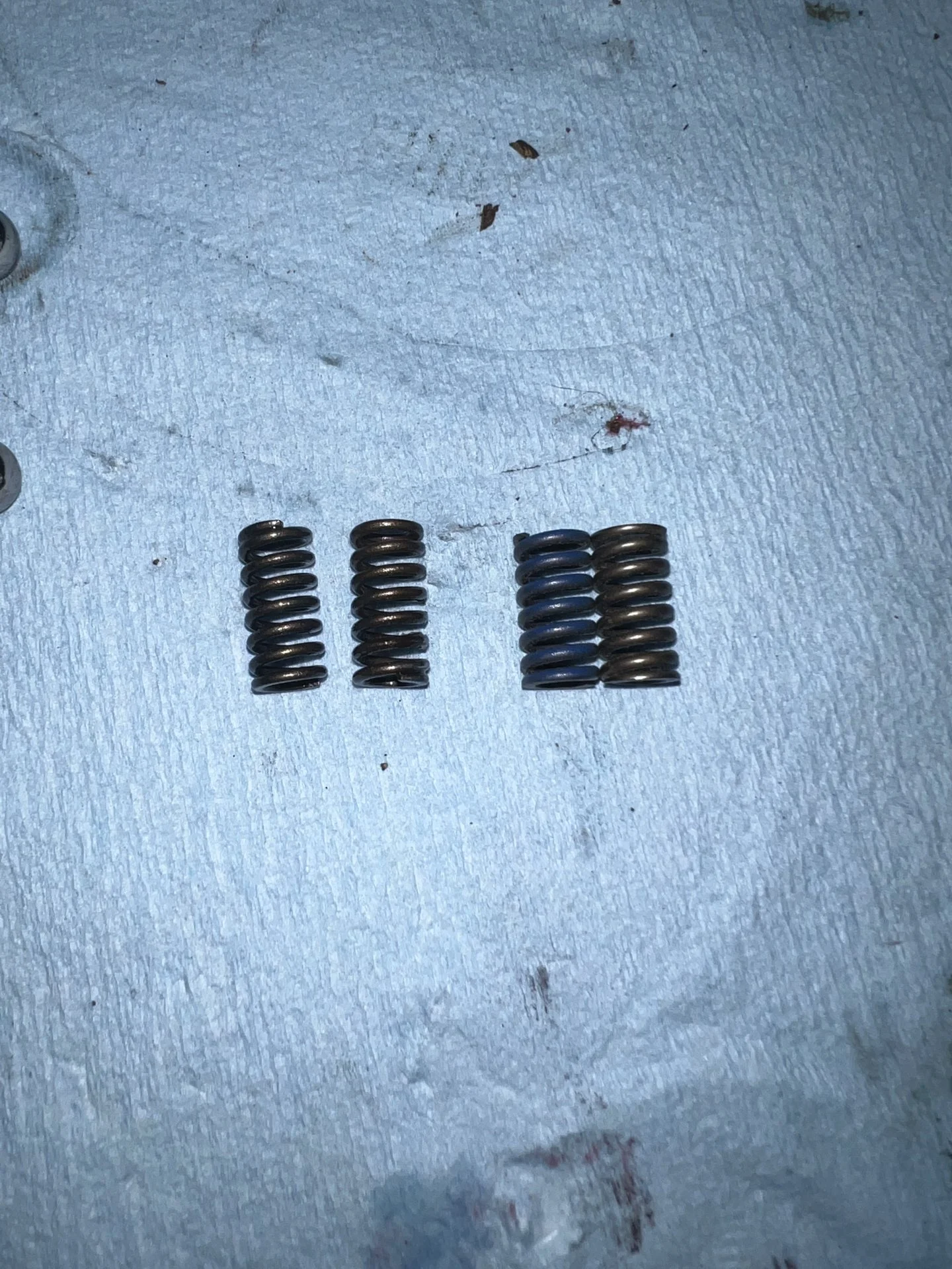

I also ordered up some stronger detent springs thanks to a suggestion by @EasternYeti to ensure the shifter won't be popping out of gear.

Once I got the clutch removed, I confirmed my leaking OPG. I had planned on replacing the RMS and OPG while I am in there so no problem getting it fixed.

Extended spline input gear also added.

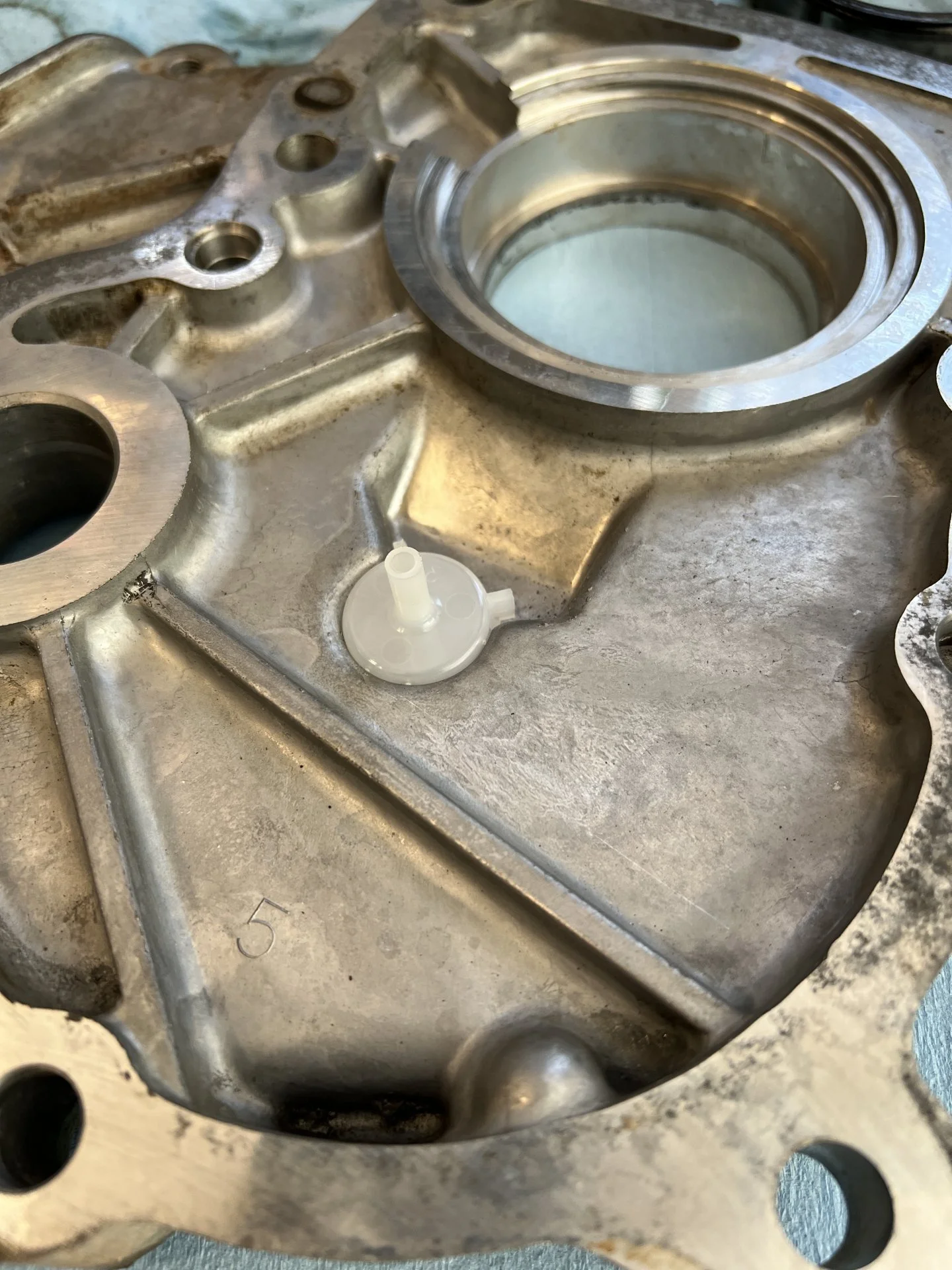

And yes, I also noticed that the little oil shield for the breather was missing after I put on the input gear so it had to come back apart after this picture to reinstall it. D'oh!

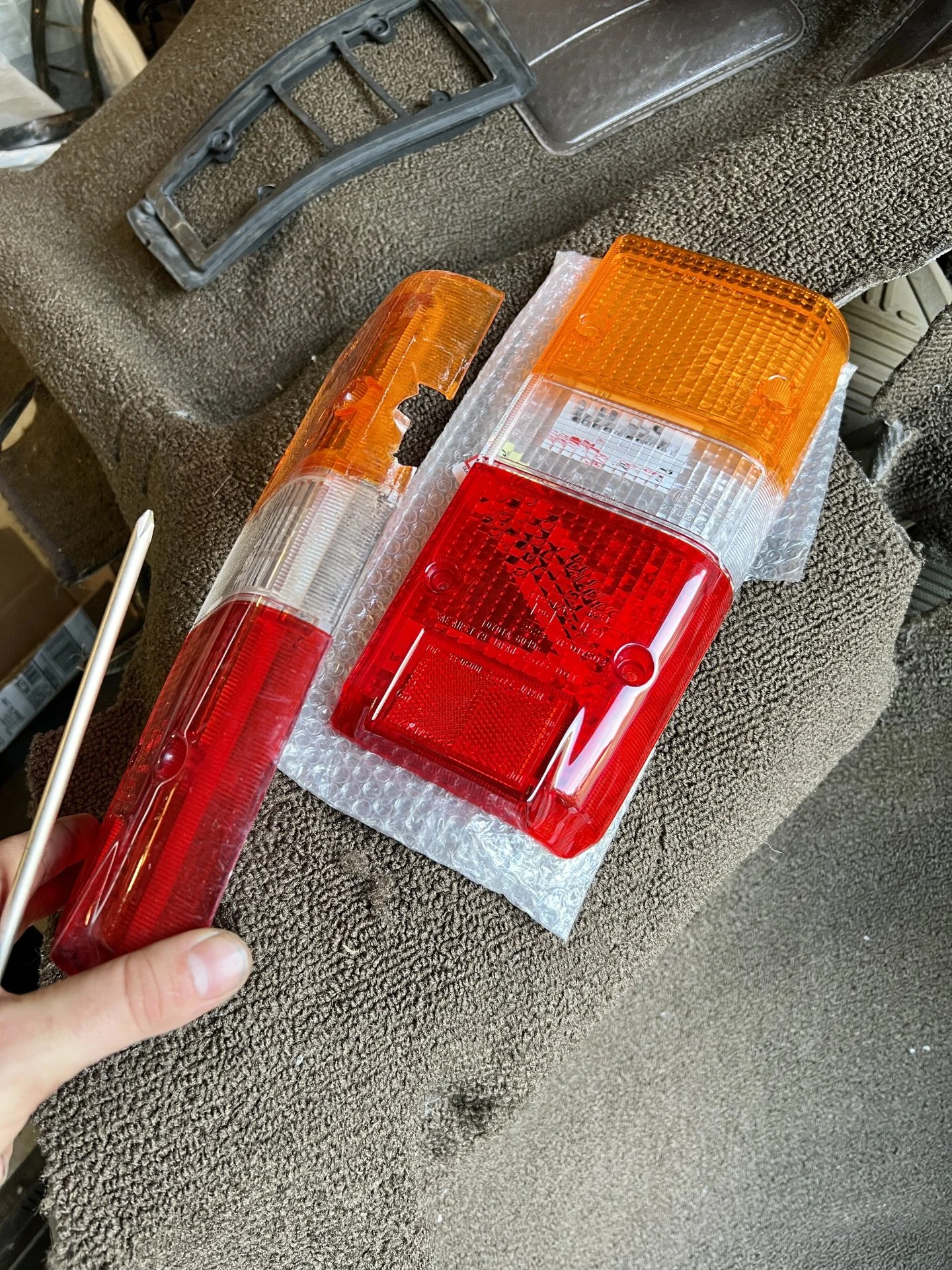

Old taillight gaskets were leaking into the housings. The right rear lens was also cracked and missing a big chunk which had been temporarily mended with some gorilla tape.
New right rear OEM lens and new City Racer gaskets with new foams on both sides.

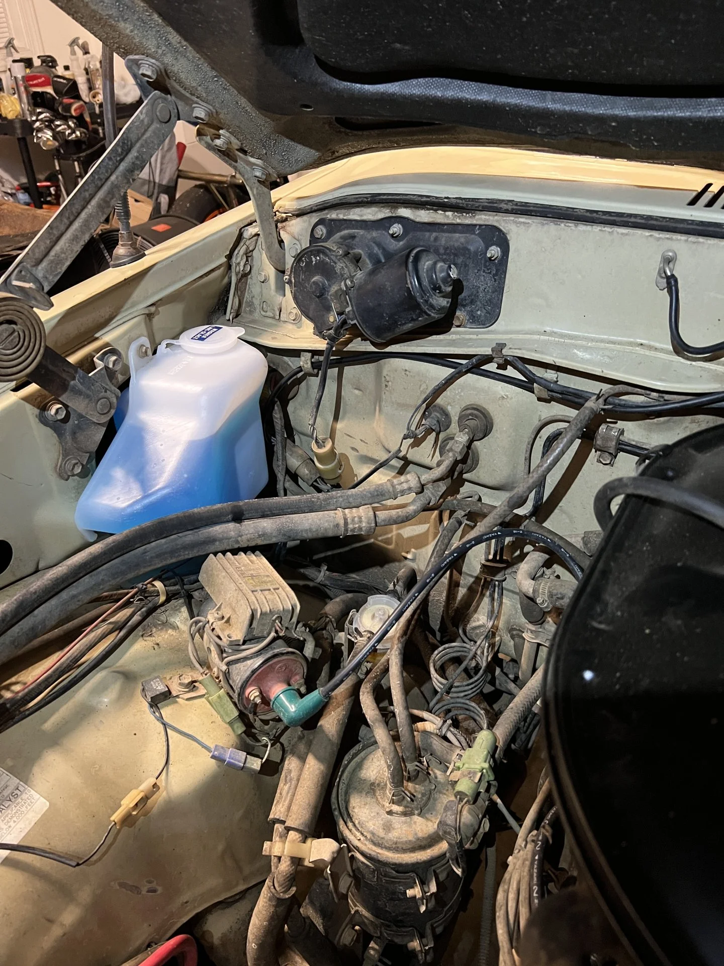

Added a nice driveability item today. Windshield washer!
The factory one was completely missing when I bought the truck and all that was left was a couple of pieces of crusty dry rotted tube. New Toyota reservoir, new motor, all new lines and connectors. Works great!
Where did you find the motor?
I got it on RockAuto. Factory ones are NLA.

I bought this one. I think I had to extend the wire harness with the factory connector though so it would reach.

Here are the stronger shift detent springs that I used compared to the original ones. New on the RIGHT. PN: 90501-16115
The shifter feel and engagement with these stronger springs feels great and I shouldn't have to worry about popping out of gear.

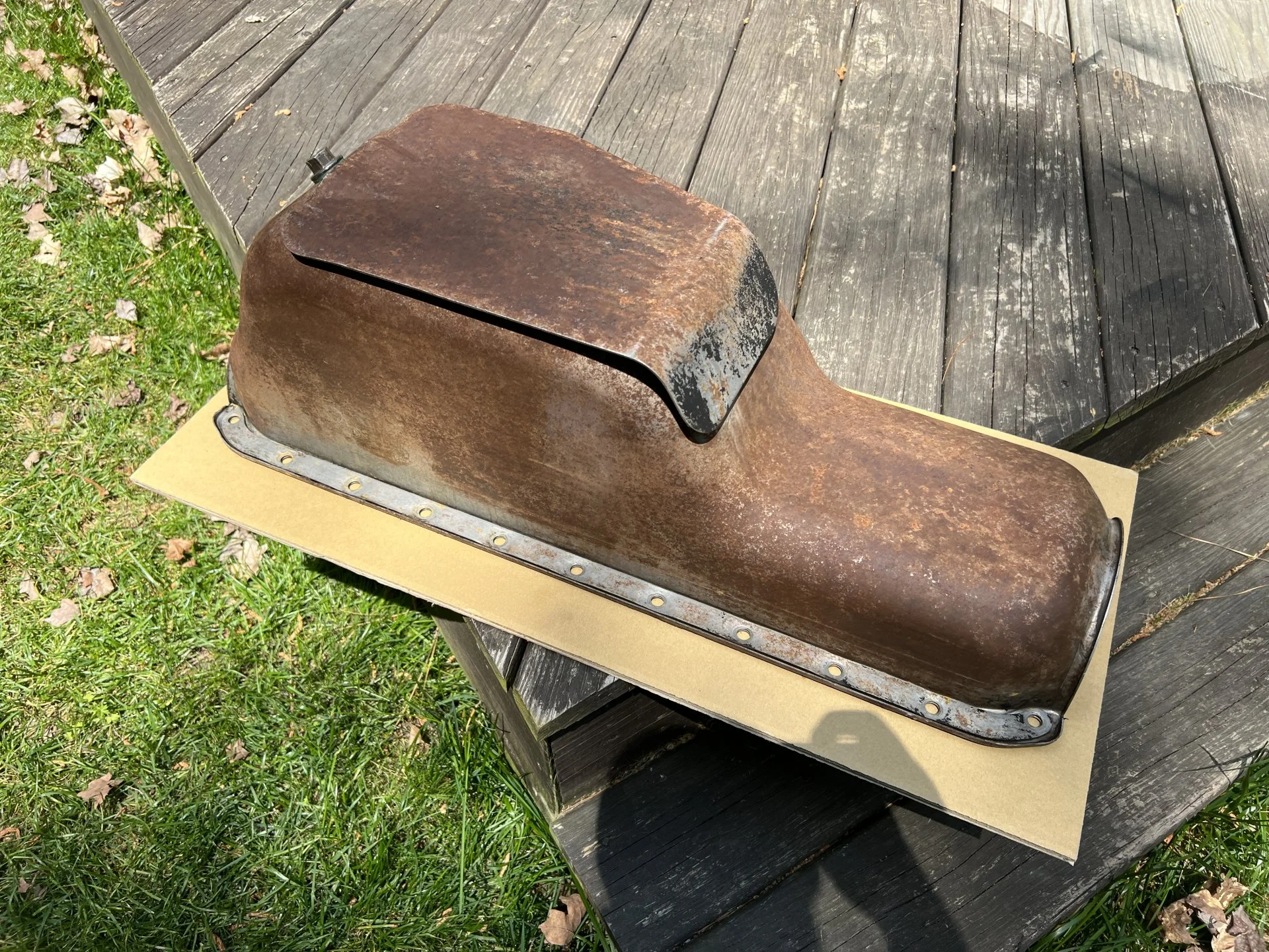

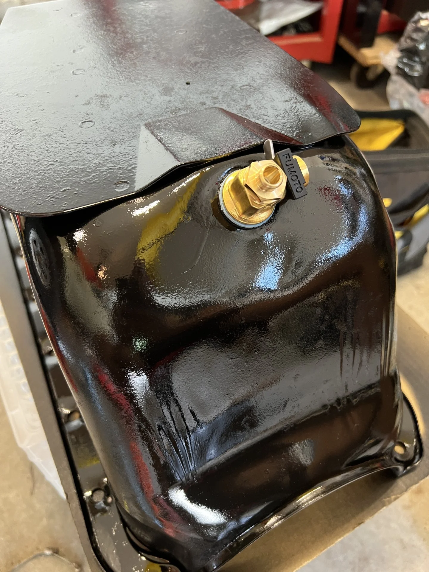

Pan was pullled to do the OPG and so I cleaned it up and gave it a coat of paint. Before and after.
Also had to add a Fumoto drain plug. PN: F104S
I opted for the @TRAIL TAILOR linkage for the new H55 so that it would work in my pre-1985 truck. Here's a couple pics showing the difference in shift linkages. It's a really nice bit of kit that bolted up no problem! Will fine tune the shifter position once it's in the truck.

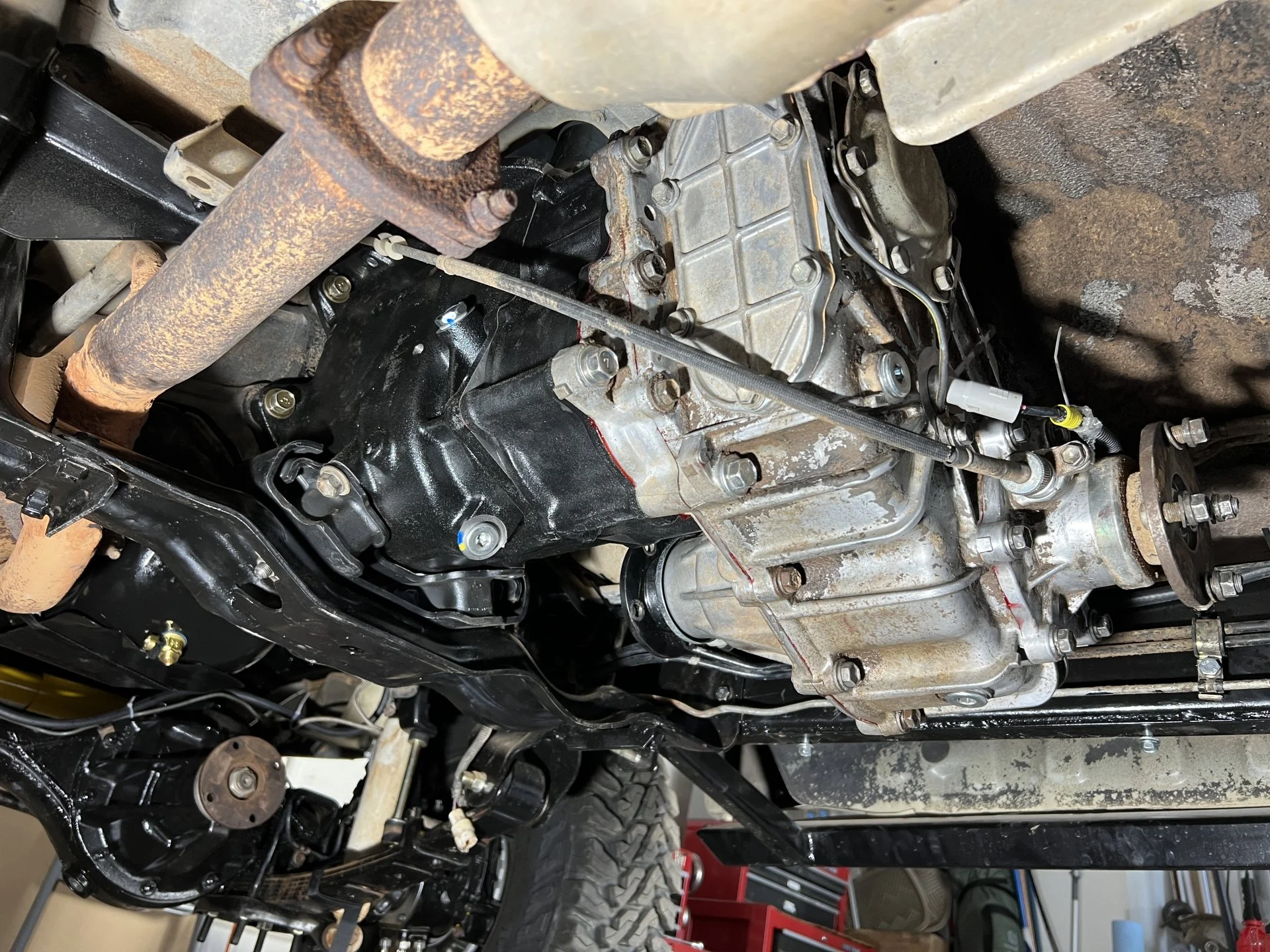

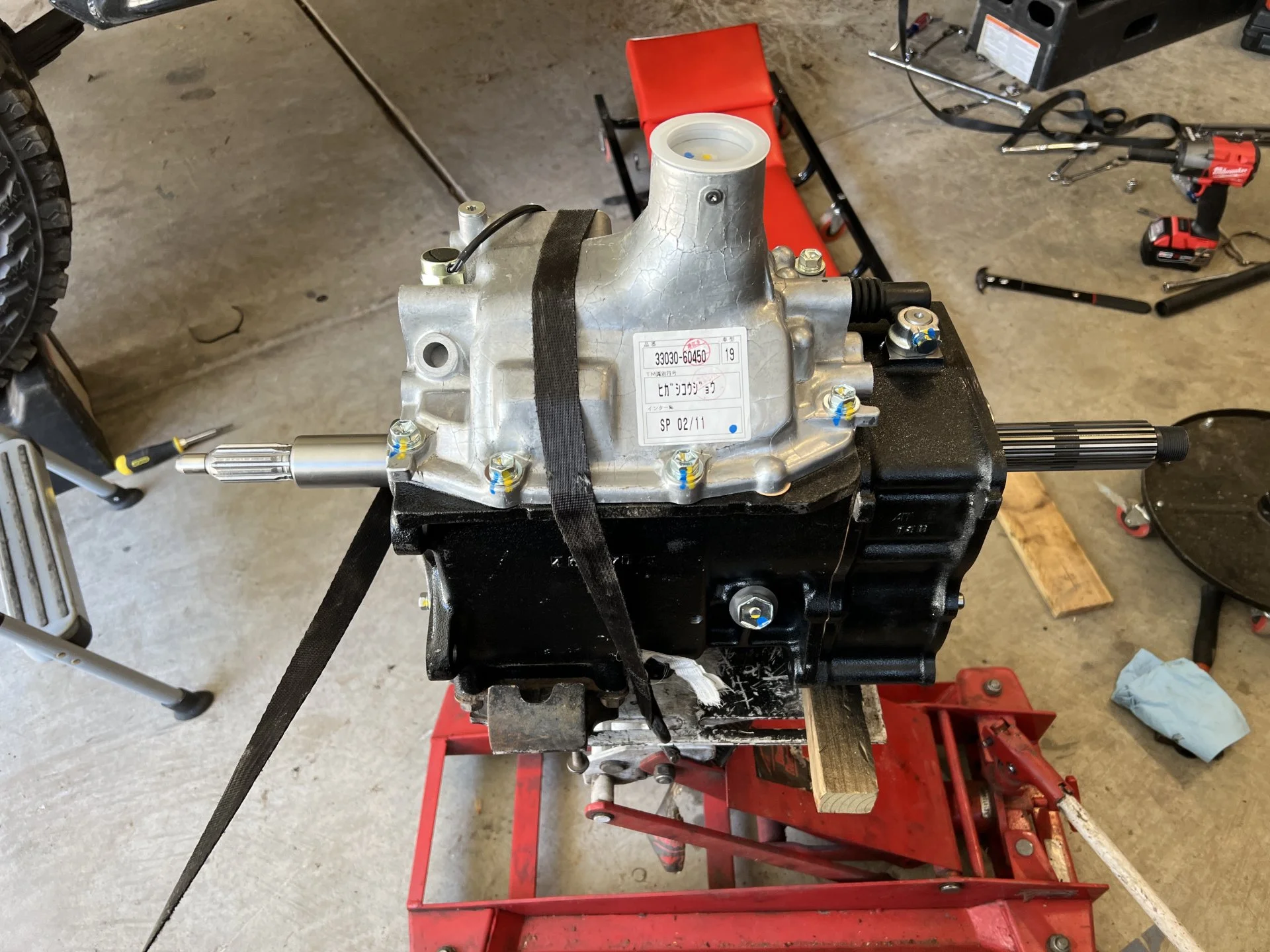

H55 is installed! Shoutout to @GLTHFJ60 for providing an extra set of hands for the install and letting me borrow some key tools for the job like a trans jack and pilot bearing puller.
Next step is to order driveshafts and then button up the install with all the wiring, starter. etc.
By my driveshaft measurements, the front and rear shafts need to be modified 3.5” each to accommodate the H55.

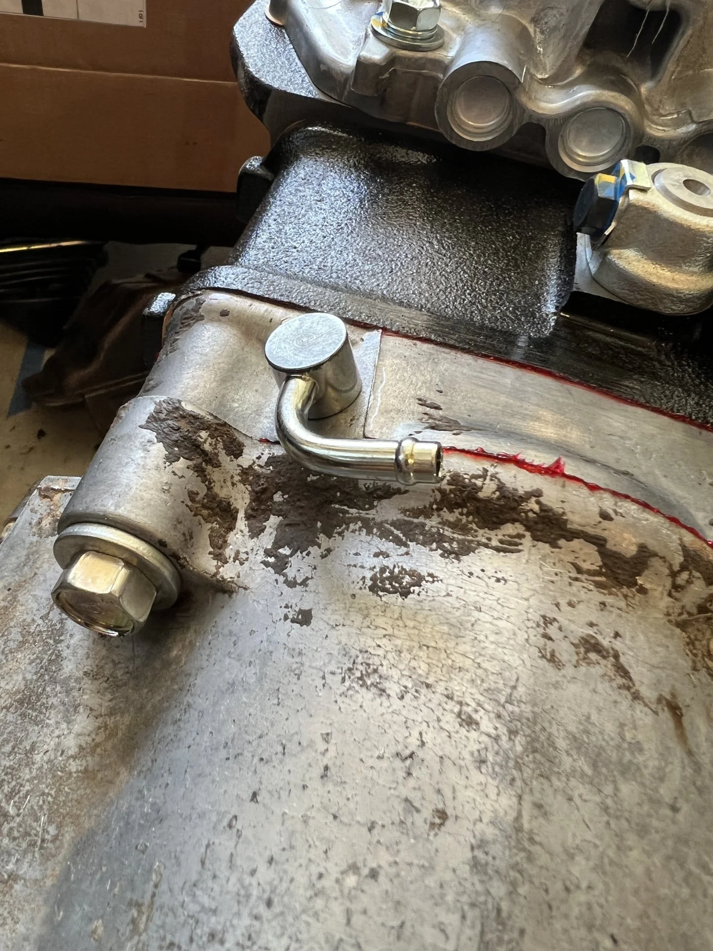

Some miscellaneous additions to the H55..
90* breather fitting

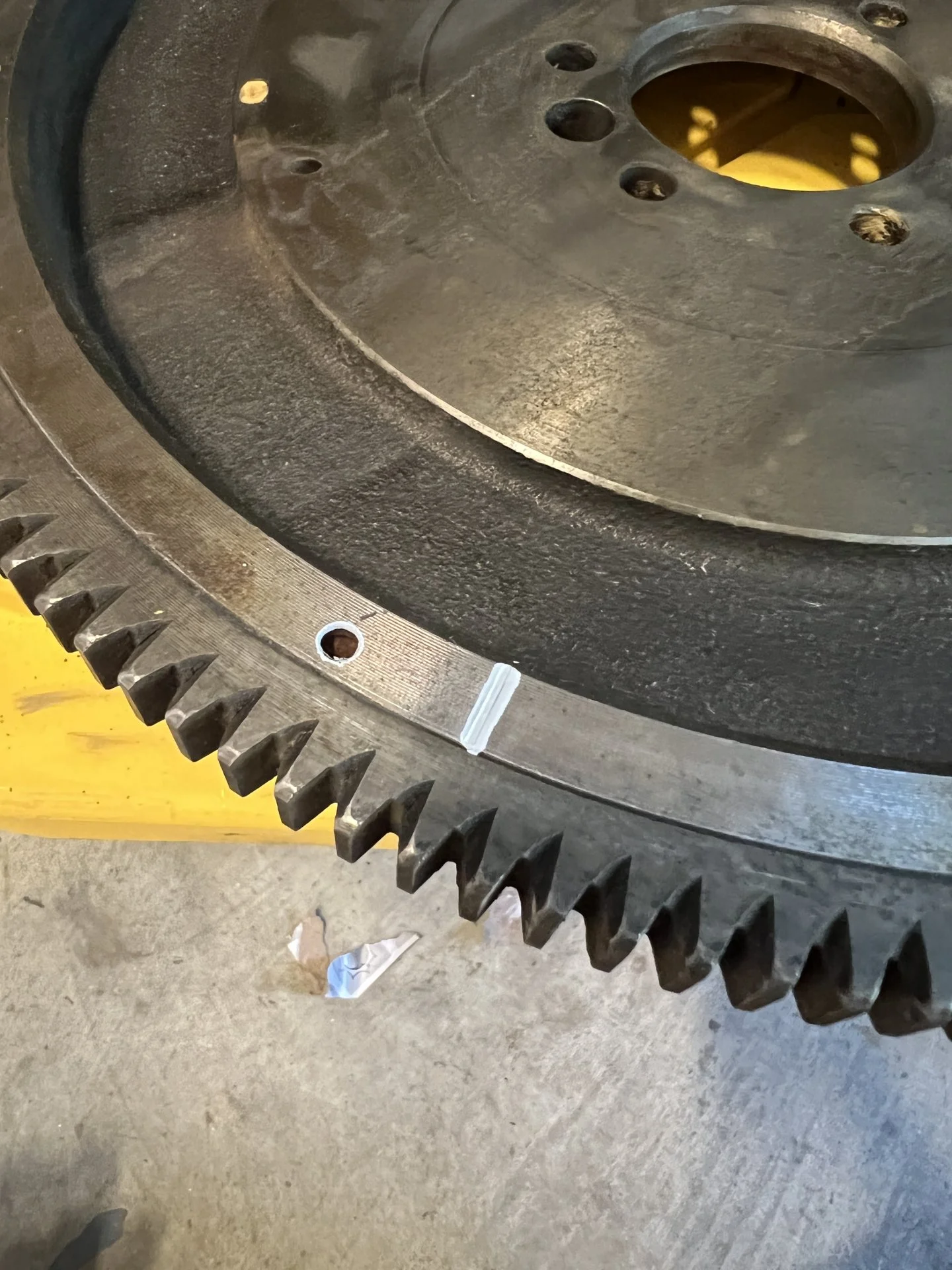

Used a paint pen to highlight the timing mark on the flywheel

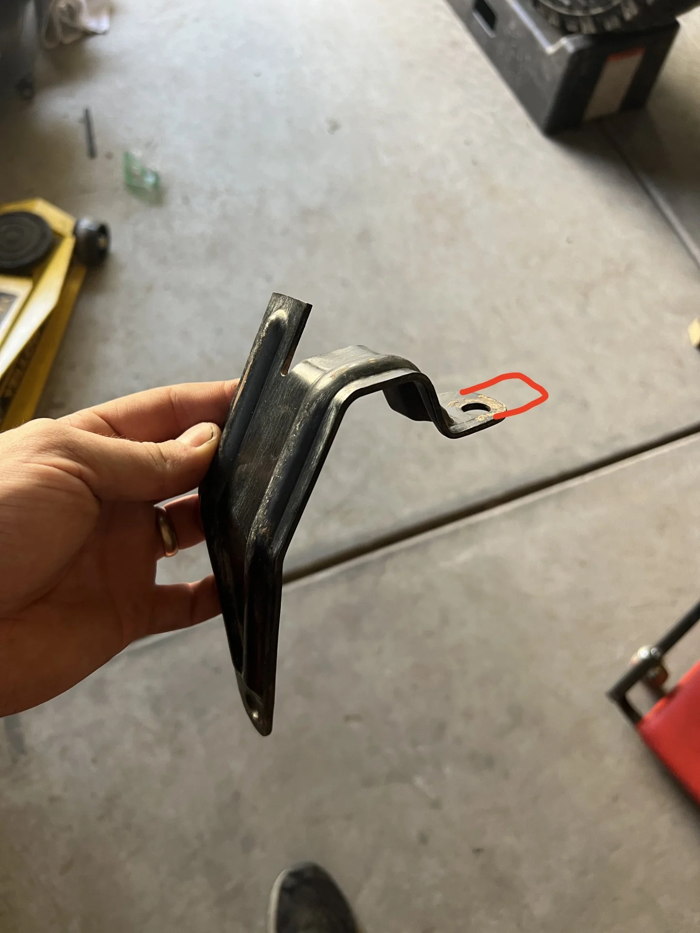

I went to go install the transfer case shifter plate and it didn't fit. The top hole that goes on the top transmission plate is ~1-1.5" too short. It looks like the cast mount that the shifter pivot bolt goes into sticks out a lot more on the H55 compared to the H42 and therefore this plate for the H42 doesn't fit. Are there other options? Is it even necessary? I could see it supporting the other side of the shifter pivot but also stop the shifter from shifting into 2WD Low but that tab is cut off by a lot of folks anyways. Ideas?

Where did you source the 90* breather? I just tried to order one but it was unavailable as an non import item, was going to look on partsouq.

I bought it from @cruiseroutfit

Iirc it's not entirely necessary, but I'd assume you could get it used from a late truck, or fab something up.

Part# DIFF36149 @ Cruiser Outfitters :D
