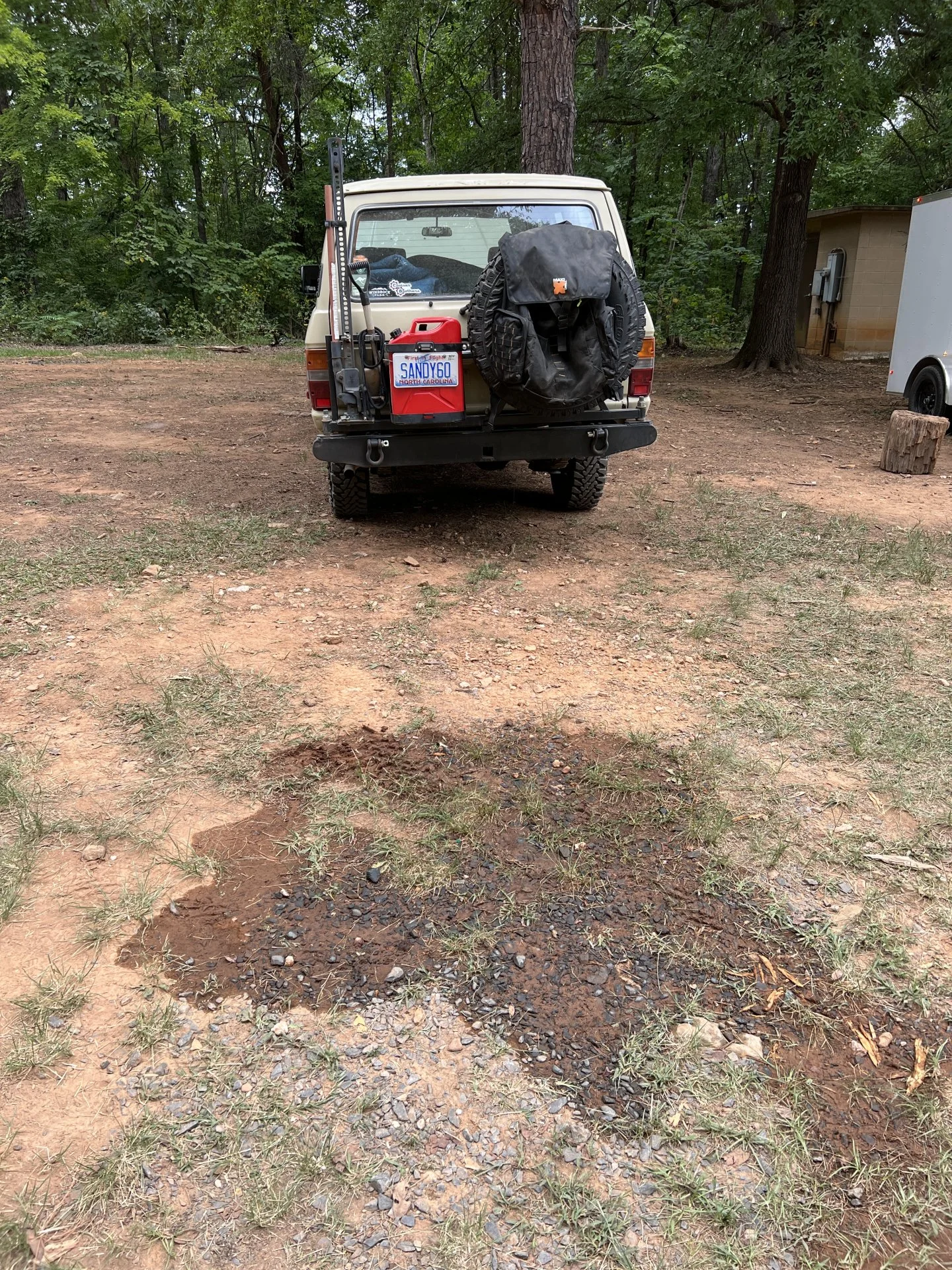

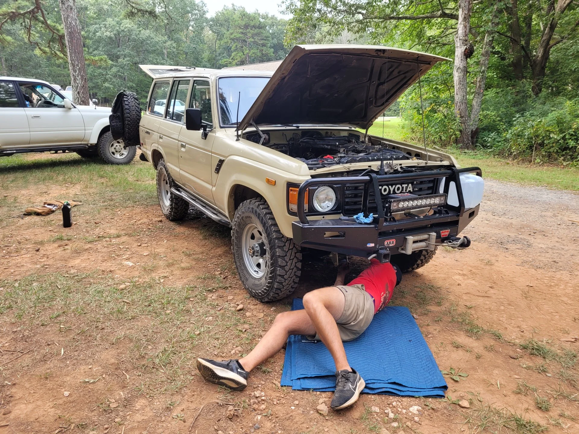

Well I forgot to update this after Logan’s Run. I opted to go ride the trails instead of drive and that turned out to be a good decision. Let the truck idle for 5-10 mins before heading home and finished saying goodbye and turn around to see Sandy spilling all of her coolant on the ground. Rushed over and shut it off without it getting hot luckily.
Turns out the lower water pump hose had popped off. I think the clamp must’ve been slowly working itself off and finally popped. Glad that didn’t happen on the trails! It was a quick fix and refilled and burped the system and I was on my way home. Otherwise it was an awesome event.

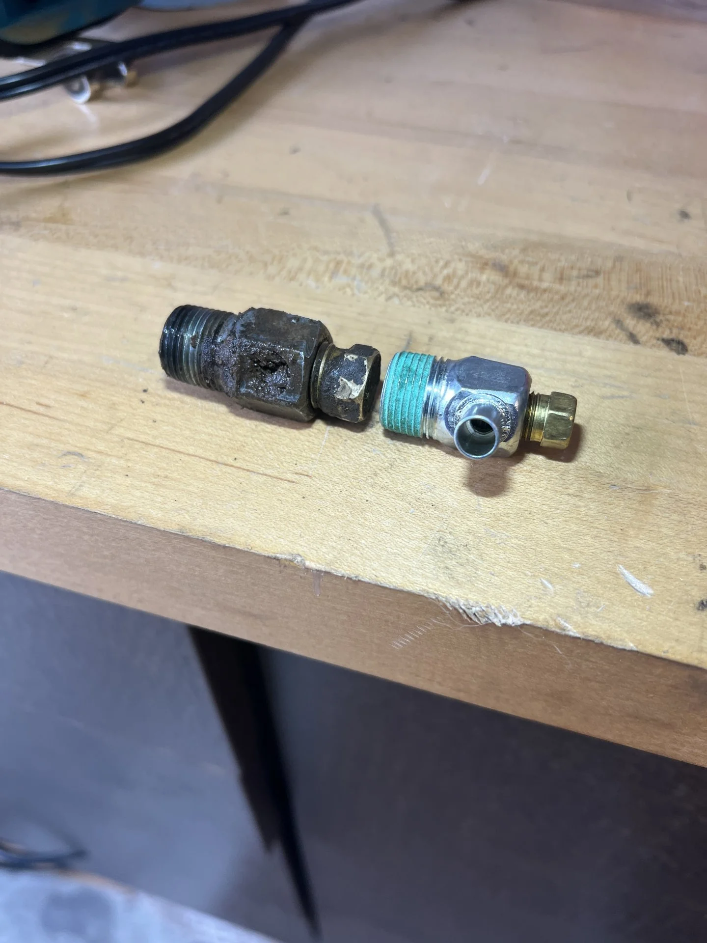

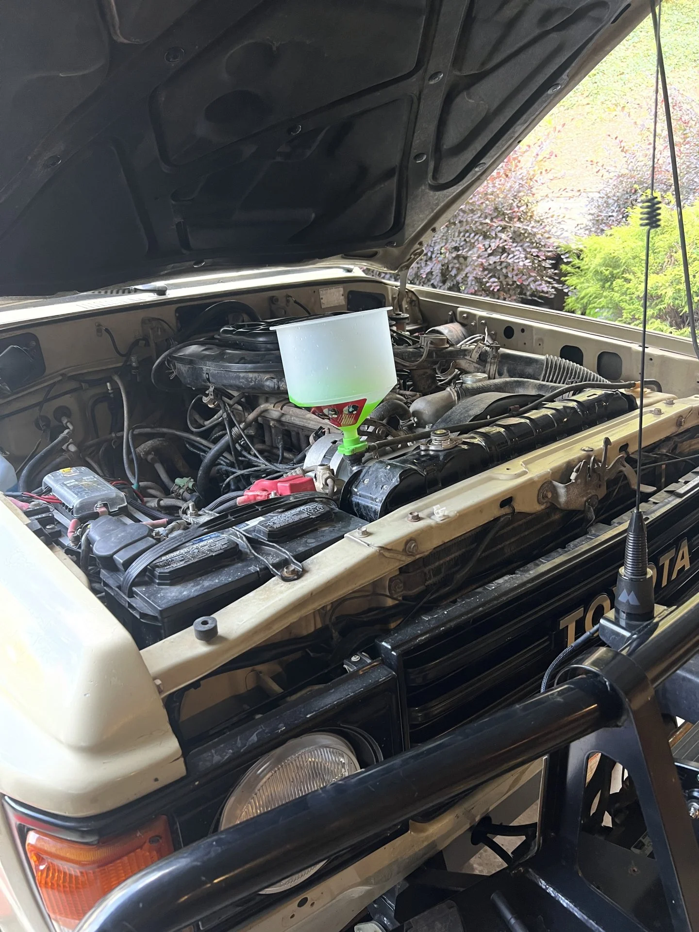

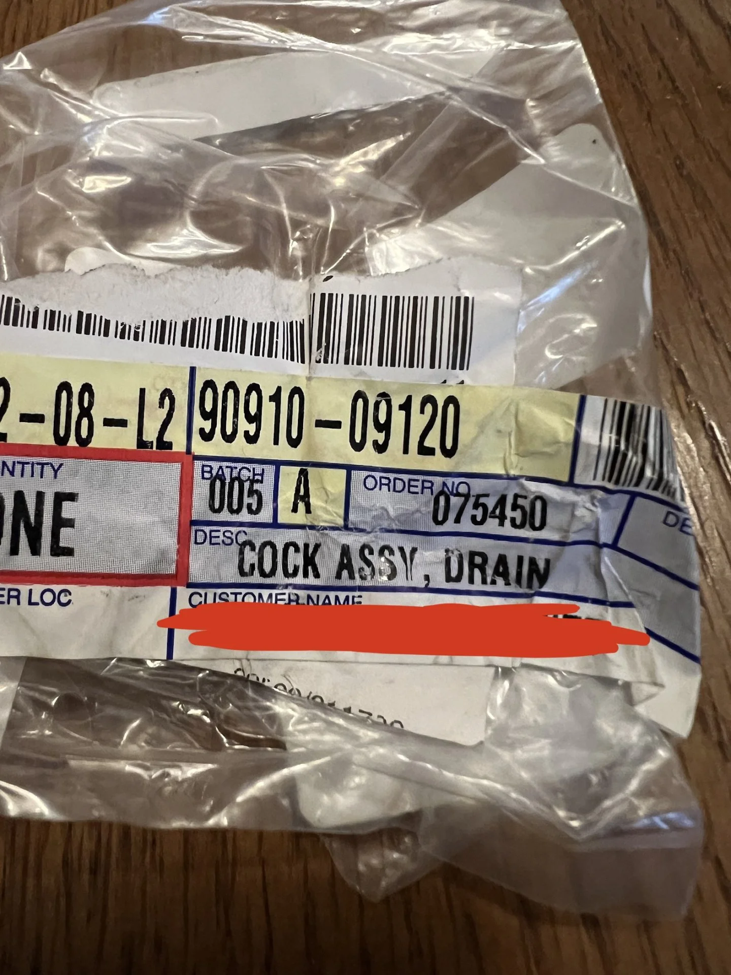

Refilled the cooling system today after the water pump hose fiasco where I just refilled it with water. While I had the system drained, I decided to put in my upgraded Cock Assy. which has a little nipple on it to put a hose on to drain which is nifty.
Slowly getting ready for Fall Crawl next weekend!
If anyone else wants to upgrade their Cock Assy. here's the PN
Old vs. new
Installed:
Refilling and burping the system

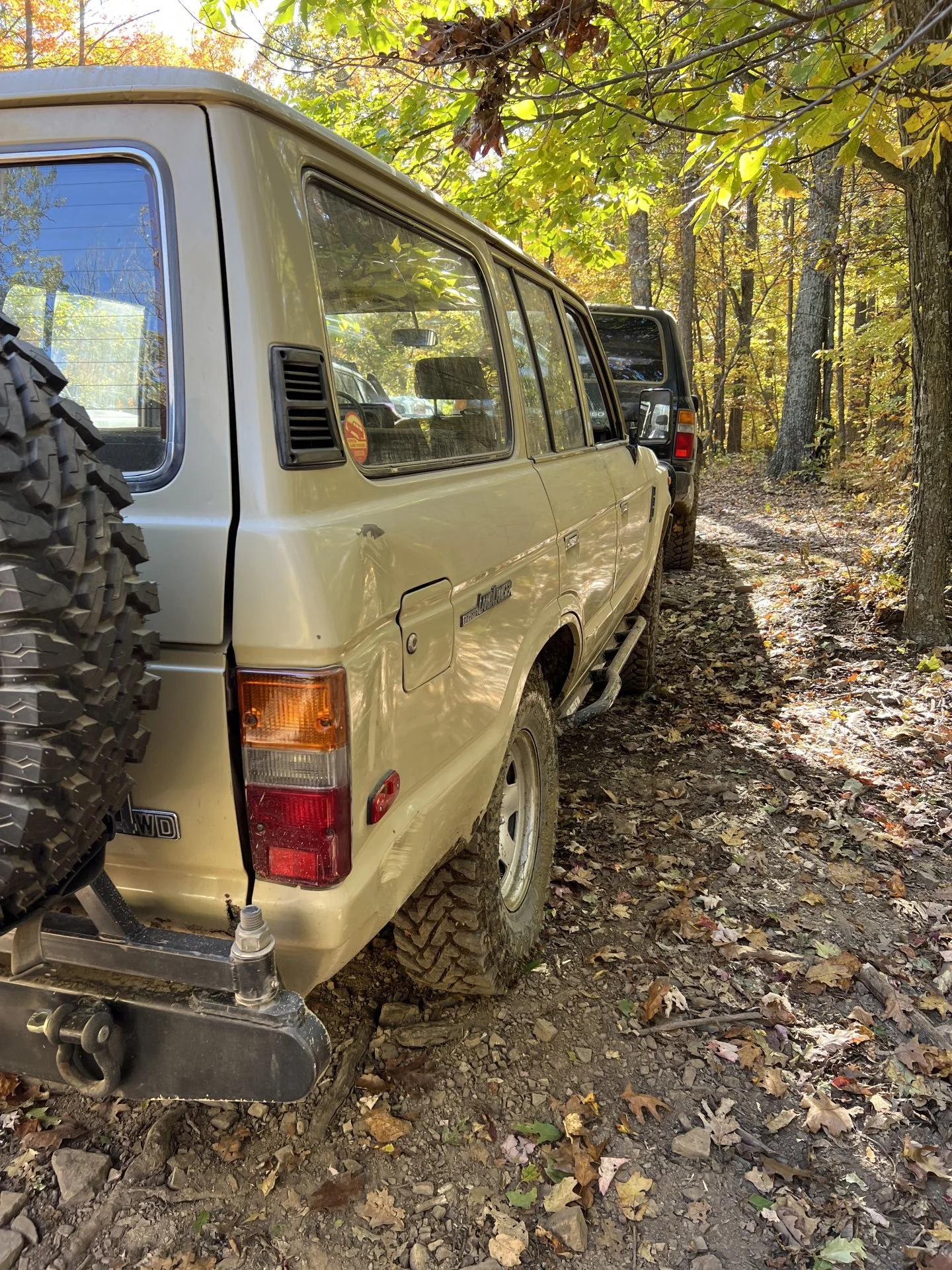

Some of the trails were a bit tight and, as a result, I christened the typical FJ60 rear quarter. Should be able to push most of it out and at least the taillight survived.

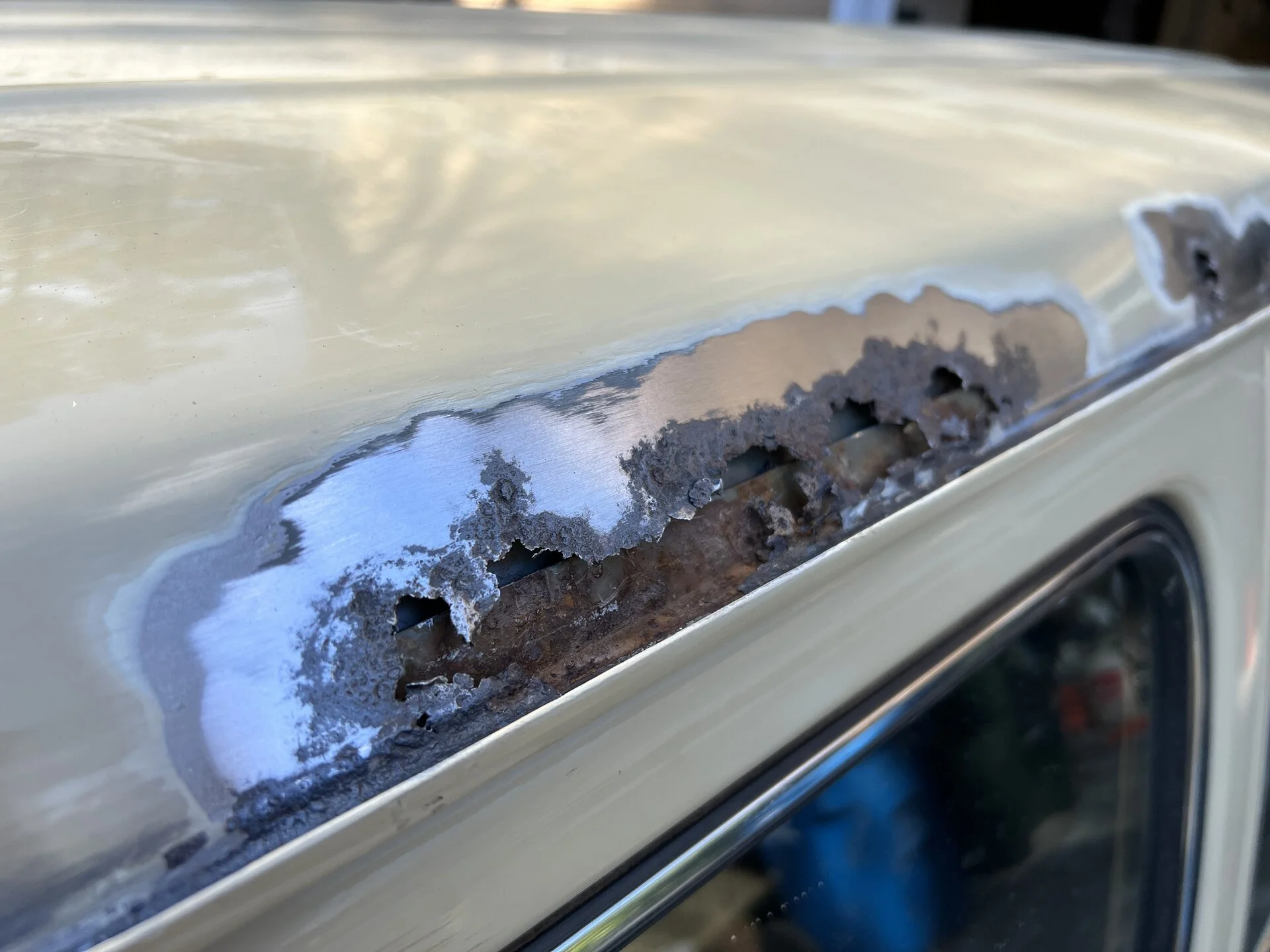

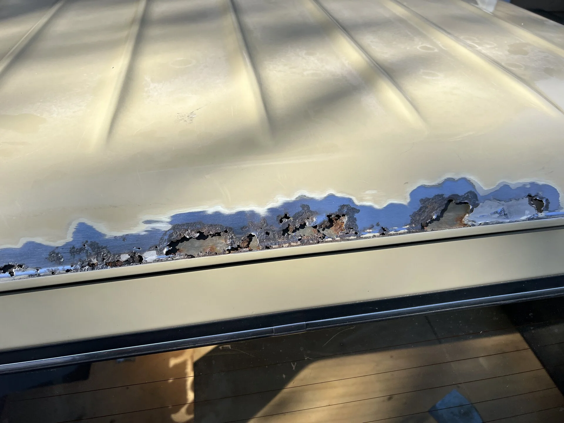

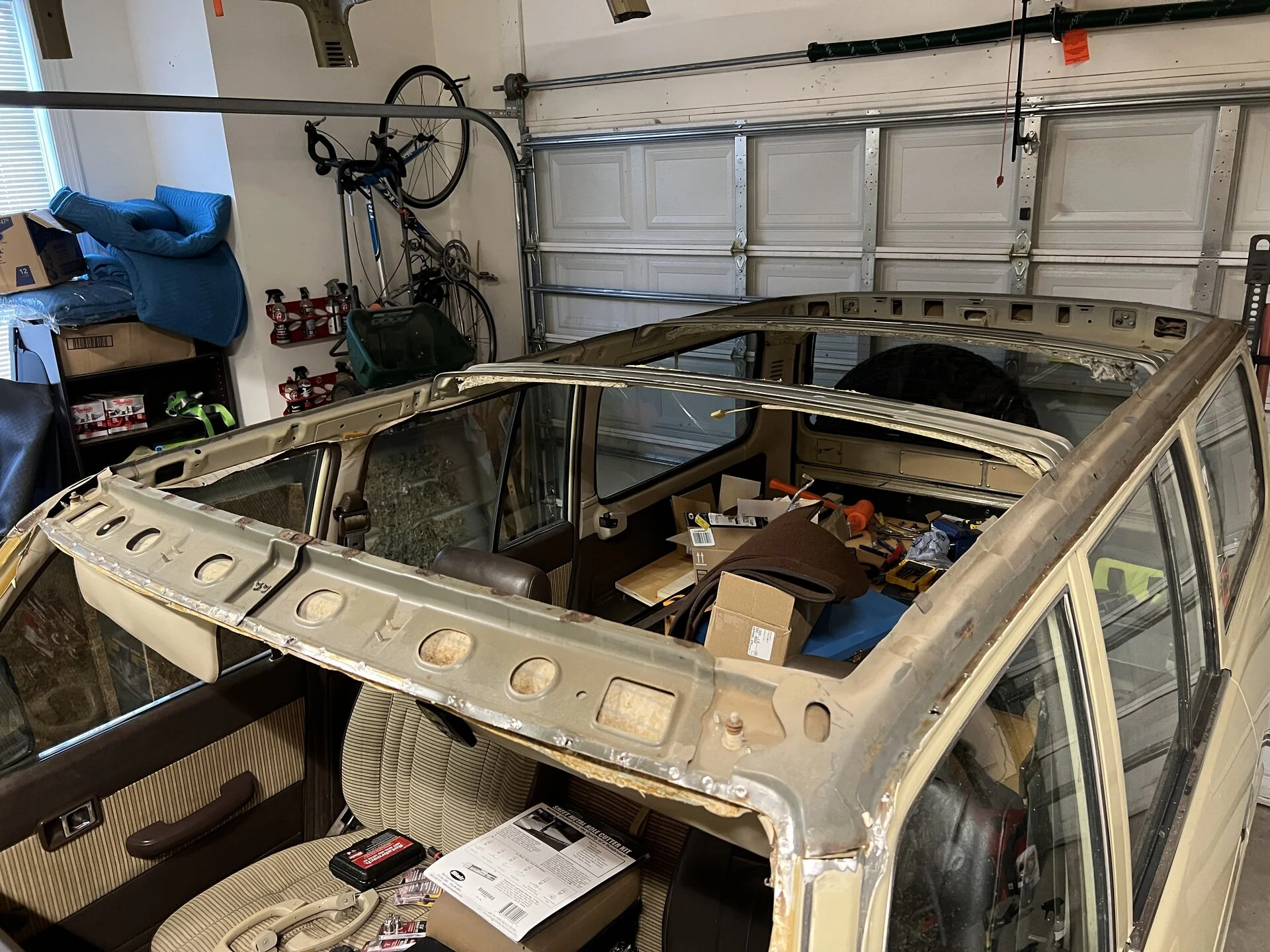

Fall Crawl was the last event of the year so the truck has been sitting in the garage. Well, boredom combined with hanging out in the garage with a flat blade screwdriver one day led me to poke at the roof rust on the truck to see the true state of it. When I bought the truck, I knew it had some roof rust and the bubbles could be seen through the paint. Things got a little out of hand and I opened a can of worms that I knew I wanted to address properly at some point. That point is now. I had picked up a 100% rust free tan roof earlier in 2022 in anticipation of this job and it's been hanging in the ceiling of my garage waiting.
For background...the PO told me that his buddy was a body man and addressed the roof rust a decade ago or so. Come to find out that they never neutralized the rust and basically just bondo'd the rust holes and resprayed the roof. Predictably, the rust returned.

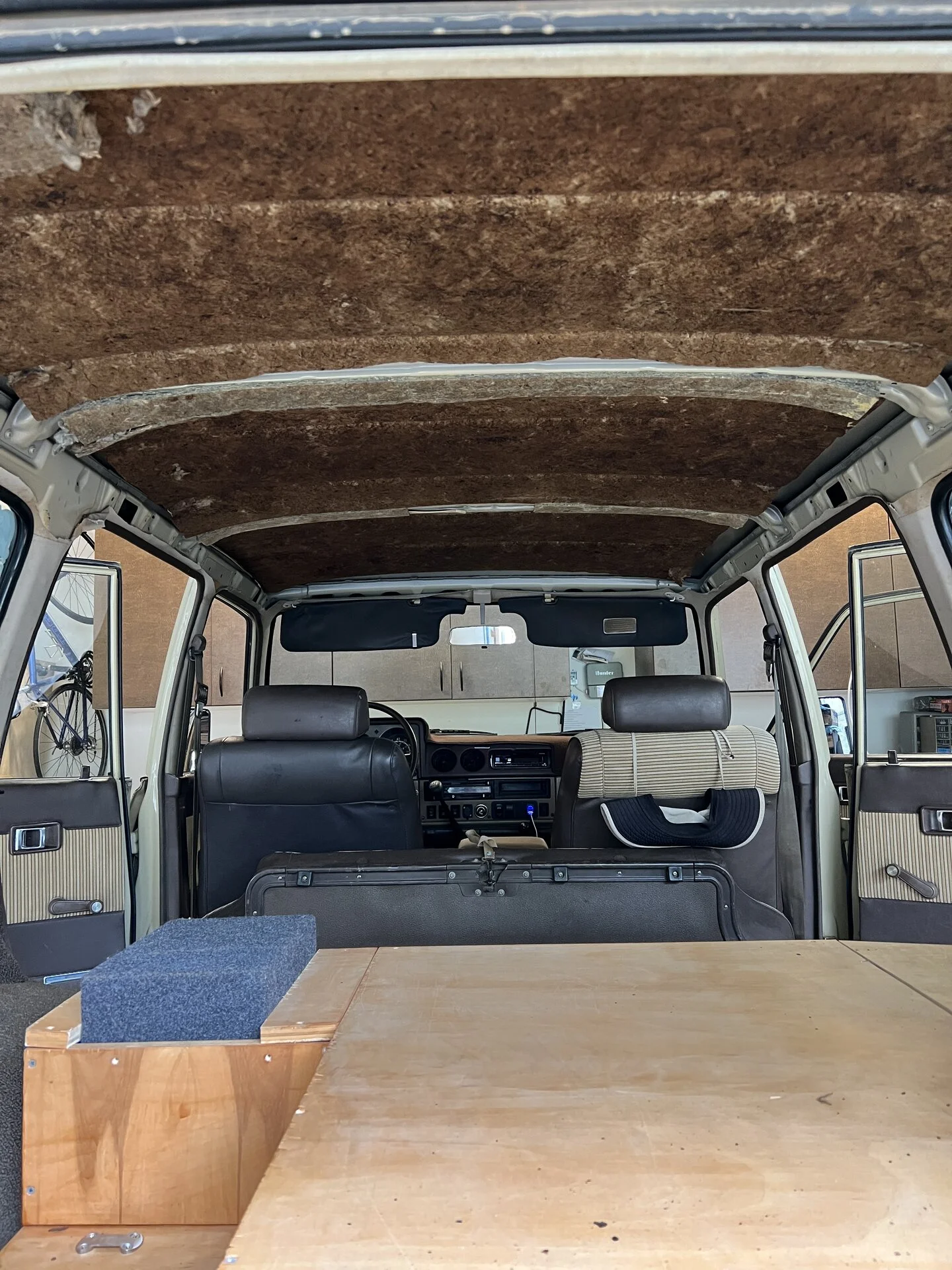

Some pics after poking with the screwdriver and grinding down some of the paint/bondo. The two bad areas are above the passenger rear door where the gutter seam is and along the back above the hatch. I cut out the headliner which will be replaced with a SOR replacement I ordered yesterday and started checking out the interior structure which was in great shape. The inner area above the passenger rear door will need a small patch but otherwise it's in great shape and easily savable. Given this, I consulted with @GLTHFJ60 and we decided that a roof skin swap from my donor roof and some light rust repair on the existing inner structure was the way to go and would address all of the rust.

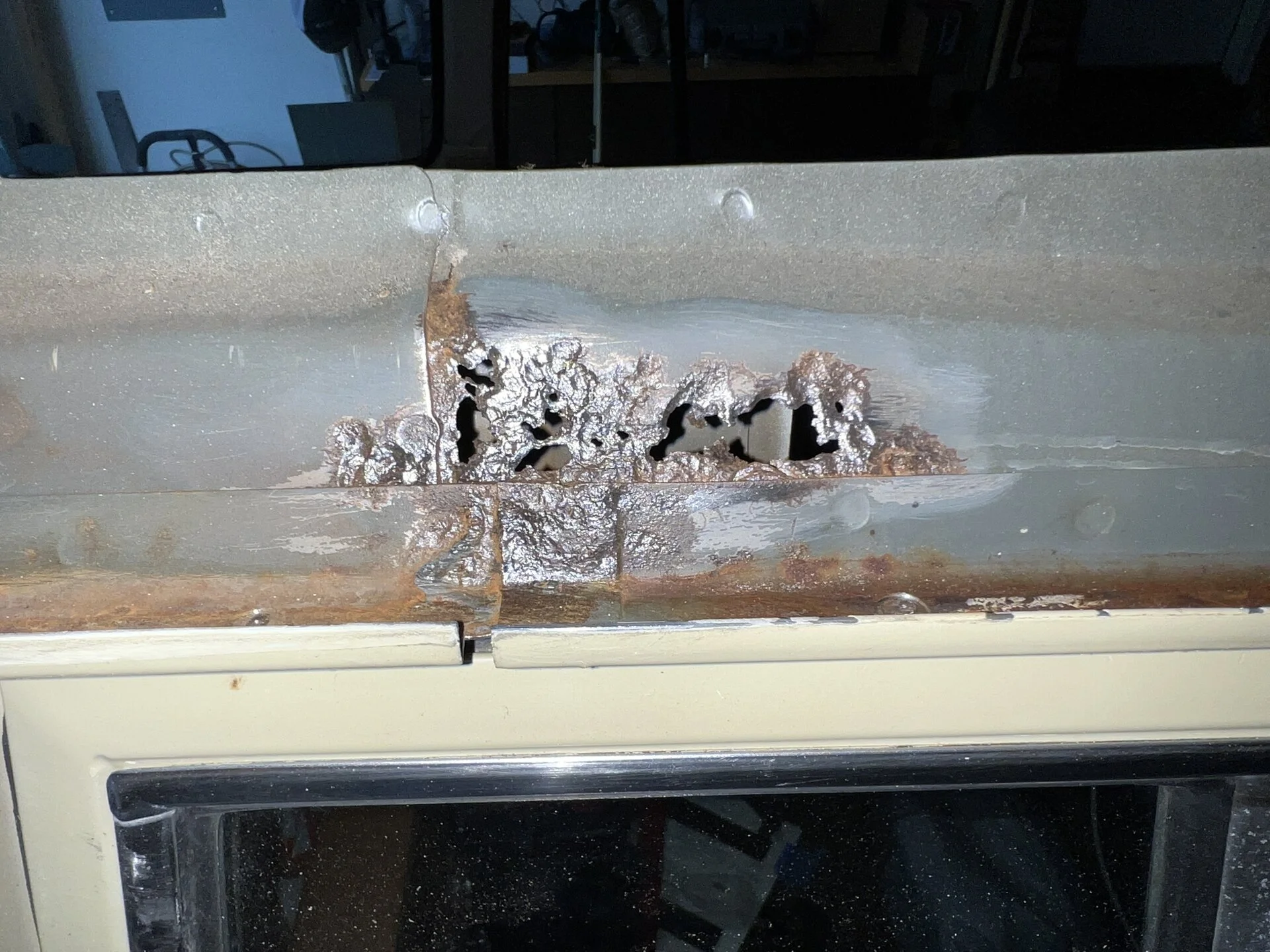

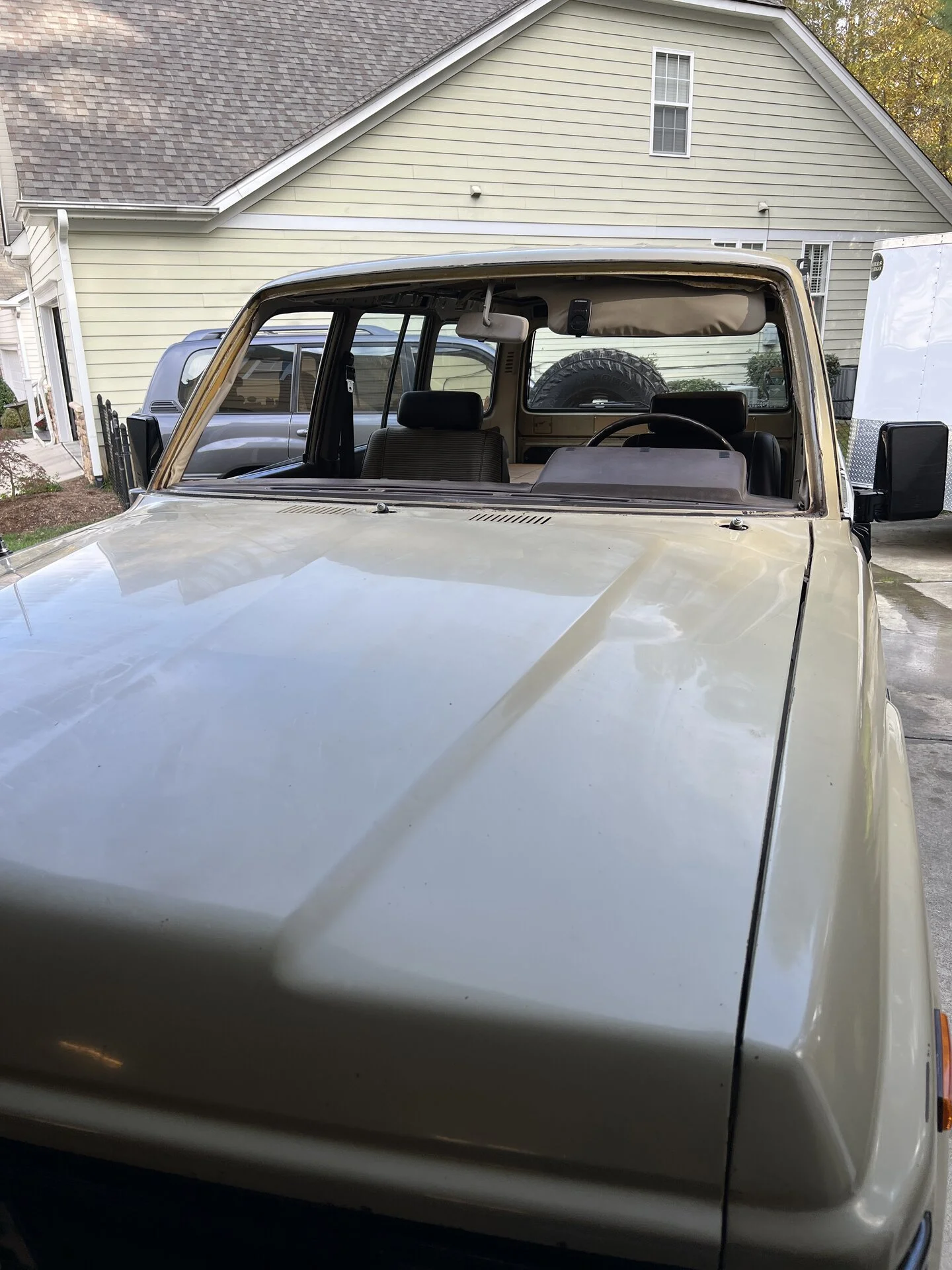

Obviously, next up was to pull the windshield and get the factory roof skin off. I used some rotabroach bits to drill out the spot welds which worked a treat. The skin is spot welded all the way around and then brazed on at the a-pillars. You can see the seam when you remove the windshield. I used a dremel and cutting wheel to address that. I was relieved to see that the windshield channel was relatively clean also.
With the skin off I confirmed that the inner structure was good. There is some surface rust along the area where the roof skin sat on the gutter and a couple other spots which will be easily addressed with a wire wheel.
Next steps are to grind down any surface rust, patch the one spot above the passenger rear door and then neutralize everything. Pic of the hole needing patching below.
Once the rust is neutralized, the donor roof skin will get cut off and welded onto the existing structure. I have ordered some 3M products to reseal the drip rail after all said and done.
I'll keep the thread updated as the project moves along.

Very impressive work! That's the cleanest roof panel swap I've seen!
The only way to correctly repair a roof. Nothing wrong with patching in place but now you know with confidence there’s no other issues. Very nice work and appreciate you documenting it here for all of us.
Agreed. I had briefly considered trying to patch the outer skin but I had a donor roof already and this way I can get eyes on the inner structure to see what the true state of the whole roof is. This way I'll have confidence that the repair is correct and will last a long time going forward.
were you able to remove the old roof skin cleanly enough that it would be possible to patch it and re weld back on, if you didn’t have a donor roof? I would imagine it wouldn’t be that hard off the truck.
Yeah I could have reused the old skin and patched it. My "rust free" donor roof that I bought earlier in 2022 from someone turned out to not be rust free. Looked fine outside but, once I got the skin off, the inside was rusty whereas my factory roof skin looked rusty outside and was good inside. The donor skin is still in better shape than the factory one so I still plan to use it. It would be infinitely easier to patch it off the truck if someone didn't have a donor roof. Plus with the drip rails needing to be refilled on most of these trucks, given relatively low amount of effort it takes to remove the skin, there's no reason not to take it off for any type of roof rust repair. It allows you to check out the inner structure and repair it correctly.
