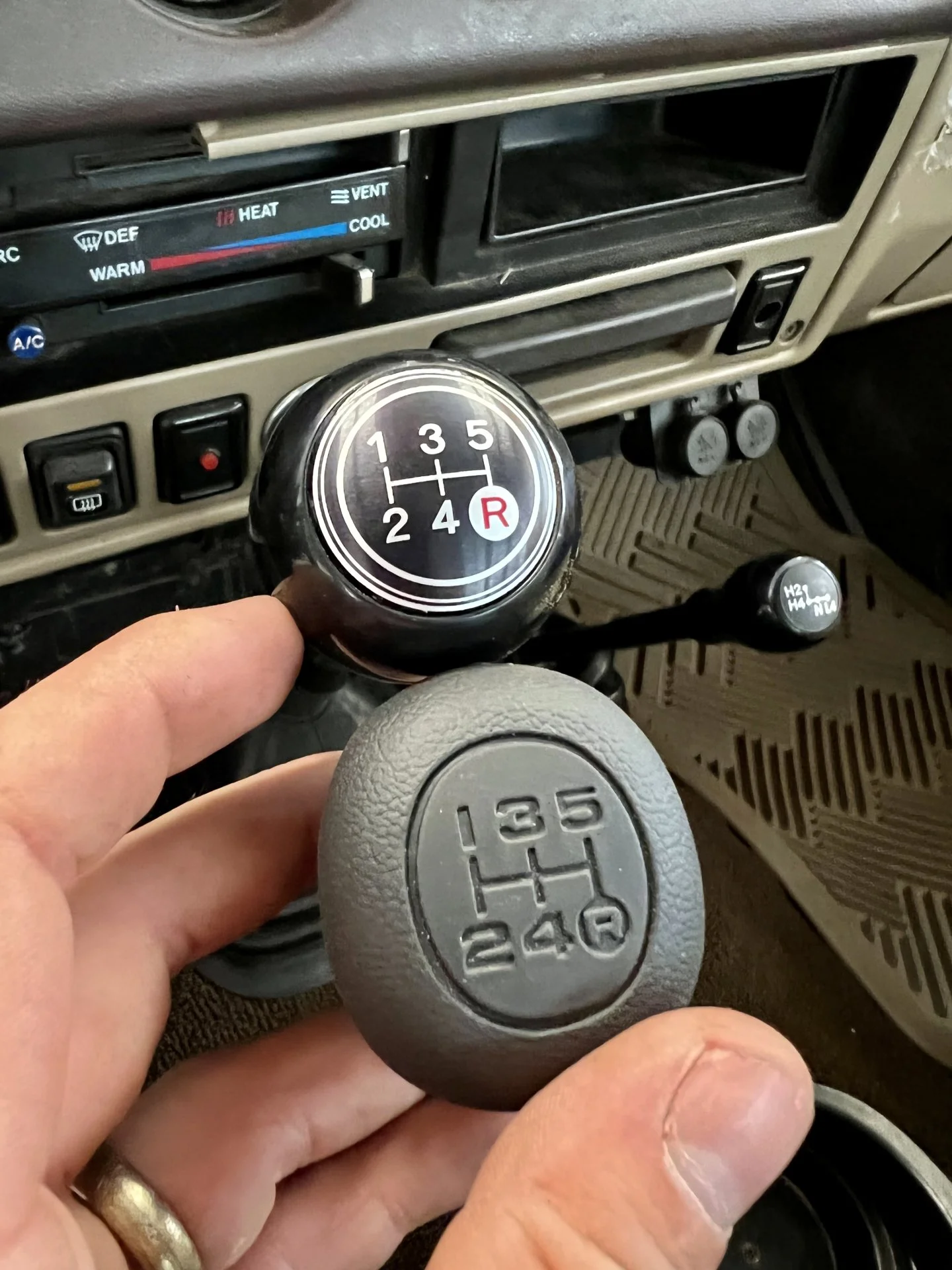

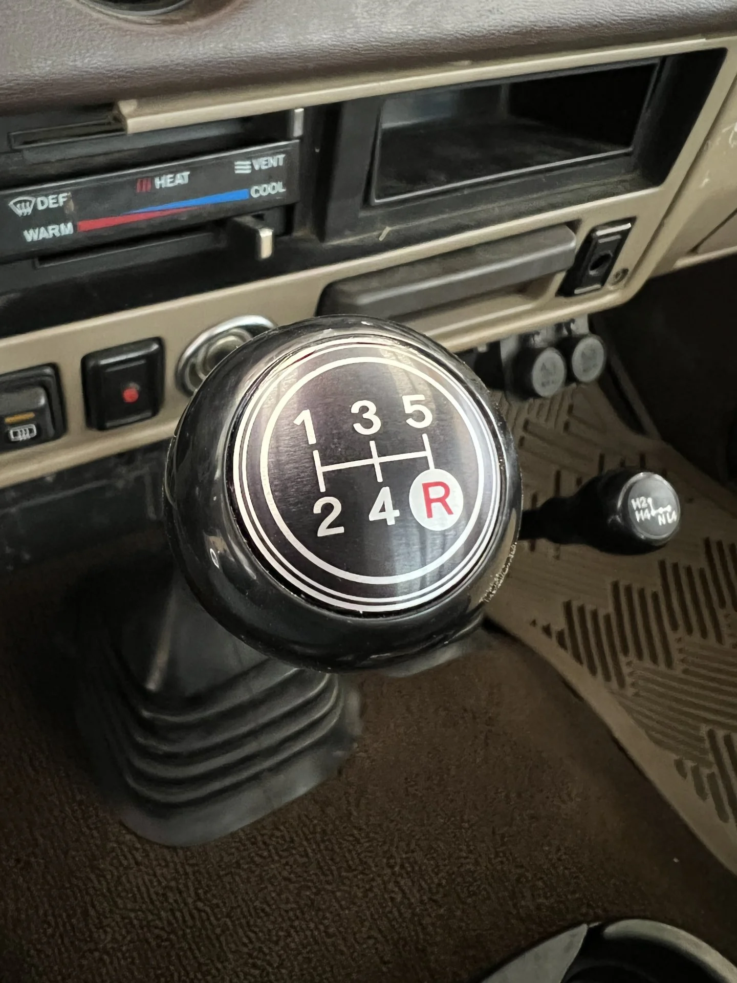

Added the City Racer 5-spd shifter plate to my shift knob and compared it to the stock rubber shift knob. I'll need to drive both to decide which I like better. The shape of the rubber one is similar to the ZHP shift knob I had in my BMW e46 ZHP which I like but the look of the plastic one better.

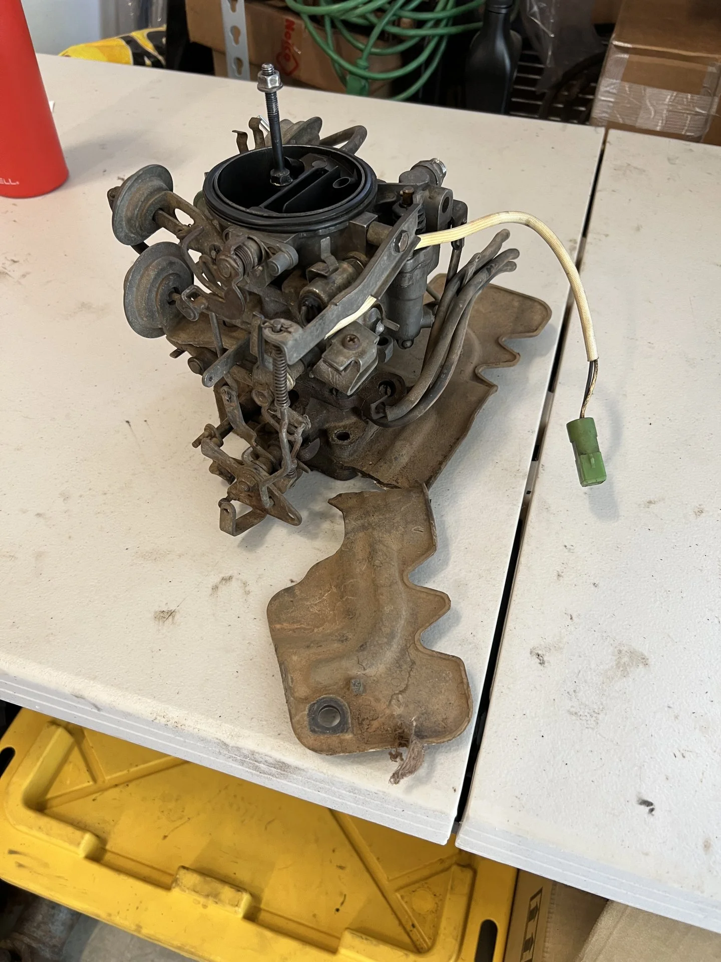

Start of the next project. Desmog and carb rebuild. I had been told that the carb was recently rebuilt but like most items I'm finding, the shop that did the work did not really do it correctly or well.
This is also a chance to fix the carb insulator gasket that had a big vaccum leak below the carb. I have a new insulator and plate on hand.
Blew the carb apart and the 2nd main jet was completely buggered so I still need to try and extract it maybe with a bolt extractor and the choke shaft needs to be replaced. I found a replacement shaft and got it ordered. That will give me time to work on the desmog while I wait for parts.

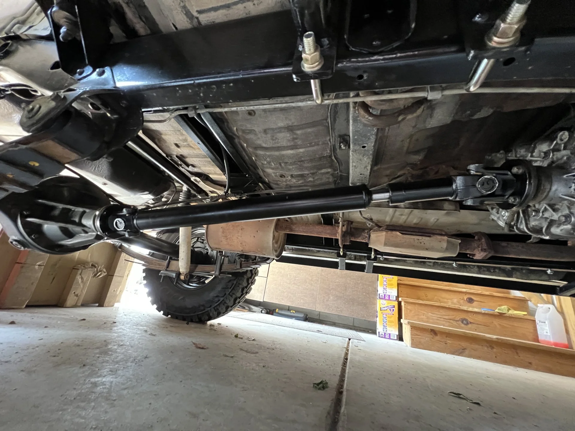

Driveshafts are here and installed from Tom Woods. Went with a double cardan up front to help clear the crossmember and it clears with room to spare.

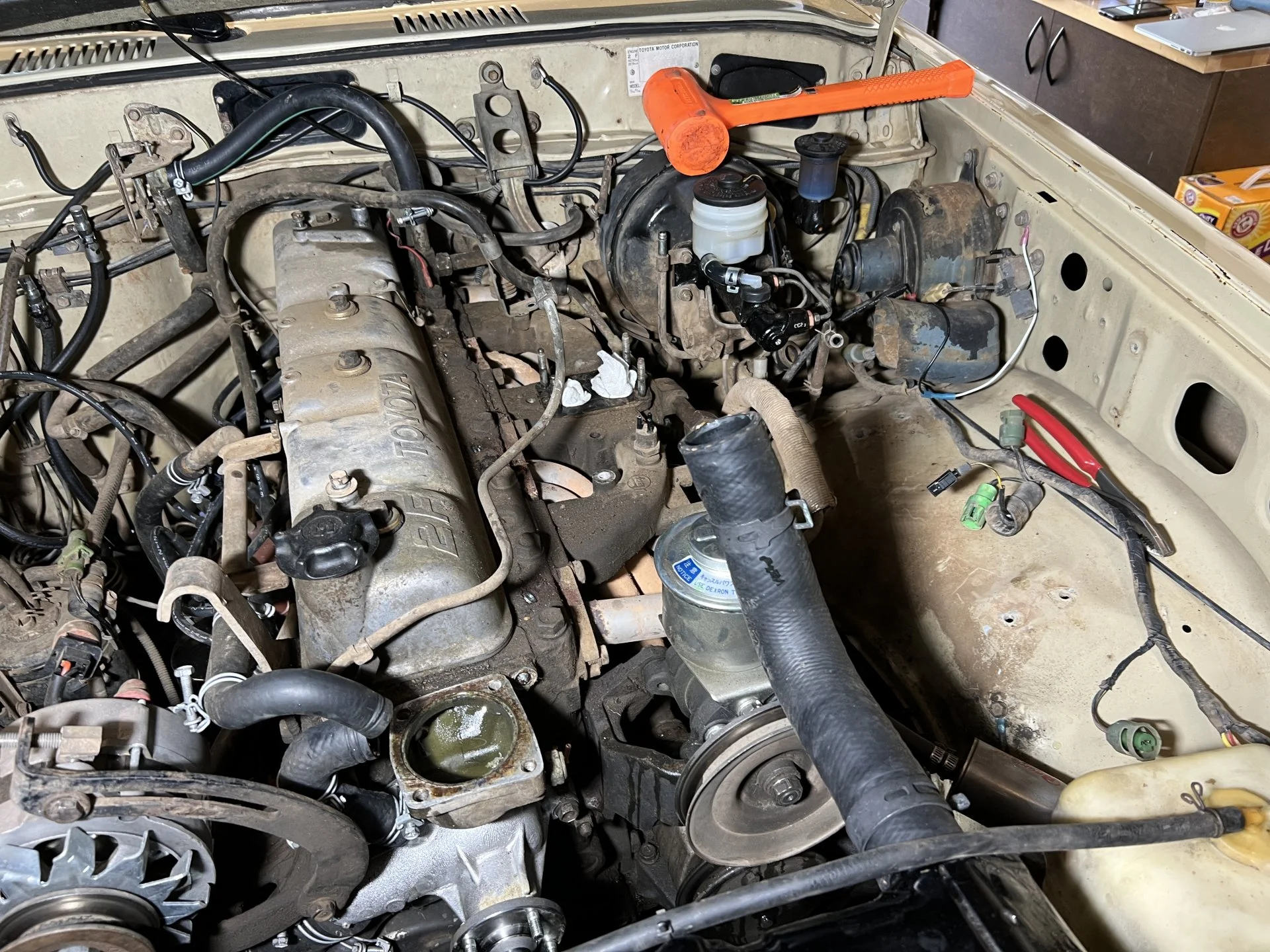

Got her back together after some family time this past week. Now I'm chasing coolant leaks from the new hoses, some causing small puddles on the ground but only after/while driving. Seems to be some leakage from the WP after torquing it to spec and some from the various oil cooler lines. The clamps are almost maxed out so I will have to look into that further this week. New hood liner is looking fresh!

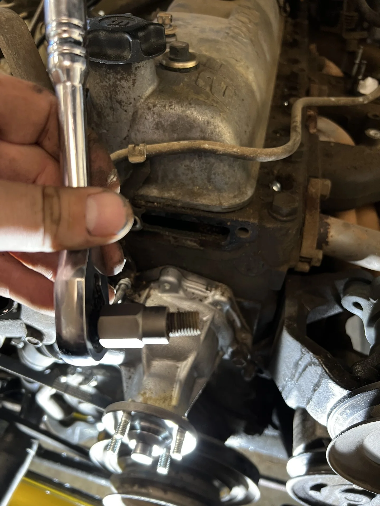

It's motorcycle track season now (my main hobby) so the truck isn't getting as much attention as usual but started on the desmog. Was going swimmingly until one of the lower thermostat bolts decided not to play nice. Ended up partially draining the cooling system and removing the thermostat housing. New lower ordered and a new BVSV (1) since the factory one was nonexistent. I noted this during my cooling system replacement earlier this year but didn't find a lower housing in stock at the time to replace. Got one ordered from City Racer.

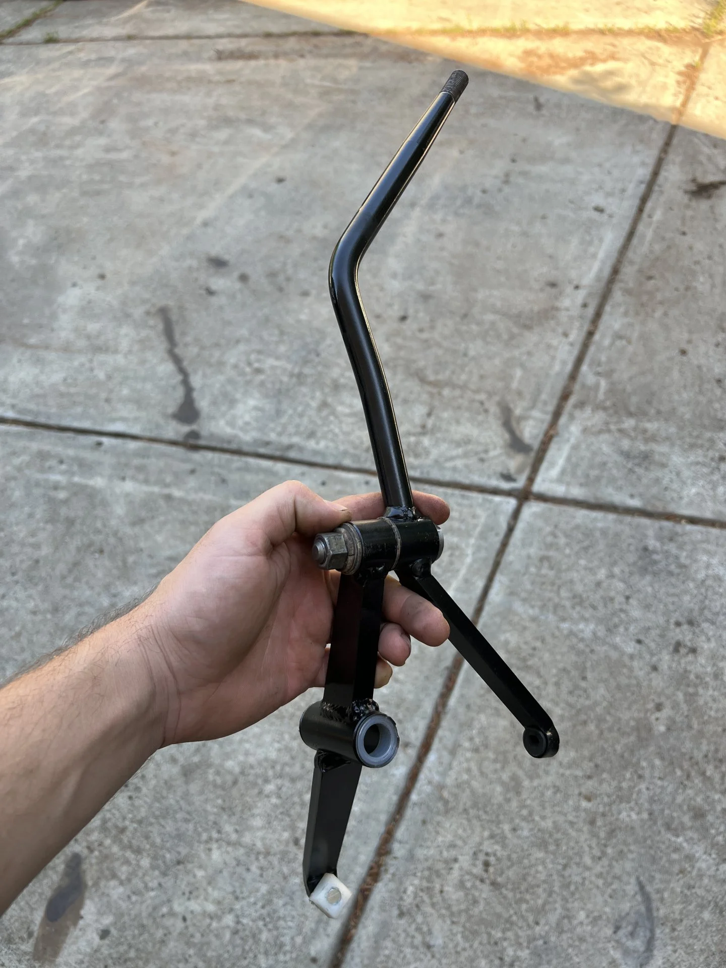

H55 feels smooth and silky. However, I need to bend or modify the shifter as it is WAYY to close to my leg in 1st and 2nd and I want it a bit further away. Will report back once I get more miles on it.

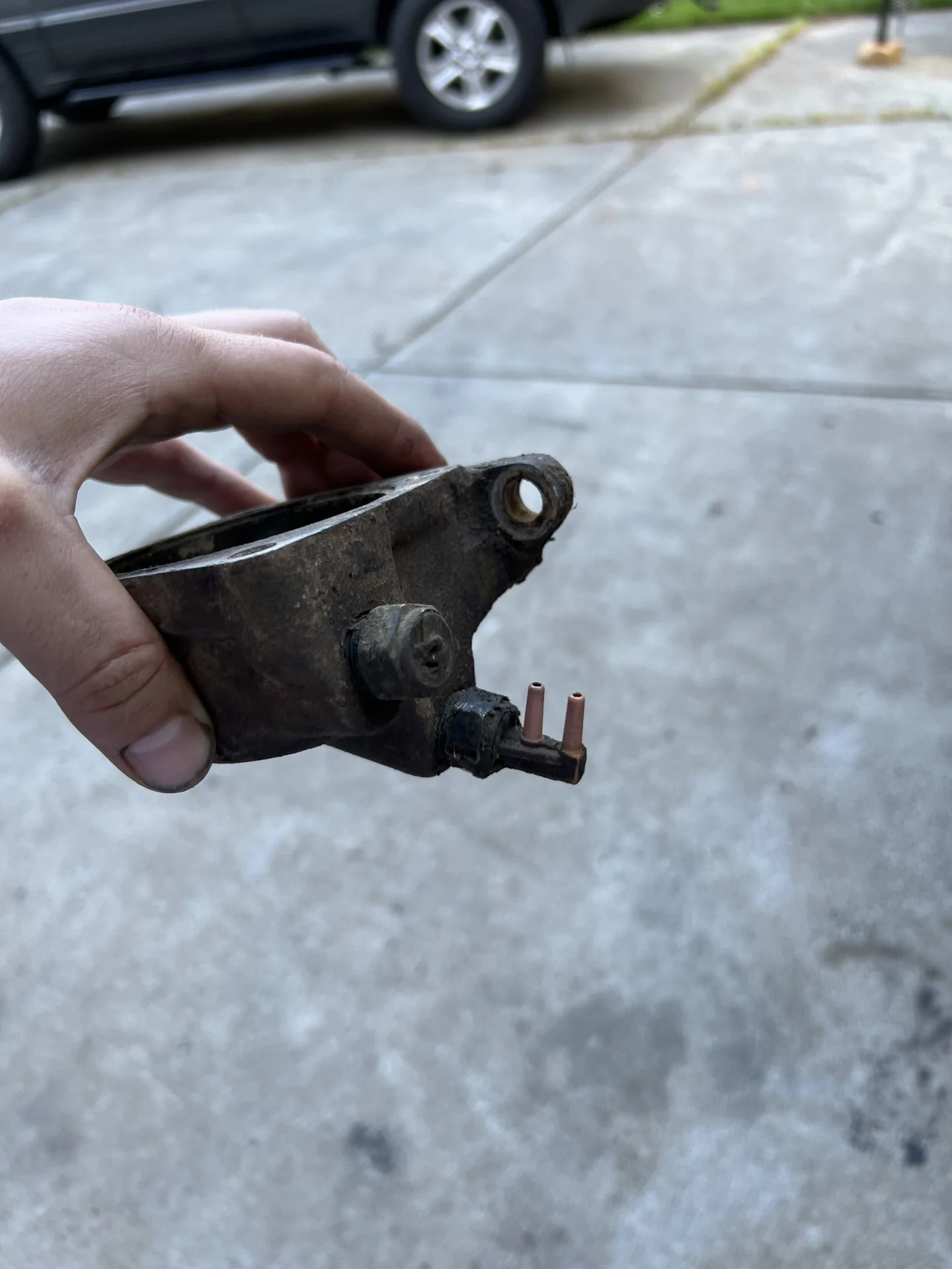

I also discovered why the truck was having idling issues and an air leak below the carb. Took the insulator off and went to clean the mounting face on the manifold before installing the new insulator and found silicone all over it :bang: :censor:
Scraped all of the silicone off and good as new. I imagine my issue was that a piece of the silicone that was covering a failed gasket let go and now the air path was unsealed and letting air in below the carb. Frustrating to find silicone yet again but it's properly fixed and ready to go now!
