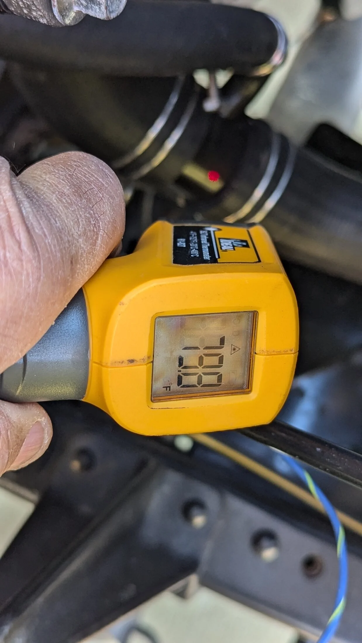

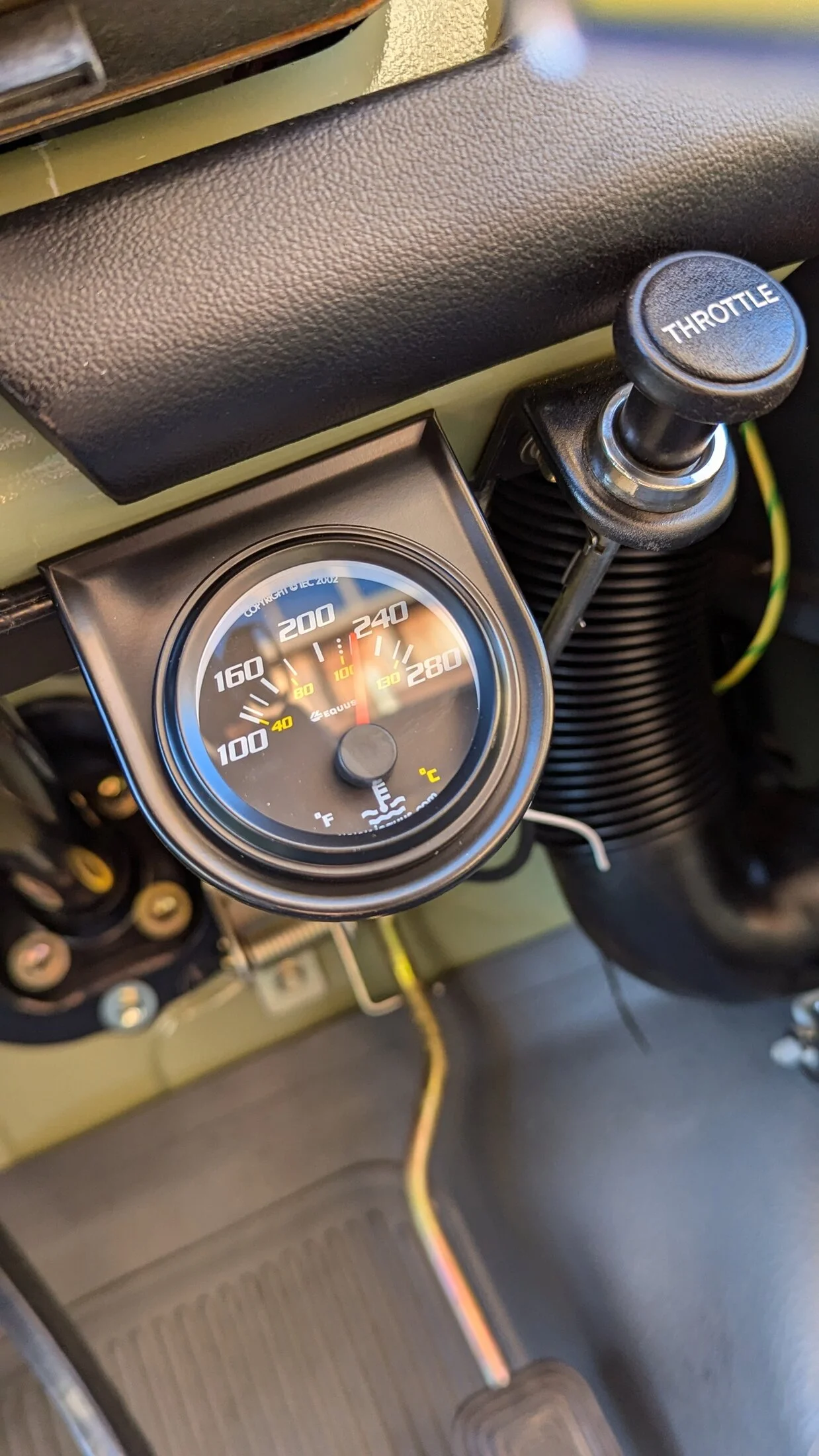

My 1980 fj40 seems to be running hot!!! Dash gauge shows hot so I replaced the thermostat with a new OEM from Toyota with no change. Added a under dash temp gauge wire into the temp sending unit with ZERO improvement!!! Took a reading with a infrared gun and the lower hose reads about 80°f and upper about 130°f.

The infrared sensor seems difficult to interpret, at best.
Which temp sending unit did you use and where is it mounted to the engine?
When I installed my Dakota Digital dash I broke the adapter for the sending unit they sent so I used a sender that I had (same style). It was reading about 30 degrees low and one of the guys here on MUD caught it in a photo I had attached. It had been about 3 months between when I had installed it and when the engine was first started. I had forgotten about it.
My point is that the temperature sensor has to match the gauge or display as stated above.

I didn’t read all your details, but I may have had a similar problem. I have a newly rebuilt FJ60 engine and head (Thanks FJ40Jim!). This was installed in my ‘76 FJ40 this fall ‘24. The FJ60 OE temp sender (top rear driver side cylinder head) was reused during the rebuild. FJ40 factory gauge was reading abnormally HOT and didn’t seem right. I ended up pulling the old sender from my original FJ40 head and swapped it onto the new FJ60 head. Works great. I never researched whether or not this is a sender/guage incompatibility from the 40 to the 60 series, but this may be the case. Whatever your setup is, try a different sender before you start digging too deep.

I'm still thinking that 220F isn't that hot, based on a few web searches.
That's next. Thanks for that info. The gauge I bought for under dash came with a sensor to install in the head. I didn't swap it yet hoping it was just the 40s temp gauge.
