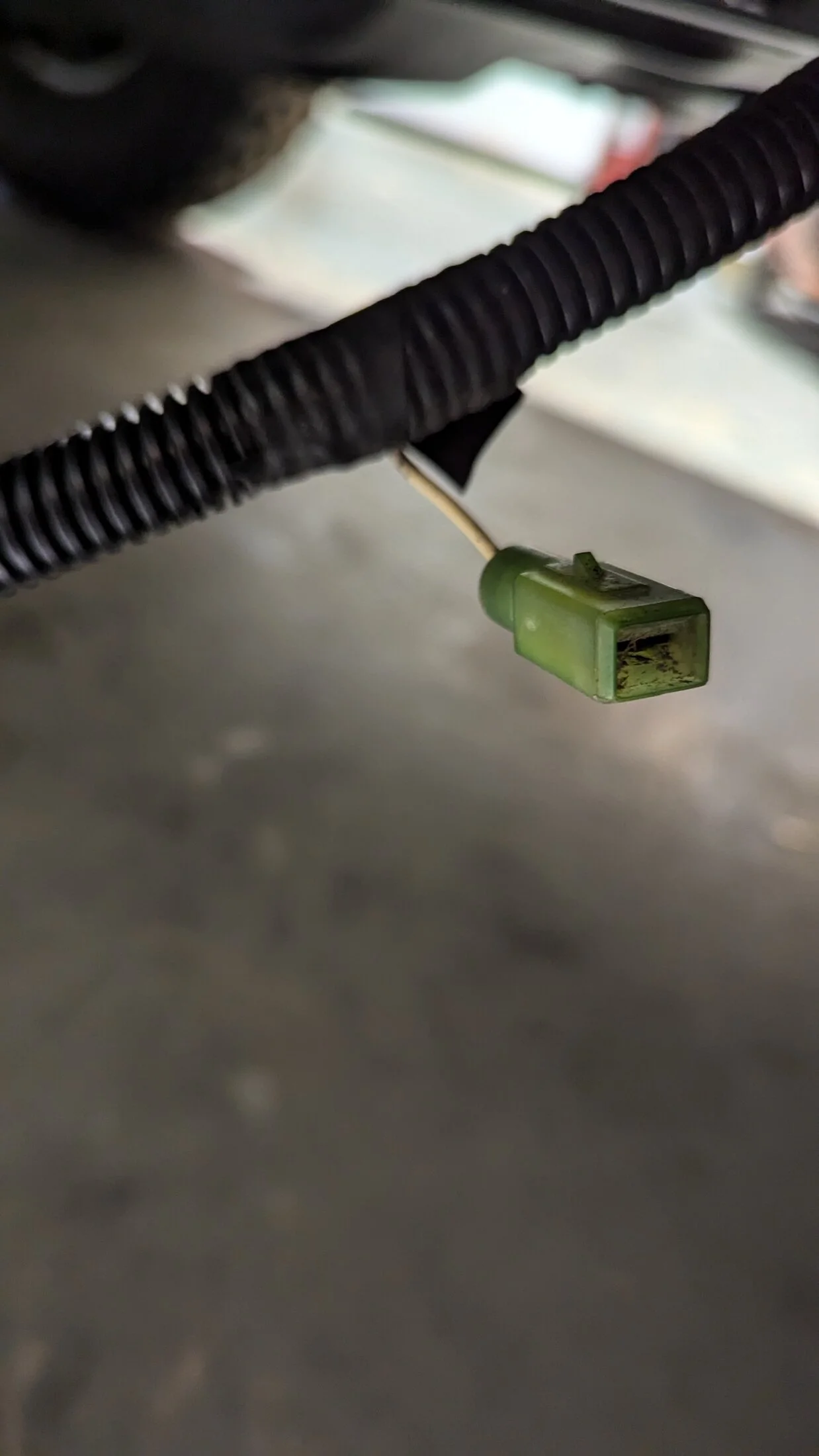

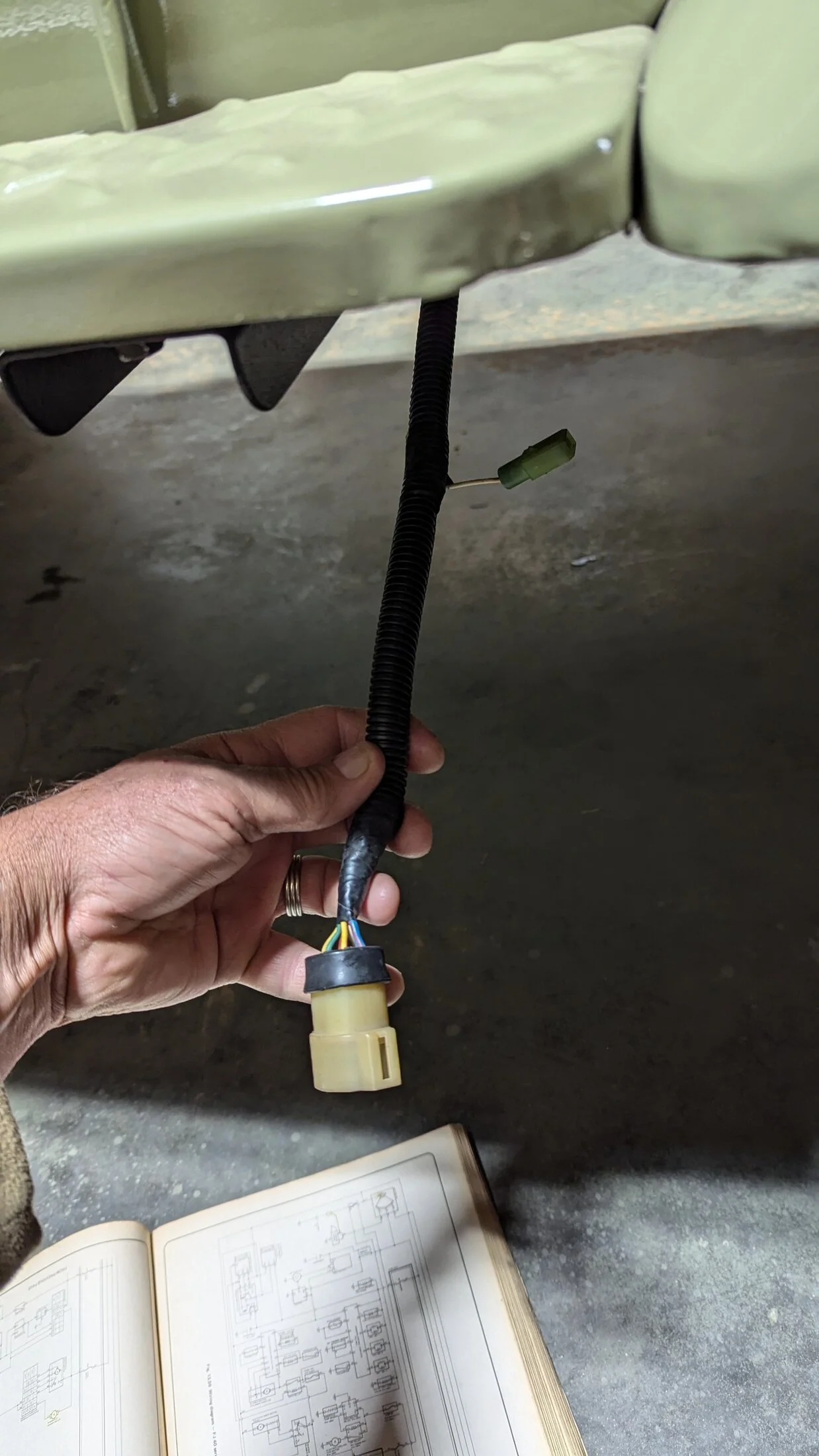

I'm still chasing electrical issues ! No blinkers or flashers, reverse lights or heater blower front or rear. But what does this go to on the wiring harness! 1981 40 . It's the single white wire sticking out of the rear harness
Fixed the blinkers and flashers!! Was the switch contacts all gummed up. Works like a champ now. Found the front heater problem, resistor on blower cracked on one side of bracket. Need to find a new one. Tested blower and works fine. Rear heater the an works when hot wire but not through dash switch.
