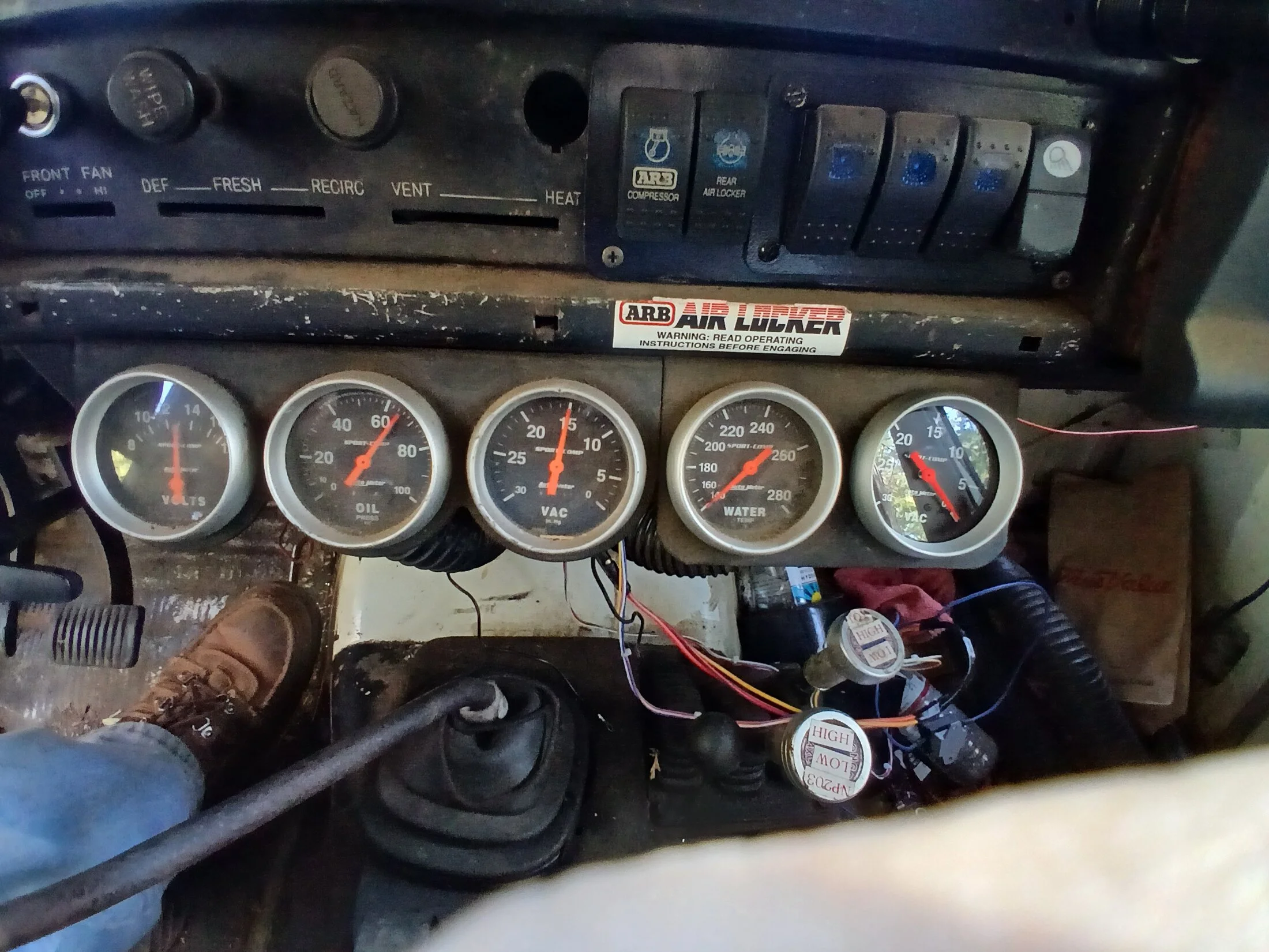

The gauge I bought for under dash came with a sensor to install in the head. I didn't swap it yet hoping it was just the 40s temp gauge.
Traditionally, you need to match your gauge and sender. I think you need to get an accurate engine temp before you do anything expensive.
How do I get an accurate temp of not by use of the two different gauges ive used ?

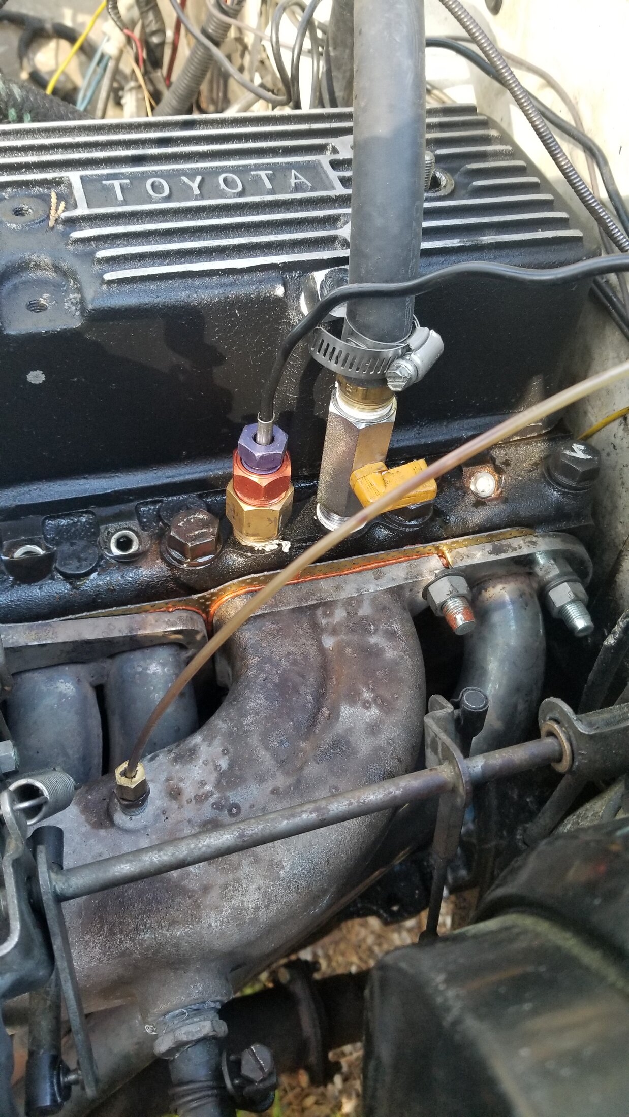

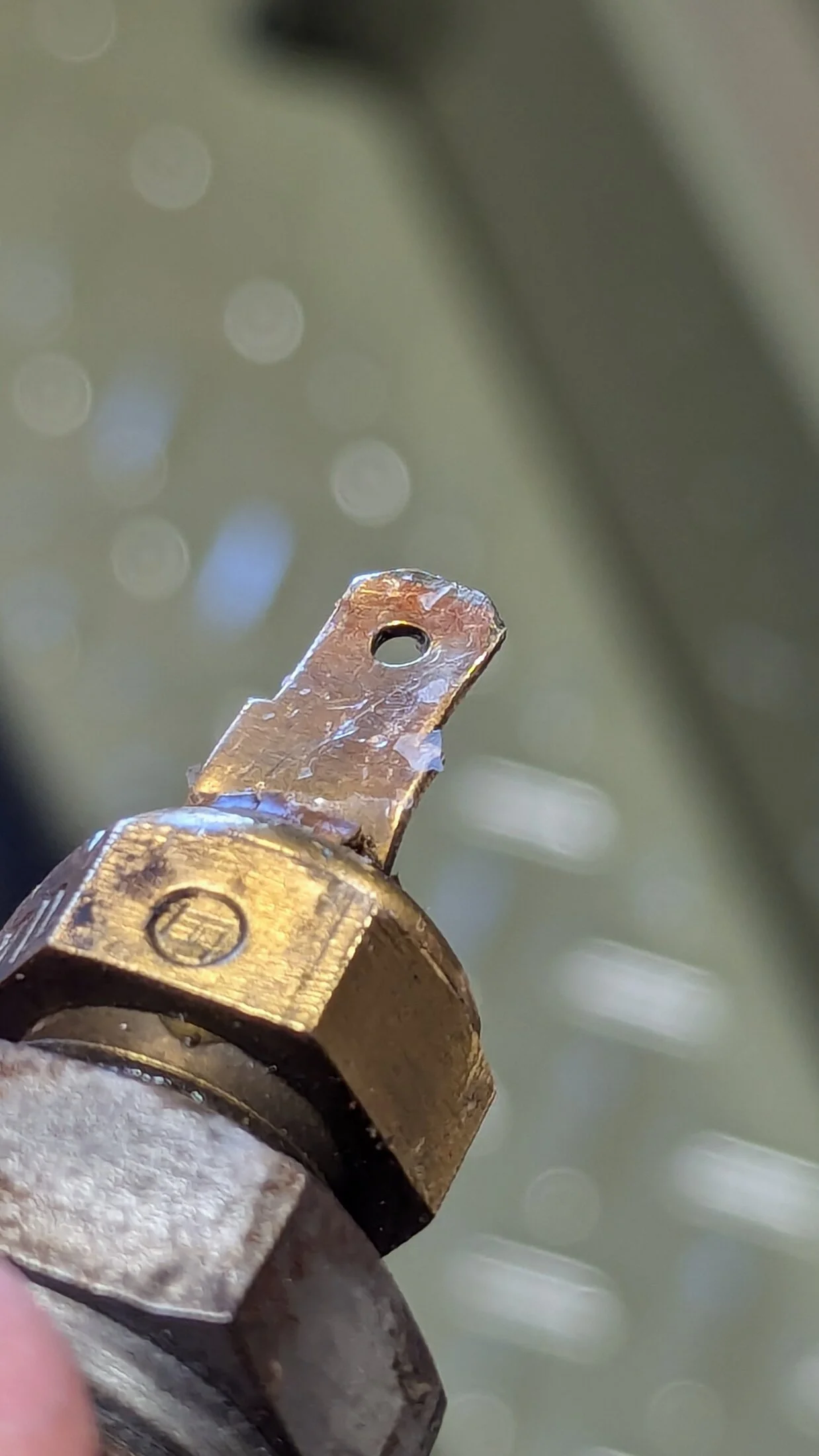

So I pulled the OEM sender out and replaced it with the one that came with the under dash gauge I bought from O'Reilly's. Temp went up to about 190° on new gauge and stayed pretty steady. This is all while setting parked on an incline with a radiator fill/bubbler installed working the bubbles out. Seems to be good. Noticed that the OEM sending unit had what looks like a clear coat on it!! So that would not be a good connection. It was flaking off when I removed the wire. Also, not sure what these numbers on the side represent.
Did you answer your own question here? After you hooked the correct (matched) sender to your aftermarket gauge you get a more reasonable, and, theoretically more accurate, reading.
You might have had two temp senders on the top rear of your cylinder head, one for the dash gauge and one for the emissions control. they each put out different amounts of whatever it is that they put out (I don't know much about electricity). The markings on the sender might tell you what that sender was sending if you could read that code. Figure out which sender does what and you can run your stock temp gauge and your new temp gauge. That's what I do.

There might be a couple other places to install a water temp sender. Are you still using your stock emissions "computer"? Are you running an oil cooler?
OK, I have heard (or read) about a bit of pipe, or tubing, with a threaded bung, that fits inside one of your larger coolant lines and takes the place of a couple inches of coolant line that you can thread an aftermarket sender into. I've not had to use one, perhaps search the 60 tech section.
I didn’t read all your details, but I may have had a similar problem. I have a newly rebuilt FJ60 engine and head (Thanks FJ40Jim!). This was installed in my ‘76 FJ40 this fall ‘24. The FJ60 OE temp sender (top rear driver side cylinder head) was reused during the rebuild. FJ40 factory gauge was reading abnormally HOT and didn’t seem right. I ended up pulling the old sender from my original FJ40 head and swapped it onto the new FJ60 head. Works great. I never researched whether or not this is a sender/guage incompatibility from the 40 to the 60 series, but this may be the case. Whatever your setup is, try a different sender before you start digging too deep.
This is similar to my temp gage - the earlier gages from early fj40s (mine is a 1964) do not play well with the sendors from the 2f engines. I found that out when I swaped in a 2f in my fj40.
I believe that you're correct. Same thing here. I had the 60 sender going to my 40 gauge and it showed hot. Added an under dash gauge and plugged it into the 60 sender and it showed hot! Removed the 60 sender and replaced with the sender from under dash gauge kit and it shows just right. I plan on finding an fj40 sender for my 1980 40 to install and keep my original gauge working as well as using the extra gauge as a back up under dash once i figure out where to install the sender. I don't like deviating from the original oem but an extra temp gauge can only help!
