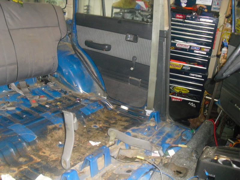

FINALLY got around to start mocking up my th400, 203/205 stuff. Originally I was going to run the th350 and the floor wasnt a problem but with the extra length of the 400 and because I wanted to tuck the drivetrain up as high as I could the floor needed modification... it was inevitable. Especially when you have Boots and Dirtgypsy egging you on!
Hanging too low:
going up:
Floor in the way:
And presto... drivetrain tucked nicely:

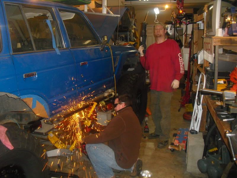

and then for just sh*ts and giggles (and because my first attempts at welding/slider project needed to go) we raced to see what was faster to cut metal.
Angle grinder vs. sawzall (I'm the ugly dude in red without any eye protection...oops)
I won:

Are you done yet? If you need some more cutting I have no problems coming in second with the angle grinder some more!
Clint

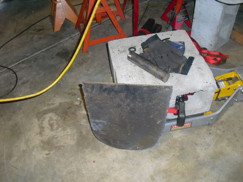

Bent the first hoop:
then made a template from that:
I'm not going to lie... having a plasma sure is nice:
fits pretty darn well:

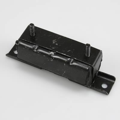

Are you going to cut out part of the tube and make it flat for the round mounts to rest on? I guess you could weld some c-channel pieces onto the tube to give you a flat surface (so that the tube fits into the channel).
I'm thinking that I'll mount the pancake mount between the flat plate you see in the pics and adapter (plate being on top of tube for flat surface) and then mount another pancake rubber mount below the plate with a large washer between the bolt head and rubber.
THEN below that I'll skin the the bottom of the tube with some of the plastic cutting board stuff I have or some more plate.
I'm still coming up with the plan to support the 205 but have some good ideas.
