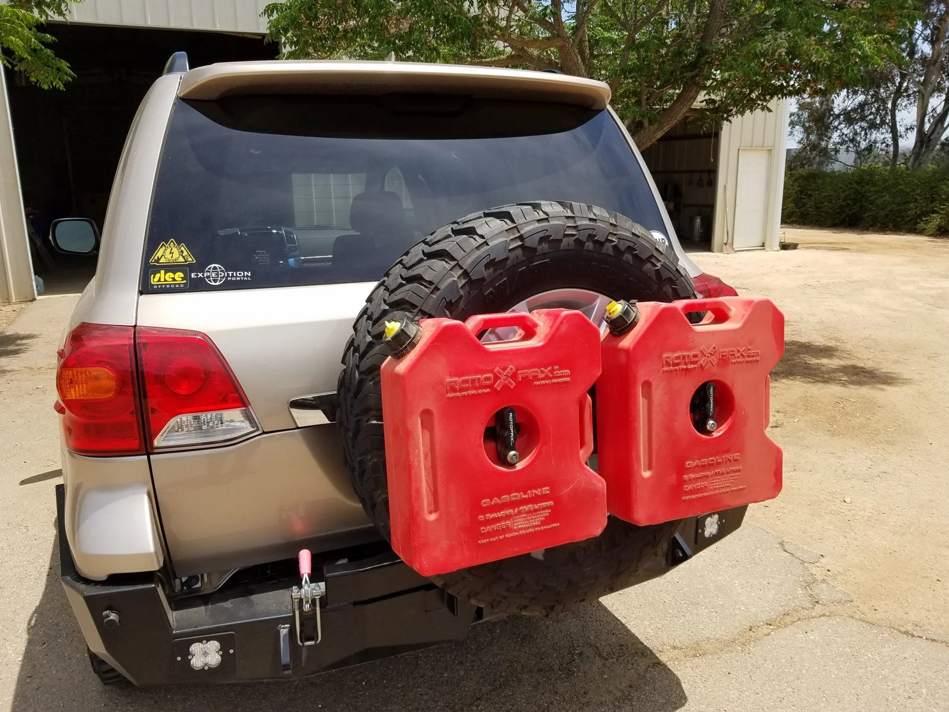

I can stack another 3 gal on each of these for a total of 12 gals.

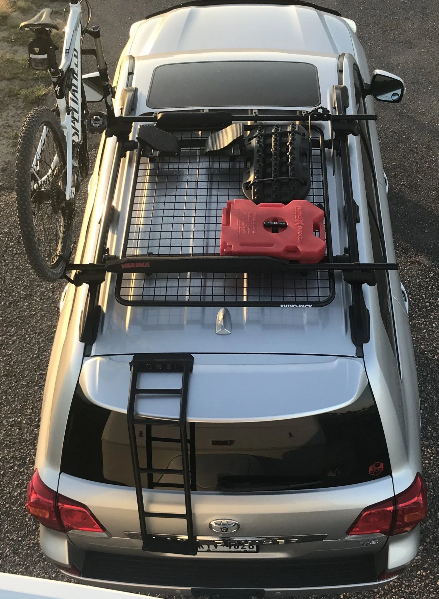

RotoPax leaked gasoline riding on rooftop. It looks like I blew the gasket so gasoline leaked and discolored a small rooftop section. Granted going from Austin to Yellowstone there are elevation changes, but maybe rooftop isn’t a great place for an extra can...
Seems like something must have been a problem with the capping...because properly capped, there should be zero leak. Not even air or pressurized vapor. Air pressure leaks more easily than liquid, and mine were absolutely air tight even with massive elevation changes (like when I forgot to periodically equalize...went from sea level to over 13,000 feet...no leak). I would check that cap gasket or even just check for an iffy thread tightening. ?
