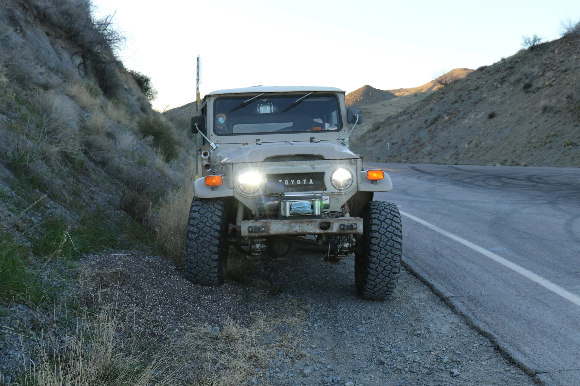

Made it back to civilization.

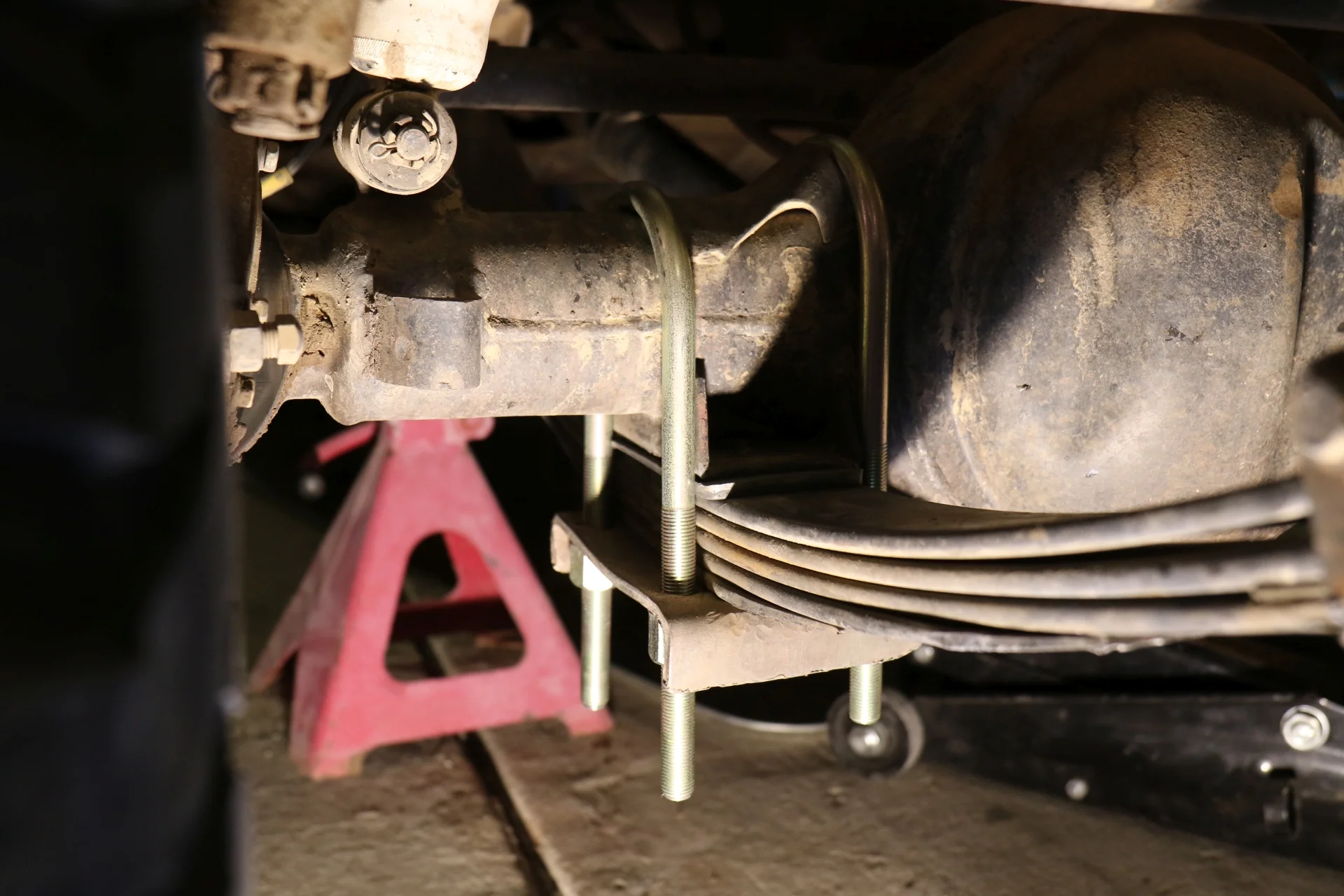

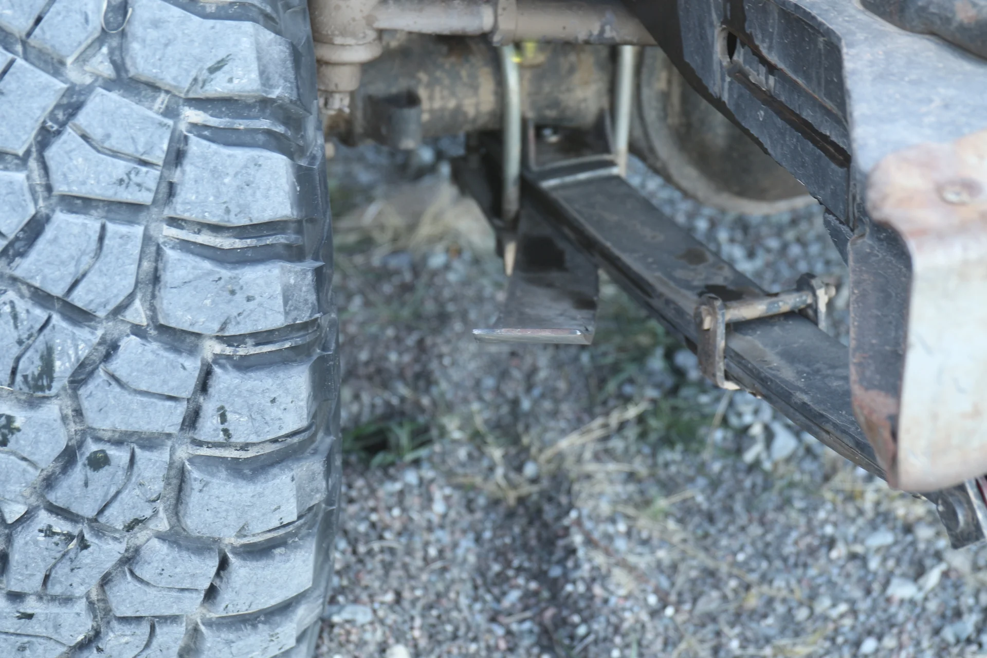

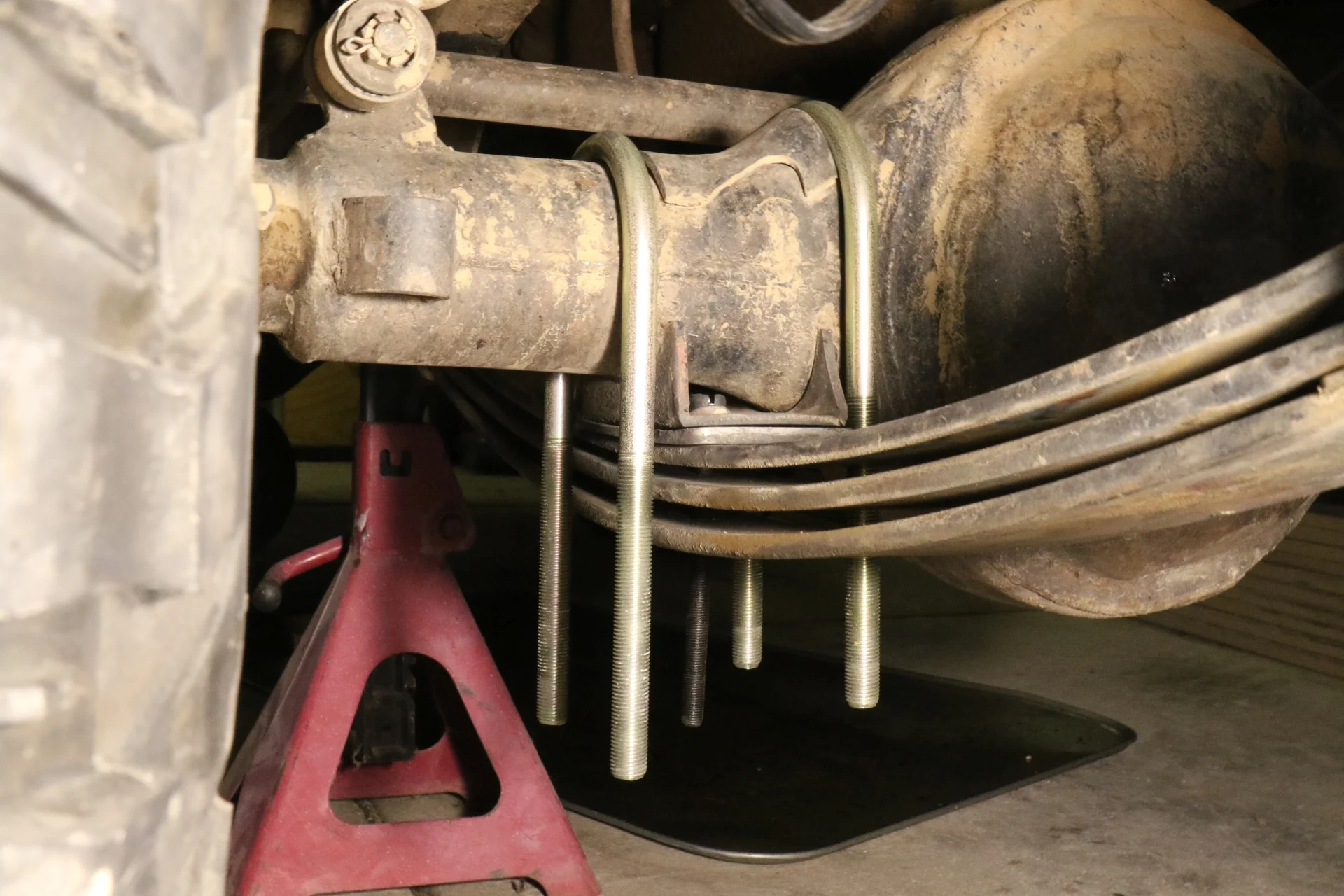

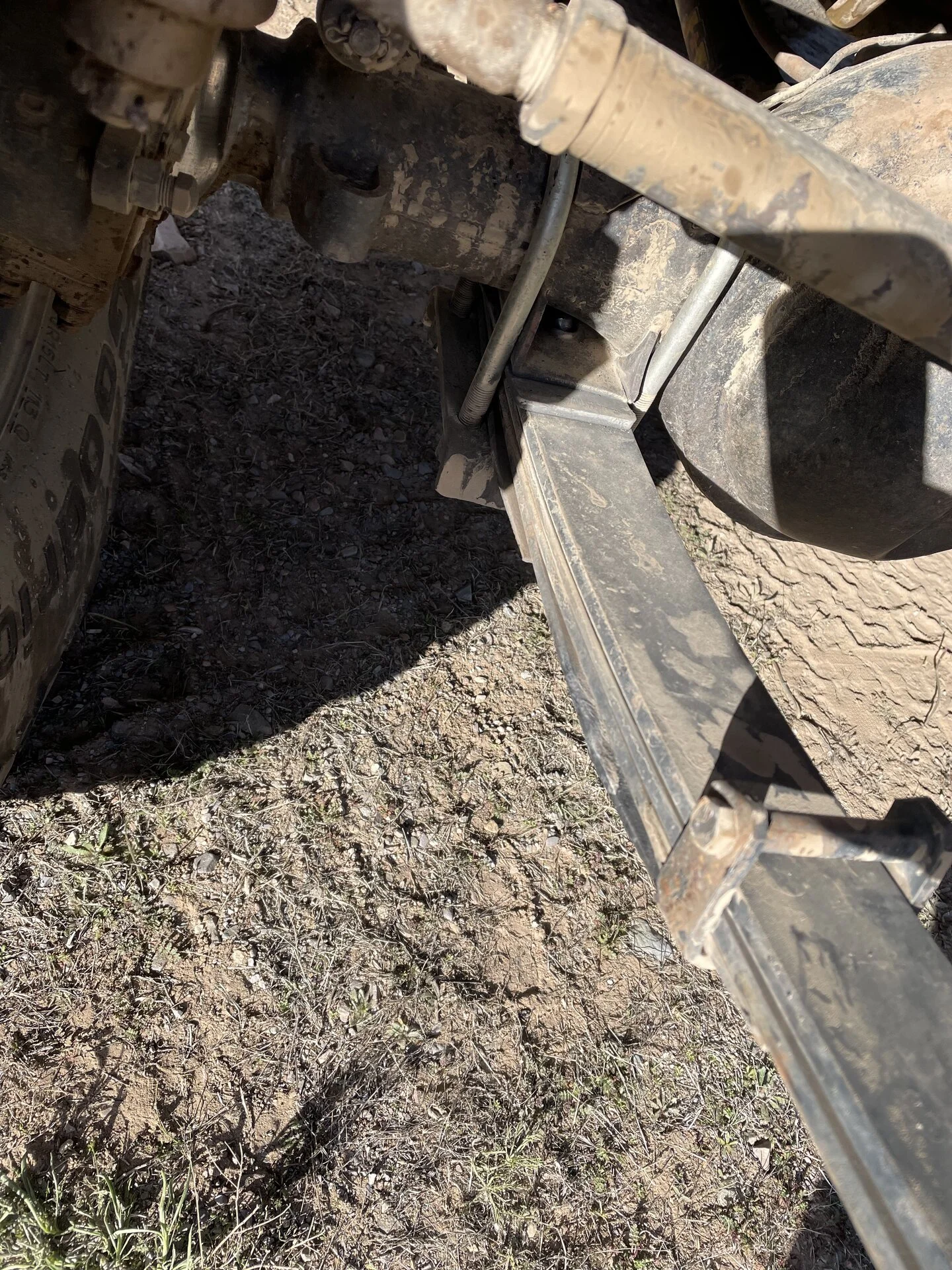

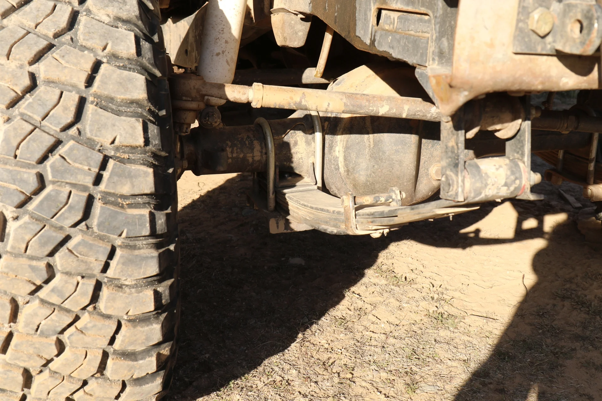

Jacked the cruiser up, loosened the u-bolts and hammered the leaf back in place. Took all of fifteen minutes.
Got a locating pin from oriellys to put on when I get home.
Thanks for organizing the run @brices123 :cheers:
I went to four different stores & a Big-O tire looking for a centering pin and bought a few 5/16th grade 8 bolts just in case I couldn't get one.
O'Reilly's didn;t hve the 5/16th pin that came with my leaf springs but had the next size up a 7/16th. Turns out that was the correct size and Skyjacker sent me undersized pins. I'm debating taking the other front apart and putting in the correct size.
Got the leaf spring back together with new u-bolts. I just have to roll it outside to cut off the extra length and I'll be roadworthy again.

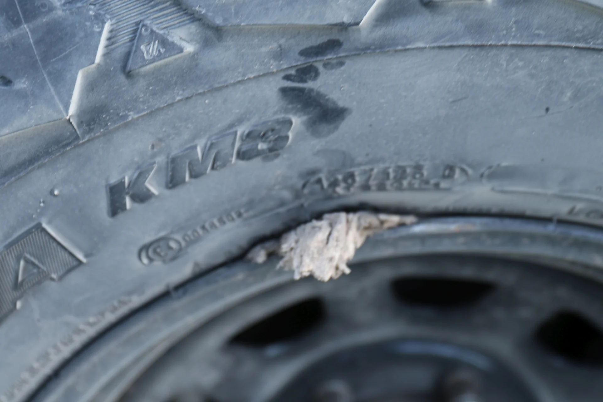

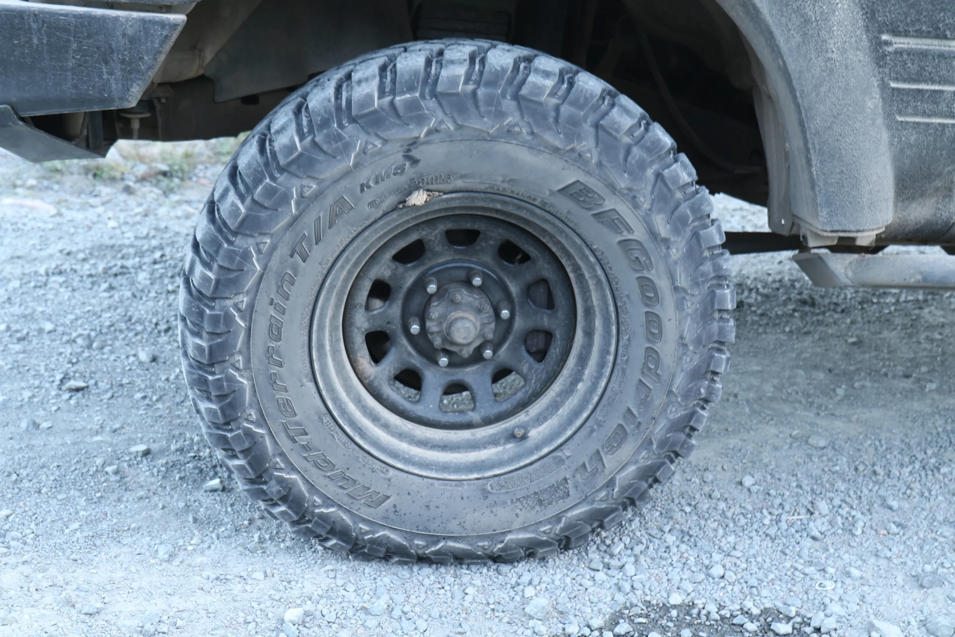

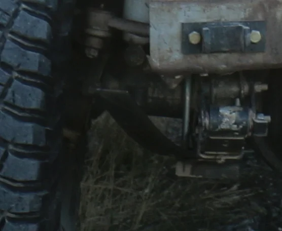

Roadside inspection of the tire rubbing I was getting making left hand turns
That doesn't look good
Sunday morning quicky trail repair
Getting all the pieces lined up
Done! (almost) just need to cut off the extra length
Top is the 7/16th pin I got from O'Reilly's, middle is what is left of the 5/16th pin, bottom is a 5/16th bolt for comparison
