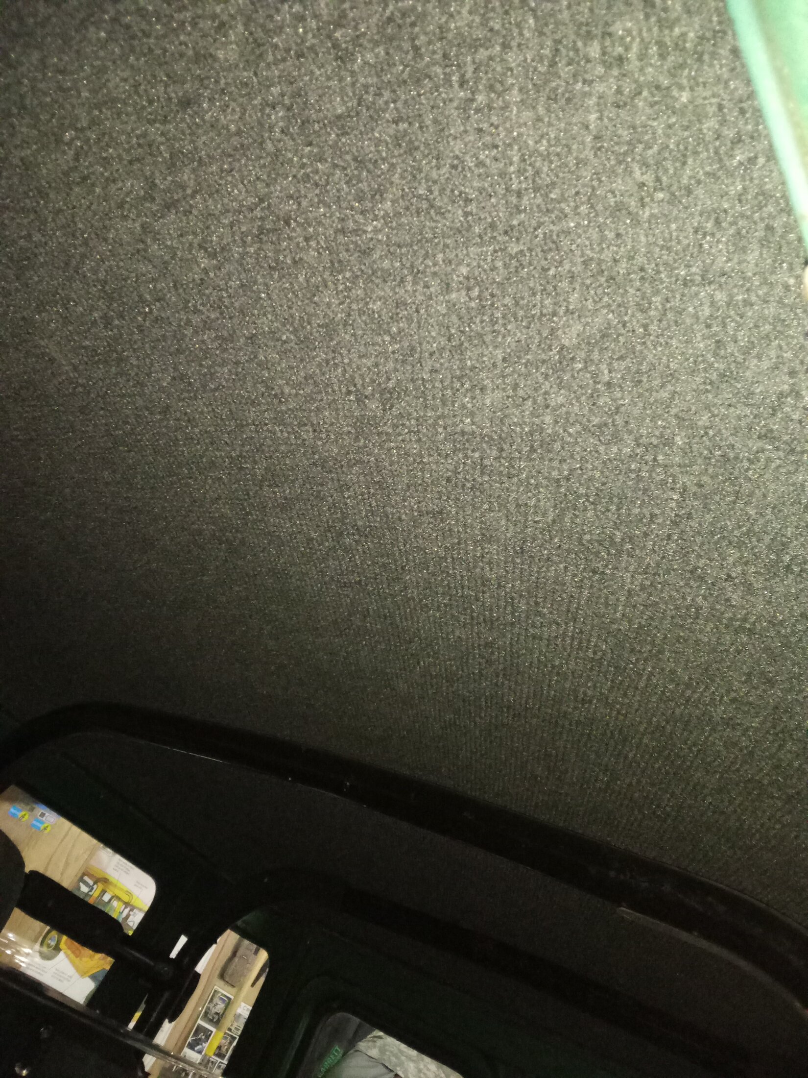

I used an indoor/outdoor carpet from Lowe's for my headliner. Dampens noise, insulates and in my opinion looks better than the white one.

Haha, no links either. A $20 carpet and 4 tubes of liquid nail from Lowes is what I bought. Use your old headliner as a template to cut it into the right shape. Leave it outside for a couple days until the adhesive cures, it really stinks at first but it will never sag if you apply it correctly.

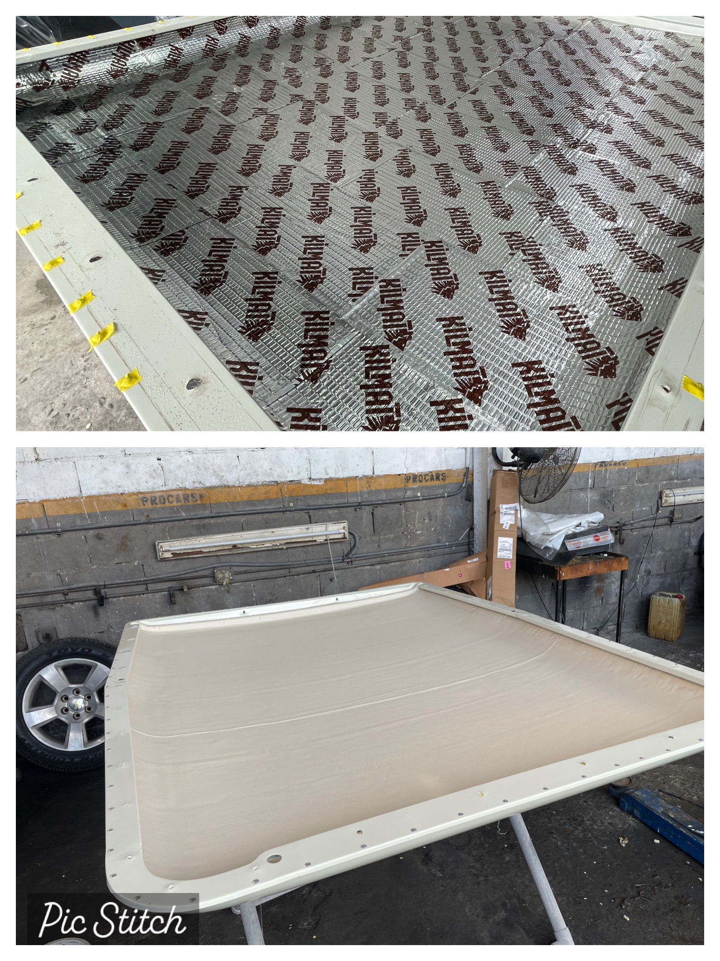

I sprayed Lizard Skin, then Kilmat, and finally the headliner, and I am very happy with the results. It’s been 6 months since I did the work in a very hot and humid climate, and it has been holding up with no issues.
Did you use the CC headliner?
