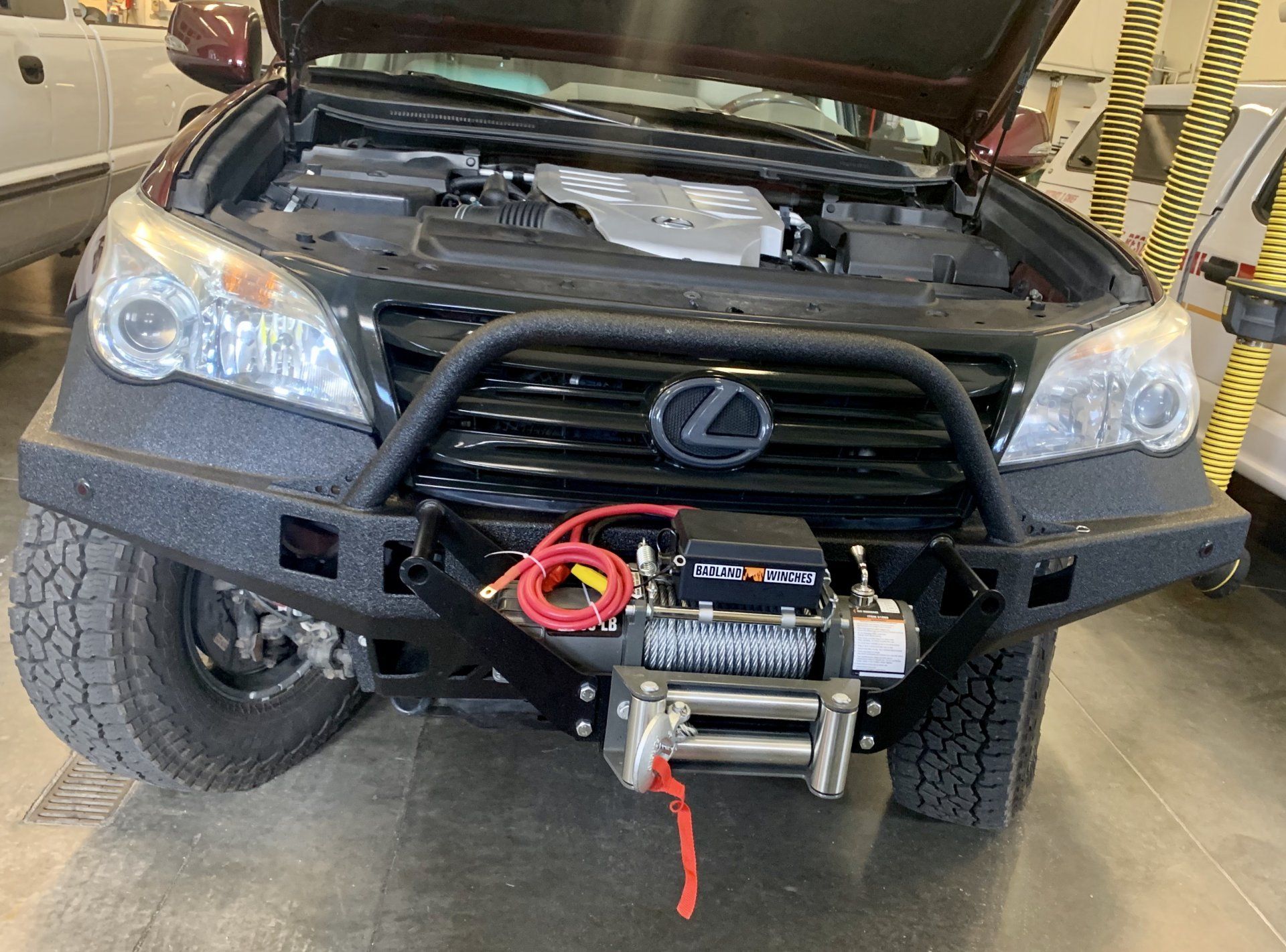

Great looking build @Lenny33! I have a 2012 GX460 - same color that is still stock. Trying to figure out the direction of my build. Like you, I've got a Jeep for the more serious trails, but thinking the 460 is a great expedition/overland platform.
Did you do any research on adding a "hidden winch" with the OEM front bumper/fascia? I'm thinking 2" lift, 33's and hidden winch and call it a day.
Bud Built used to sell a hidden winch kit but I don't think they do anymore. You might have to call around to the fab shops to see if they'll do one. There was a "local" shop that said they would do one (I don't think they were going to make a line of them) but I can't remember who that was.
I had the front bumper fabbed with a receiver in it so that I can use one winch on a tray for both front and back. Also like the idea of not throwing even more weight on the front of my truck.
Makes sense - that's the main reason I'm looking to forgo a heavy front bumper and just have the winch plate and winch. I previously built a 200 Series Land Cruiser and went nuts with ARB bumpers front and back, ARB skids, etc. and by the time I was done that was one heavy pig.
If you want something even easier, you could just have a receiver hitch on both front and rear and a hitch mounted winch. The winch could be used front OR rear and minimal added weight on the front! Albeit, you'll have to find a place to haul your winch around in.
Yup - that is what I was saying - that is my exact plan. AND I can run electrical for my Jeep and use it on that as well!
Theoretically, yes. I've never seen this in practice, and without my having the knowledge base to comment intelligently, my immediate concern would be the strength of this setup. Assuming you're winching at capacity - possibly with a snatch block - at a 90 degree angle, I'm not convinced (again, haven't really researched this - but also have not seen it in practice) that the hitch receiver setup will withstand those types of loads. I was just winching in a situation like this about a week ago, high-centered in my Jeep in very compacted spring snow. The force on everything was immense, to say the least. And like you said, that also means you're carrying around a winch inside your rig everywhere you go. Not the end of the world, but it's one more thing.
Bad quality pic, but you get the idea.
I could see that pulling at a 90 degree angle could be tough on this setup and there are certain things/pulls that I will have to be cautious with. In very general terms, pulling at a 90 degree angle adds roughly another 40% of “weight” to your pull. More stress on a setup like this to be sure. To me, the flexibility of a setup like this and not constantly carrying another 100 pounds on the front at all times is worth it. My plan would be to not have the winch in the vehicle at all times. I would have it loaded in wintertime weather and Offroad trips.
Personally, as long as the front receiver was as strong as the rear and welded/bolted correctly to the frame and the winch is on a strong chunk of 2" square tubing with a good fairlead for the type of cable used (aluminum for synthetic and roller for steel wire cable), there should be no problems.
