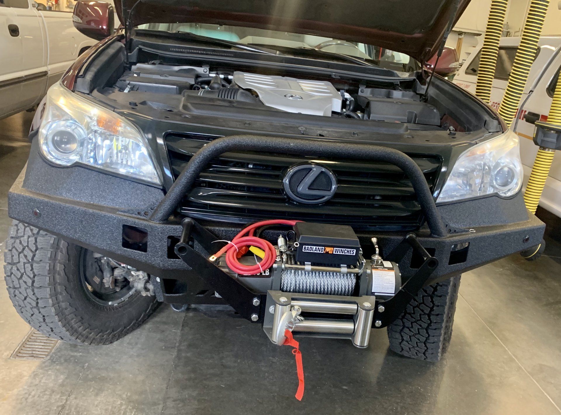

Oh yeah, forgot - grabbed my buddies setup to see how it would look and fit and took a couple of pics...
I'd suggest getting a synthetic line and lose that wire cable. It will save your back if you're having to lift that winch often! I love having a synthetic line when I've had to use my winch. No wire splinters, light, flexible, easy to wind back into the drum.
For sure! This is just my buddy’s setup. I estimated that I would lose about 20 lbs with synthetic line and 10 lbs with a 9K instead of 12K. That thing weighed 100lbs!
That is a long lever that you will have mounted that winch to. Do your best to make straight pulls use a pulley block if you need to pull off angle, rig a redirect if possible.
Agreed. I have not found myself pulling at a 90 degree angle very often in my life. I know it can happen, but I will just do my best to avoid those situations. I am a technical rescue rope nerd, so I love making pulls more technical than they need to be! 😁
This was my thought. Essentially every inch the winch is farther from the actual frame of the vehicle, the worse any angled pulls will be, from a leverage standpoint. Figure a 10,000lb winch pulling at capacity, and any angle amplifies the force against the hitch point.

I don’t consider it a “hijack” at all - just discussing the build. And you bring up a valid point.

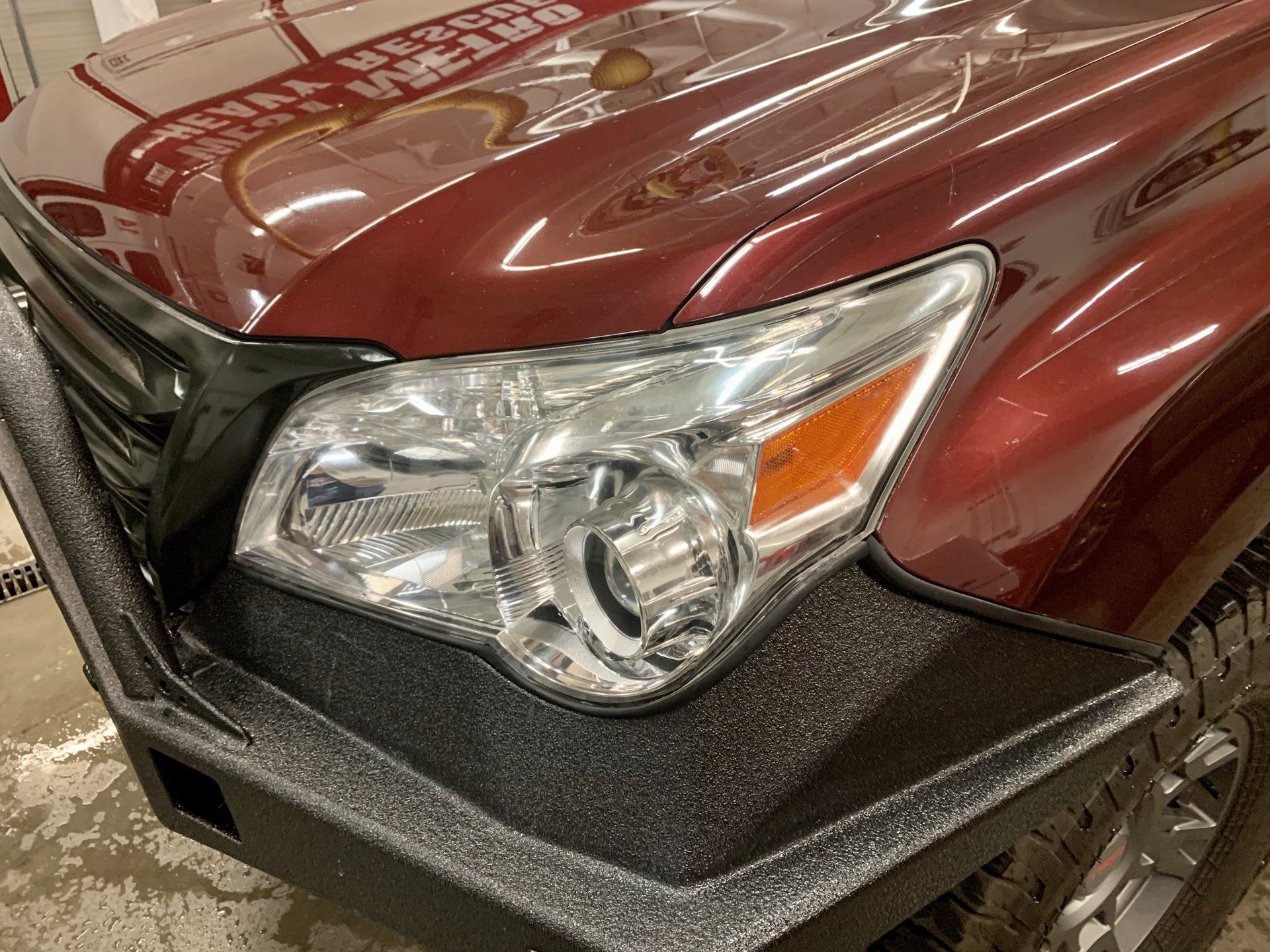

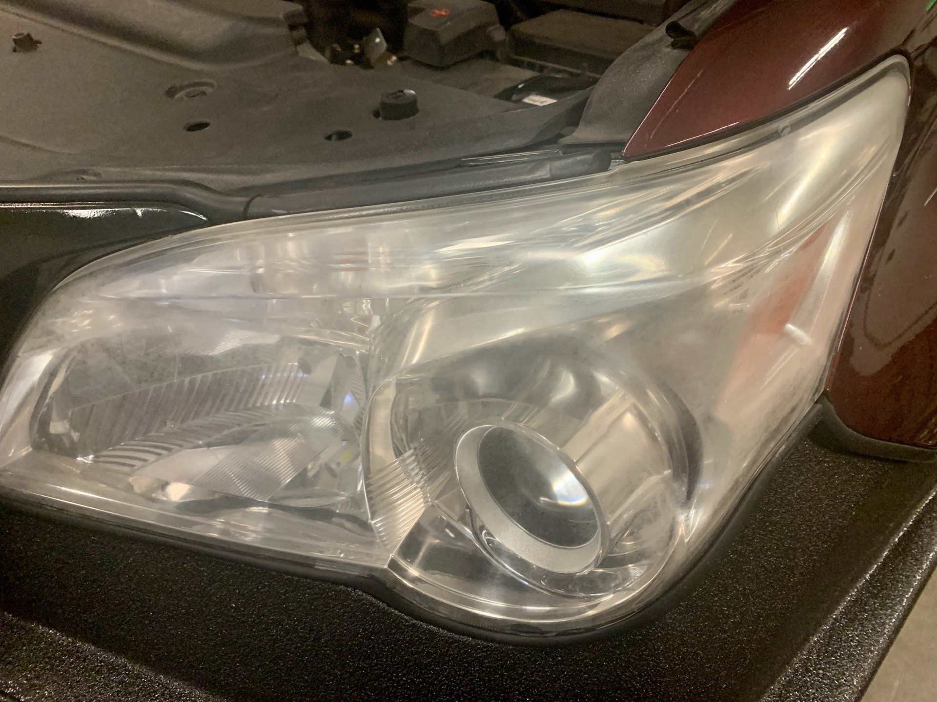

I don’t really think this even worthy to add to a “build” thread, but I am amazed at how much this little project exceeded my expectations! Before and after headlight polish kit ...
They look great but the true test is how long they stay clear.
I've had years of frustration around headlight restoring kits. Always looks great...for a few months or so then back to ehh. Use this Meguiars kit 2 years ago on my old Tacoma and the clear stayed really well for two years. The sanding discs aren't the most aggressive, so if your headlights are bad then you'll need something else to do the trick before this kit, but the trick to the kit is their clear headlight coating. It seems to be an actual clear top coat you spray on when done, no just a polishing compound. Cheap price too.

Yup - that is the kit I got and used! Happy to hear that review
