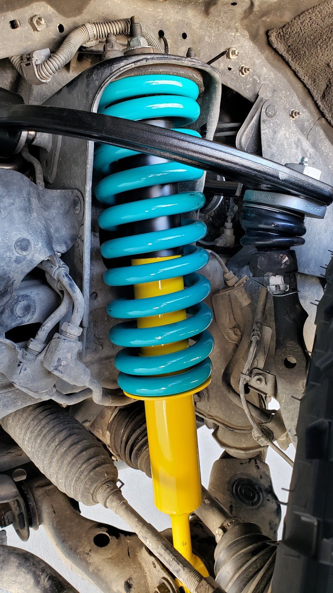

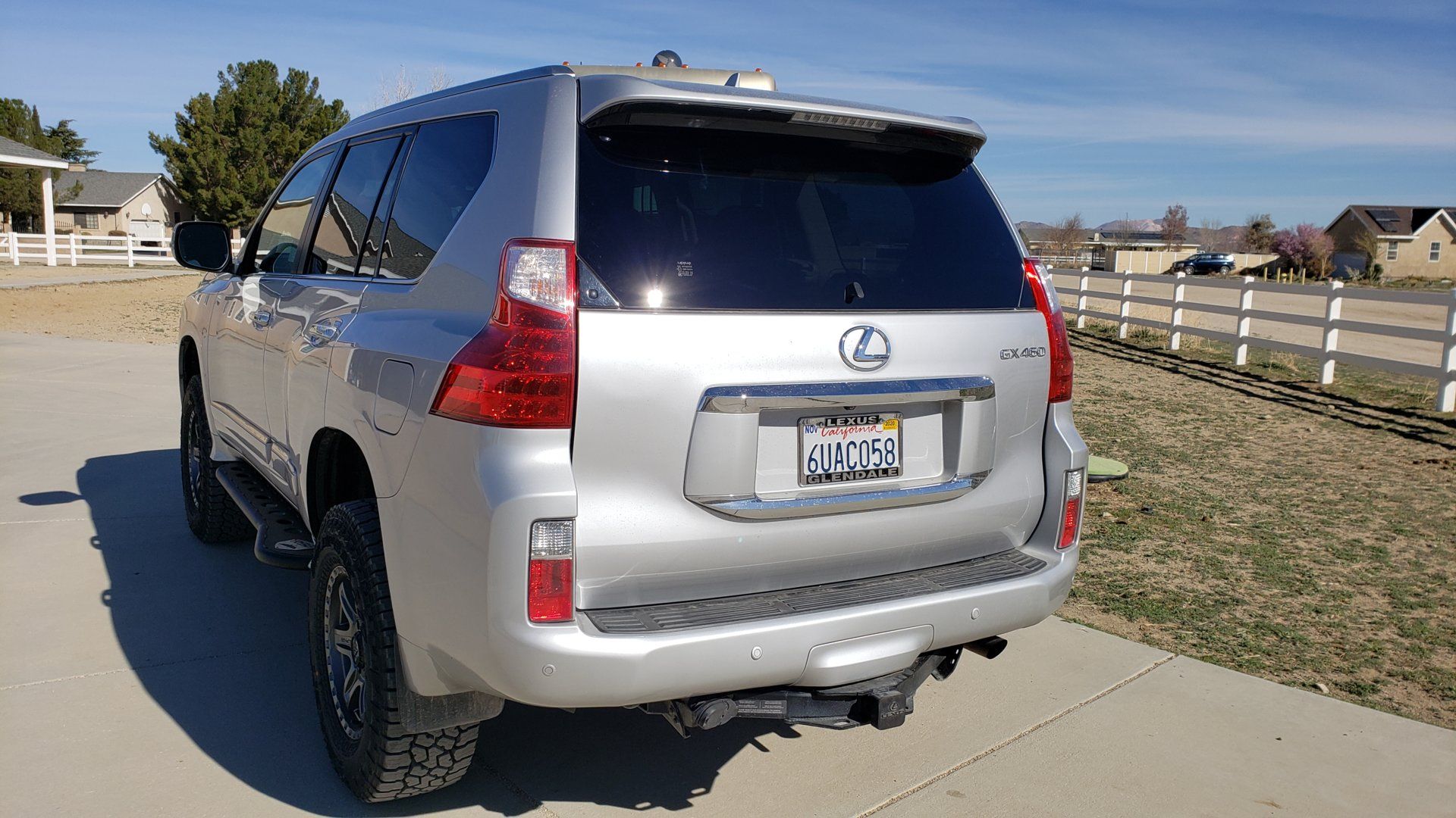

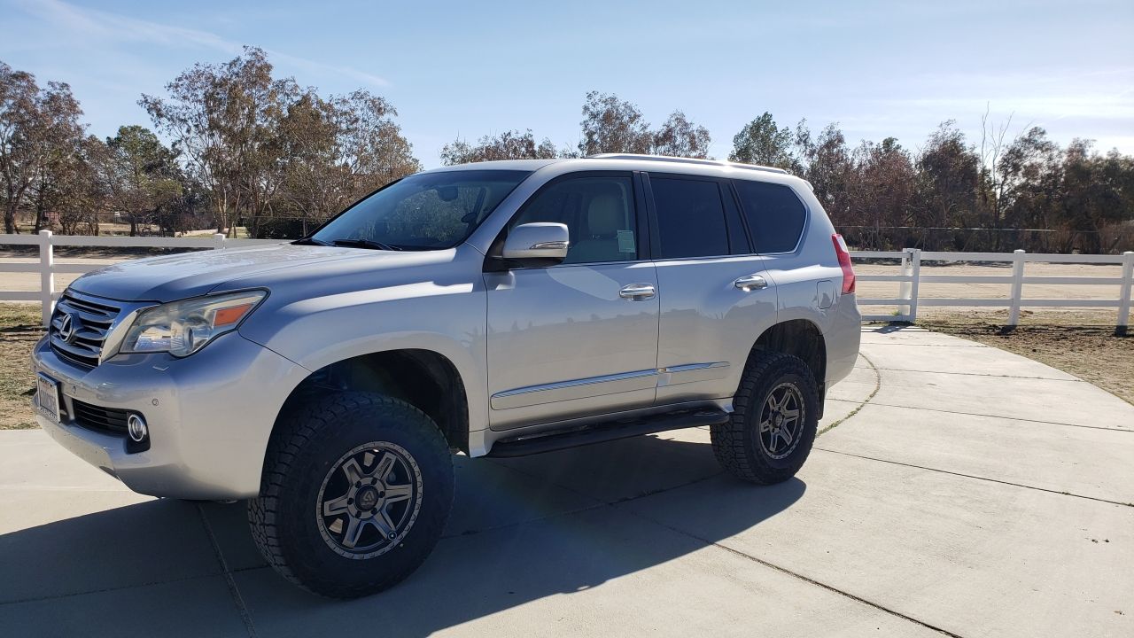

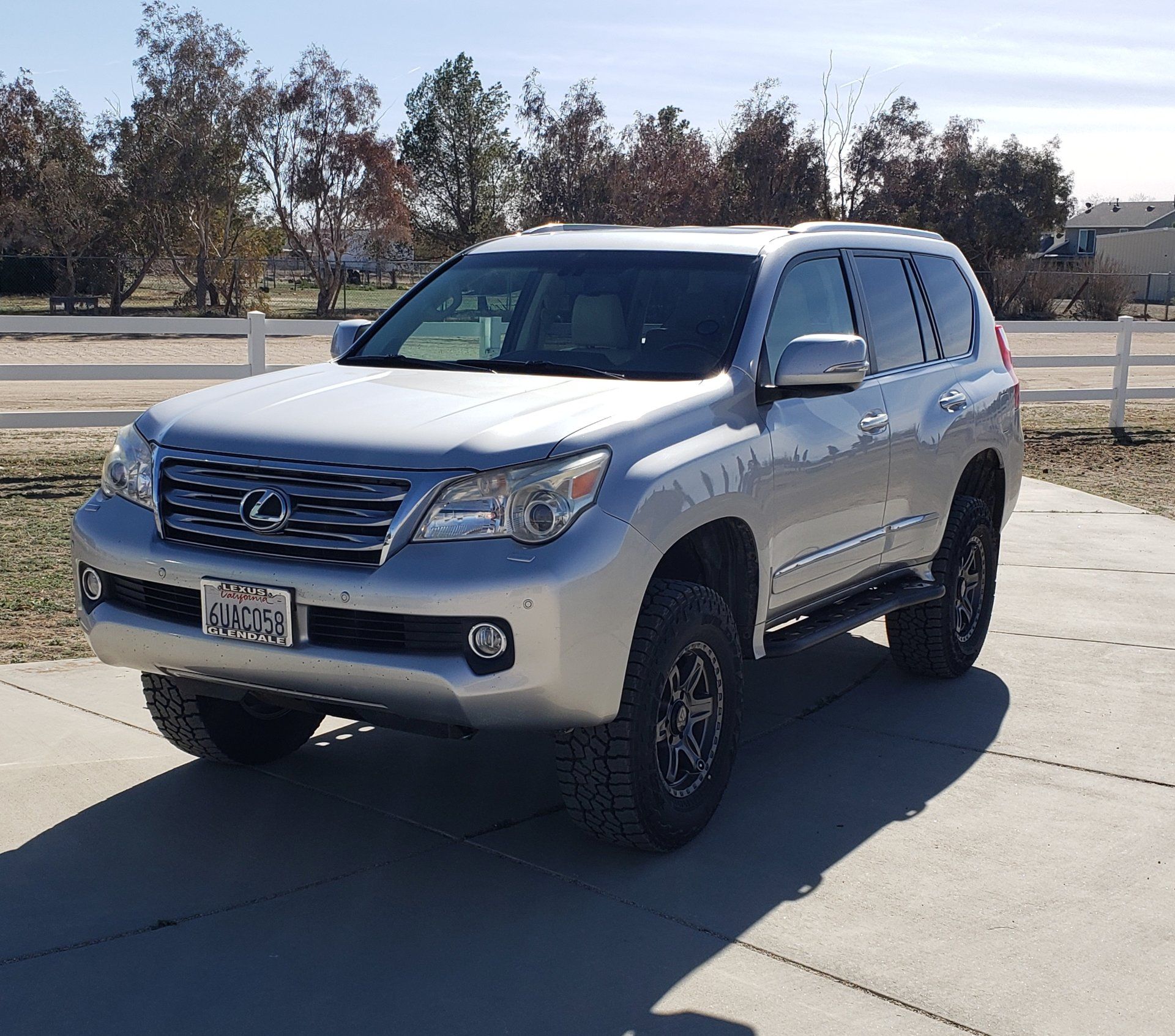

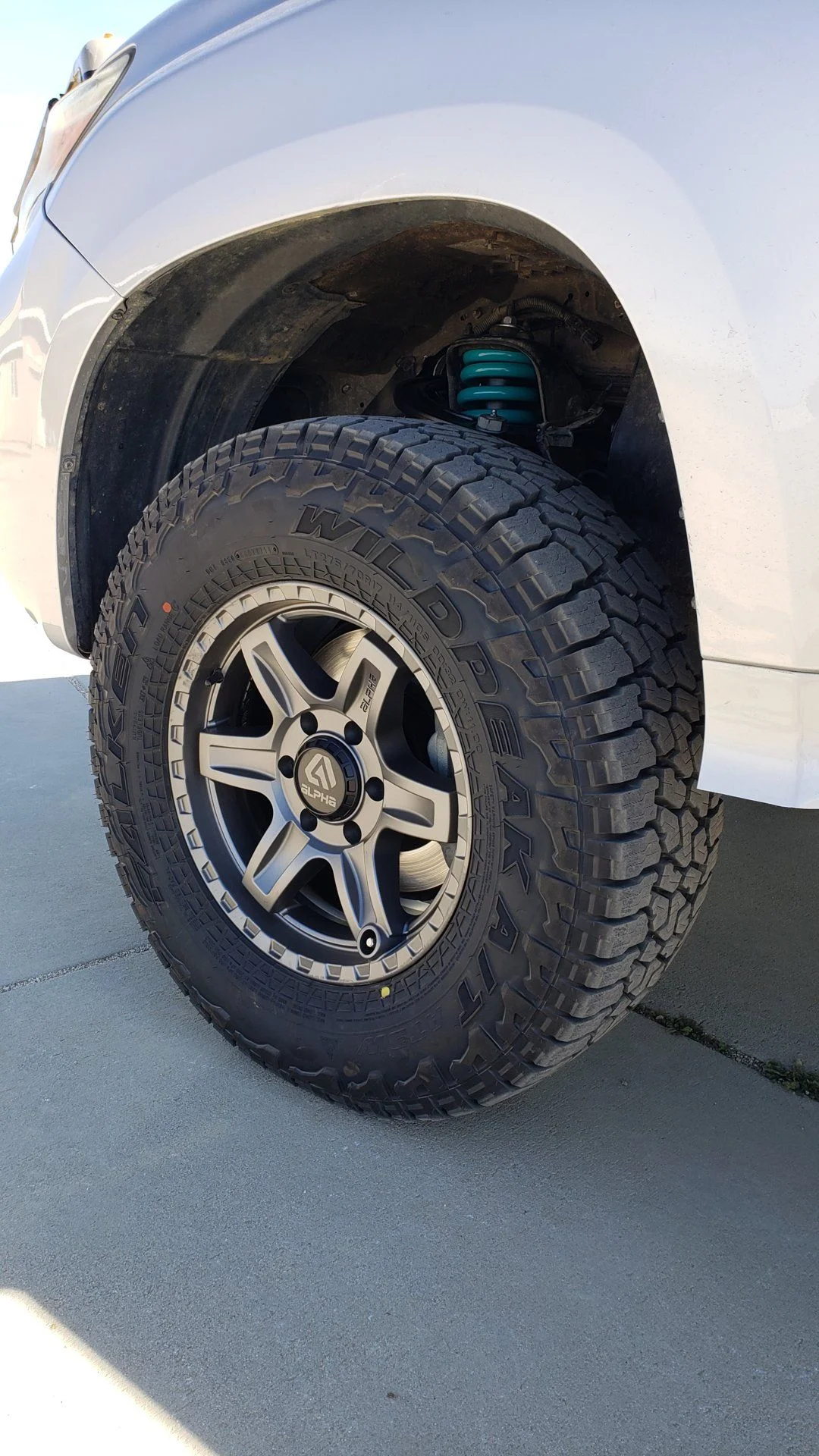

Build was completed yesterday! I had a shop (RPM Garage in Monrovia, CA) do the install. They did an excellent job! Especially on the alignment. It's spot on. Some changes to the parts list were:
SPC UCA's
Falken Wildpeak AT3W's in 275/70R-17 (this combo does NOT fit in the OEM spare tire carrier)
Did you end up with the 2 inch or 2.5 inch lift? Just wondering how my dobinsons 2 inch lift is going to turn out with the same size tires.
I finally made it to check out your build thread. Nice rig buddy, hows the clearance with that tire height?
Thank you! It only rubs if I'm reversing with the steering wheel at full lock. Pretty rare circumstance.

What are you doing for a spare tire since it does not fit in carrier?
Right now I have it in the cargo area. It's the same wheel and tire as the other four. At some point I'll decide on where I'm going to put it.

Very sharp. I hope to be doing something very similar soon with a 2010 in white. I am deciding on the RSG flat vs RSG angled. Those are flat. Correct?
Thanks! Yes those are flat.
Do those flat ones make a OK step for the little lady to get in? Do you think they give as much protection being flat? I have All Pros on the FJ and it is a big jump for my wife!
