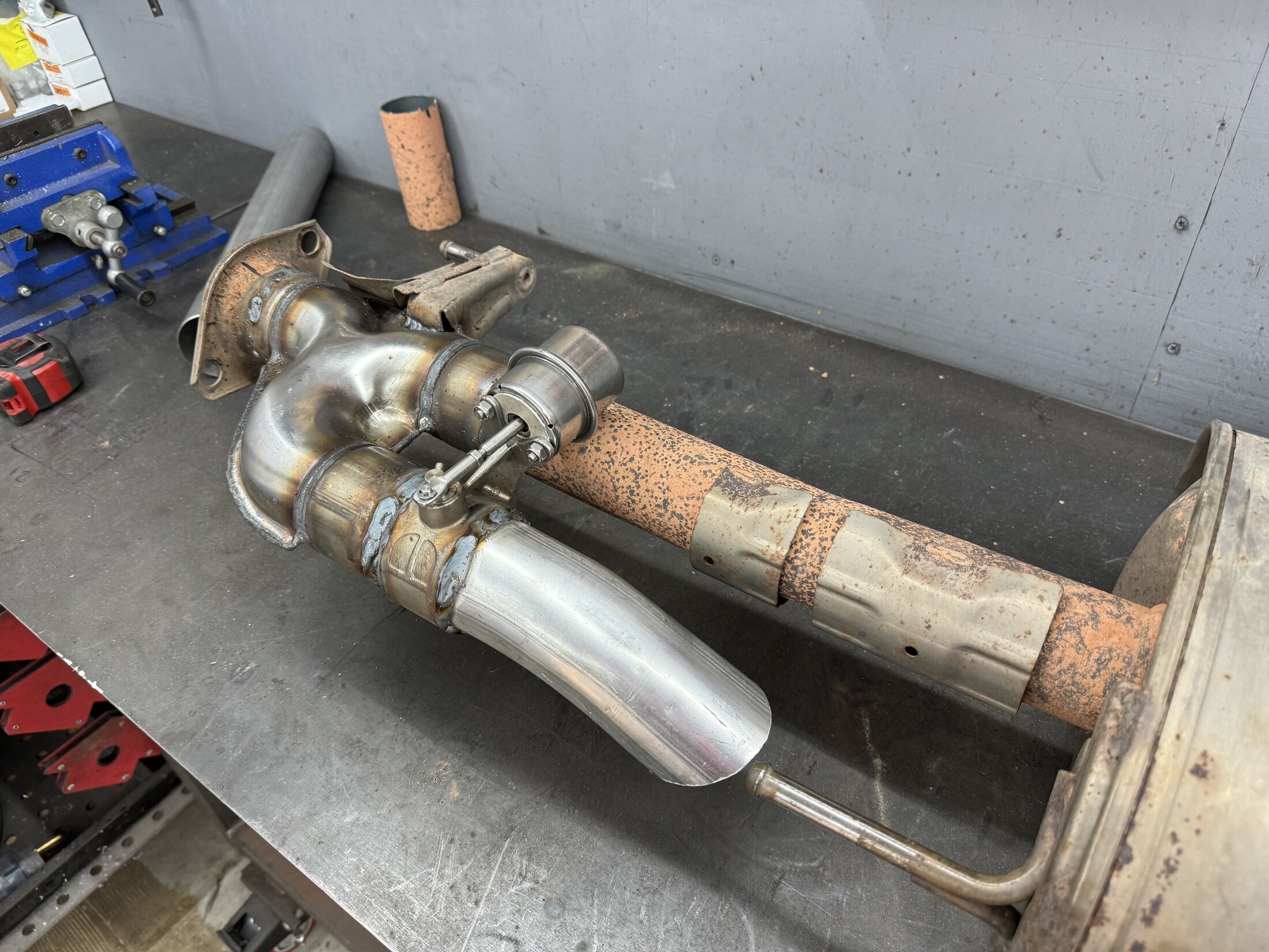

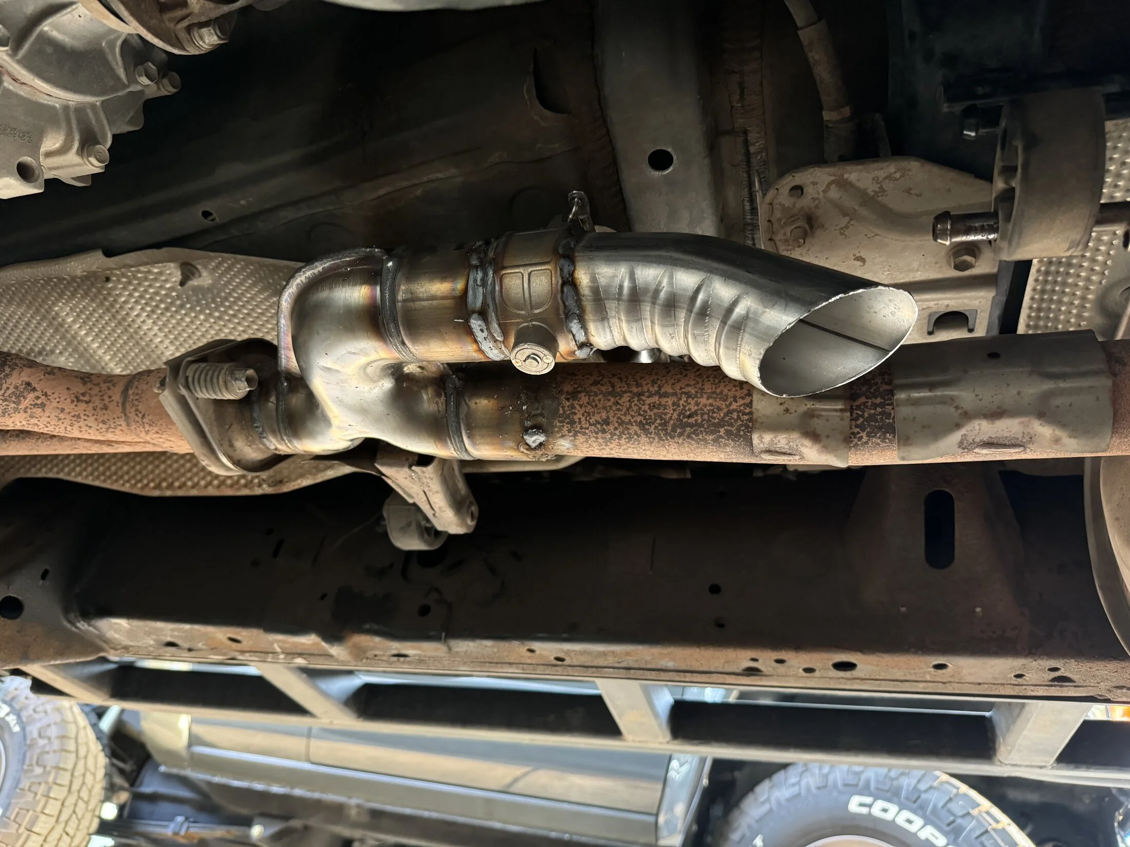

I spent this afternoon setting up a vacuum actuated exhaust dump. I’ve never had a v8, I love how quiet the Lexus is and the lengths they’ve gone to keep it quiet, but….V8 noises
I drove it around a few miles with the muffler removed just to get an idea of how loud it could be. It had a bit of openness to the sound that I wasn’t a huge fan of, but since putting the Y pipe and everything else on, it toned down everything and has a great sound to it while still being dead silent with the cutout closed.

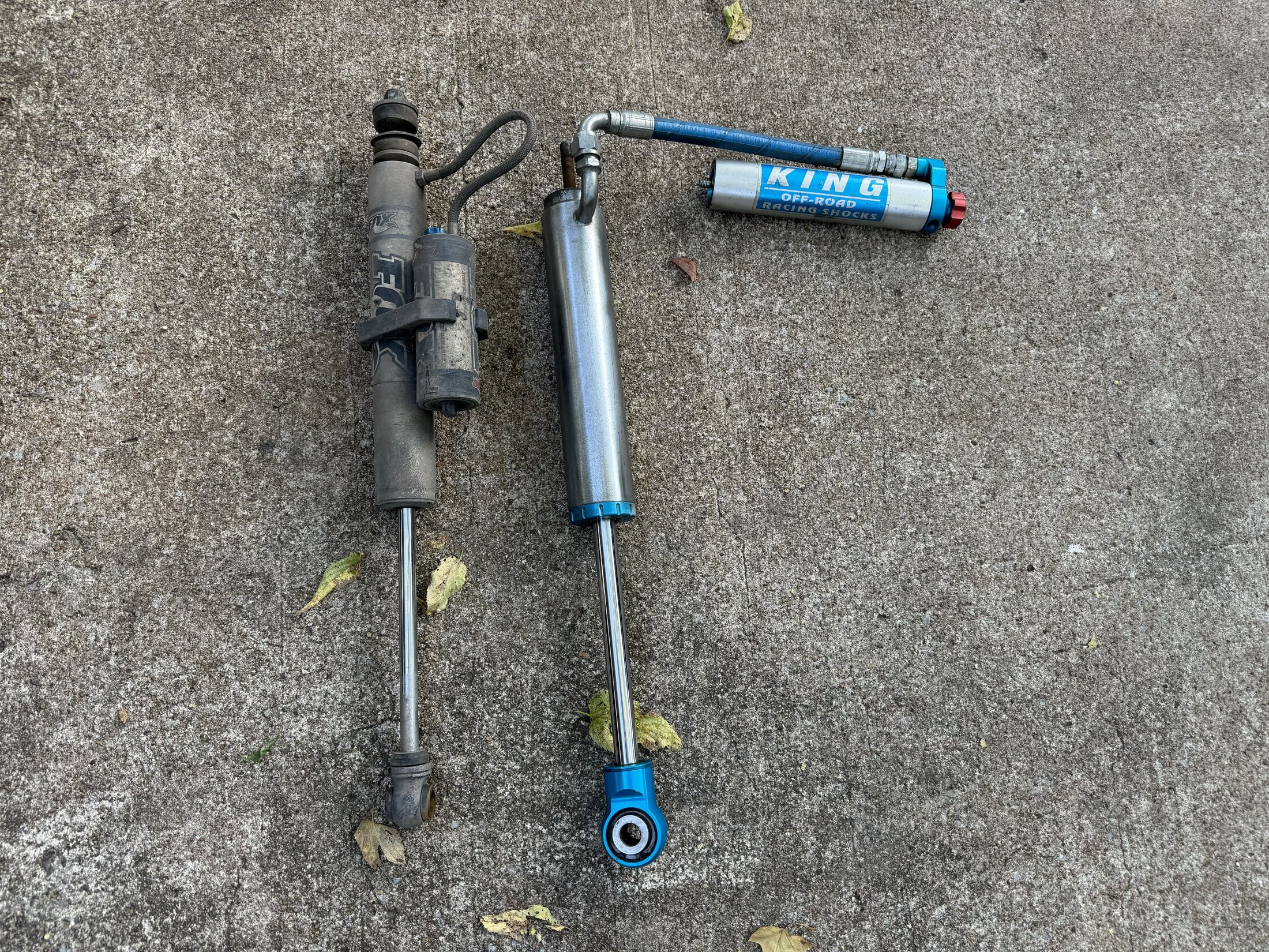

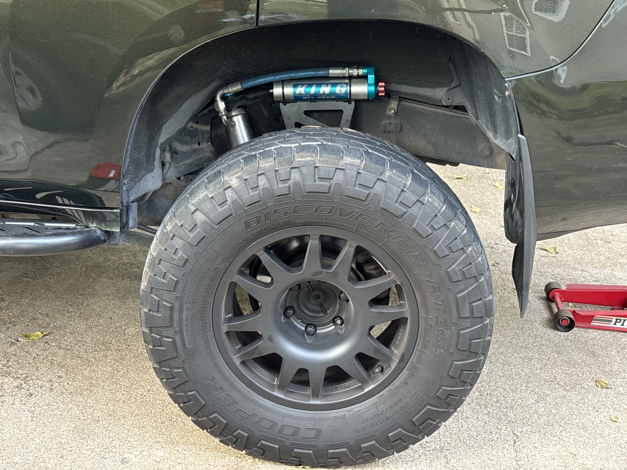

Swapped out the Fox 2.0s and their soft valving for some King 2.5s with the clickers that my friend just had rebuilt before going to a different full system on his GX. Ride now feels much closer to the Fox 2.5 DSCs up front and seems to ride a smidge higher in the rear. Still very comfortable, but definitely firmer. Back end reverberations are gone and after a couple jumps and drops, predictability and capability is back up. I still think the BP51s have been the best I’ve had in terms of small bump compliance and bottom out resistance, but these aren’t too far off

Dumping under the rig can result in CO entering the vehicle. In a well-sealed vehicle like a Lexus it's probably a non-issue....but it could always be a concern under certain scenarios. It will also kick up dust when you rev it. I ran mine this way for a couple of weeks while I had my aftermarket system out to further modify it. It was honestly fine, but not something i wanted to run full-time.
For your application, I'd suggest chopping off the tailpipe and have it exit just behind the rear tire with a 45-degree angle. Kind of like the Magnaflow Overland systems exit. This would provide your more clearance but still direct exhaust away from the vehicle, instead of under the vehicle. It would still be an easy job for any muffler shop to undertake.
So far not an issue. When camping, I will usually run my rig at idle for 5 or 10 minutes before lights out and/or after getting up in the morning just to be sure my fridge doesn't drain the batteries.
With it idling, have never smelled any exhaust inside and sometimes I will sit in there in the morning looking over email/whatever as my phone is plugged in. My wife has a real sensitive nose and she doesn't smell anything either.
Haven't caught a buzz yet...
Although the exhaust tip is pointed out the towards the passenger side, not down, if that matters. :meh:
I will need some kind of exhaust change once my Dissent rear bumper arrives since the stock piece hangs way too low. I have been toying with the idea of a cut-out because v8 noises keep America safe but like 99.98% of the time I like my super quiet Lexus. Any idea how your setup would fair with the occasional dunk in a mud pit?
I think it would be fine as long as it’s not peanut butter mud. It’s pretty well shielded and tucked up in there. I also figured vacuum operated would be more reliable compared to an electronic one, but this past week my vacuum pump is no longer receiving signal from the controller. I haven’t had any time to look into it yet. Hopefully it’s an easy fix. I knew the box didn’t look very watertight, but putting it up on the driver’s firewall corner under a cover was pretty protected and I haven’t been in any water/rain so not sure what’s going on there.
Like others have said, I’m not worried about CO fumes. If I left the truck running with it on for an extended period of time in one place sure, but I only really turn the cut out on when I’m romping on it. Not really something I leave on all that often.
