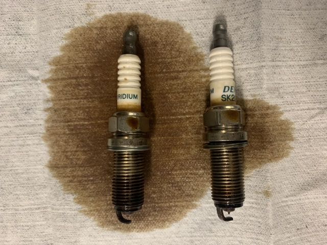

Crap - first two plugs on driver’s side.
So the whole valve cover does not need replacing - just the individual gaskets for each plug?
Ahh - found the info on it. Might do it myself unless I find someone local with a good price on it.
When I replaced them on my Taco I did the cam cover (valve cover) gasket and all the plug tube O rings. On that truck to complete the left side you had to remove the intake manifold.
