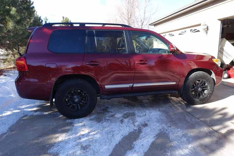

Tires and RIMs make a big difference. I moved the Toyo AT IIs from my 100 along with aftermarket rims
Black Rims on a red truck look great
They do rub on turns so I better get that lift going

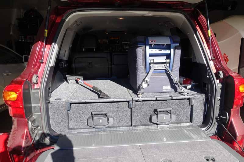

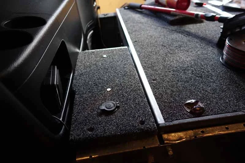

I installed my ARB drawers from my 100. The wheel wells are tighter and I had to shave about an inch off the trim kit

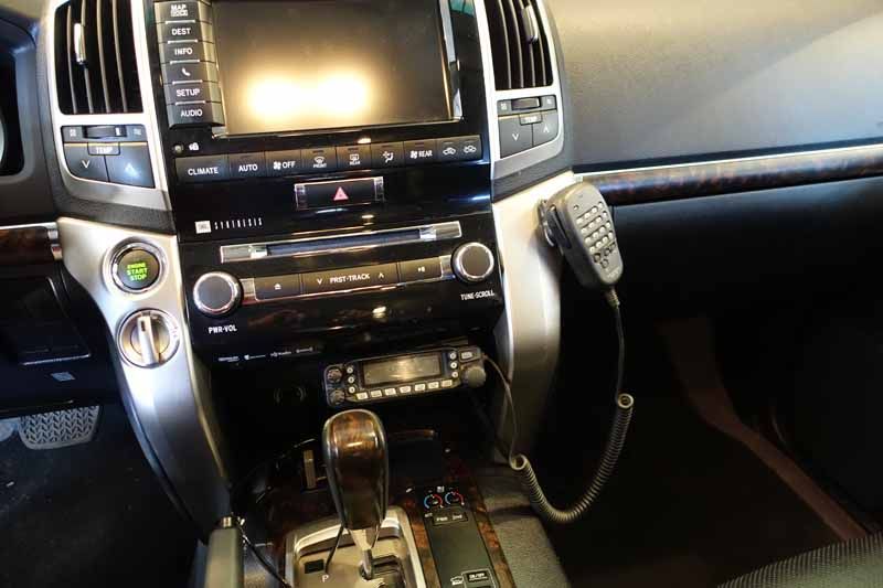

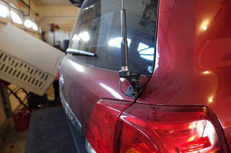

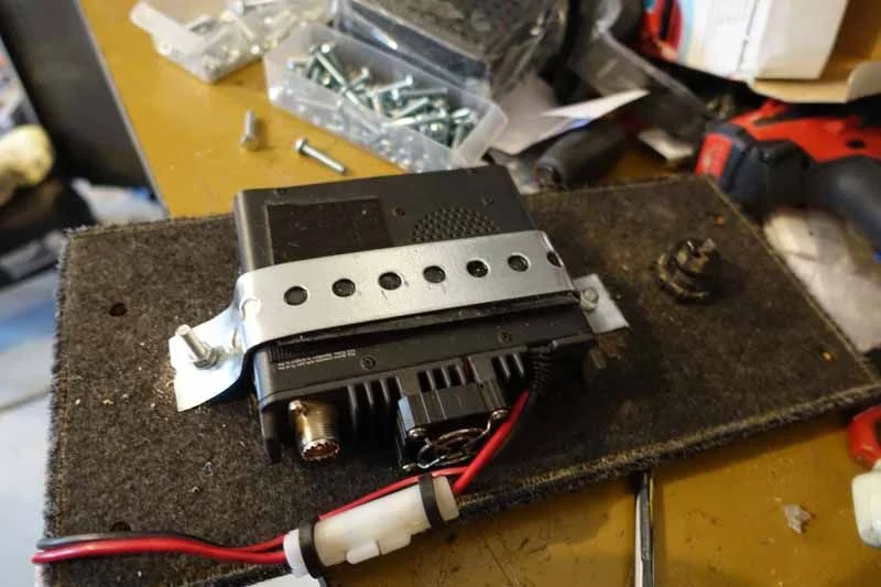

Next cam the Ham Radio. I installed the Yaesu FT-7800 that has been in my 80 and 100. Great Radio. Problem is the mount wouldn't work for the antenna. I went to HRO and found a mount that works on the hatch below the glass

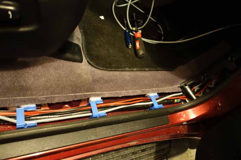

The 200 has an advantage over the other rigs I have built with the space set aside for wiring. I went ahead and strung wire for the HAM, CB and AUX power outlet
Then used a angle piece a plastic I JB welded above the ashtray and used adhesive tape to put the faceplate on

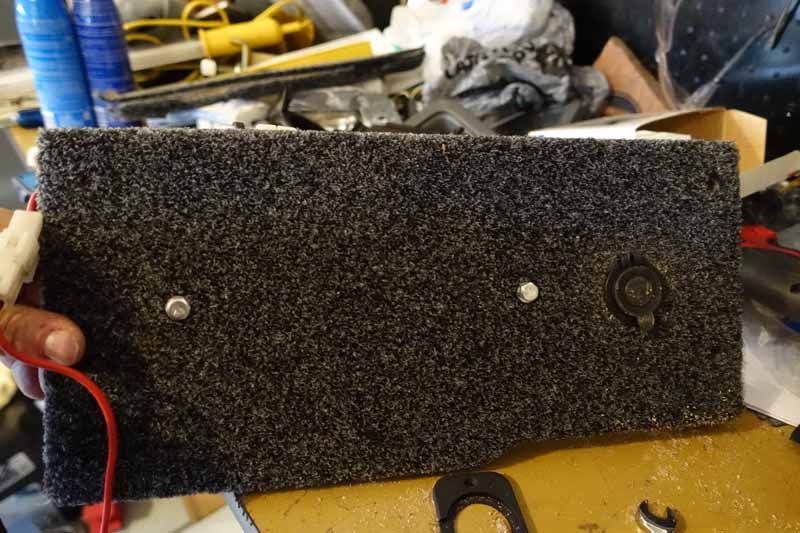

I put the Radio head unit under one of the Drawer Trim Kit panels along with the 12V outlet for the Fridge. Was amazing to me there wasn't a 12V outlet back there
Nice!
Did you use the same trim kit from your 100?
Which ARB fridge size is that?
I'm about to put drawers in mine too. Had them on my 100, and truly been missing them.
It is the same trim kit. The passenger side fit well. The drivers side required adjustment with a jig saw to change the curve and take about an inch off the width. Brackets fit fine though.
They have a 200 trim kit now
Its the 50 qt from ARB.
Thanks. Been looking at fridge models... Kinda wishing for a setup that is accessible from the front passenger seat, so thinking about size and how it might be secured on folded-down right second row seat.

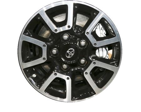

When I swapped the rims I only got 4 turns of engagement on the lug nut. I went to Discount and they said 4 is fine per their specs. I am not comfortable with 4, maybe I am being anal. With the new Toyo AT's I would stick to an 18" rim. The TRD Pros are two pricey, but also look like the older Tundra wheels just powder coated black. I do like the Fueal Anzas and sent Kreiten a PM to see how he like them. RIMs and specs still confuse me. What specs should I look for in a RIM to fit the wheel and also ensure I have more turns on the lug, say at least 8.
I decided to go with the TRD Tundra Wheels and ordered 5 on ebay for less than $200 each delivered. I am debating on Powder coating them all black before I put them on, but I kind of like the two tone
