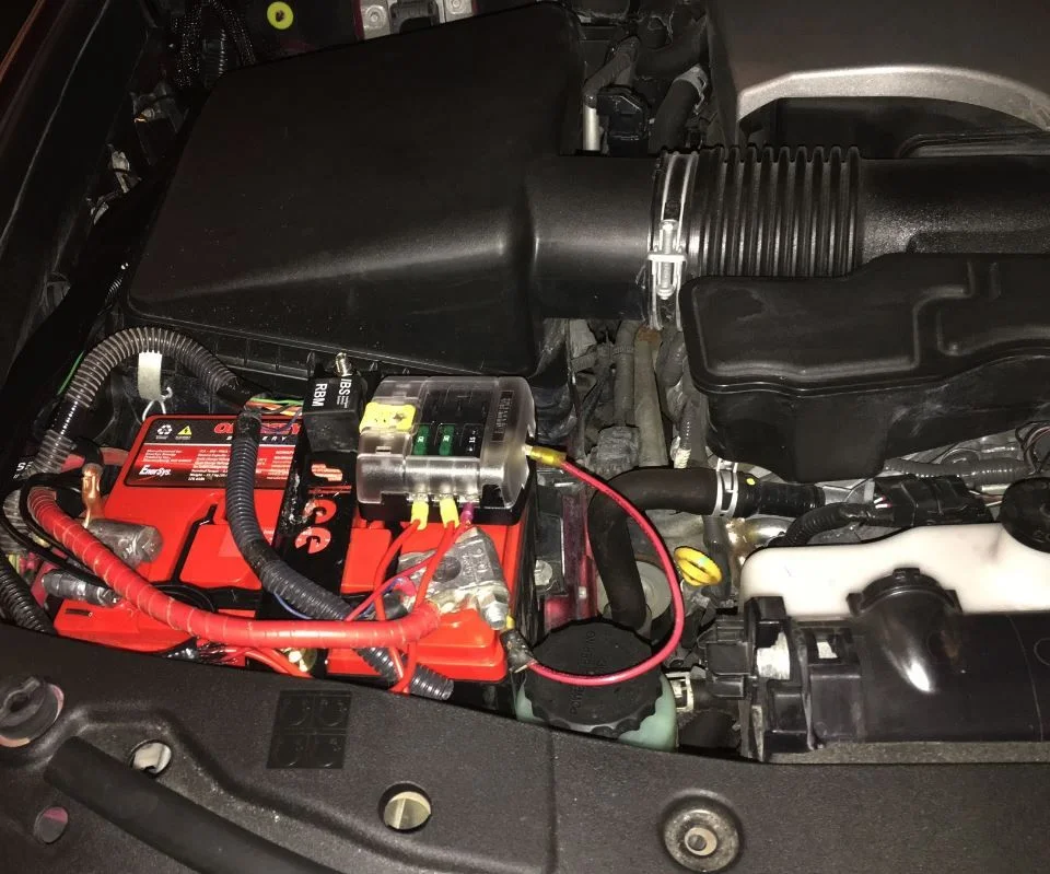

Installed the IBS Dual Battery setup I had in my 100 with a 200 series Slee 2nd tray. I was trying to decide were to put the Blue Sea Fuse holder and I didn't see why I just couldn't velcro it on top of the battery. I haven't decided if I like that. I may just get rid of the fuse box and use three in line fuses to the positive post on the 2nd battery. I will go in and clean up the wiring, I just wanted to get it installed. I essentially lifted the whole thing without disconnecting more than I had to from the 100 series and laid it in the 200 so some shorter wires and optimization can be done while I clean that up

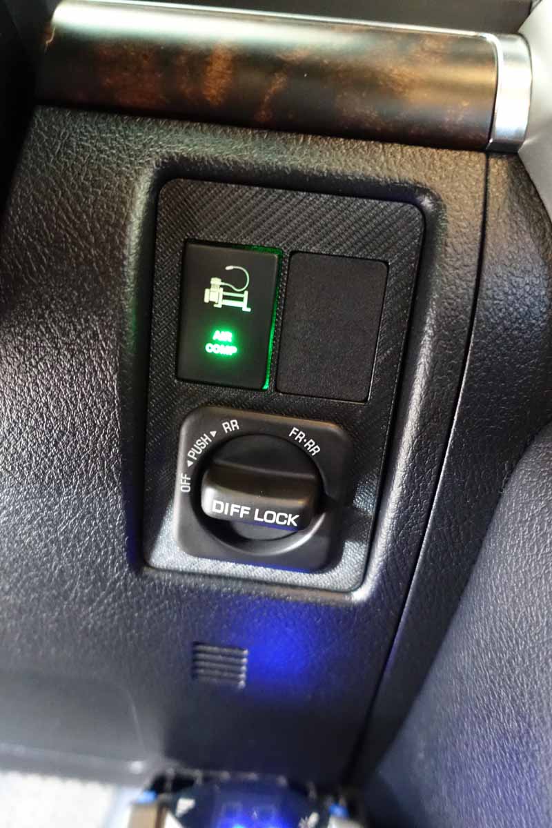

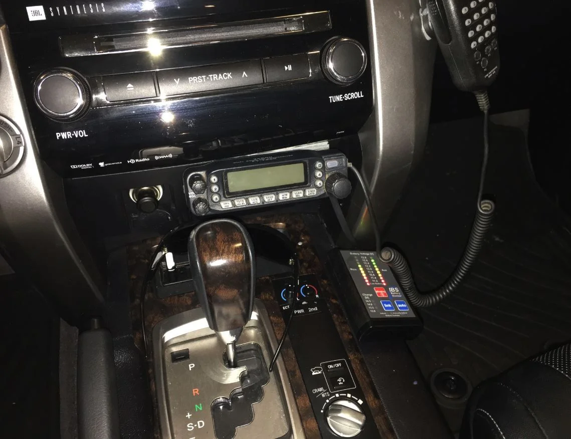

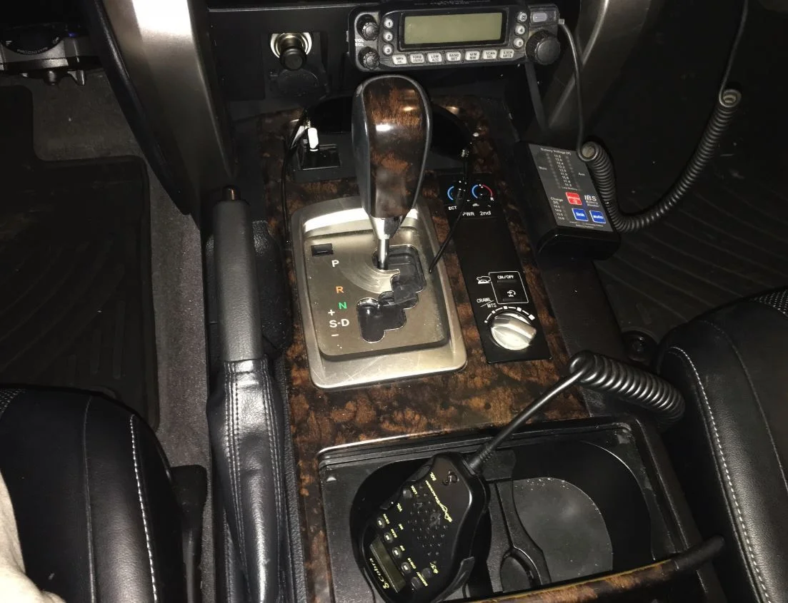

Sat in the cab for a while trying to decide where to put the control box. I ended up taking some adhesive and putting the bracket down on the right side of the console

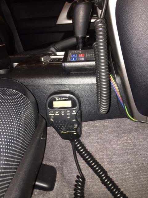

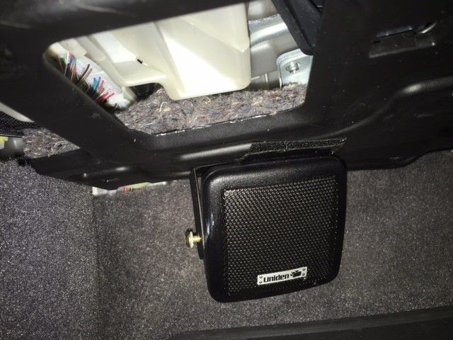

Next I wired in my CB. I took the under side dash cover down from the passenger side and mounted the speaker there tucked up out of the way. I put the main unit behind the carpet laying against the metal on the tranny hump. Just need to take care of the mike setup. I may put a mic holder on the passenger side just below and back a bit from the batt controller on the side of the console rather than the top, still thinking about it. Can't really use it till I get the rear ARB bumper installed at Slee's in a week and can put the antenna on. I wanted to get all the wiring done at one time. I laid the antenna cable last week when I was running the Ham wires from the back to the front

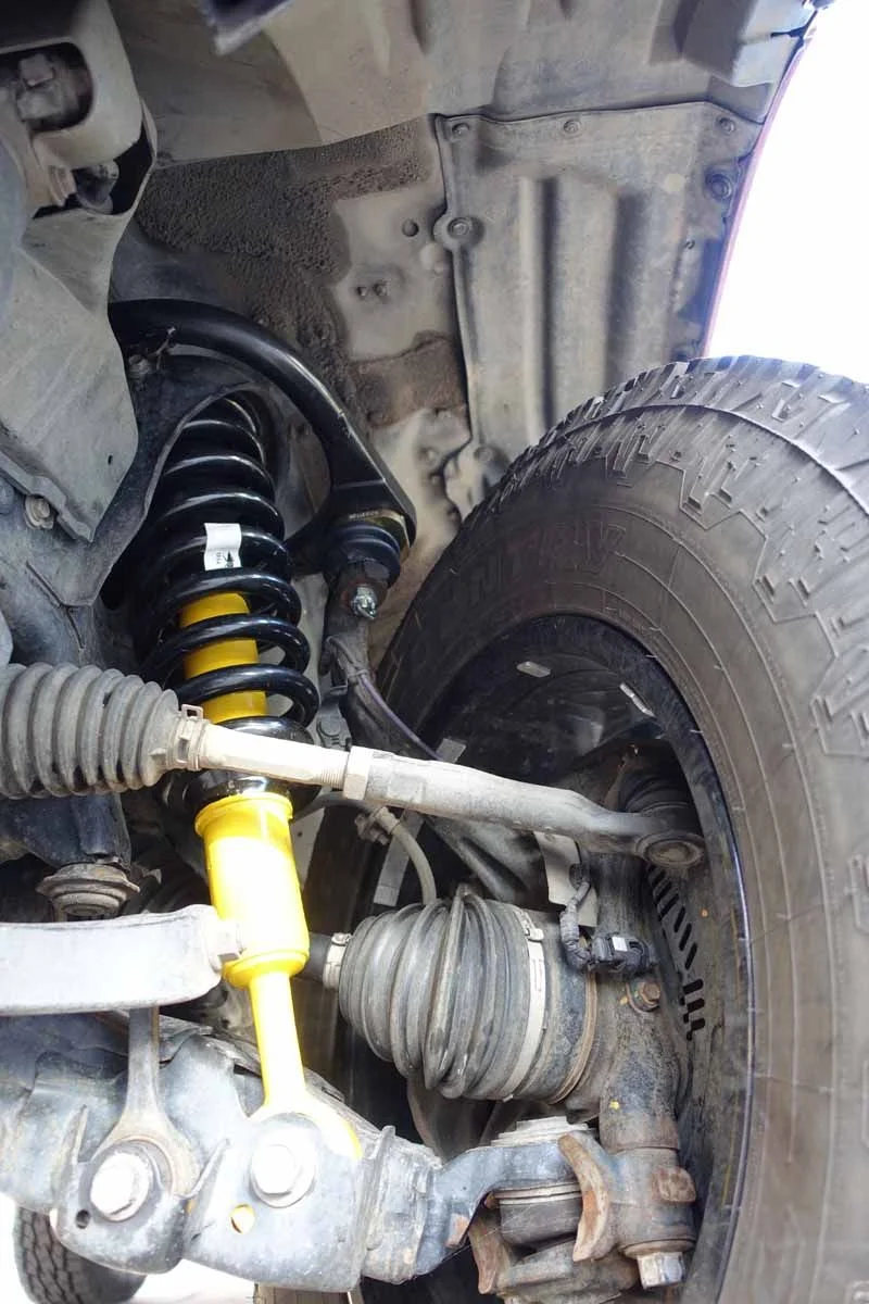

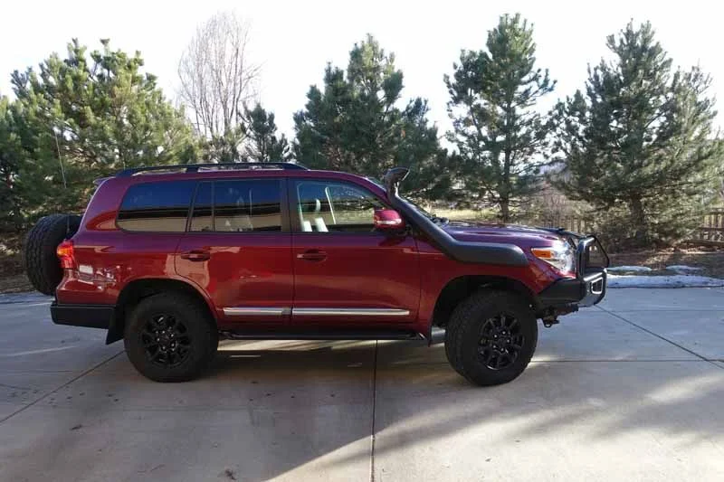

Aww the beauty of a built truck. I ended up going with the OME standard lift because the BP-51's wouldn't be available for a couple of months. The standard lift did fine for me on my 100
Edit - Here are the part numbers for the lift
OME 2723 - REAR COIL - 3/4" Lift - 440lbs
OME 61029 NITROCHARGER SPORT SHOCK - REAR
N91005-S 91005 OME Nitrocharger Sport - Strut - FRONT
OME 2703 - FRONT COIL - Medium 2" Lift -
OME 661 -Rear Shock Guard
SPC-25465 SPC Adjustable Upper Control Arms - 08+ Land Cruiser - Pair

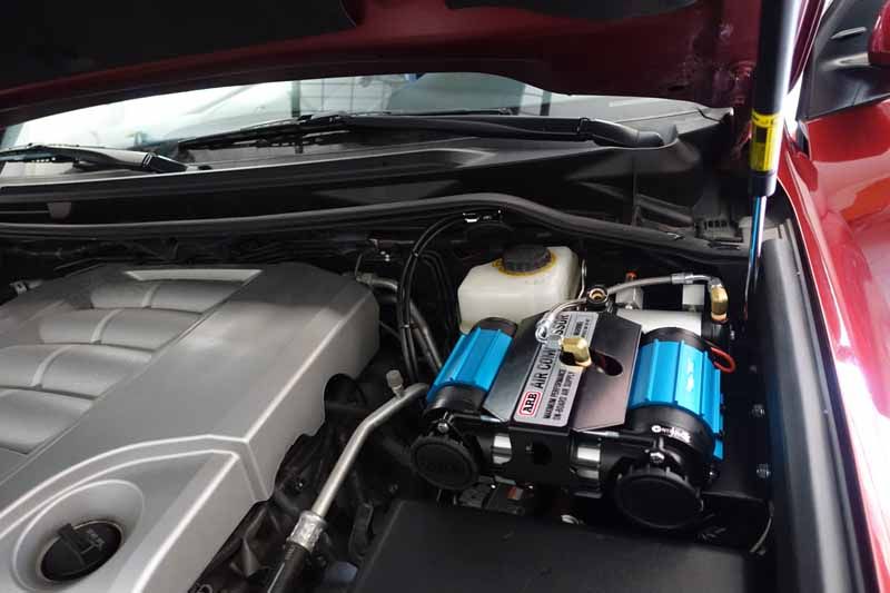

the Twin compressor will be nice airing my tires up. Here is a thread I did a review of several setups
80's locker switch

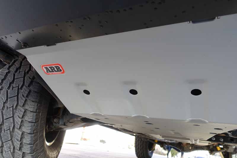

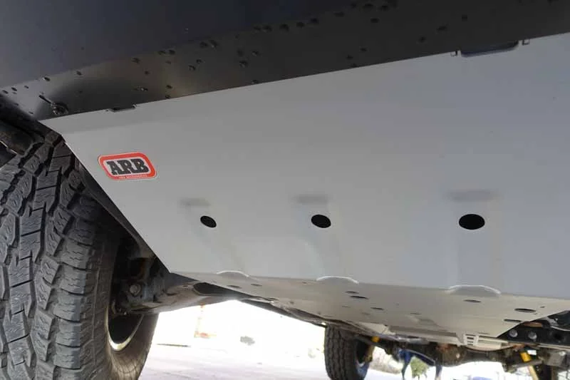

ARB Skid Plates

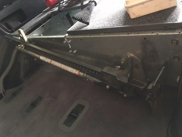

I installed the Hi- Lift Jack and CB radio today
Ran a bolt through the back of the ARB Drawers and its nice and tight. Going to follow the suggestion to get a neoprene cover for the jack
I installed my Cobra CB. I mounted the speaker to the under dash cover below the Glove Box

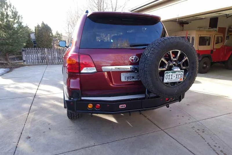

I used a trucker mirror arm CM Antenna mount on my ARB tire carrier. Had to shave the curved edge to flat so wouldnt dent the rear gate when closing the ARB
I believe they are 275 70 18's, 33.2"
