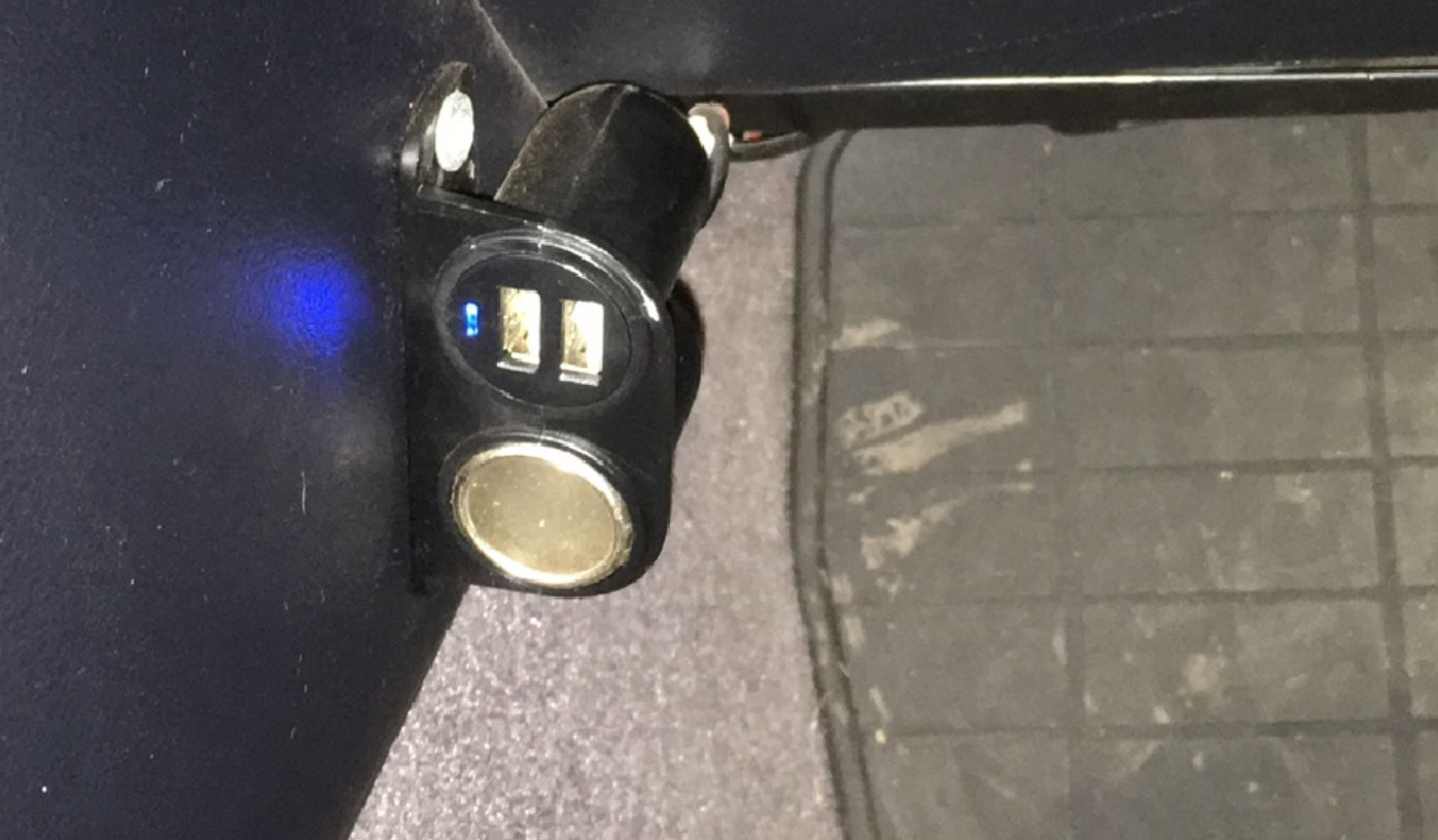

I replaced the power outlet for a dual, USB and standard

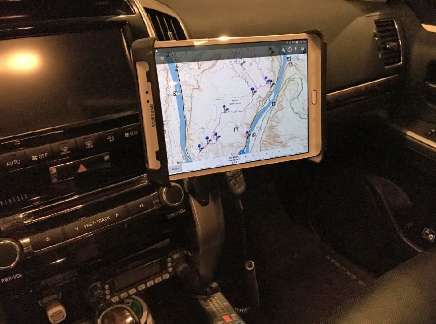

I swapped my GPS from a Windows Tablet to a Samsung Android Tablet. The research that led me to there is posted here

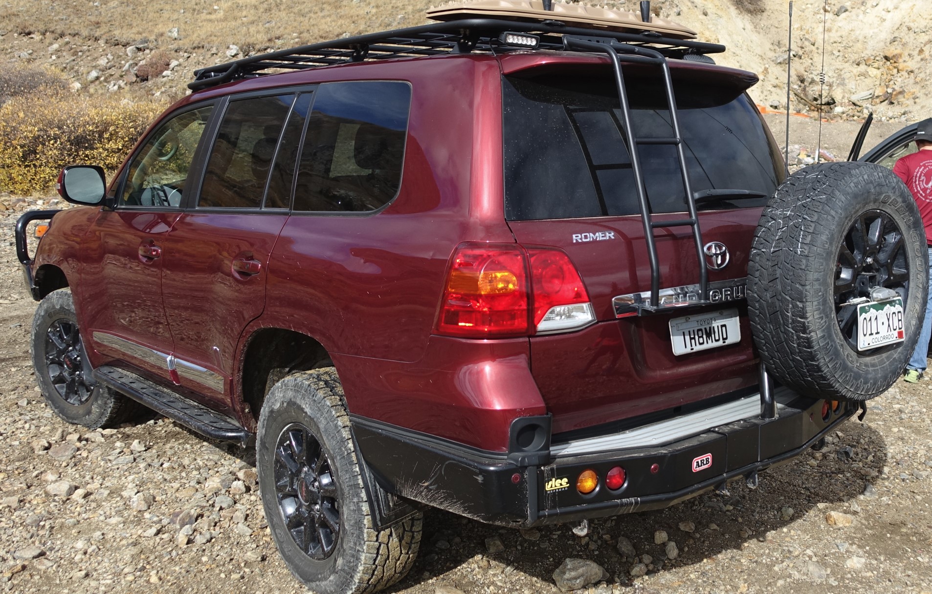

Ill check my archives when I get home. I took the Gobi ladder off as I am having my ARB rear bumper replaced with a Slee Rear bumper.
Romer, Been rummaging through your archives as I am getting ready to get trigger happy on my 2016 200. As you have had the ARB and Slee rear bumpers for substantial amounts of time at this point - what are the pros and cons of each? Which would you buy today and what was the deciding factor? TIA

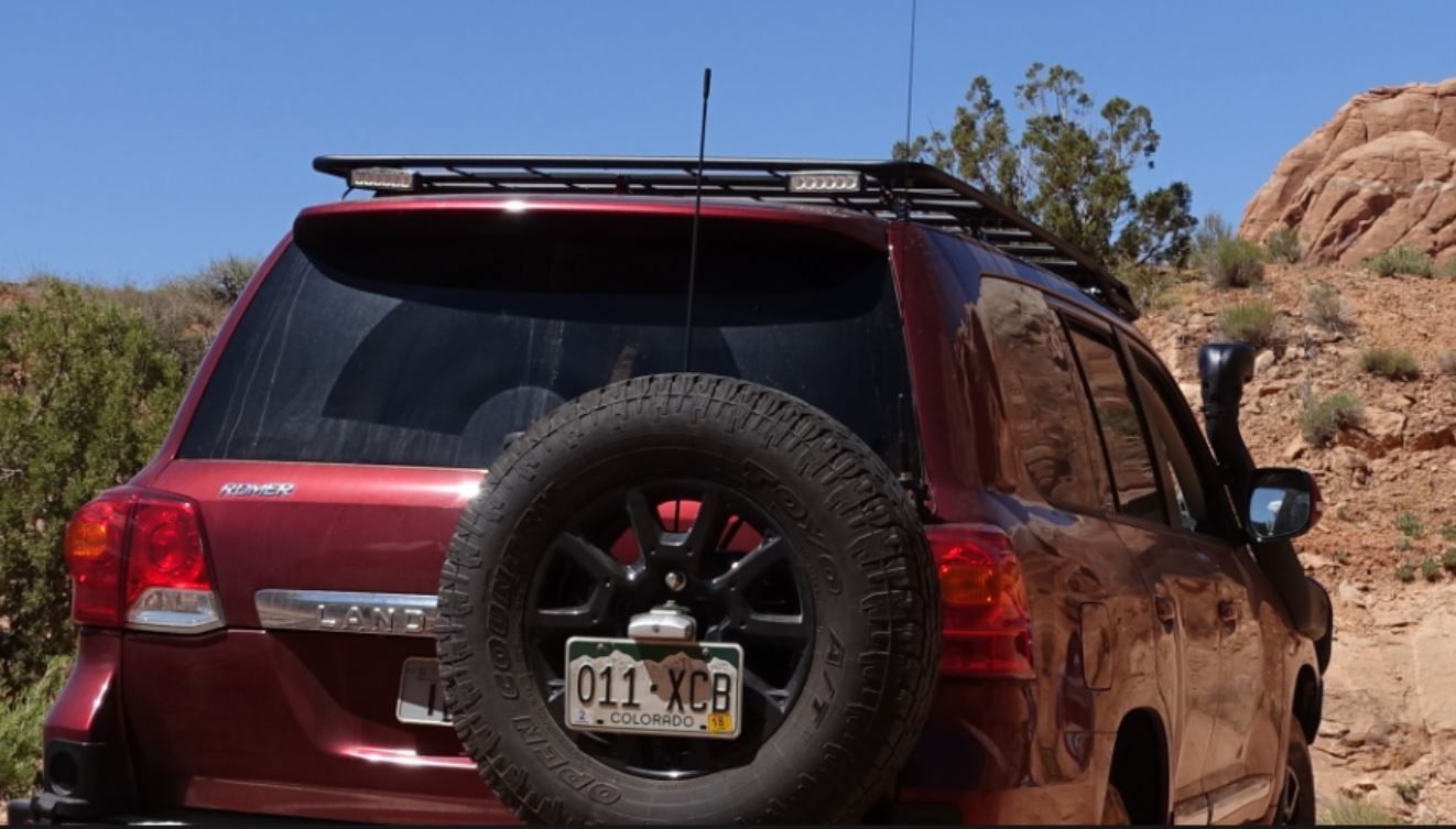

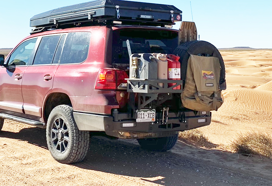

Hey Oakley,
I would buy the Slee Hands down again. The only advantage the ARB has is price. This is for the model with the tire carrier. The ARB non tgire carrier is one peice
The wings on the ARB with the tire carrier are separate pieces and easily get pushed up. Several times I had to get in there and jam them back down.
The tow hook eyelets on the ARB is in the middle of the bumper and gets hit a lot
I think the Slee has better clearance or maybe it is just the eyelets being in a different spot
I like the tire carrier on the slee more. It has a place for the max tracks and a highlift if you have one. The ARB Tire carrier requires an adapter for the high lift which has to be removed to get the spare tire off. The Slee does not require removal. The ladder on the Slee holds the gas/water can box which came in handy on my last trip to the maze
Below the bumper you can see the 2nd spare tire I carry

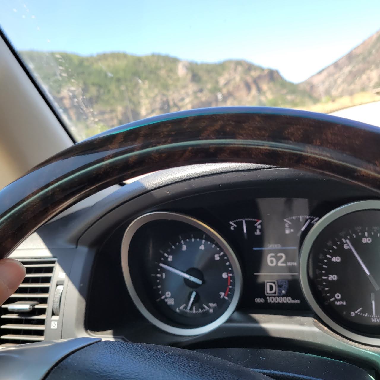

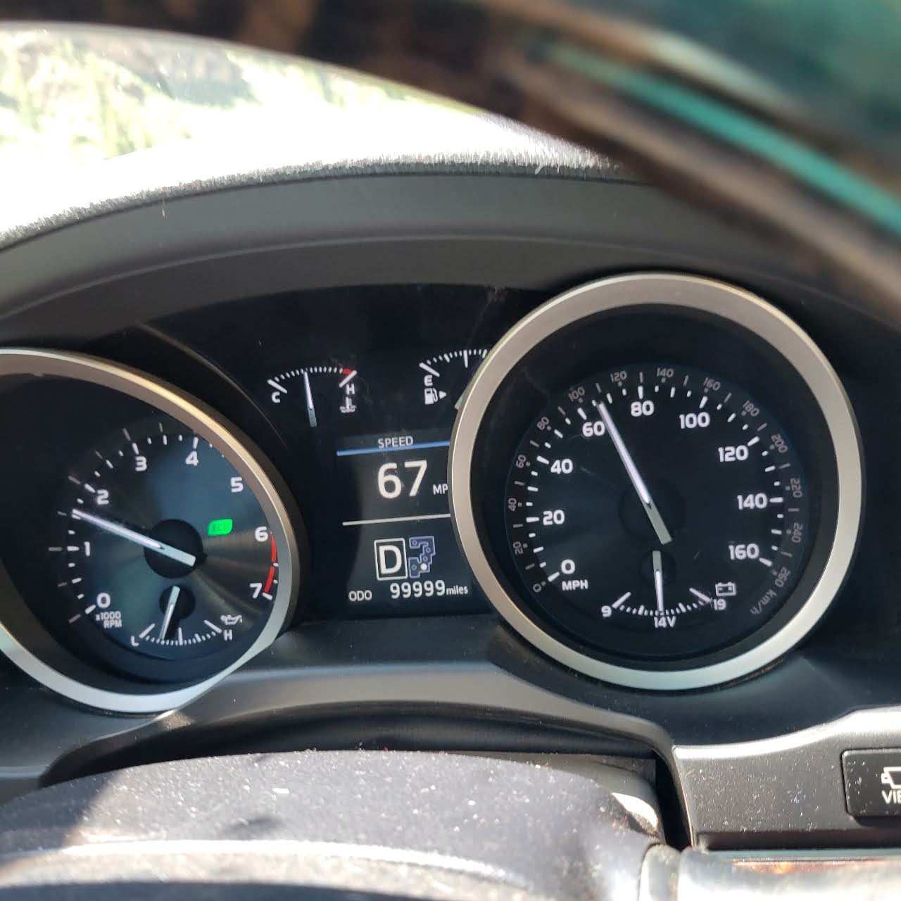

Haven't changed anything . Setup still working like a charm After almost 9 years I did cross 100K miles on the way to Ouray today
