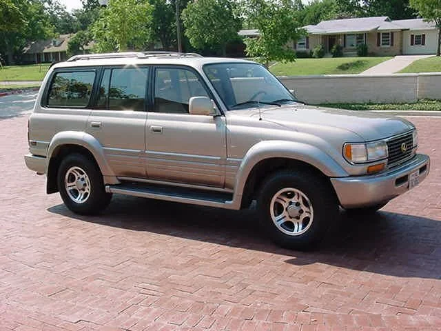

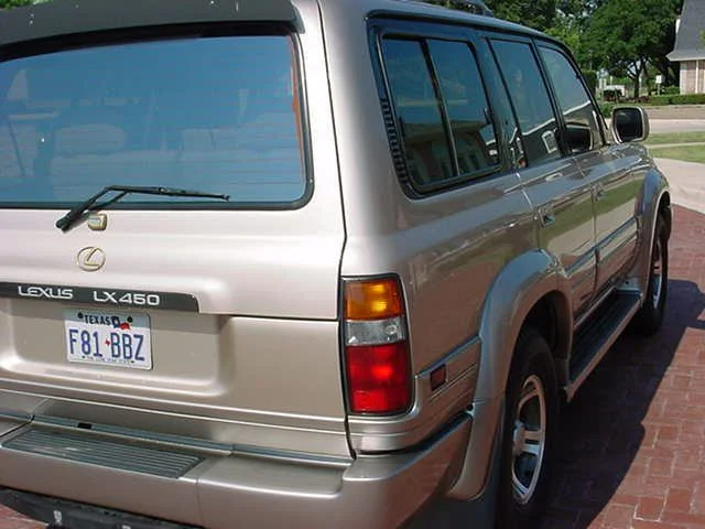

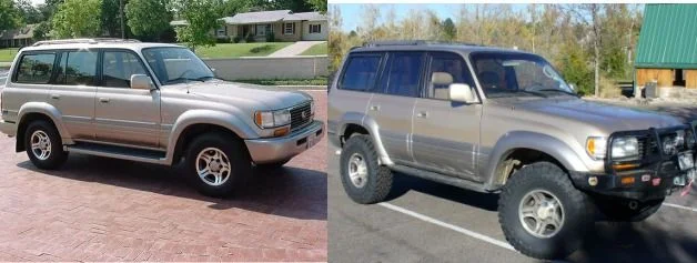

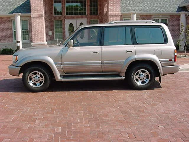

Photos from ebay showing how it looked when I bought it.
attachment.php
attachment.php
attachment.php

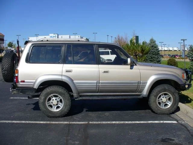

The first Mod I did was buy 285 75 R 16 BFG AT’s. I had 33” BFG AT’s on my FJ40 and was real happy with both the on and off road performance.
attachment.php

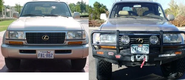

Before Moab 2005, I wanted an ARB Bumper and it was pretty simple to install myself. I also Installed a CB radio in the Ash tray slot (the trash on the floor is the box and other wrappers from the CB- had not cleaned up yet)
attachment.php
attachment.php

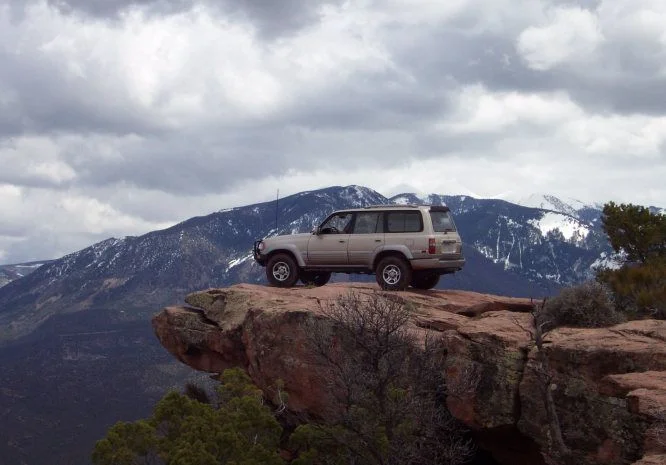

I went to 2005 Moab (with daughterofromer). Moab is awesome and the longer wheelbase of the 80 was perfect.
attachment.php
attachment.php

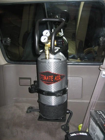

I followed others suggestion and installed my CO2 tank on one of the rear seat brackets:
attachment.php
Brentbba's write up is in the FAQ thread on how to do it here starting in post #28

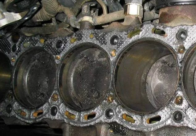

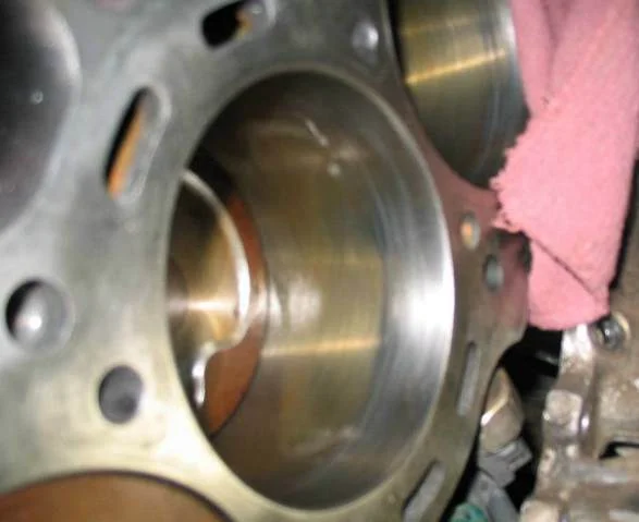

In fall of 2005, I elected to have my headgasket replaced. Robbie was available and had commented that he saw signs it was starting to go.
Head gasket set replaced, New Spark plugs, Distributor cap and rotor replaced, Spark plug wires replaced, fuel filter replaced, EGR gasket replaced, Distributor O-ring replaced, Water pipe gasket replaced, Fan Clutch replaced, Thermostat and O-ring replaced, Throttle body cleaned out and the PHH replaced.
When the head came off I was told there was tremendous buildup of carbon, more than normal for my engine. The pictures below show the before and after shots.
The head was also slightly warped and the valves needed to be resealed. The head was milled .11. It was running pretty good for all that crap. Must have been the computer compensating. It runs great now.
The PO must have run cheap oil and did not change the oil when they should have. They probably ran cheap gas as well.
No one better than Robbie to do this work. I was very fortunate.
Robbie was unable at this level of break down to get the carbon out of the ring packs. So, researching on bobistheoilguy.com, I found lots of praise for a product called AutoRX. I followed the treatment and won't know for sure if it got the carbon out, but over the next 4 months, my average MPG increased from 12.5 to 14MPG. Same style driving and a steady rise over the 4 month period. I can only surmise it did the stuff, making it easier for the rings to operate. I performed two treatments like they recommended.
Also, before all the work, I was burning about a qt of oil every 6 weeks. I have now gone 6 months without burning any oil, or at least the dip stick still says full.

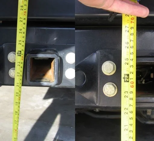

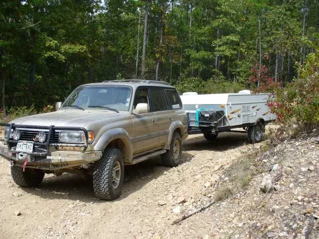

I then installed the Slee Receiver to my Bumper because I was looking for a pop up camper
attachment.php
attachment.php
I then decided on which Pop-up Camper I wanted and found a brand new last years model (2005) Jayco Baja in Rapid City South Dakota for $3500 off. I drove to pick it up and came back in one day
attachment.php

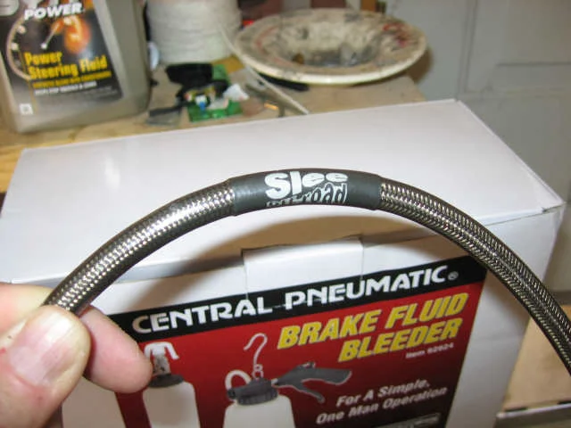

I also decided to swap my brake lines for some of Slee's extended lines and flush the Brake Fluid. I replaced the fluid with Synthetic.
I was flushing my Brake fluid using a Vacuum Bleeder kit from Harbor Freight and had an idea about using it to flush my power steering fluid. I stuck the hose all the way down in the reservoir and sucked out the fluid. Filled it with new synthetic fluid, turned on the truck and turned the wheel a few times. I repeated this step 3 times until only clear and new fluid came out.
It was easy and took 5 minutes. These Vacuum Bleeders are a lot easier for bleeding the brakes as well. Mine was $24 with a 20% coupon.

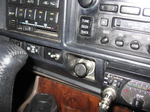

Next I installed a Dual Battery Setup. There are a lot of good choices for a Dual Battery Systems. I debated between them in this thread
https://forum.ih8mud.com/showthread.php?t=93700
I almost went with the painless because I liked the manual configuration. I also wanted to run my accessories off of the backup. )I now run them off the main with the hellroaring
I decided on the Hellroaring system from:
http://www.hellroaring.com/
You get the same manual configuration capability with the other systems, PLUS you get the automatic protection capability. I decided to follow the advice of the manufacturer and have all the accessories run off the main. This meant I needed a deep cycle main battery.
So, I am running a Optima Yellow Top for my main battery and an Orbital for my back-up battery.
I used Cruiserdrews technique and installed the unit and the ground fuse on the backside of the battery tray. I do plan on covering the terminals and battery posts better.
I made one modification to the Hellroaring system not posted here. I took out a cover plate for the a dash "Spare Slot" and drilled two holes. I then took apart the remote case that came with the unit (Optional purchase) and installed the switch and led in the cover plate. This integrated the switch and led into the dash, rather than having the remote box attached somewhere.
attachment.php
attachment.php
attachment.php

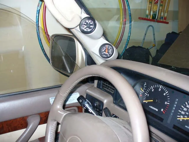

So with the money from the 40, I installed the Supercharger and Supra Twin Fuel Pump, ISSPRO temp gauge and Autometer Vac/boost gauge 0-20PSI. I selected the Supra Fuel Pump because my pump had 125K miles on it. I had already changed the injectors and filter. It was suggested that I also get a new pump, and since I am getting a new pump, I might as well install a Supra Pump as it is Capable of providing more fuel if I later decide to work on the regulator or other components.

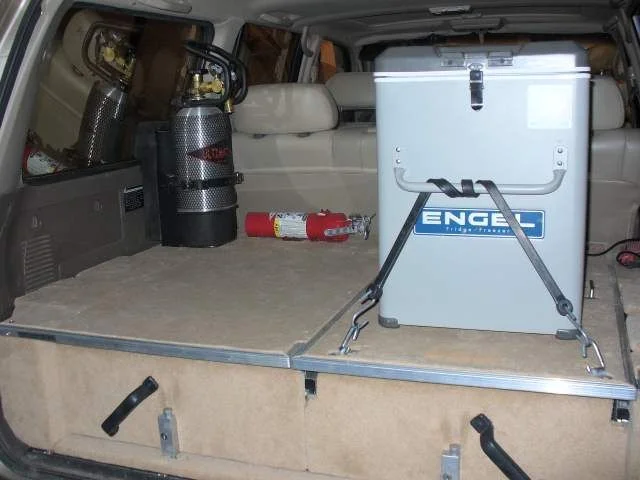

I then visted Christo Slee and bought a set of outback drawers and an Engel Frigerator. (Note: I have since moved the CO2 tank to the other side as it was too close to the Engel :

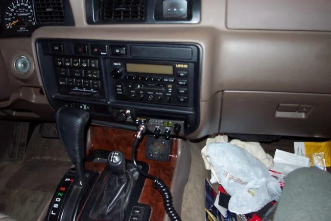

Also about this time, I had my CB tunned and moved the antenna location to the top of the Rear Bumper Tire Carrier. I have a 2ft antenna I use in the city and a 4Ft antenna for "adventures." The truck won't fit in the garage with the 4ft, thus the smaller antenna for local driving. The 2ft antenna with a tuned CB works great for highway driving with others.
I also moved the CO2 tank as it was too close to the engel and installed the fire extenguisher. I glued foam to the backside of the CO2 bracket so it would not bang the window. I painted the foam black. In addition, I installed a 400watt (800 watt peak) power inverter.

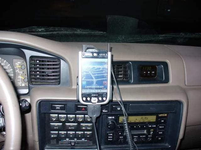

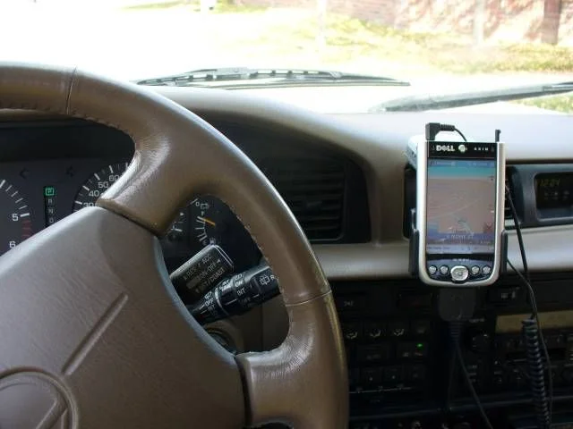

Prior to going to Flat Nasty, My Garmin M3 Ique Pocket PC was stolen and I wanted to make sure I had a GPS System for the long trip. I ended up with a Del Axim x51V PocketPC with a VGA screen. It's awesome. I have installed a 8GB Compact Flash Card with about 70 hours of MP3's and even a couple of movies. I have a 4GB SD card installed for maps and other memory storage. The description and my review of the unit can be found in this thread. I also bought a blue tooth GPS receiver and iGuidance for street Navigation. I still need some topo software for offroad and I am leaning towards memory-map. It's expenisve, but is suppose to be the cadillac of topo packages.
In addition, I looked at buying a universal mounting bracket. They looked junky and I didn't want to worry about my PPC falling off and breaking. So I went to proclip and bought the mounting plate for a Land Cruiser and the PDA bracket for my model Dell. Perfect fit and I am not concerned about vibrations or it falling out:

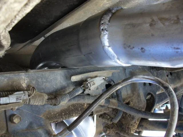

Also damaged at Flat Nasty was some of my Exhaust Pipe and hangers. I took it into the exhaust shop and we raised it up on the lift. I also noticed that the factory crimps the pipe pretty good to get it over the frame, closing the 2.5" pipe down to 1". So instead of repairing what was there, I asked them to ditch the resonator and replace the pipe from the magnaflow muffler back with 3" pipe. I noticed a definite improvement in performance. The thread this is discussed in along with what others have done can be found here. I am thinking it's a little louder than I would like, like a muscle car. I probably next year will add a turbo muffler or glass pak in series to cut the noise down a bit without hurting performance.

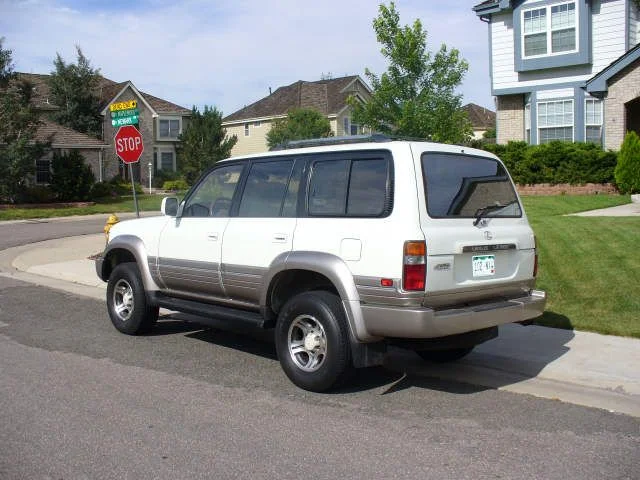

Sarah (Romer's other Daughter) turned 16, so I bought her a 1996 LX450 (no lockers) from Lexusben who had just done the headgasket, fuel injectors and front axle. We of course put the OME lift, ARB and sliders on.
attachment.php

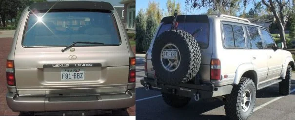

So my LX450 has come along way from Sept 2004 to Oct 2006:
attachment.php
attachment.php
attachment.php
attachment.php
