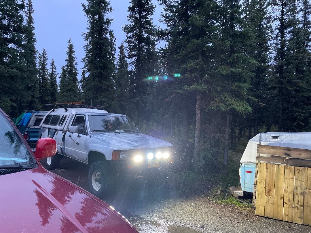

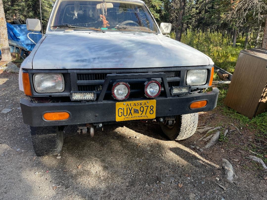

I recently installed/swapped some Anzio 4” HID driving lights for fall use, replacing a pair of 4” LED eBay pod type lights. The wiring for the road/moose lights is sourced from a 60 amp Blue Sea auxiliary fuse panel direct connected to the battery. Circuit uses a 30 Amp Bosch type relay, and 14 AWG wiring, it has been in use for about 5 years- all I did was swap the old lights for the HID ones. I was able to do this after gabbing up some 2” sq tubing spacers to move the bumper out enough to make room for the housings on the Anzio lights.

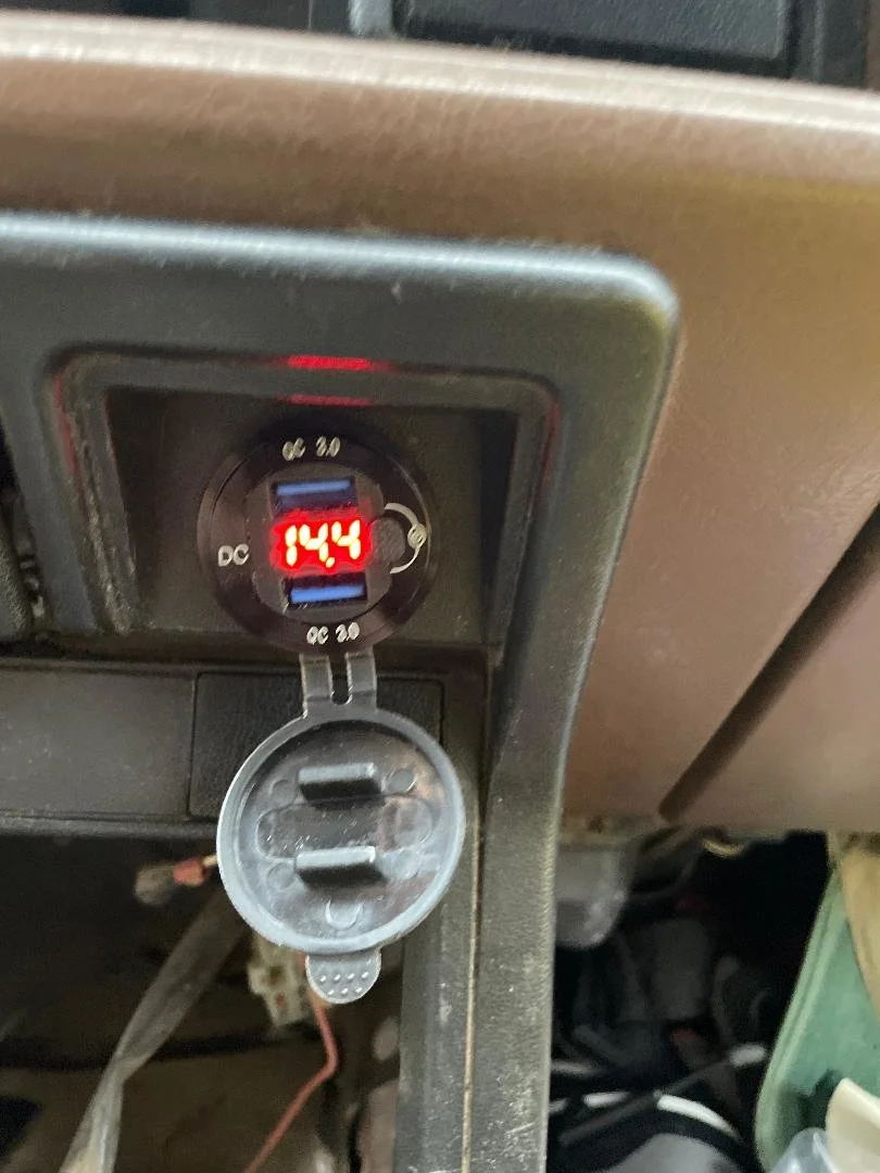

While I was into this I also installed a switchable volt meter/ usb charger.

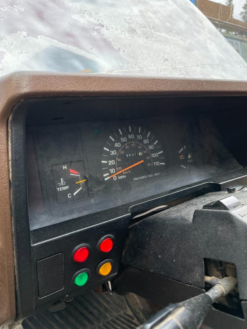

A couple weeks later I started experiencing a troubling random issue. While driving to and from work(and just about anywhere else) the charging light would come on while driving- so I would turn on the volt meter and check the volts, it would read 12.9-13.2(plus or minus) volts then start dropping to 12.7 or even less. Initially this might only last for a few minutes, then bingo charge lights go off, voltage comes up to 14.4 and normal voltage till the next event.

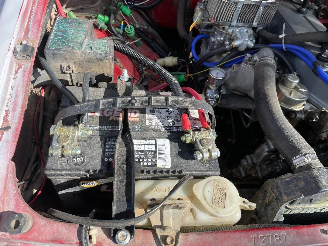

I checked battery connections, looked for loose wiring, tested the battery condition, and charging system. Everything looked good/normal. This normal reading would last for a week or less and occur again- totally random timing, I couldn’t tie it to bumps in the highway or anything else.
Eventually it happened in the driveway, so I tested the charging system using a Solar BA 9, got good reading for the battery, and poor readings for the charging system, while doing this the anomaly stopped and ops were back to normal as were voltages-14.4V. I retested the battery and charging system, and everything checked out good and normal. So I suspected there might be a loose or bad ground, the 6AWG ground cable from the block to the body looked pretty dodgy so I built a new one and hooked it up and tried that.
