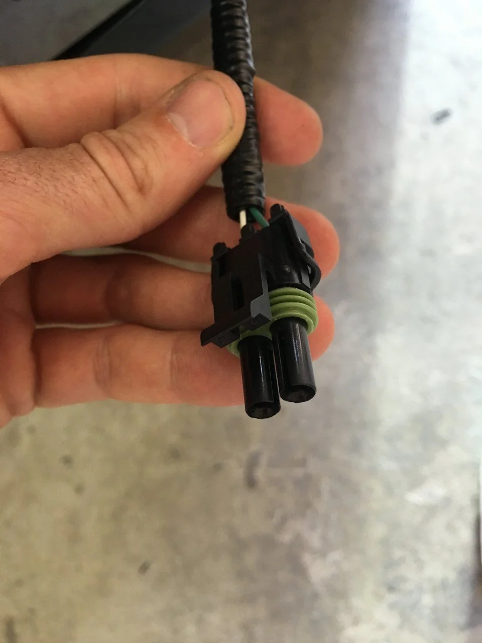

Never liked the scotch connectors that come with their bumpers for taping into the markers lights. So I use weather resistant connectors for the marker lights and weather lock for the fog lights.
Stock connector
My version

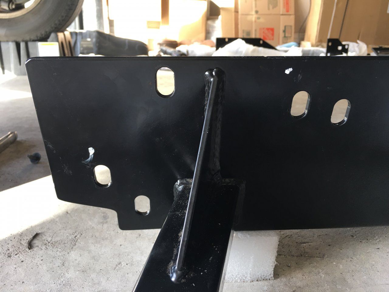

These look pretty good, nice welds, wish they had a kick-out but figured I could add one later. As for how they mount, well... I'm not impressed.

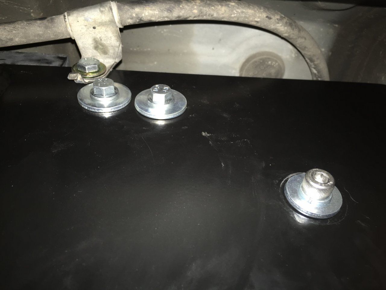

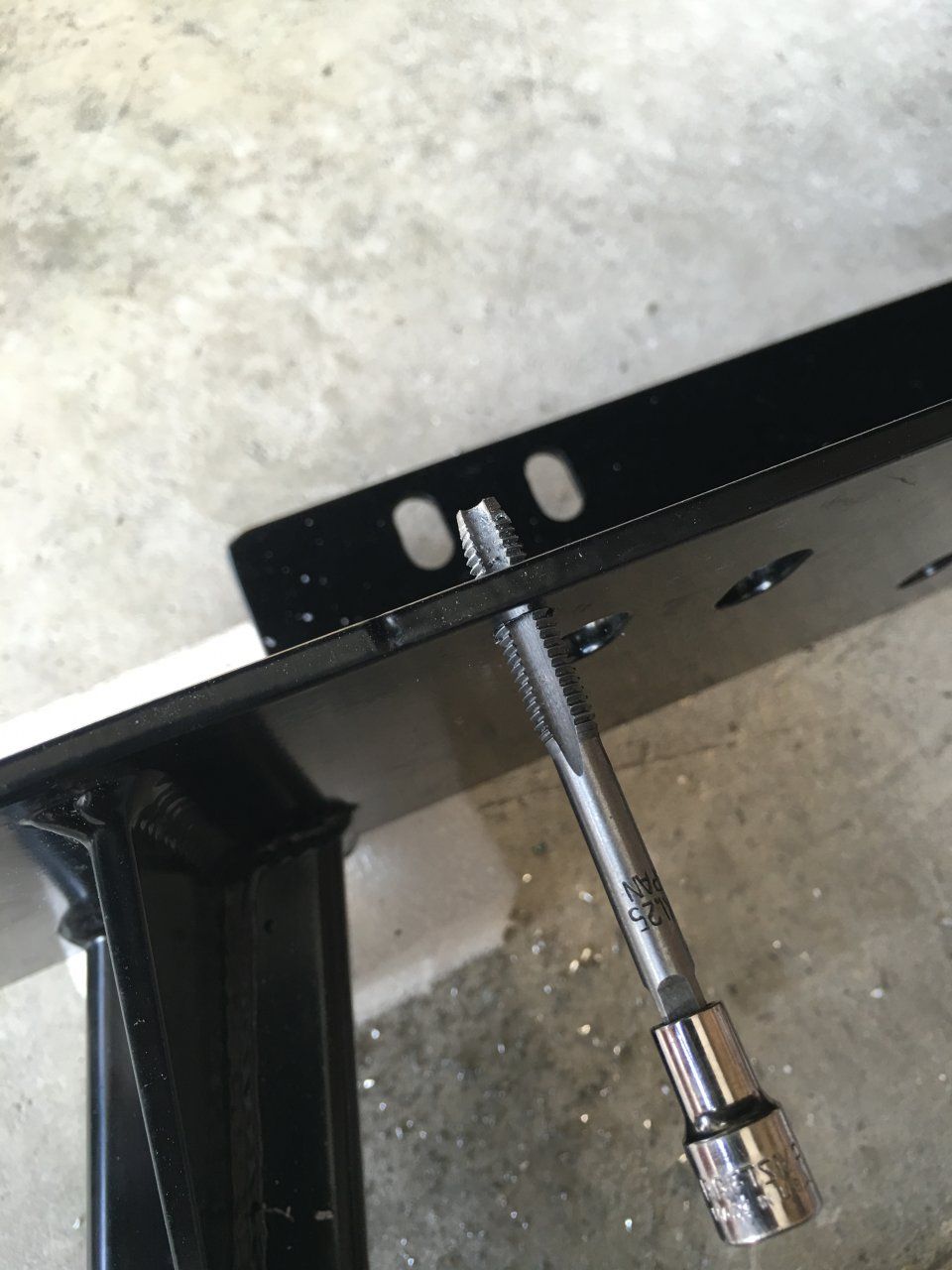

There are a couple holes that could take a rivet at the top of the frame plate, but you can't get a drill in there to enlarge the hole. Ok... well I can get screws in from the back to take care of that, but they should at least address that.
Then I got more annoyed. When they welded the rear gusset for the slider, they didn't take into account the path of the E-brake cable.
Yea, you could just mash it into the gusset with 1 of the 2 bolts, but that's low grade engineering. So I'll be spending some time on an easy solution to secure the cable, but have clearance from that gusset.
After talking to Slee for a week, we have found that there has been quite a few changes to the frames of 200s. My 2011 has different welded nuts and ebrake angles than an 08 or a 14. They are working on a better instruction manual for future buyers.
Either way, ended up marking, drilling, taping, and bolt shortening to make my own ebrake cable routing.

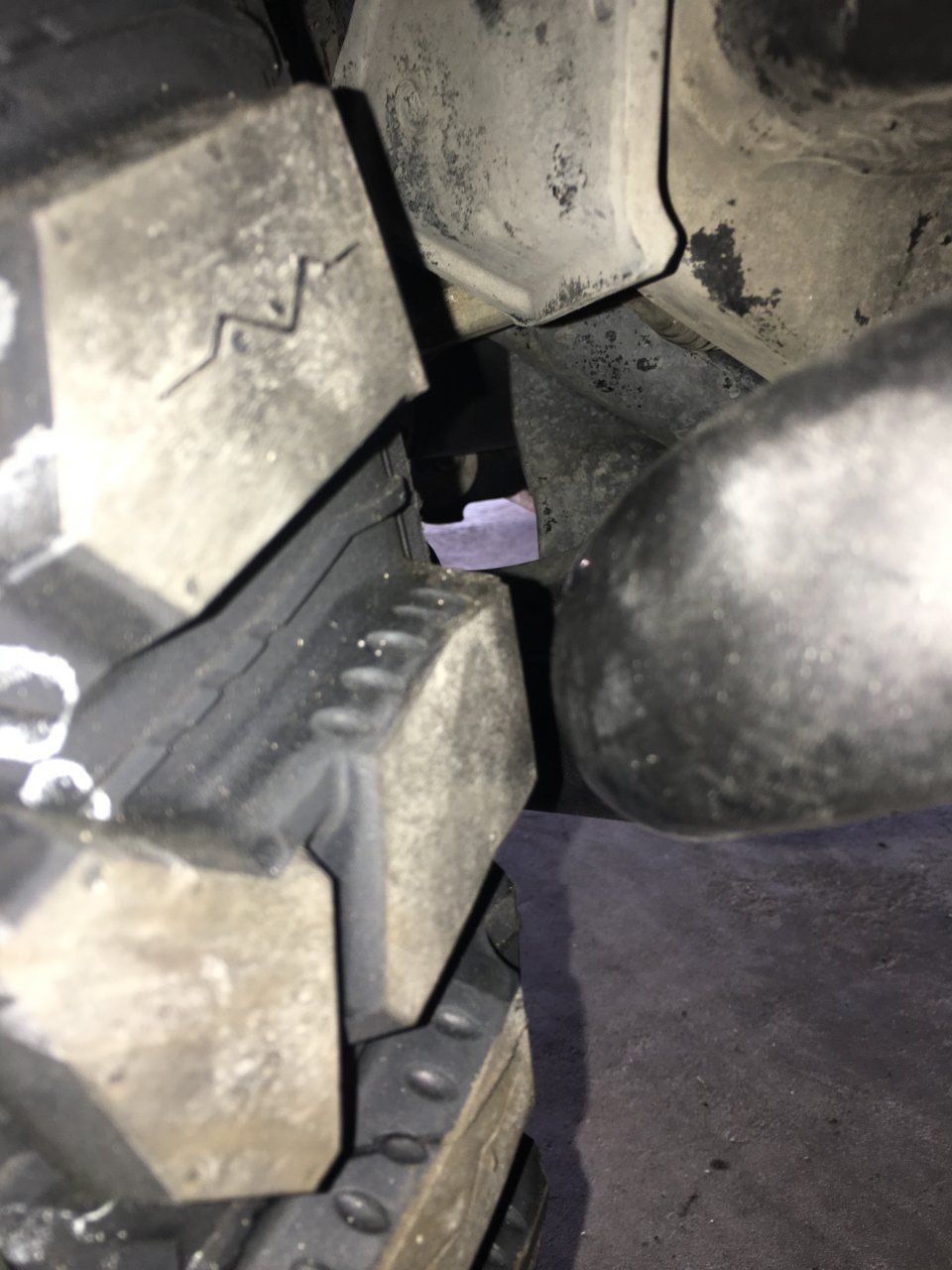

Ok, 295/70r17 Cooper STT Pros on stock upper control arms with a RW wheel does not fit. On full lock, the tire is smashed right into the front part of the arm.
With Total Chaos arms, they fit. I tested without the coil over in the truck and while is is very close, no rubbing at all. So I'll be sticking with that tire for future east coast mud. These tire will do a trip to SoCal for a month, then drive across the country while towing my FJ. Guess we'll see how their road manners are.
Tire to upper arm at full lock.
Tire to sway bar at full lock

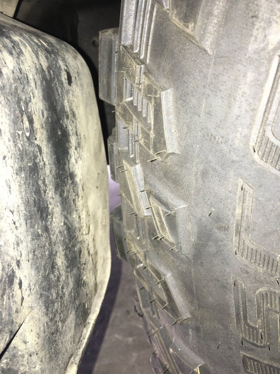

Tire to rear mud flap.
Get to trimming
I am sorry about the confusion on the install and that you are not 100% happy with the product. We always appreciate feedback.
We probably have to add some more details to the instructions. Somewhere along the line Toyota stopped putting the captive nuts in the holes on the frame. Once we discovered that we added another hole to the front foot and provide a "lolipop" nut on a stick that can be inserted into the frame and the the top of the foot can be bolted down. The top holes became redundant and does not need to be used, but we still left the hole for the vehicles that have the captive nuts. We are aware that you can not get a drill or river nut tool into those holes. We could look into providing a 2nd lolipop to use as a backing nut, but getting up installed there might be difficult.
We have always just installed the cable into the existing holes. The frame / slider and gusset are all tied together so we have never worried about rubbing on the e-brake cable. We made the gusset as tall as possible for strength. We could probably do a slight relief on the gusset and we will look into that.
