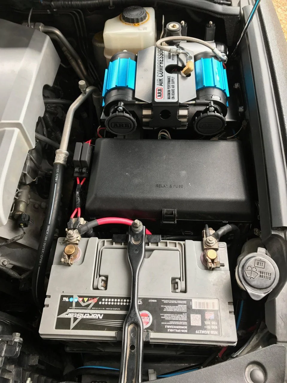

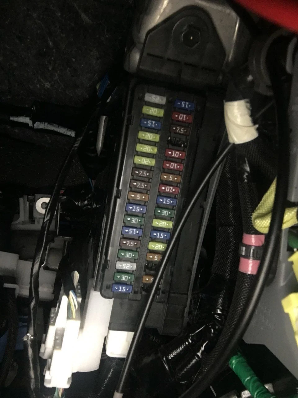

Now just plug it all together. I used the AAC port on the interior fuse block that was already open, you can see it at the top right of the picture below, remember to plug it in with the wire running toward the center of the truck.View attachment 1370170
I choose to run the power for the compressor off the main battery and not an auxiliary battery. This compressor uses a lot of power, and i'm only refilling tire pressure when I come off trail and hitting road. So the engine was just on, and will be turning right back on to charge. Plus this is also powering lockers, I want absolute reliability to activate lockers, even if the power distribution for a dual battery setup fails. Seen National Luna and IBS both fail. Also, the compressor will turn on depending where you place the "tab" on the interior fuse block, and not if you attach the compressor power harness to the starting battery or auxiliary battery. There are some fuses that are alway on in the fuse block, just use that cheap power tester to find one if you want to turn the compressor on without pressing the vehicle power on (no matter what you don't need to turn the motor on).
I ran the positive wires right off the battery post, and the ground wire down to the chassis as to hide as much as possible. The compressor fuse blocks have a nice hole for mounting in the bottom, and two zip ties connected it to the stock fuse block harness, which keeps inline with trying to make it look like things are suppose to be there. After a lot of playing, the hose that comes with the Slee kit is too long, and I'll source a shorter steel braided line (that this will get hot enough to melt a plastic line), but this was the way to get the lines as low as possible for what comes with it. The brass 90 degree fitting will touch the hood heat shield a tad, this is where I would of liked the whole Slee mount to put the compressor lower, even by 1/8" at minimum. But i'll find a lower profile 90 degree also.
Winch power, air compressor power, and fridge always on power connected. Fridge will move off starting battery once the aux battery is in. I will also source a dust cover for the inflation port. But you don't need a massively expensive and complicated electrical system. You can have a winch and lockers with tire inflation, and a fridge in the back, without adding fuse blocks and spending more money and time that could be used for adventures (cause that's the point right) and still have a clean look.

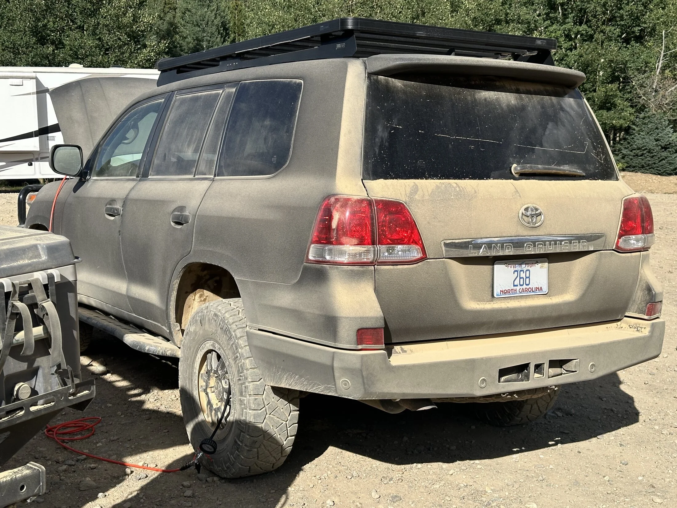

The Slee rear aluminum bumper and a lot of dust:
