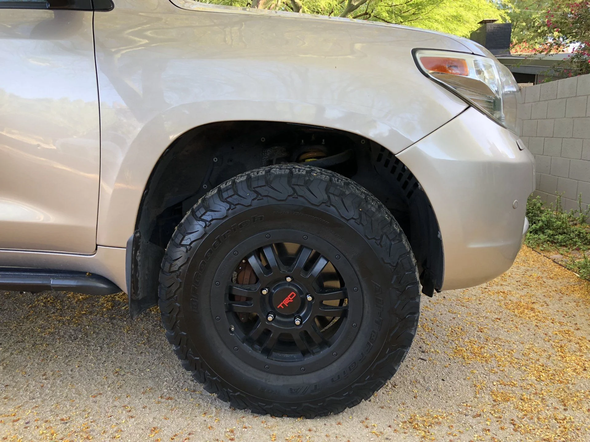

I have 17" rock warrior's on my 200. Currently, I have some generic lug nuts that came with the wheels. I had numerous people tell me it is important to use the proper lug nuts with the conical washer seat to not damage the wheels. So i finally got a set of the Mcgard ones as i wanted black to match my powdercoated wheels. Expensive little lug nuts i must say. These are what i got from amazon :
McGard 65315BK Chrome/Black Cone Seat Spline Drive Lug Nut Set.
https://www.amazon.com/gp/product/B007QB5A56/?tag=ihco-20
So, maybe a dumb question, but is it very important to tighten these to the correct torque? I think i saw somewhere in the rock warrior documentation that 97 ft-lbf was what was spec'd. I don't actually own a torque wrench so just wanted to see how important this is, and general advice on install. Do i need to jack the truck up, hand tighten 1st, then lower the truck and finish tightening? Any advice appreciated. Thanks
