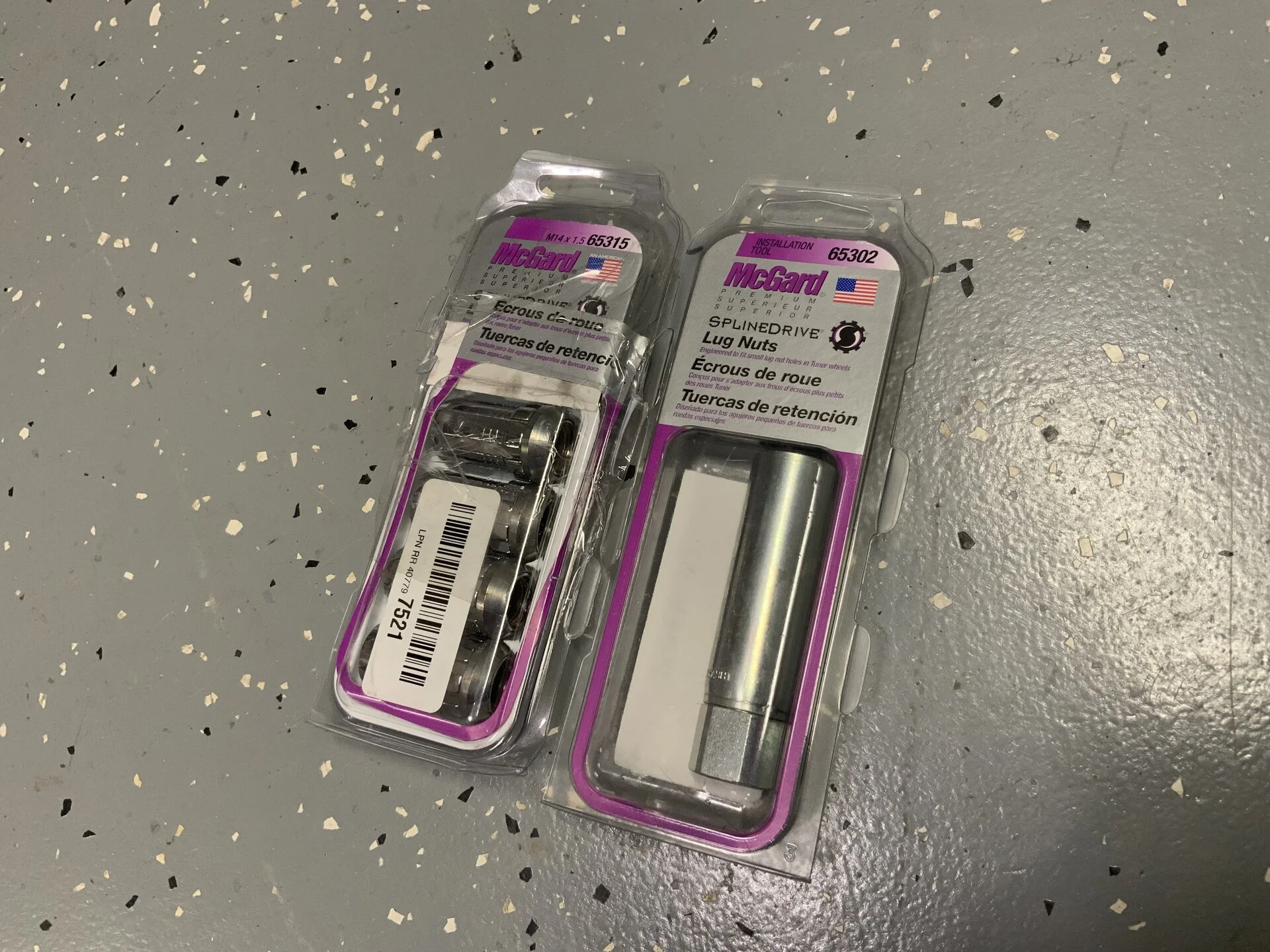

No, you need these:

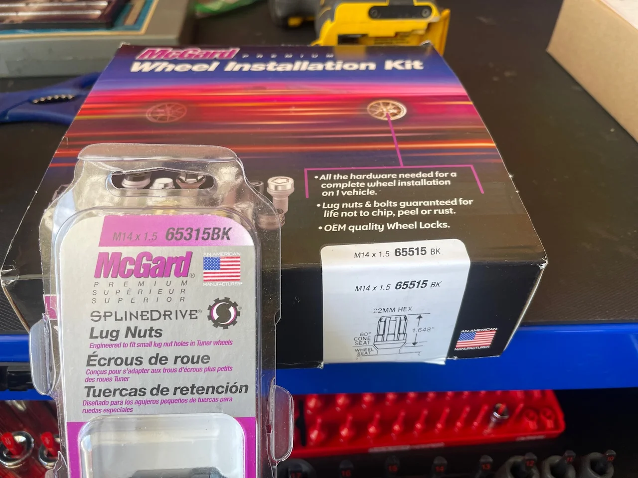

There is a 4 wheel set with wheel locks for the McGard lug nuts that comes with the spline socket and lock key. Note that the part number is different from the set of 4 lugs (65515BK) but they are the same lugs.
I bought both because I didn’t want the wheel locks on the 4 tires. I will use them on my swing out mounted spare.

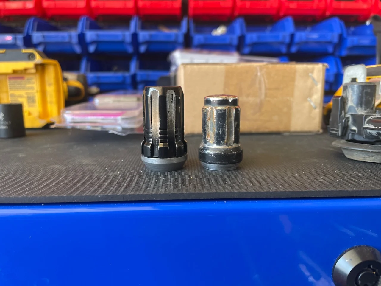

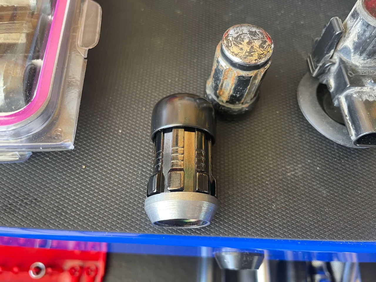

You can also get much cheaper Gorilla 14x1.5s but they are, well, cheaper. I have used them for several years and had no issues other that the black paint getting scratched off very quickly just from the spline tool.
The McGards are slightly taller/longer. McGard also makes an even longer 14x1.5.
McGard 20 lug plus locks kit comes with these rubber caps. I think just to protect them as they are packaged in a bag. Maybe could use the caps when wheeling in the rocks.

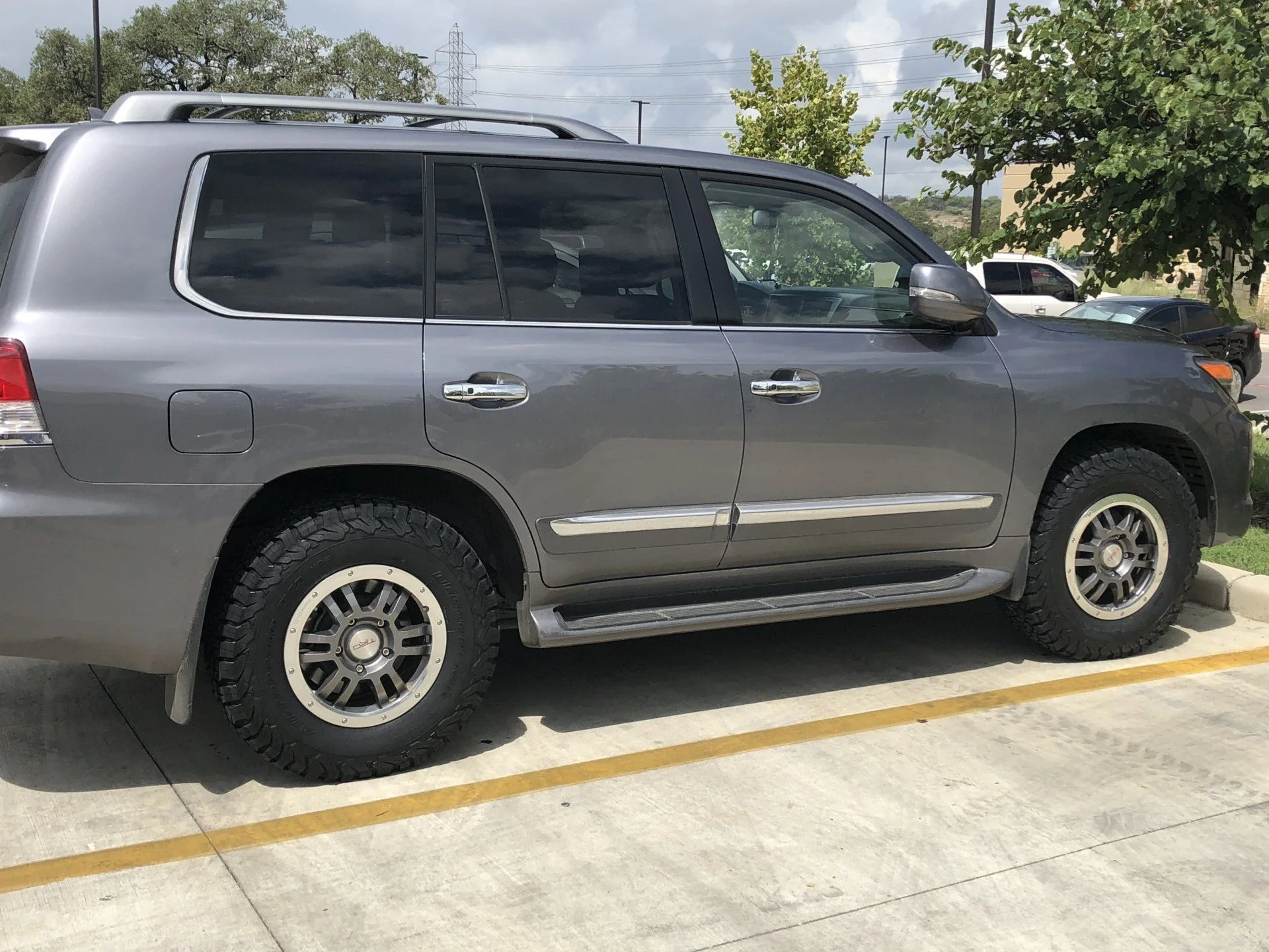

Finally got a hold on some KO3s and will get the RW on finally!
Verified that my existing TPMS sensors will transfer over and picked up some spline lugs.

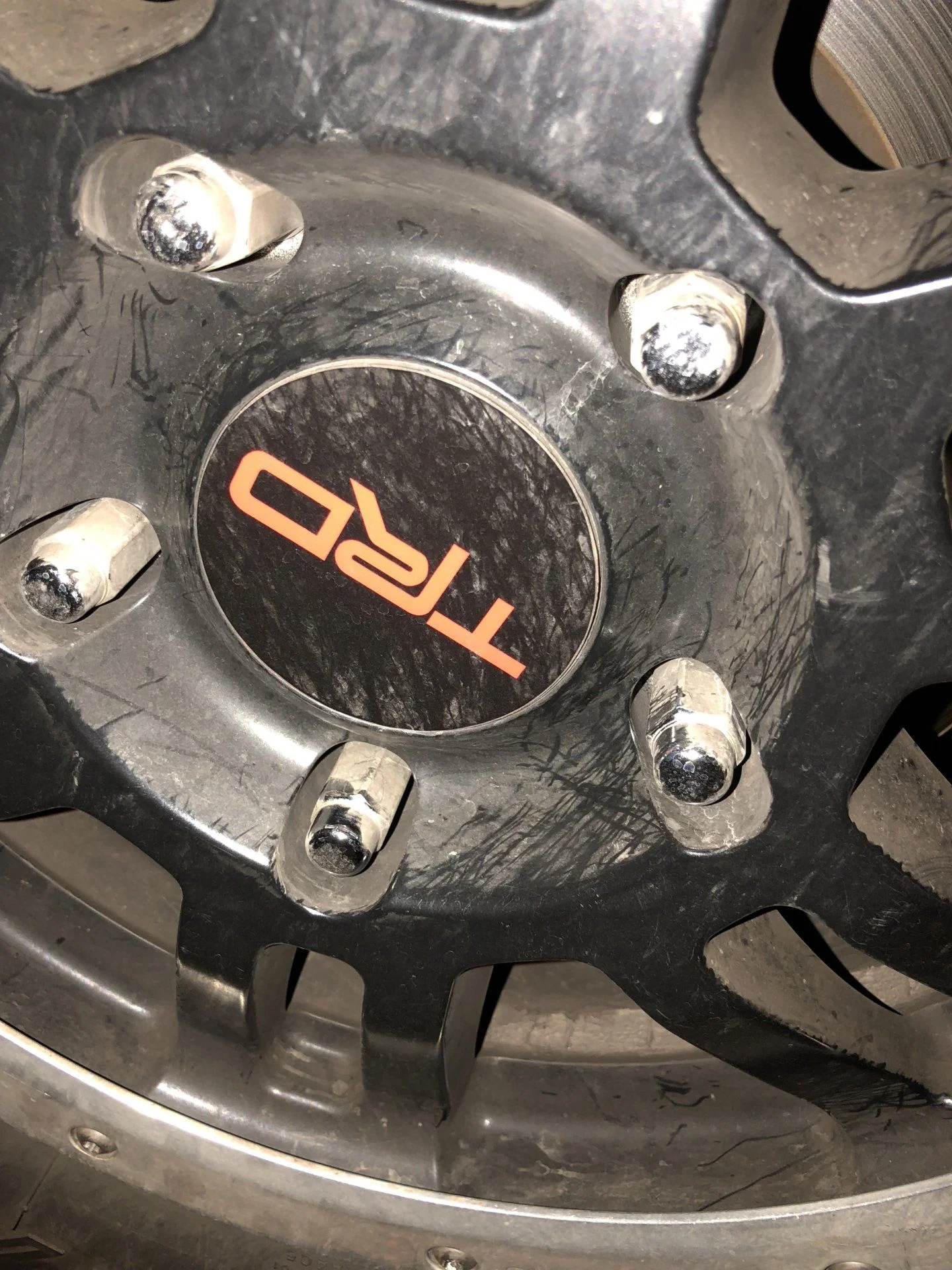

Anyone know the proper torx bit size for the ring fasteners?
Any ideas on where I can find “new” center caps. I have em but a bit worn!
T30 IIRC.
