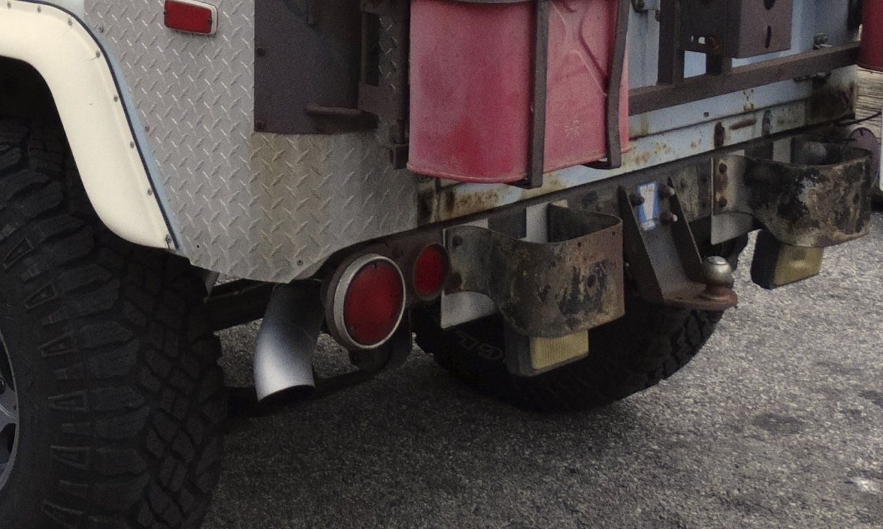

I cut a sheet of aluminum that would mount between the bumpers and the frame. I then mounted a set of fog lights to the aluminum and wired into my backup light wiring. Not wanting to blind the innocent around town I also wired in an "arming" switch. Switch off means no backup lights, switch on plenty of light. The nice thing is that when wheeling in rough terrain the lights tuck up behind the bumpers for protection.

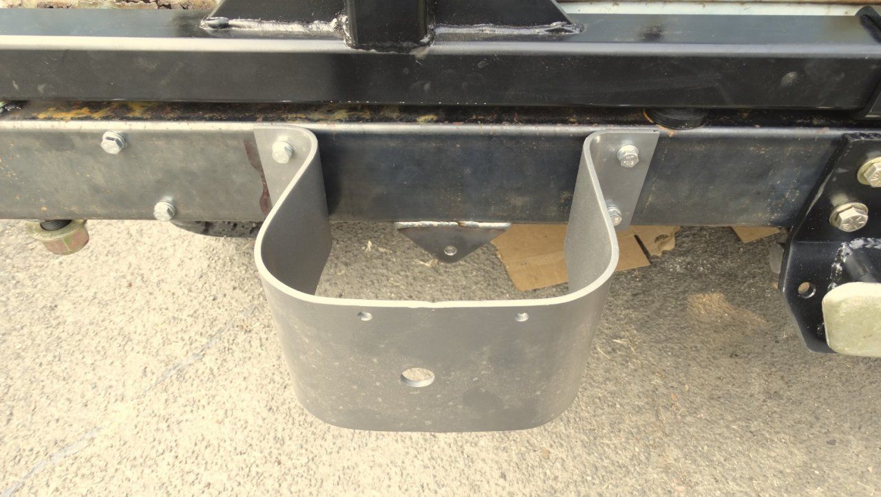

When I built my new tire carrier I simply welded a tab to the bottom rail which still allows the lights to be folded in behind the bumpers.
