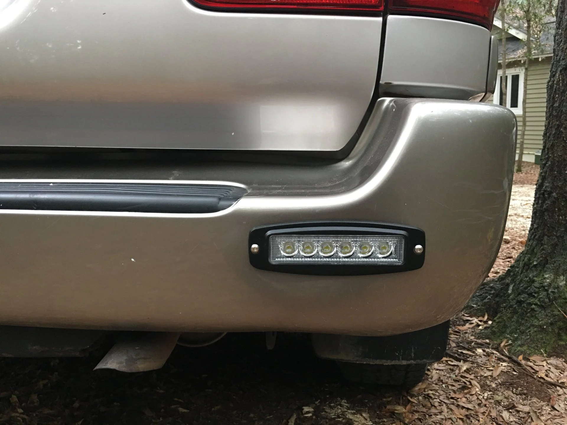

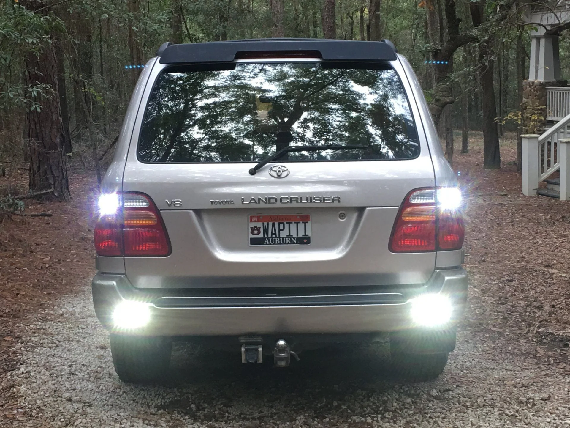

This is what I did yesterday to increase my reverse visibility.

I only spliced them into the reverse wires making them come on automatically in reverse. No switch. Mine are mounted where reflectors were. Have to take reflector off then cut out holes to mount new light flush with bumpers.
I will take more pictures if and when I decide to install these lights on my other two Hundys.
Awesome!!! I totally forgot until you just said that. Once I realized I couldn't do the square ones, that was my next thought. Glad to see someone's put it in practice. I'll order a couple of those single row lights today. Thanks.
