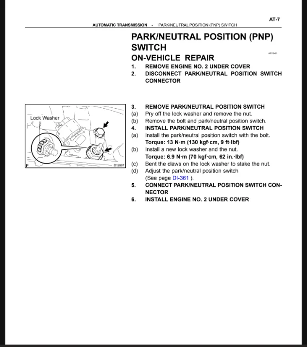

Help, reverse lights aren't working on my sons 2002 LX470

It's not the fuse or the bulbs. And I can't find anything on youtu.be that shows where the reverse switch is. From what I can gather, there's a switch on the shifter somewhere? And a switch on the transmission? Anyone have any pictures of what I need to be looking for?
This trouble shooting is from 2004 FSM but it should help:
