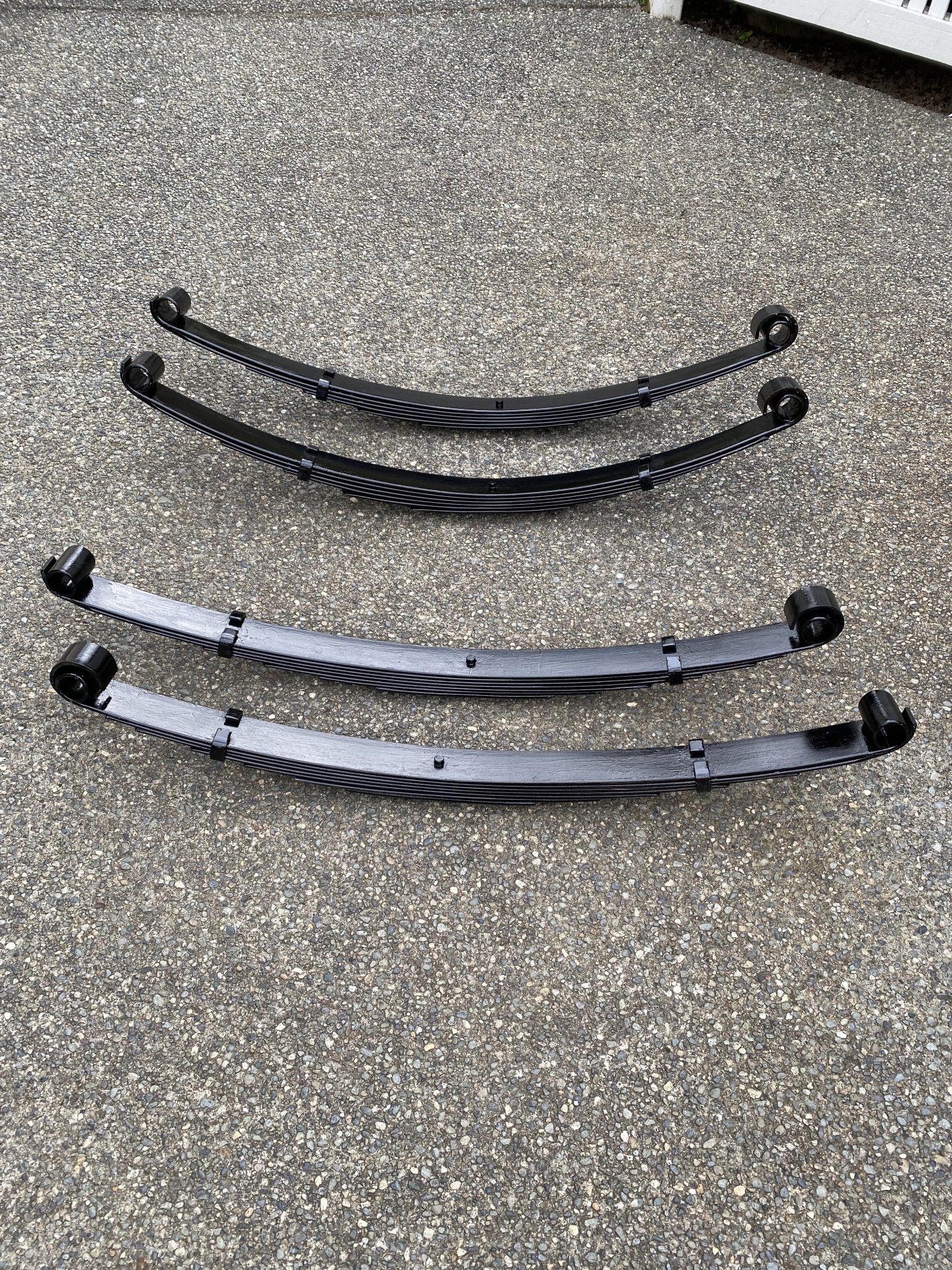

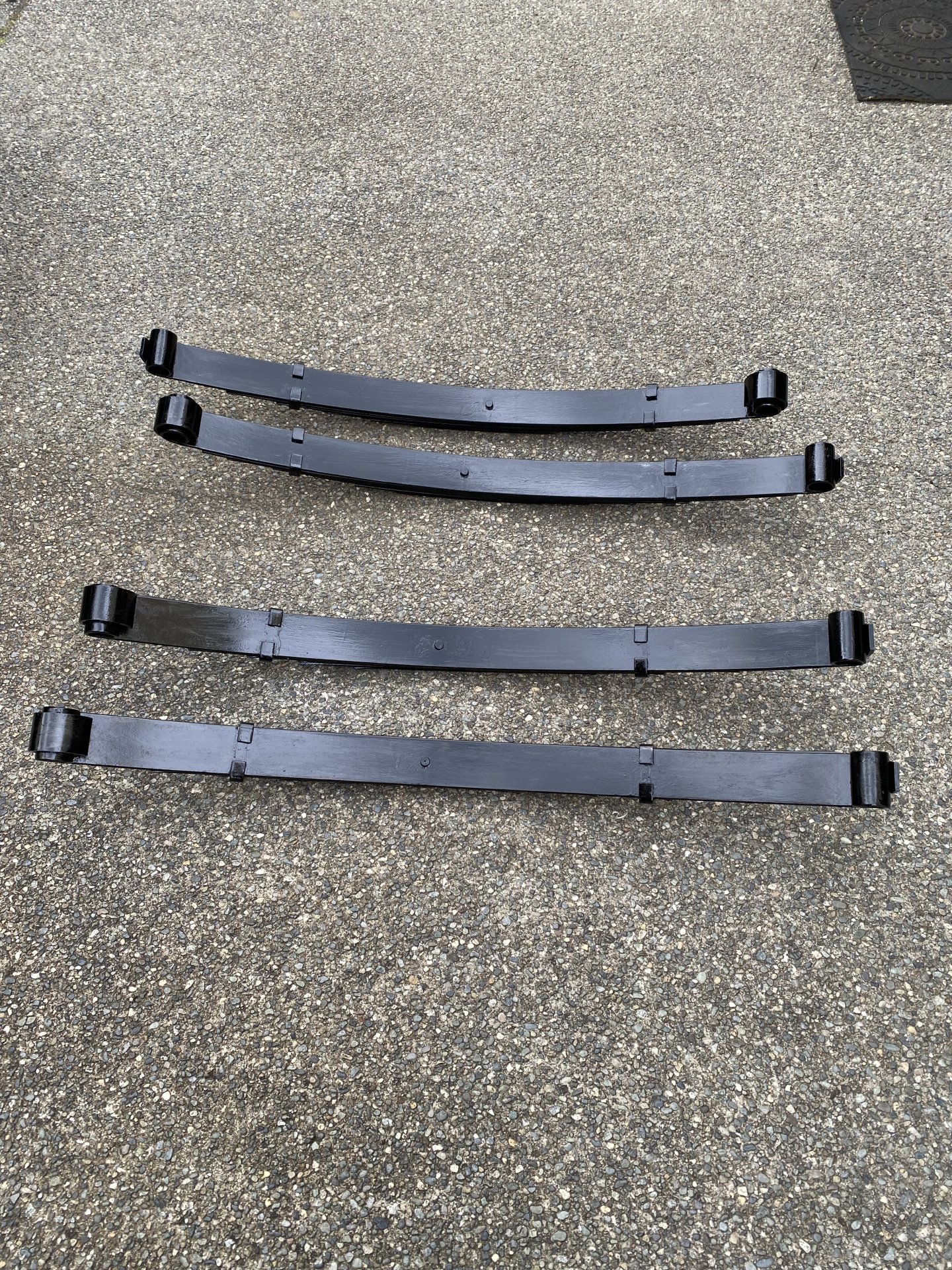

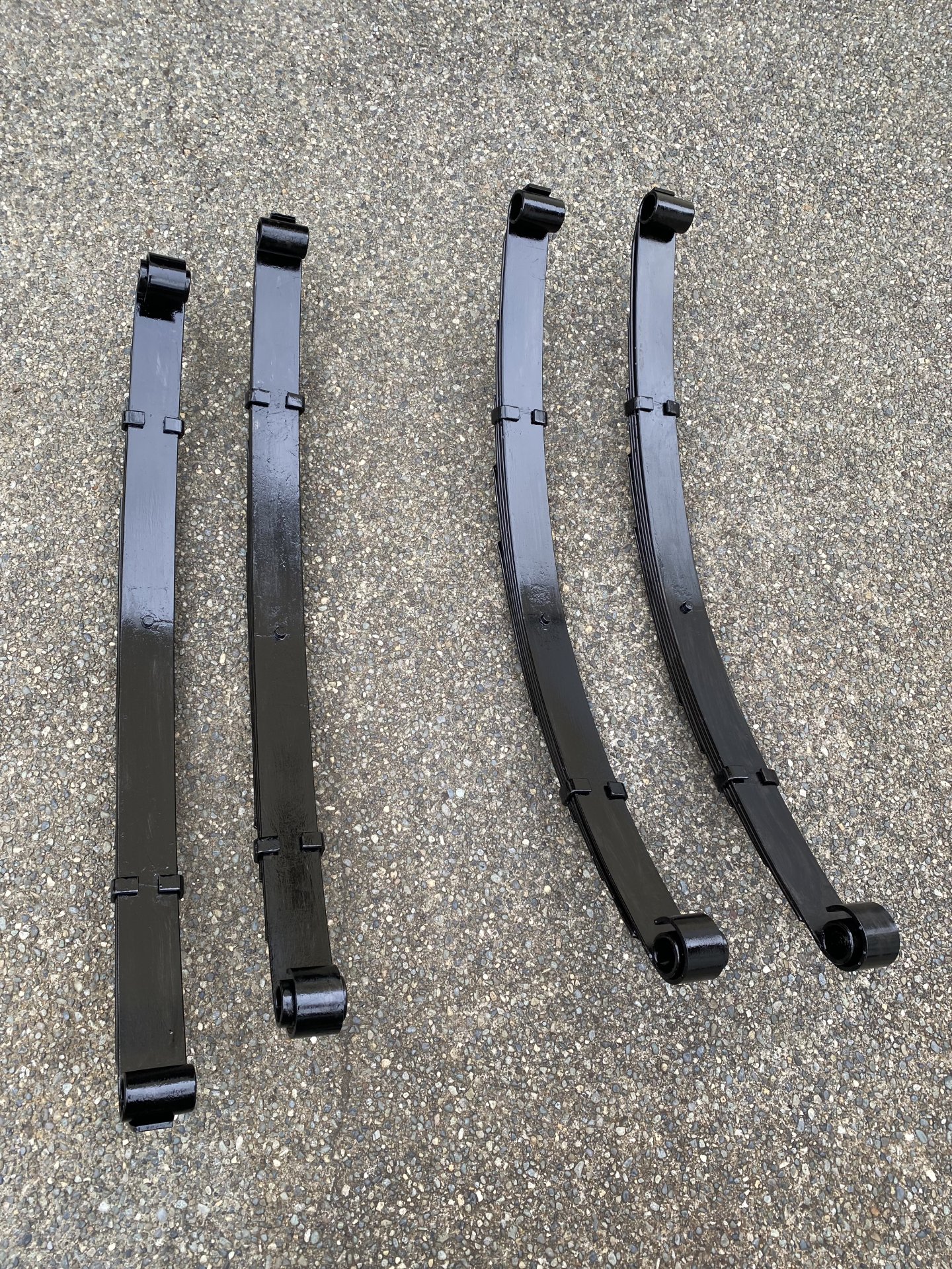

Still have my OEM’s that were okay, just a little saggy. I fixed them up, degrease, wire wheel, seal coat of paint, but they could use a re-arch if you wanted them to be more supportive. They’d also be great for a spring over. I’ll PM you to see if you are in the area and are interested in them. Too expensive to ship but I’ll let them go cheaply if you’re in the WA area for pickup.
