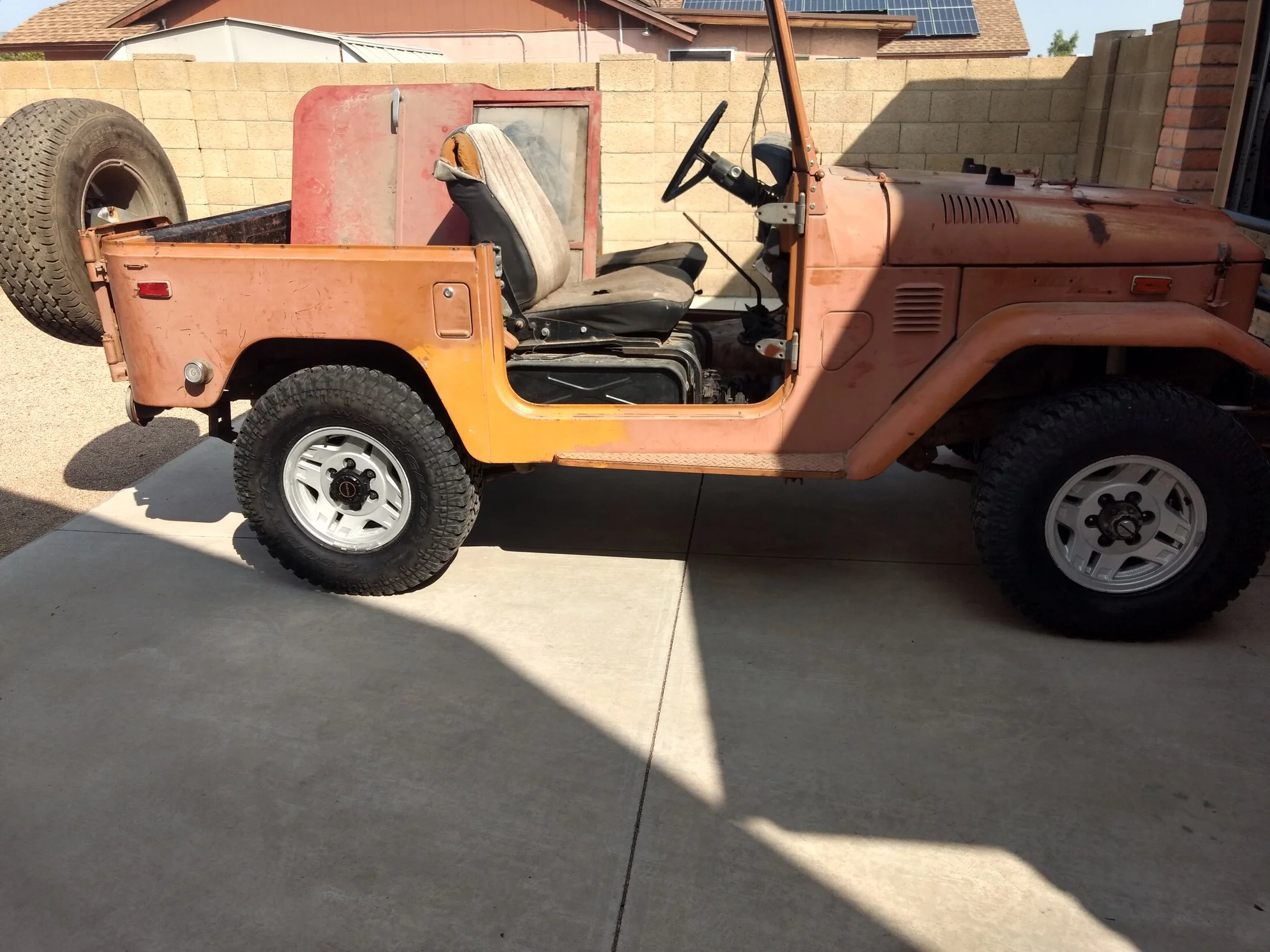

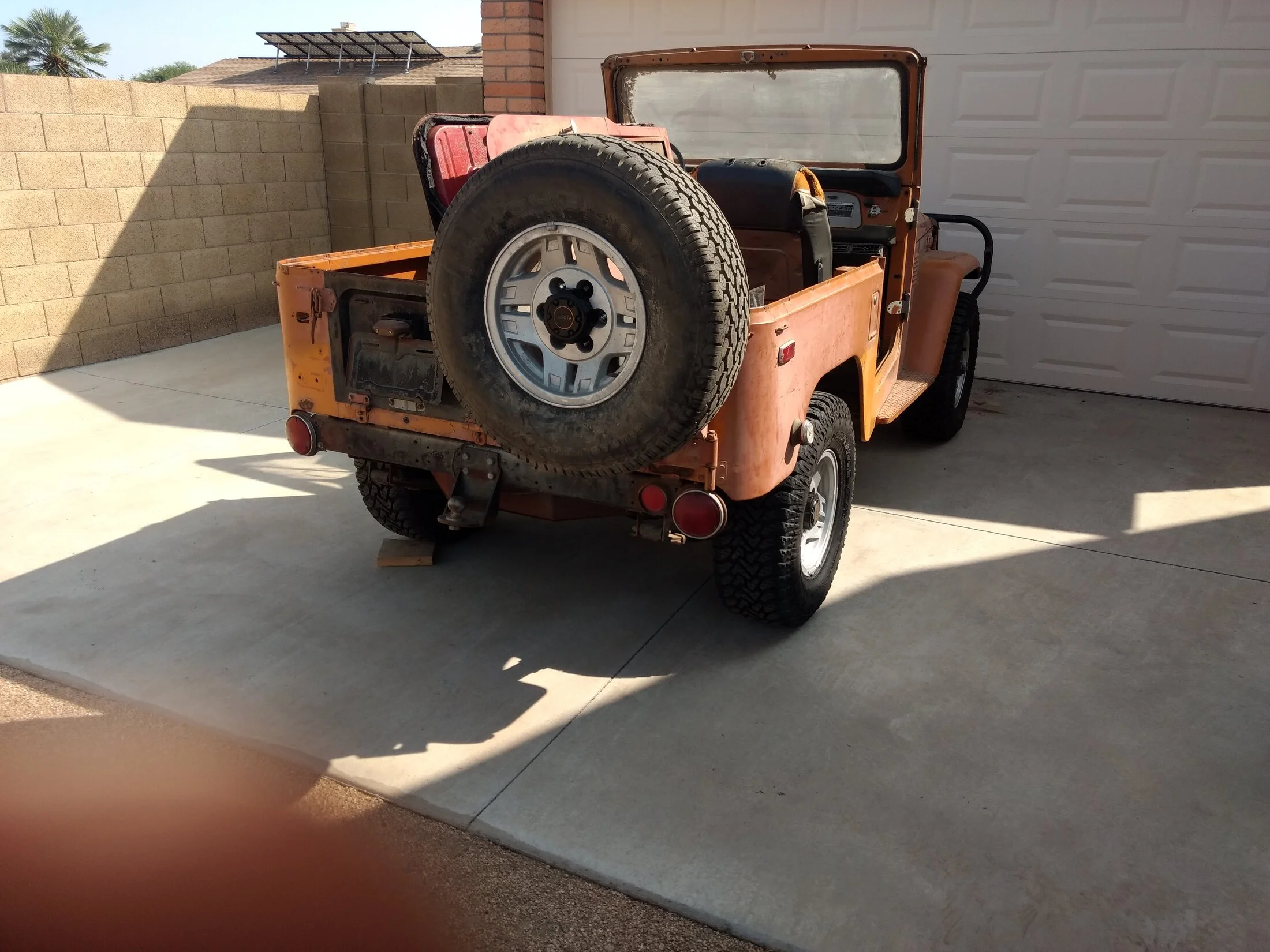

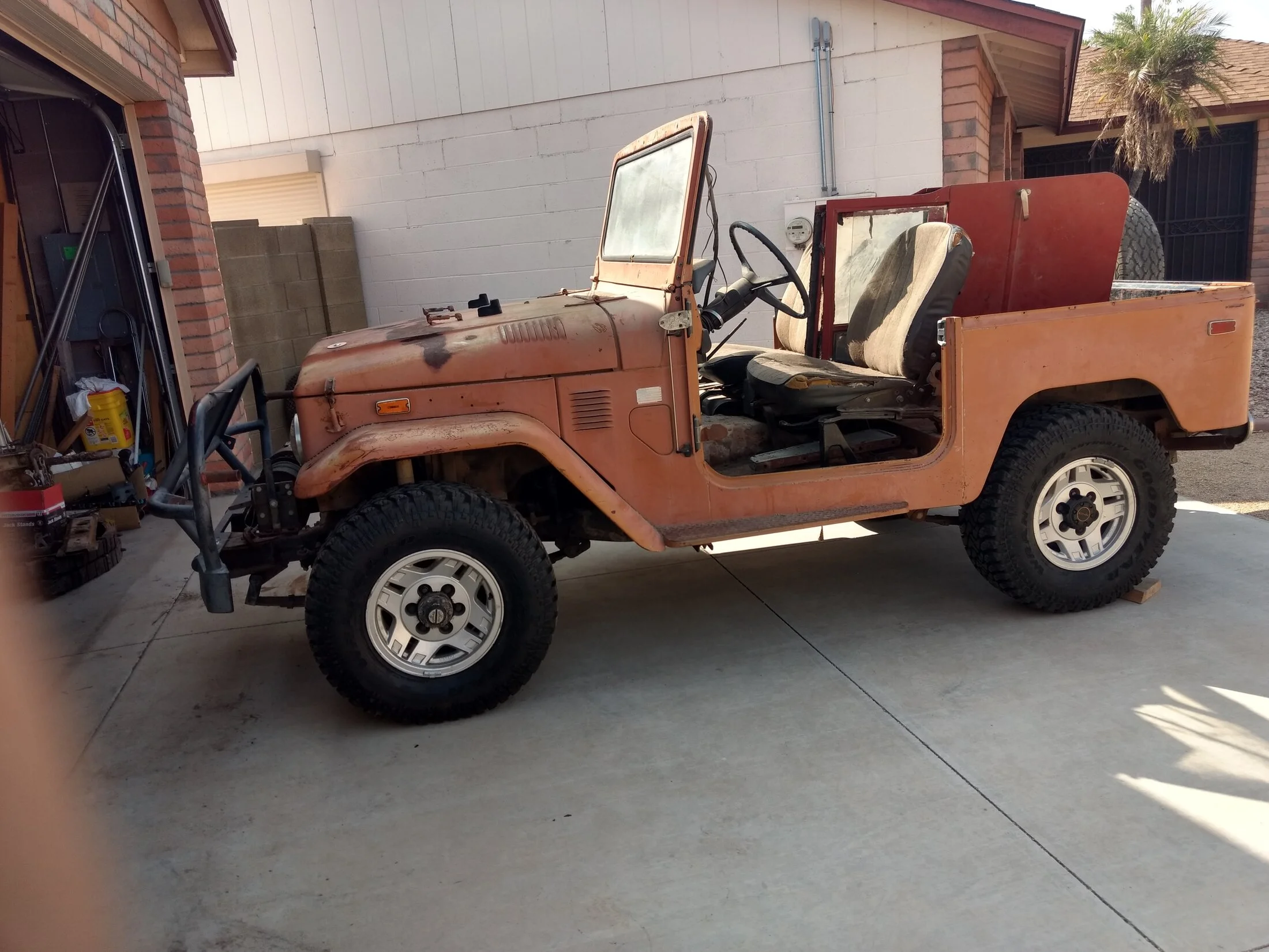

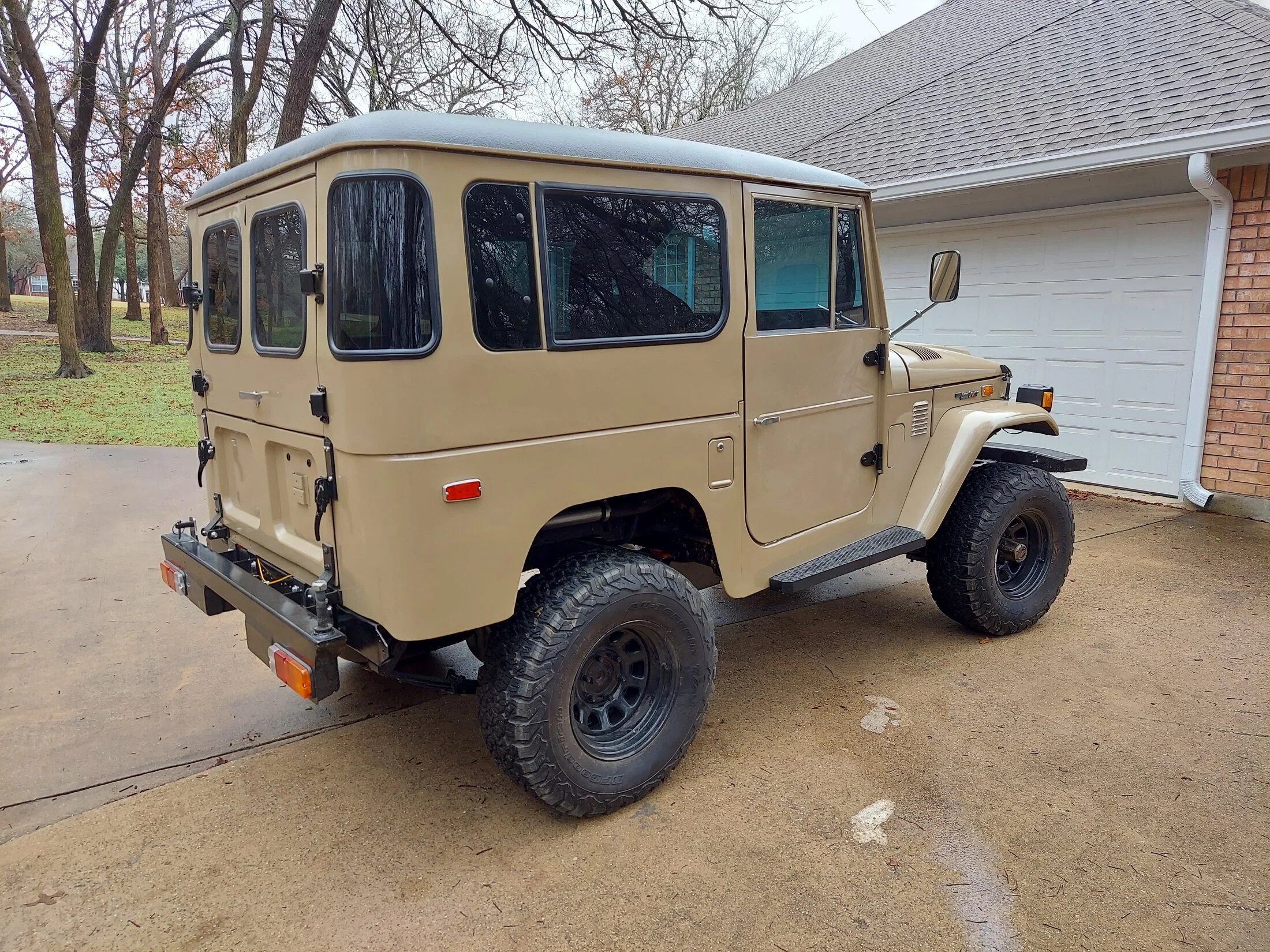

There is no lift on this. No spring over conversion. Nothing.
The tires are 31" tires. Why does this FJ look like it rides high?
When I look at other FJ40's this seems like it is exponentially higher.
1... it has new springs
2... it had the rear wheelwell cut

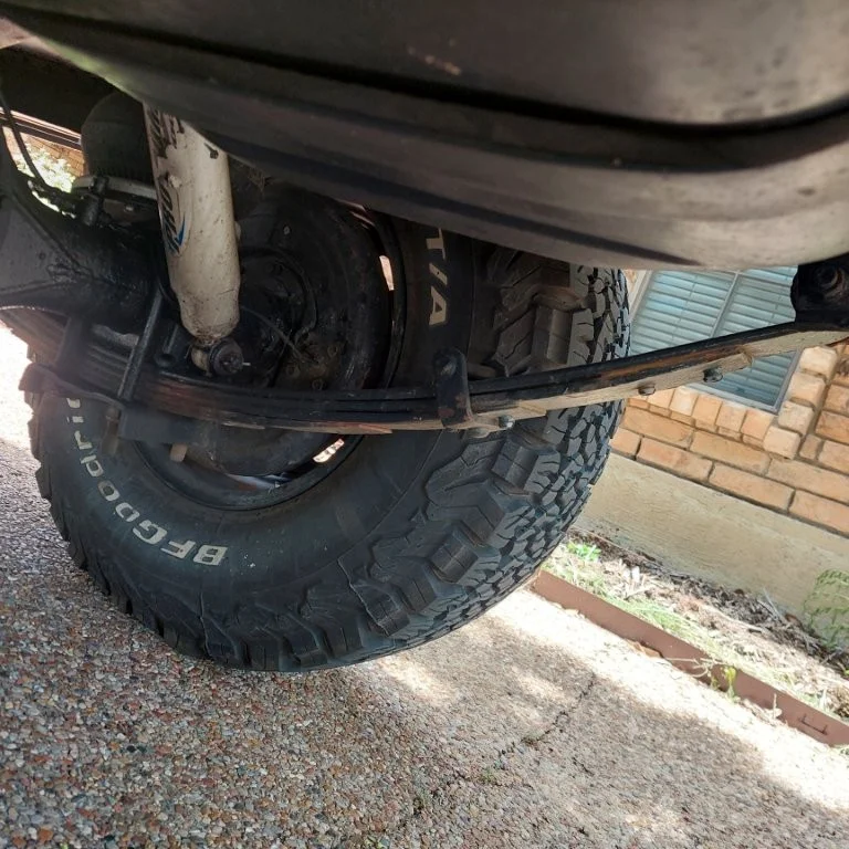

Old springs. I ended up having to install bags on it to get it level. The drivers side sagged about 3" whether someone was driving or not.
I looked at new springs etc and couldn't justify the $1200 price for a set of 4 new springs.
they are not oem springs... possibly a slight lift spring... just old... my 4¨ lift is more like 2.5¨ now that i have 300,000 miles on them
sagging to drivers side is called ¨cruiser lean¨ .... they all lean (mostly)
look up cruiser lean... there is a shim for that
are you kidding me, how come i never heard of cruiser lean? that is crazy. I would have much rather dealth with a shim rather than bagging it.

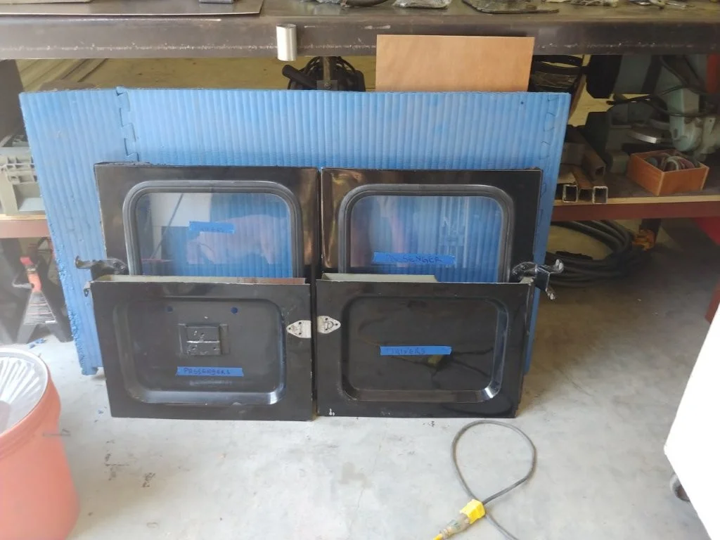

You are correct. it is a frankenstein 40. 73 body and frame, 78 engine, tranny and t-case, don't know what year the hard top is. the ambulance doors were cut in half and the tailgate was welded using the two lower parts of the doors. The drivers and passengers doors are from 2 different years. I am sure that there is more that is not year correct.

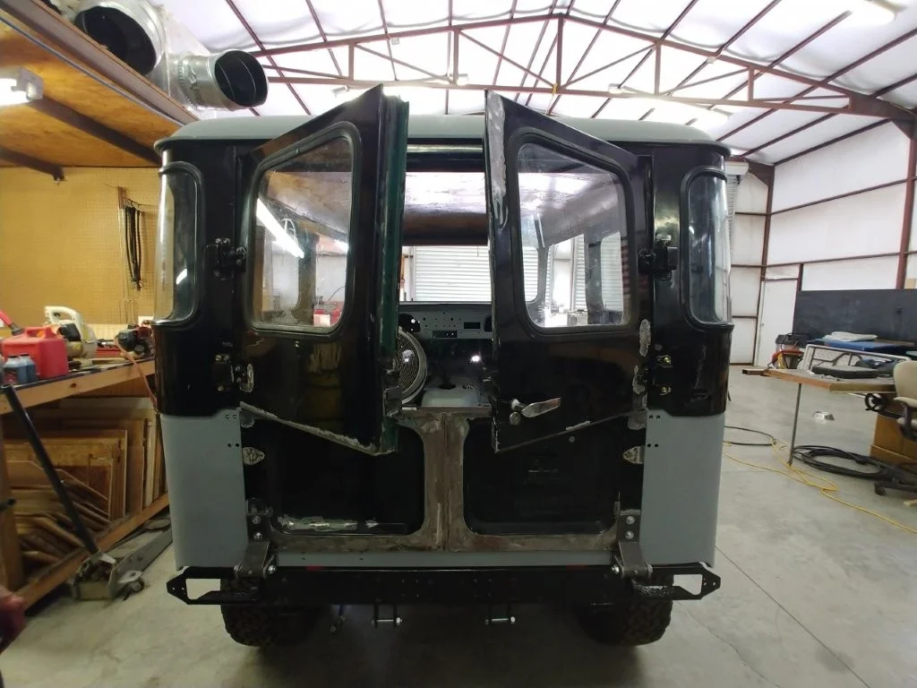

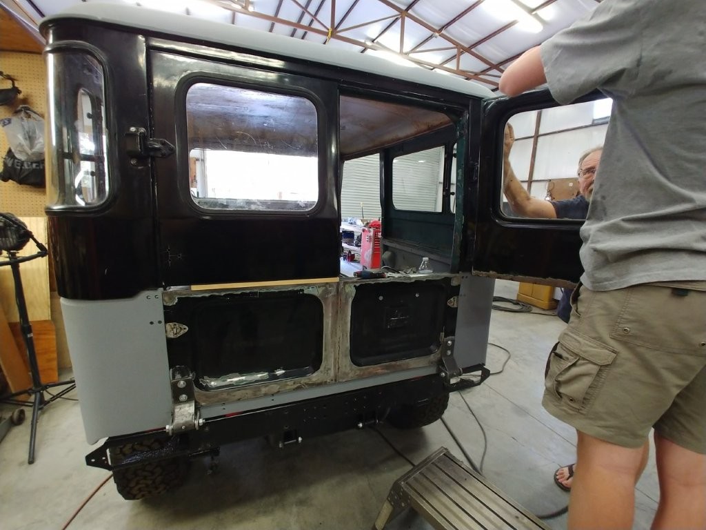

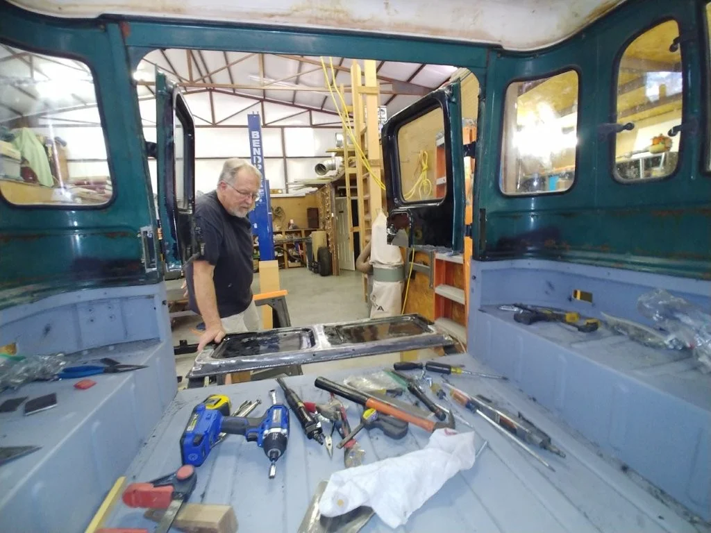

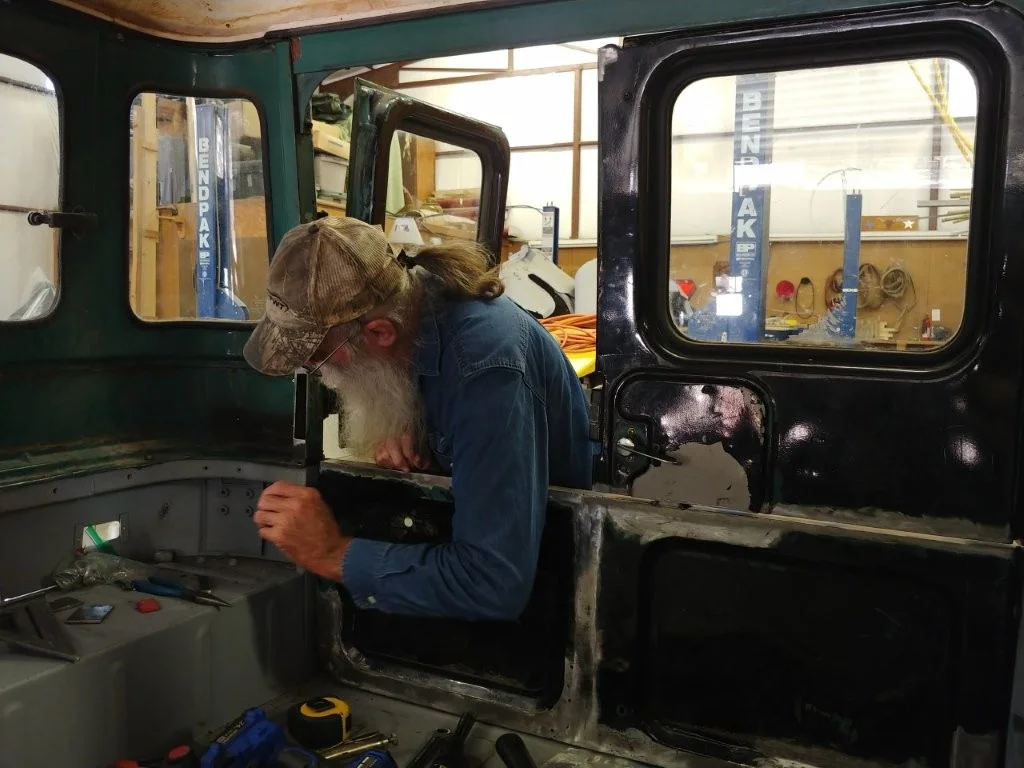

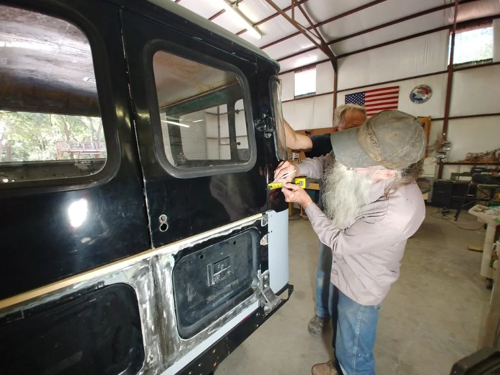

They made shims that lower the high side. The 40 looks good. Can you take a couple pics of the fabricated tailgate inside and out. I'm in the process of making a tailgate out of a pair of barn doors and I'm curious how you did the inside.
The pics are from the build. We had to weld a lug onto the top of the tailgate for the upper part of the door latch to catch onto. Obviosly we shortened the locking mechanism on the bottom as well where it meets the top of the tailgate.
Frame may be made in late 1973 but would be a 74 model unless that section of the frame has been changed. The top is most likely 8/76-1/79 going by the vent window and square corner on the bottom of the ambulance doors. Running board/step ended 9/69. Originally had rubber pads not diamond plate on the top.
Stock springs have many leads and military wrap on one end.
