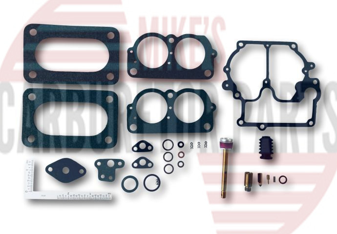

Can someone help ID my carb? According to the stamping on top it should be April 1972. 2D 10
Before I order the kit if someone could confirm this. Of course I will call Cruiser Outfitters and chat with them. Unfortunately I am missing one of the brass butterflies. I hope this part is available or if someone has an extra piece let me know. I wanted to send the carburetor to JimC but he is 6 weeks out. I’m sure by the time I get around to it I could/should have sent it to him LOL. But I guess we will give it a try and rebuild it ourselves. Emily has never torn a Carb apart so even it it’s not successful it will still be fun.
It defiantly looks like a 9/69-12/74 Carburetor, which one I am not sure.
This will help you identify it. Click on the tab that says Carburetor Identifier

Mathew, you are an awesome. You are right, I can't tell from my pics either if it has the vacuum line fitting. I will go out back and check. From the numbers stamped on the top of carb, it appears to be April of 1972. I am getting a bit confused be the PO told me the motor was a 78, but who knows. There is also so antiquated emissions stuff in the engine compartment that needs to go away. I believe I posted it above.
The PO probably swapped out the motor from a 78, but used the carb from the original motor. The date of your VIN seems to match the date of your carb :)
Yes your motor is a 2F and your FJ40 originally would have come with the earlier F motor. You can look at the number on the block and look it up. It will tell you what it is. That is easy to look up :)

I have two Carburetors. My engine is a late 76 to early 77 2F. The engine came with a 71 Carburetor, likely the one that was on the original F engine at time of engine swap. I happen to have a Carburetor from that exact time period (Federal 76-77). Is there a reason to run one or the other? Both must be rebuilt. The 76-77 looks more complicated and appears to have emission stuff on it, which I am guessing would need to be deleted, i.e. desmogged. So is it better to stick with the early Carburetor that came on the original F motor or go with the later date matched Carburetor? TIA.
The '76/'77 has ported vacuum, the '71 doesn't. If you want distributor vacuum advance the '76/'76 would be an easy choice, but a port can be added. The '76/'77 has the provision for the air cleaner stud, the '71 doesn't. It looks like you have the '71 air cleaner set-up, which doesn't use a stud.
Where does the vacuum hose from the distributor vacuum nipple go? It looks like you have a '77 vacuum advance distributor, which is the best (and latest) 2F points distributor. Does the breaker plate rotate CCW when vacuum is applied to the nipple on the advancer? If it doesn't, or seems sluggish, all it may need is to have the old grease cleaned out and reassembled with new distributor grease. Sometimes the 50 small ball bearings inside have to be replaced (they can develop flat spots). I have a lot of those, plus new races if they are really worn (I sell an inexpensive "kit" - races, ball bearings, and clips). And there's a bushing on the mechanical advance stop pin under the breaker plate that's usually gone, but can be easily replaced with a nylon or aluminum sleeve from the hardware store. Search the forums for the stop pin bushing replacement.
