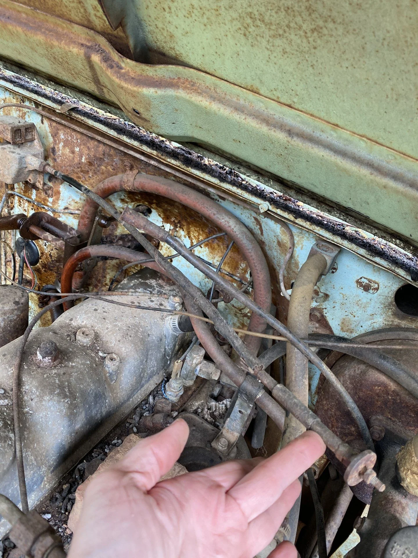

What is this cable with a knurled thumb screw on the end? It too appears to go to the 4x4 gizmo.
That is the actuator cable for FWD engagement. It goes through the firewall and is mounted in the instrument panel by the Hi-Lo lever.

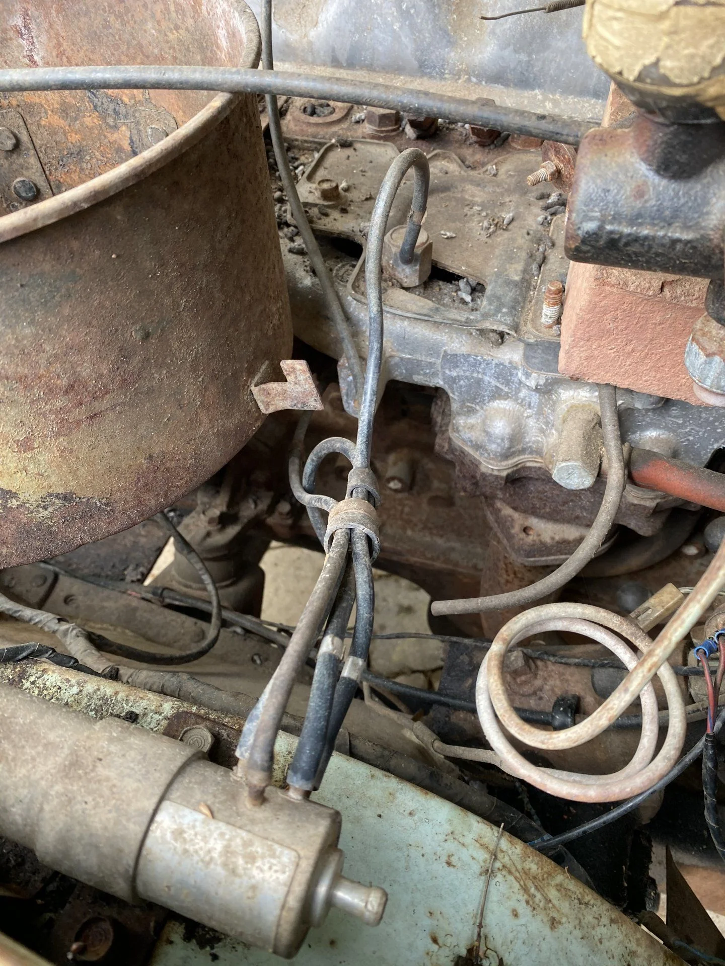

What is this? Appears to be part of emissions or something. Note bard at end that is not hooked to anything. There are a a couple other small tubes hanging, which may have been attached to carburetor.
The emissions VSV. Remove & discard, since the vehicle is no longer emissions compliant. Also remove the little "emissions computer" located inside cab, next to the clutch pedal.
