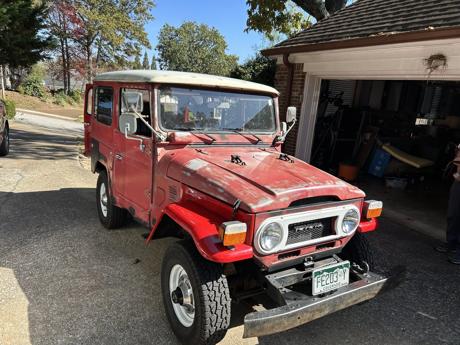

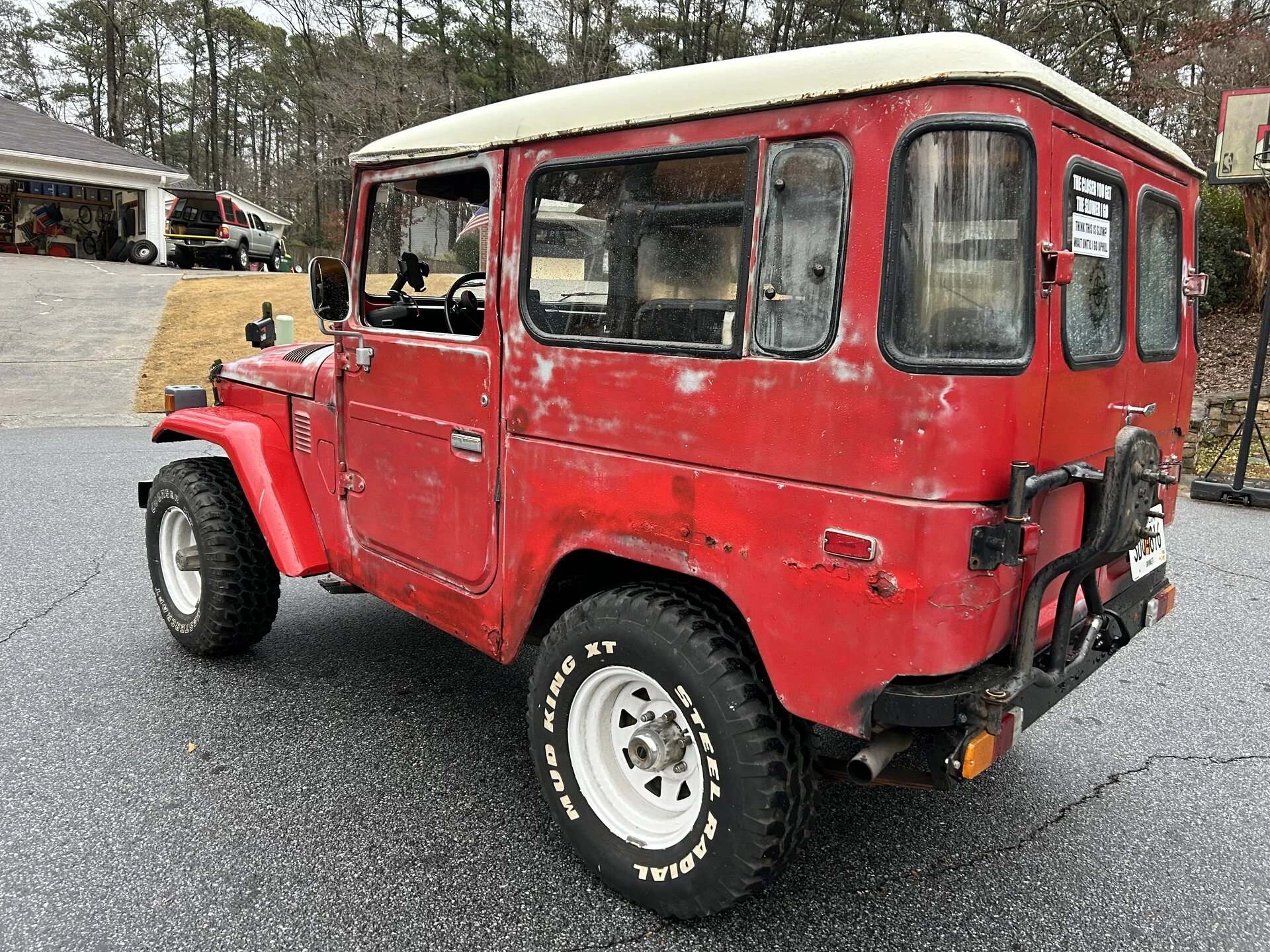

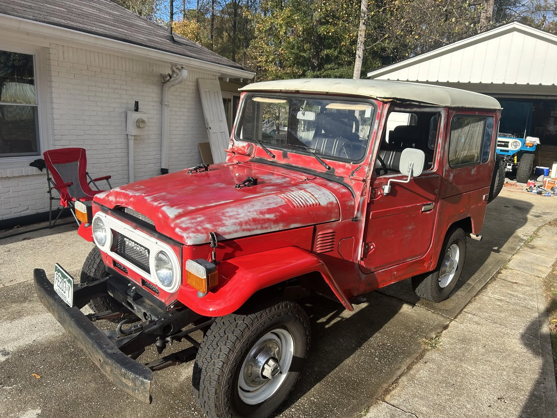

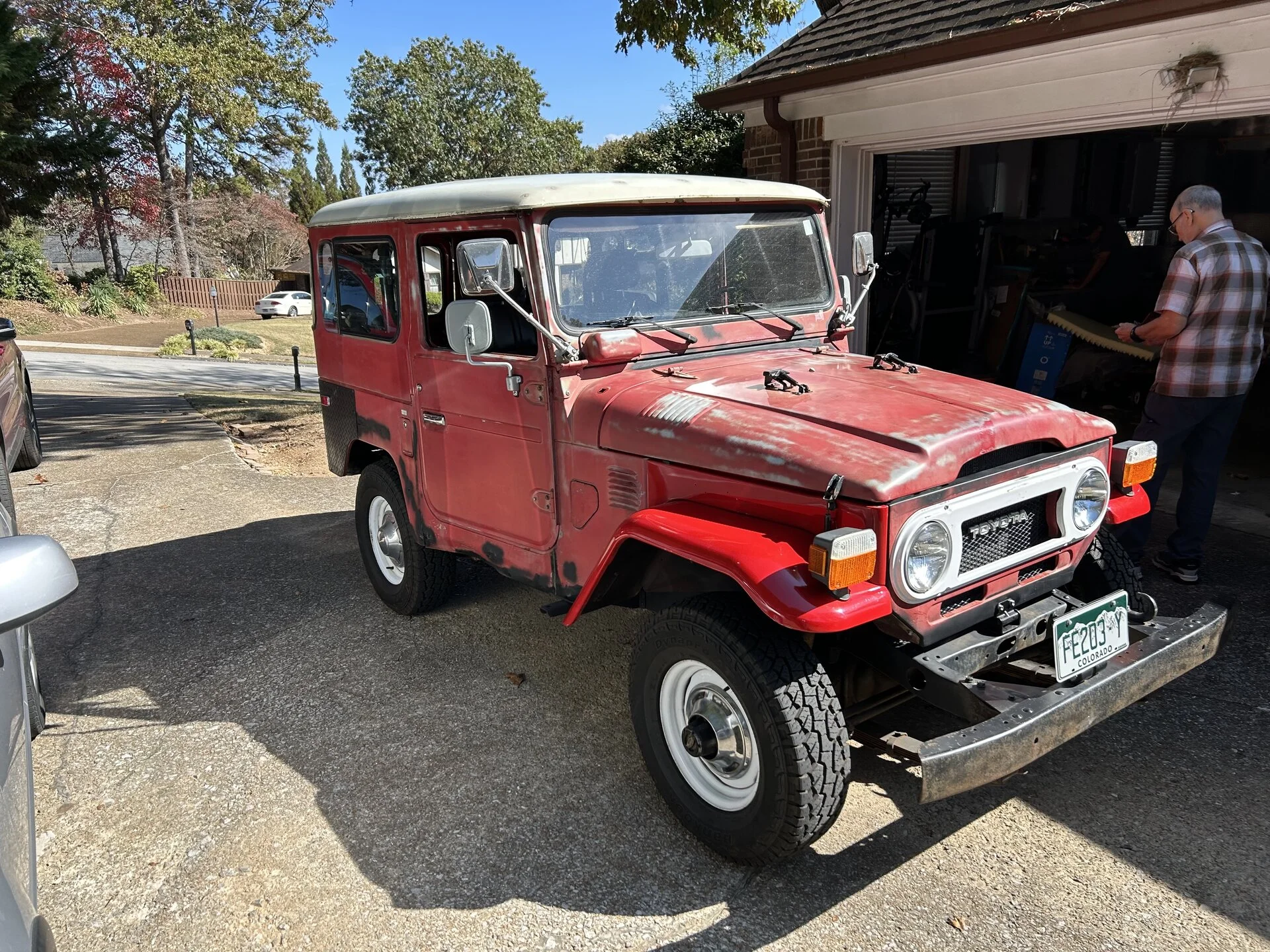

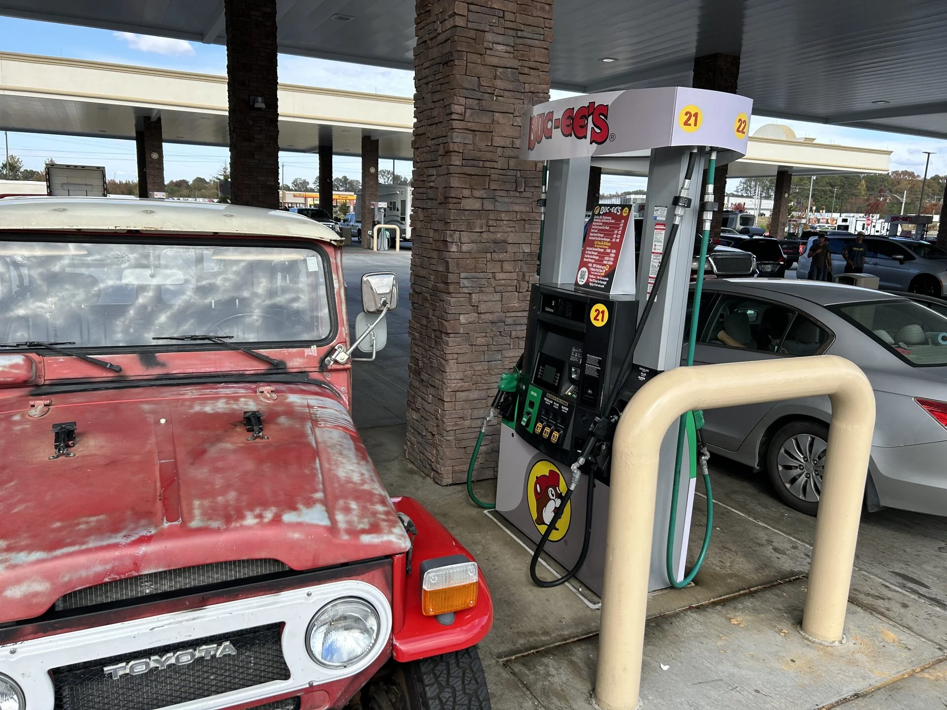

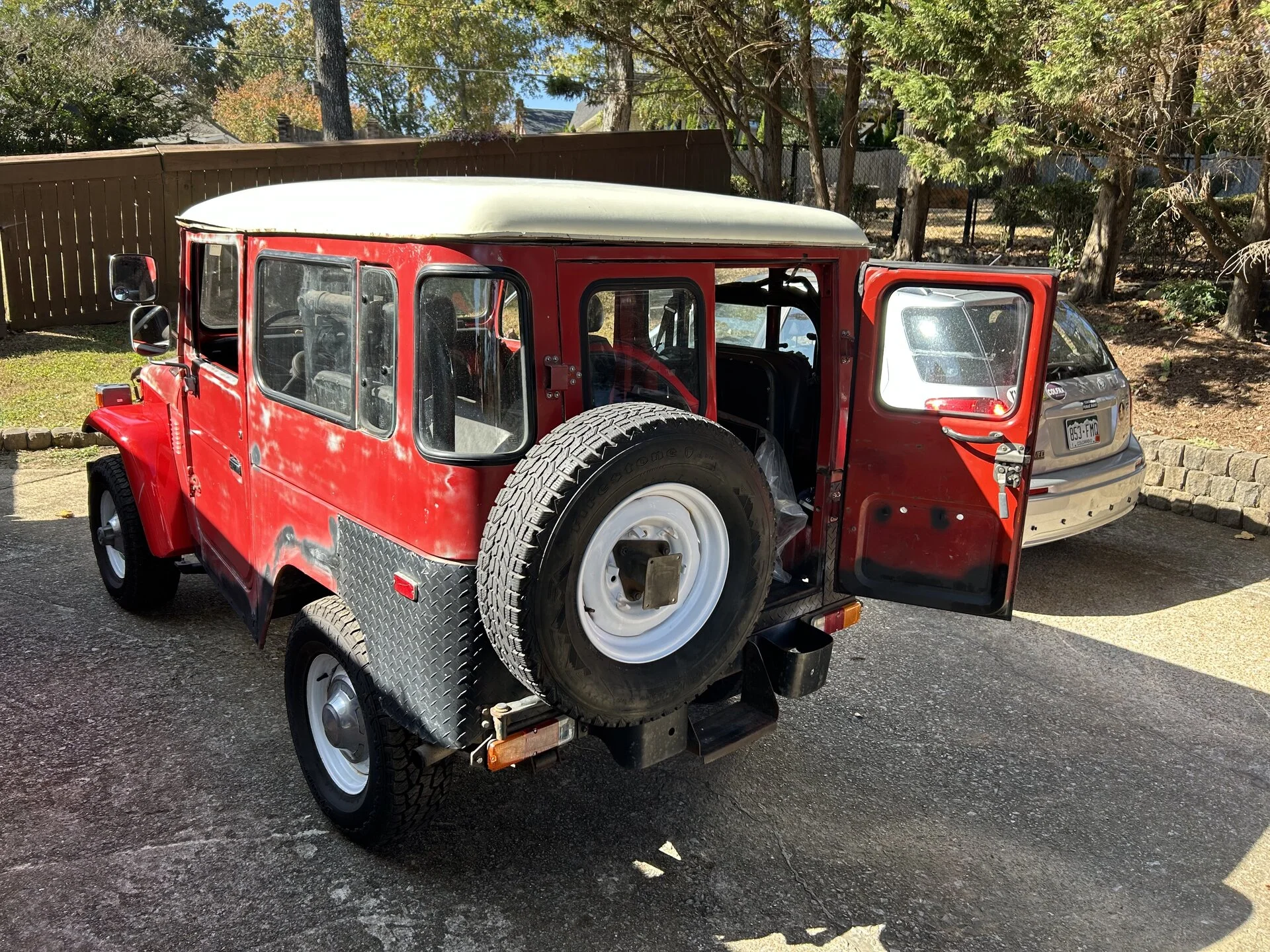

I picked up this red 78 USA FJ40 and drove it back to Atlanta from Chattanooga today. 100 miles doing 65 mph smoothly the whole way. I will give a lot more details soon, but the short story is I just plan to put new quarter panels on it, paint it and drive the wheels off of it. It is 98% untouched and all orginal. It still has all the smog stuff on the motor, and I don't think the top has ever been taken off.
Keeping the Bruc-ees tradition alive!

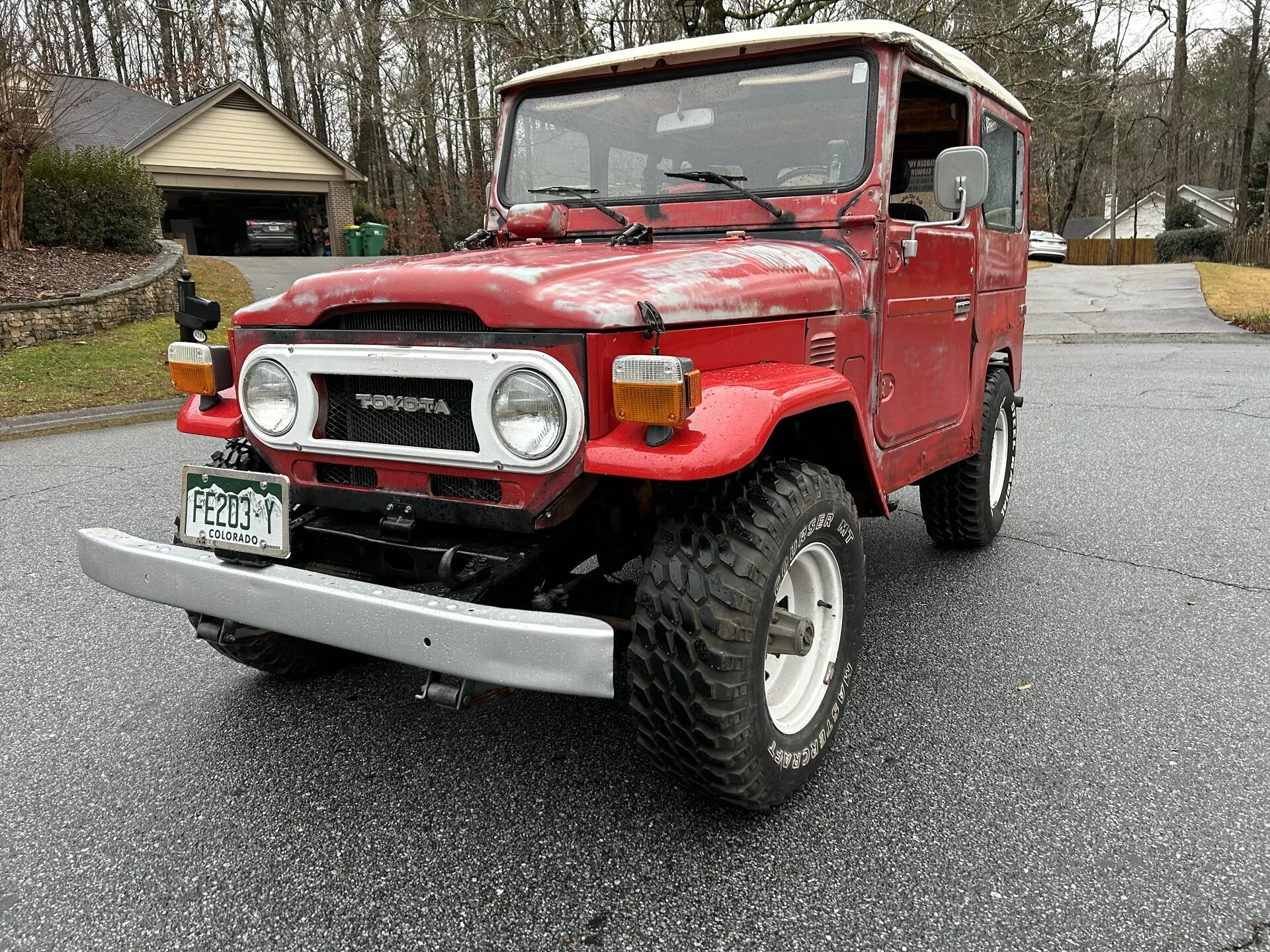

The tag says fe203 which is the formula for iron oxide which is basically the chemical formula for rust so "fe203 - y" = "Rusty"

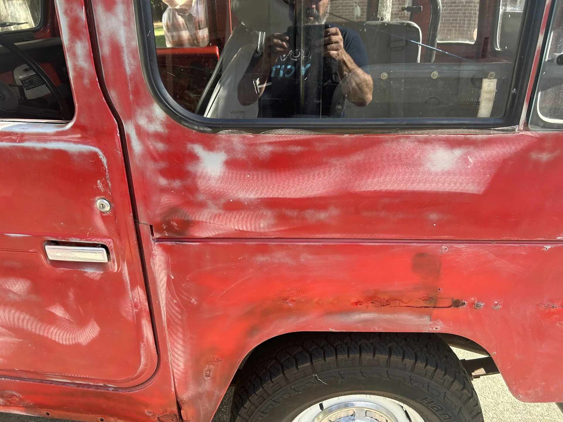

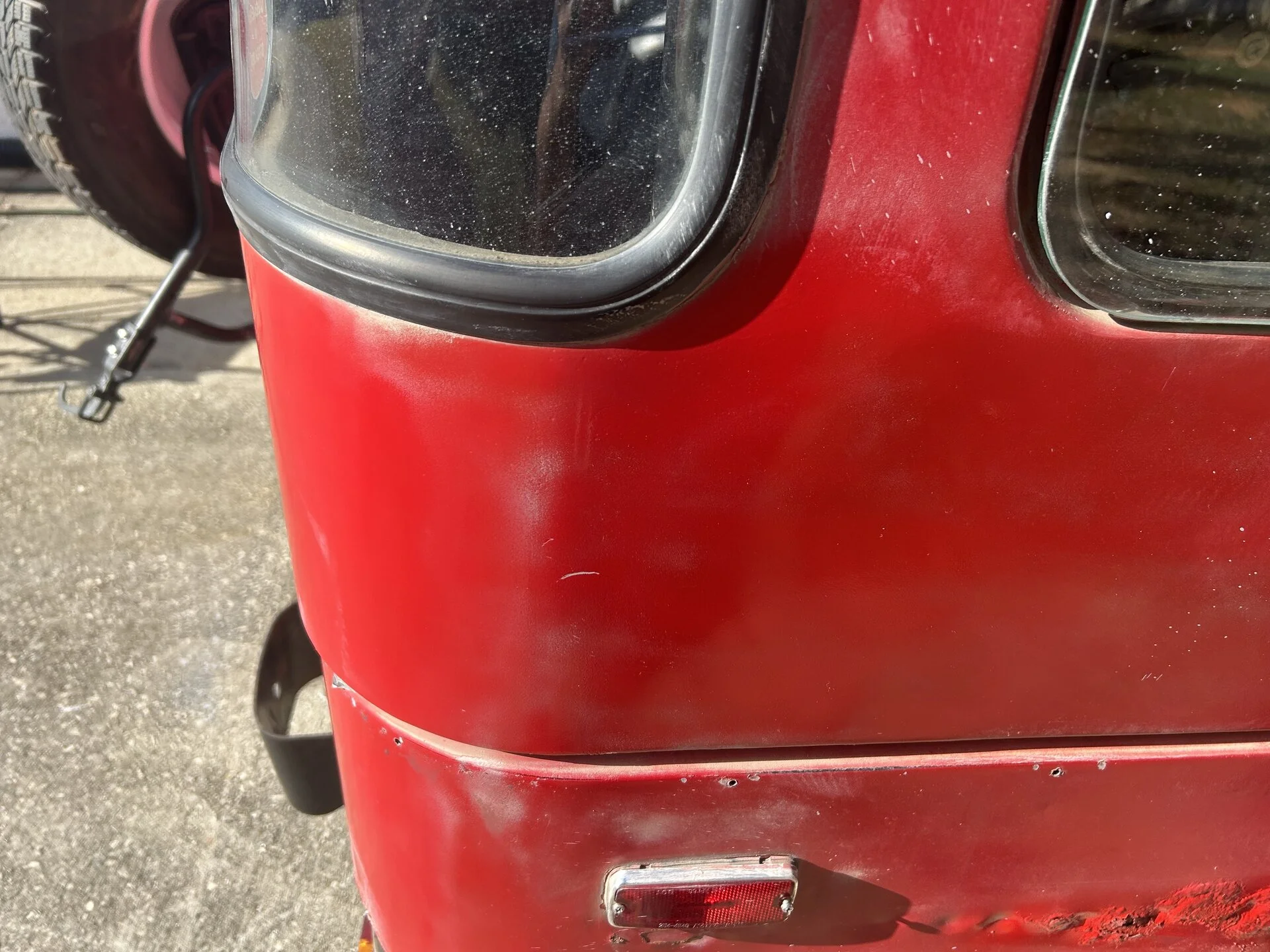

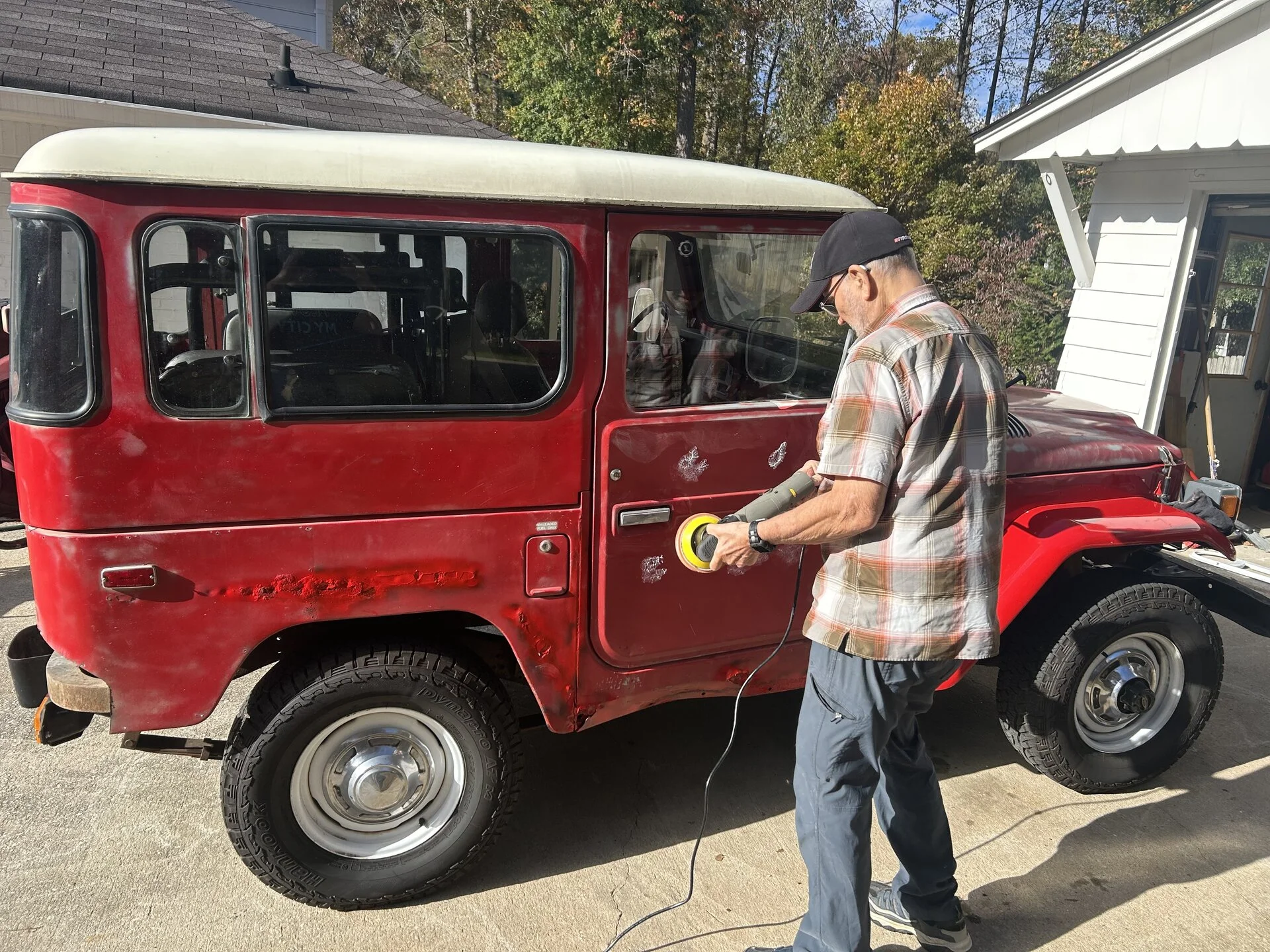

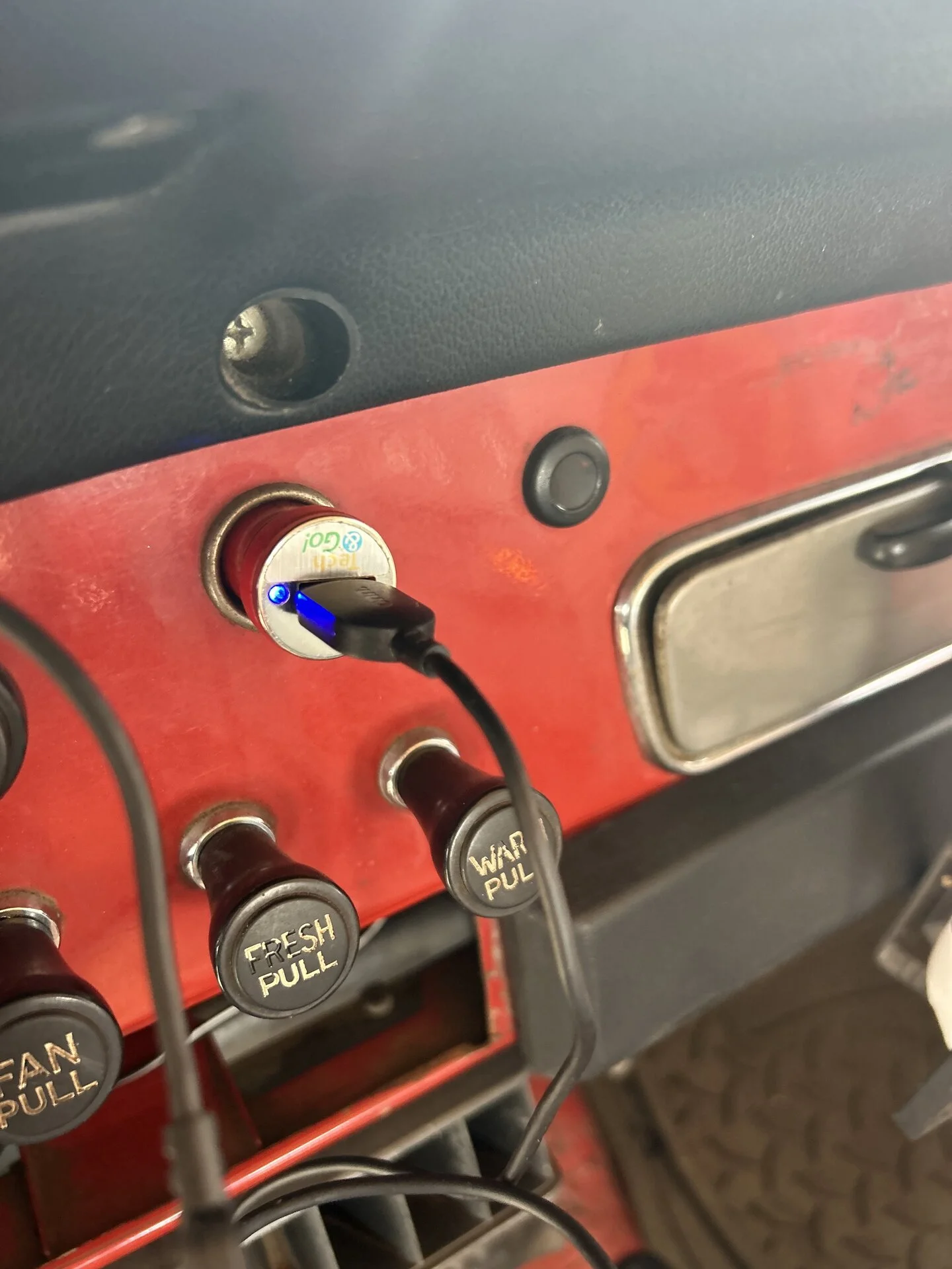

Added a 21st century phone charger and cup holder. My dad and I also decided to take off the diamond plate rear quarter panels. Someone cut out the bottoms but not as bad as it could have been. I also think the entire rear sill has been replaced. The good news is that whoever did it, did a good job. The only way I can tell is that it is 100% rust free. If the lower rear quarters we so bad they had to cut them off, then the rear sill would have had some rust also.
We buffed the entire thing with some rubbing compound, and it did brighten it up a little. You can't really tell in the pics but it does look better.
I tried to find a color at Home Depot that was close to cover the black paint, and this was the closest I could find. It looks pretty bad, but not as bad as the black paint. Painting the whole thing the right way is pretty high on my priority list, so I hope to do that soon.

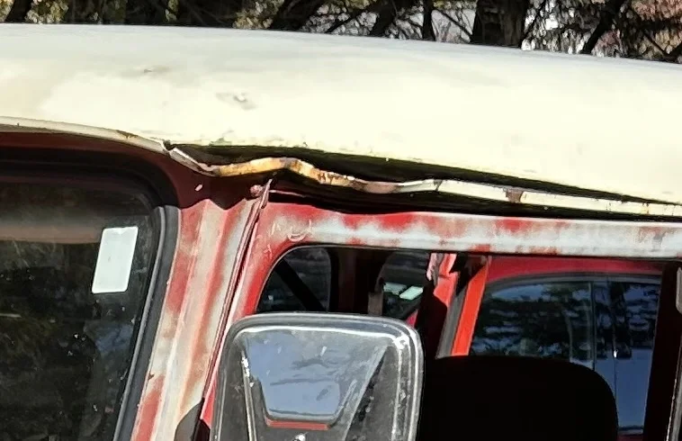

Next on the list is clean the inside really good. Take the cap off, repair it, paint it and reinstall it. It looks like someone clipped a tree or something and wrinkled the corner. It is not as bad as it looks. The fiberglass cap is good, it is only a bent frame. I am pretty sure I can fix it. I will hammer out the frame flat, re-glue it, put a dozen clamps on it and then reseal it back up.

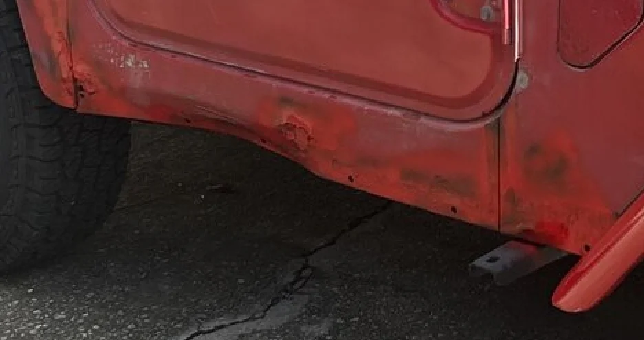

I'm also going to break out the hammer and dolly and straighten out these rocker panels.

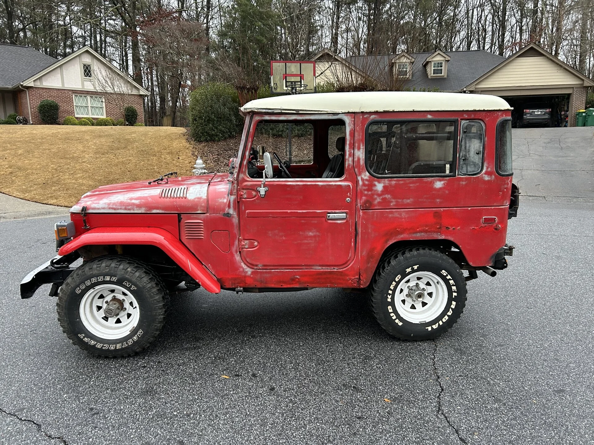

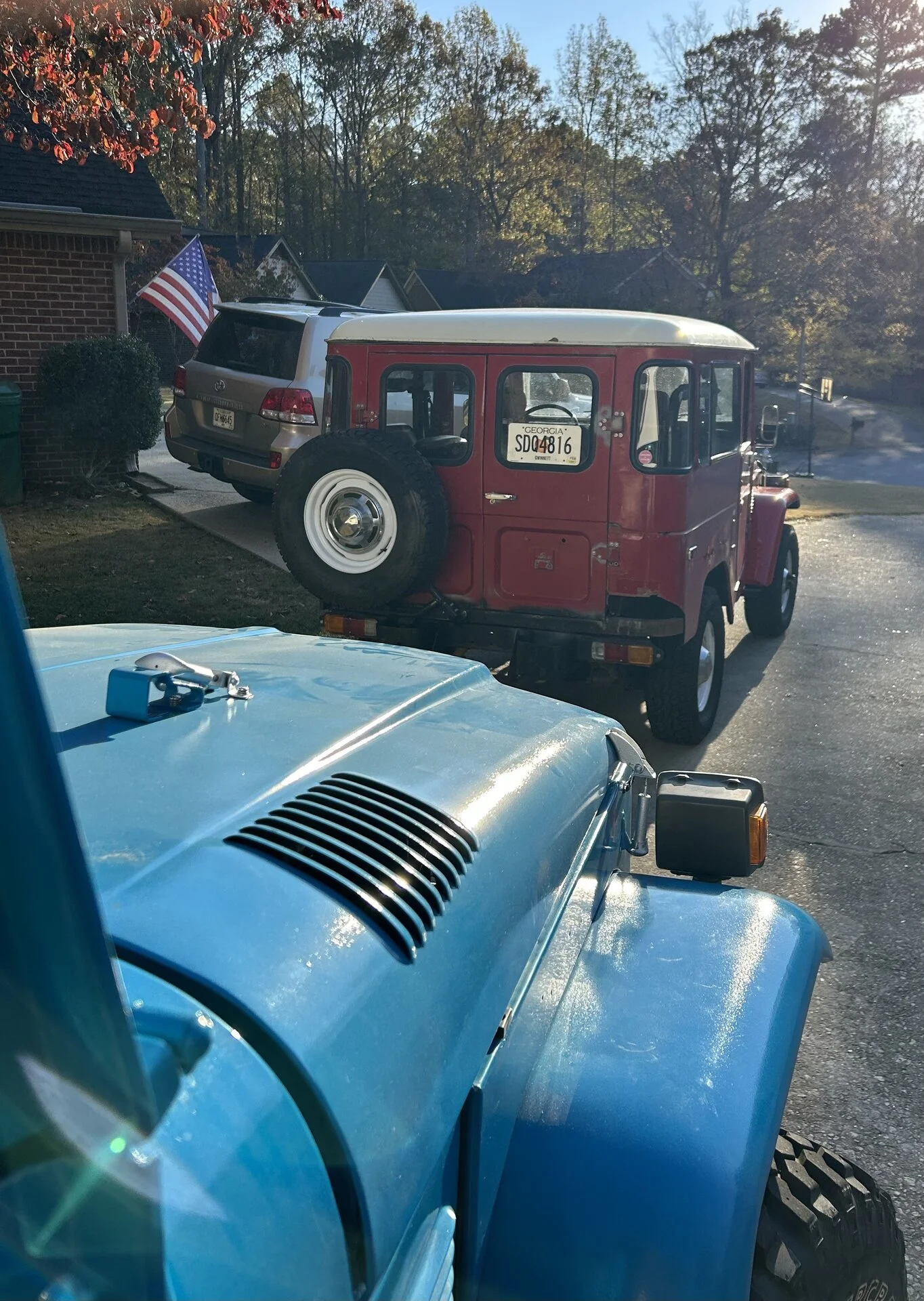

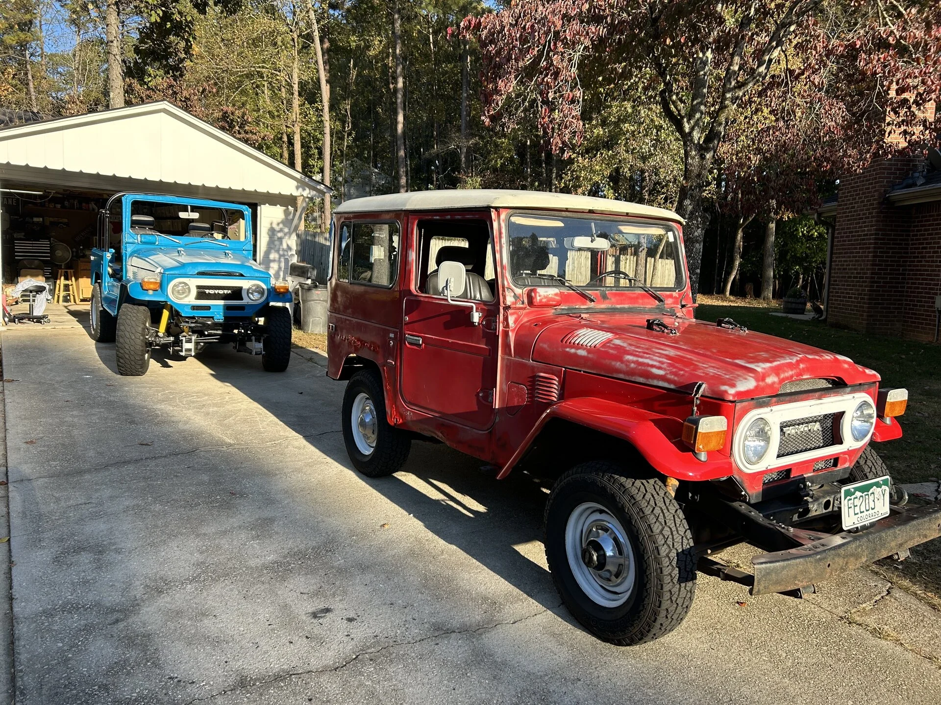

I got Belle out and drove her around the neighborhood for a few mins today. I thought I would let Rusty and Belle pose for some pics together. Their build dates are about 7 months apart, so it is pretty cool to think about how many of their parts were probably in the building in Japan together back in late 77 early 78. They were probably assembled by the same people on the assembly line, they have traveled around the world, and are reunited in my driveway 45 years later.
Rusty will be at our next YOTA meeting this saturday!

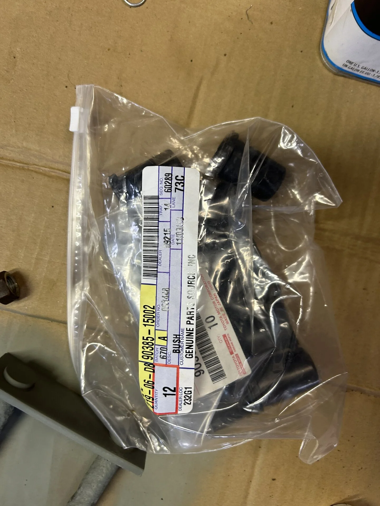

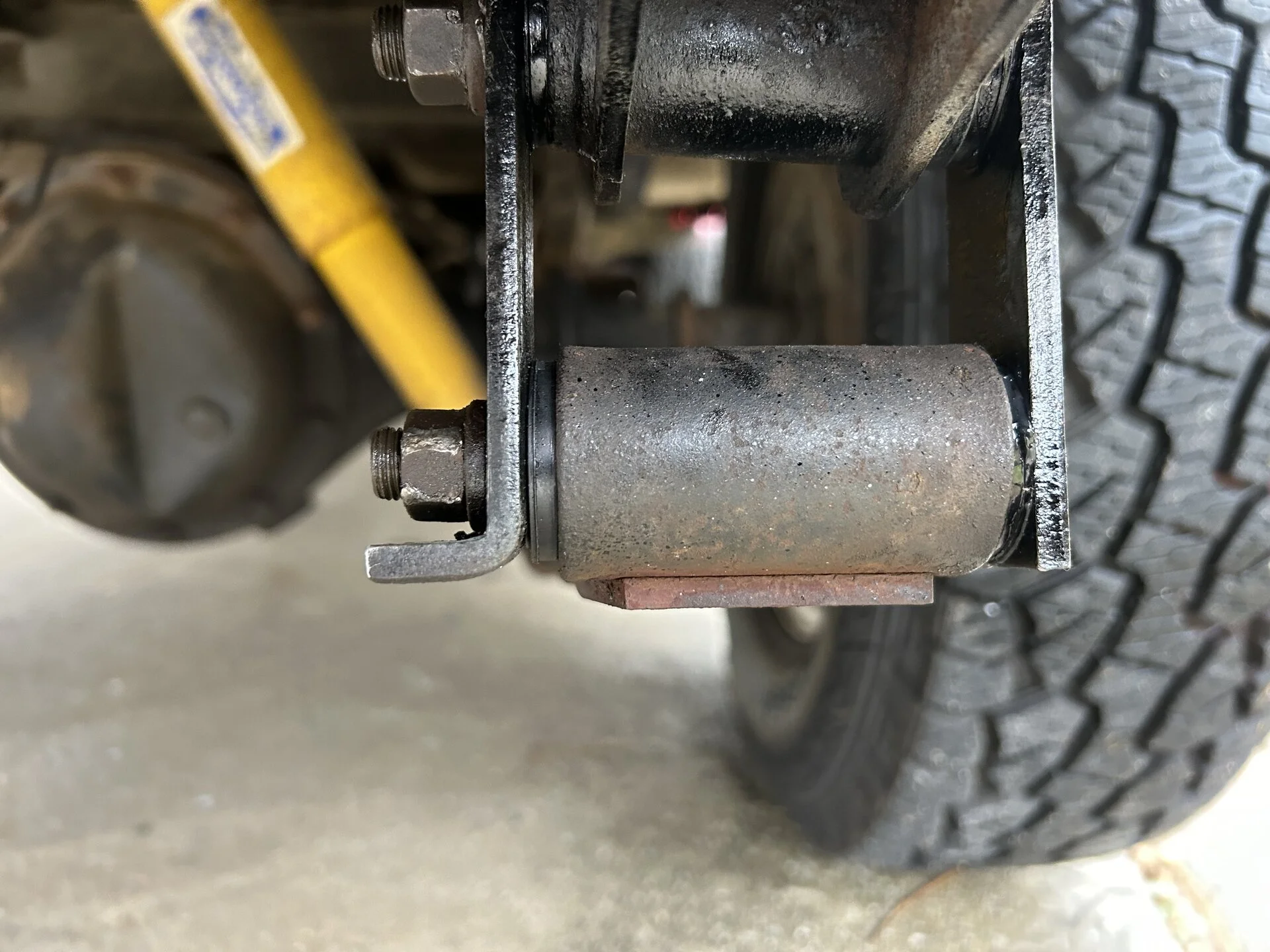

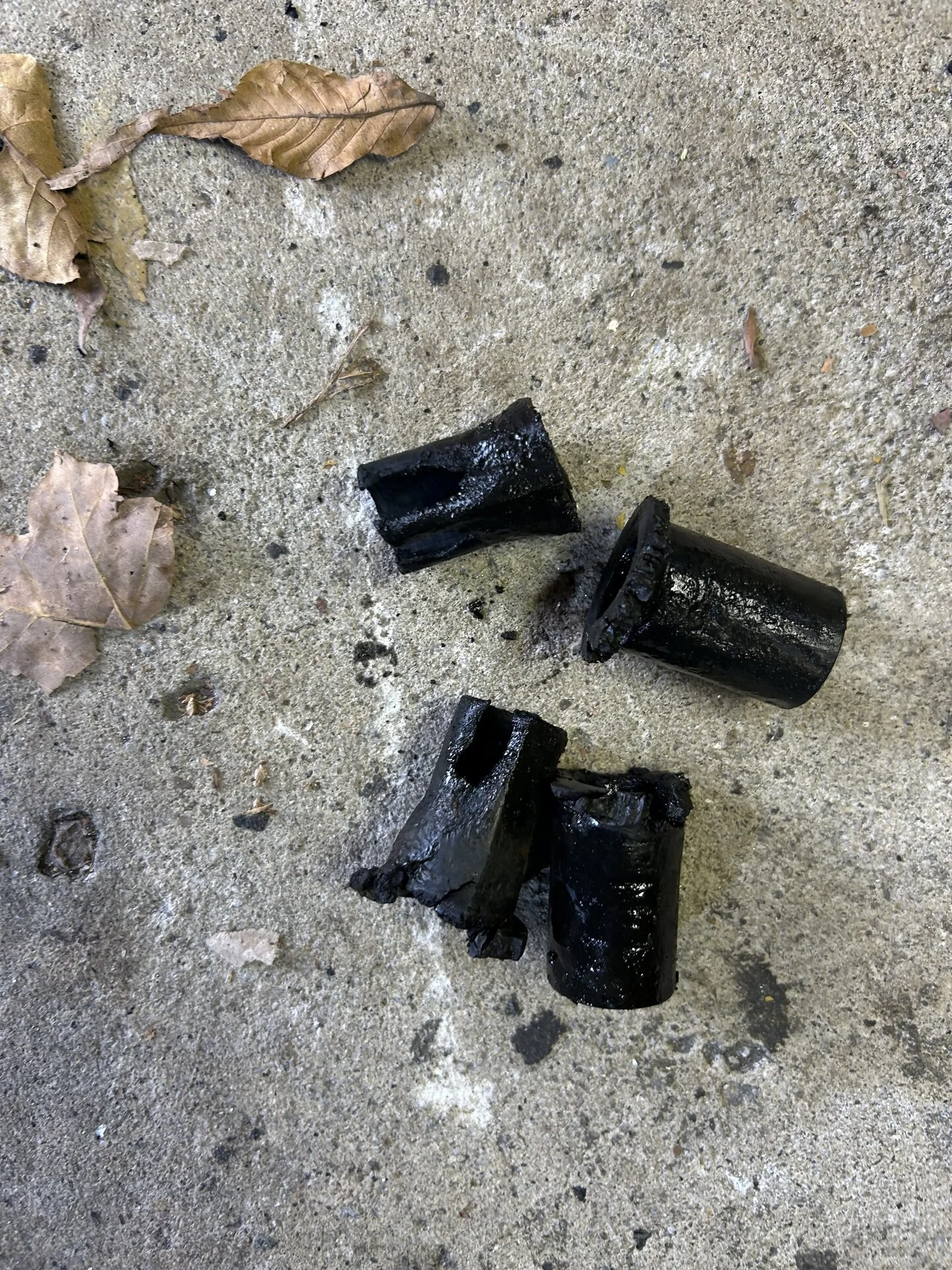

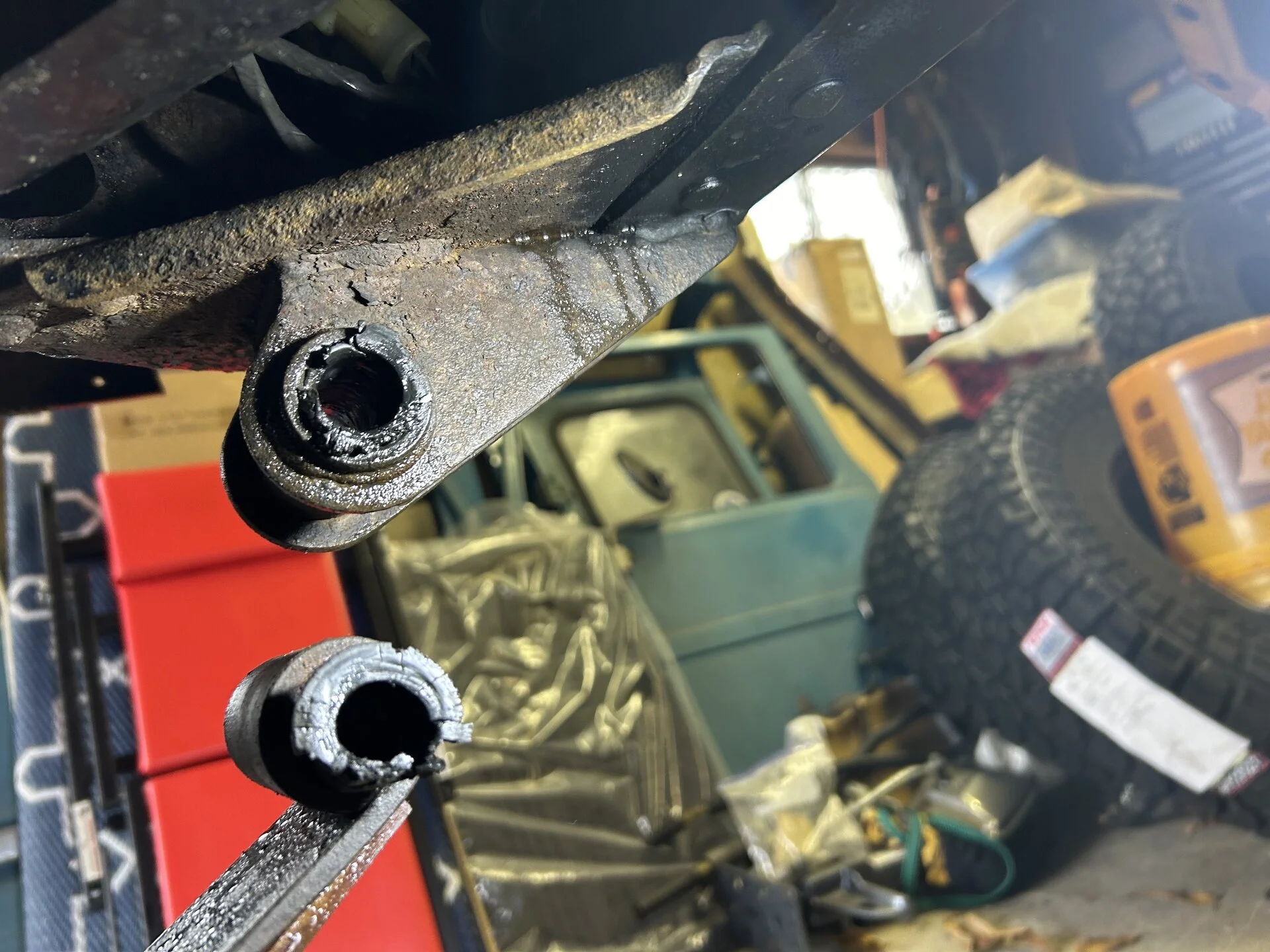

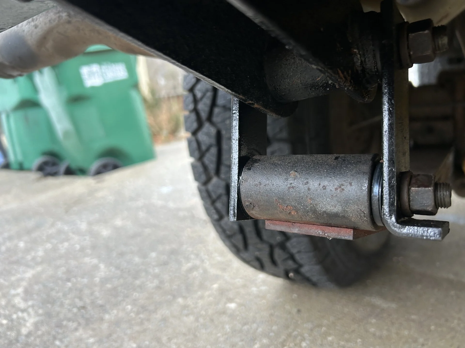

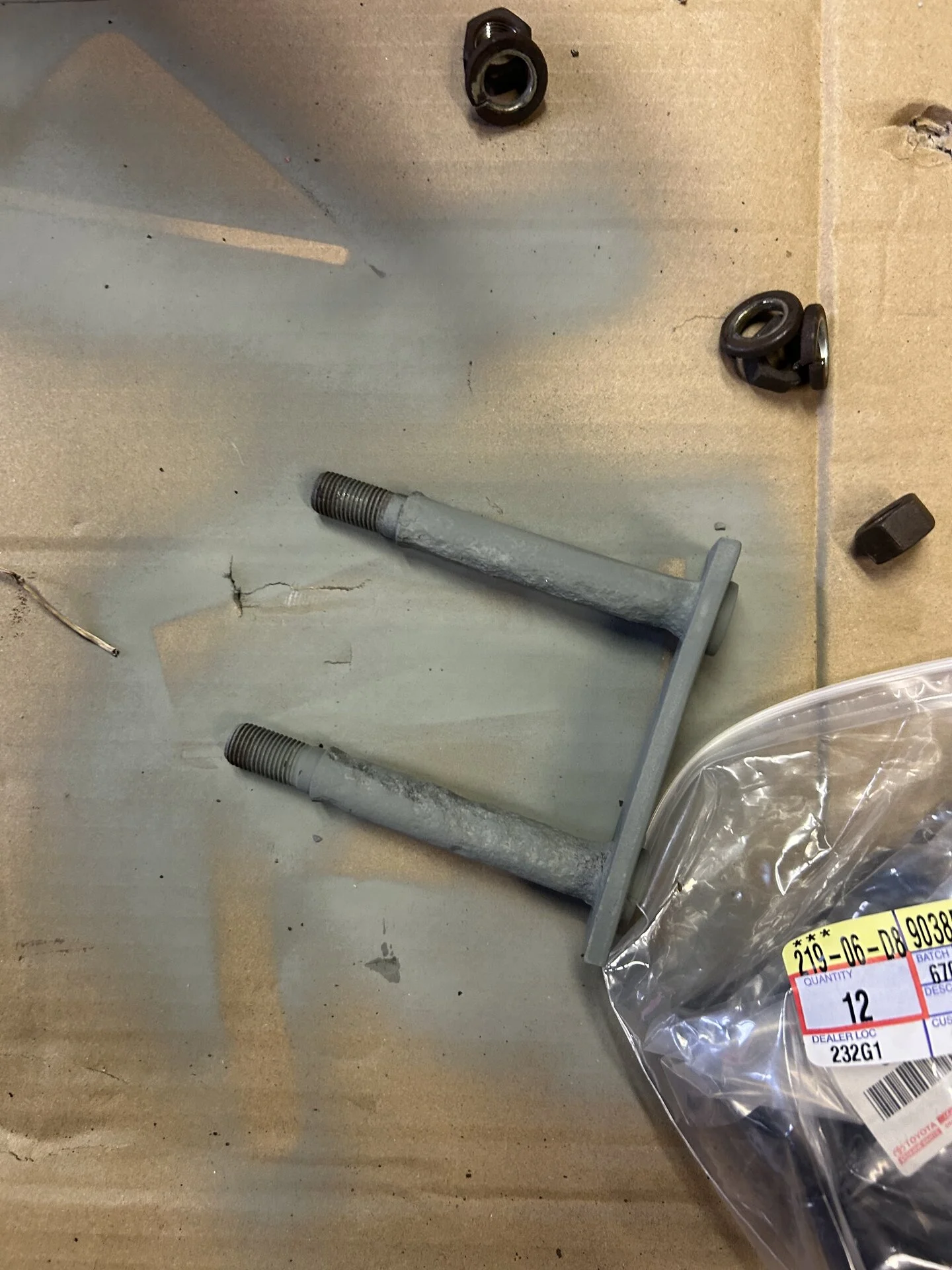

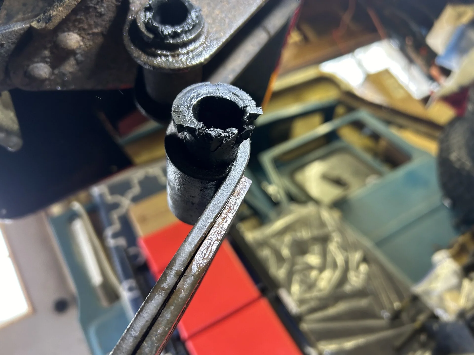

Replaced the rear shackle bushings today. I'm trying to keep this thing all original for now. I may do some upgrades at some point, but all OEM for now. I will do the leaf spring pins and front shackles soon. If I don't upgrade to OME soon, I will replace the old shackles. The rust had eaten into them a little.
The old ones were in pretty bad shape... and these are the ones that came out without completely coming apart:rofl:
Good as NEW!!

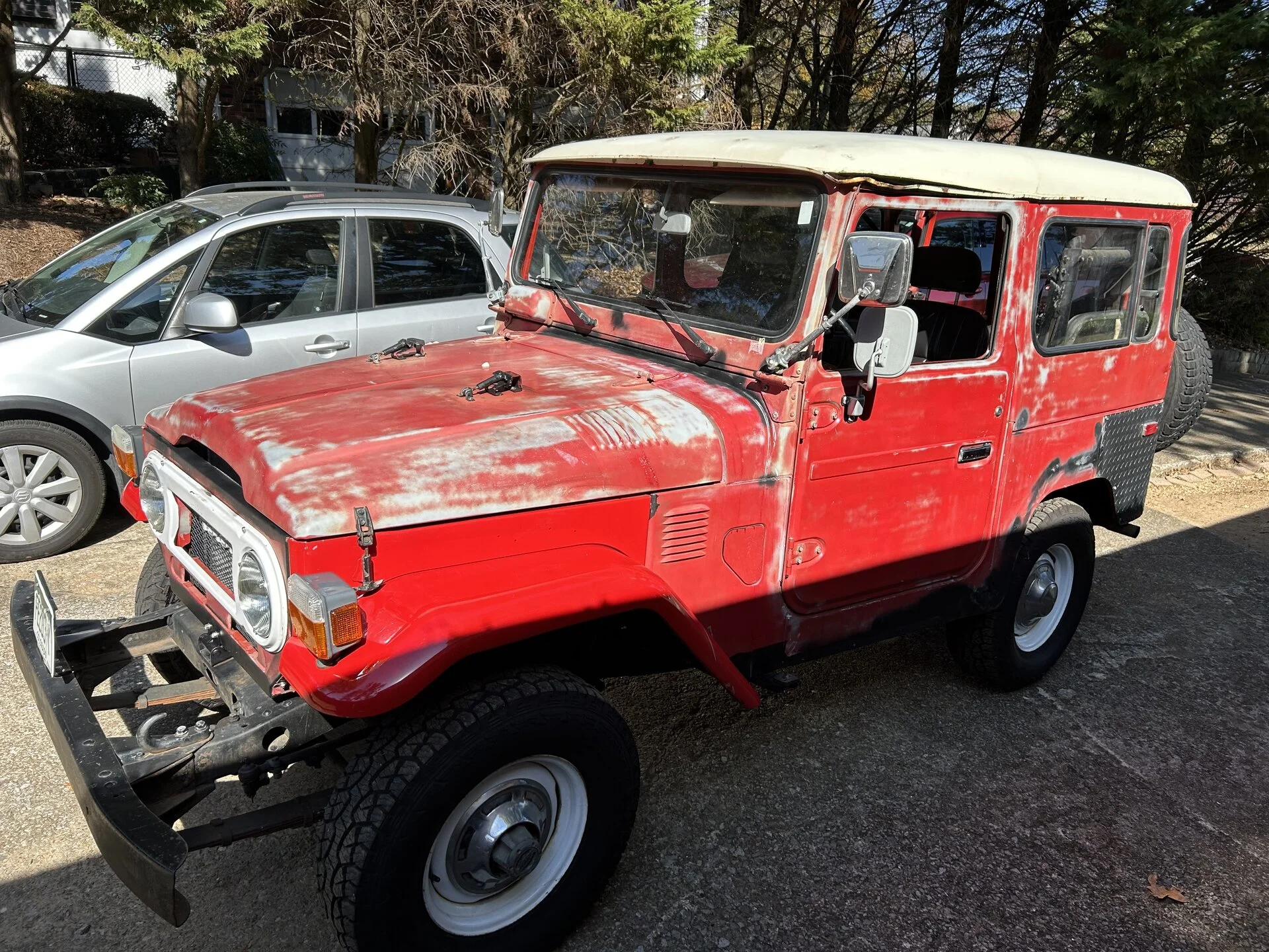

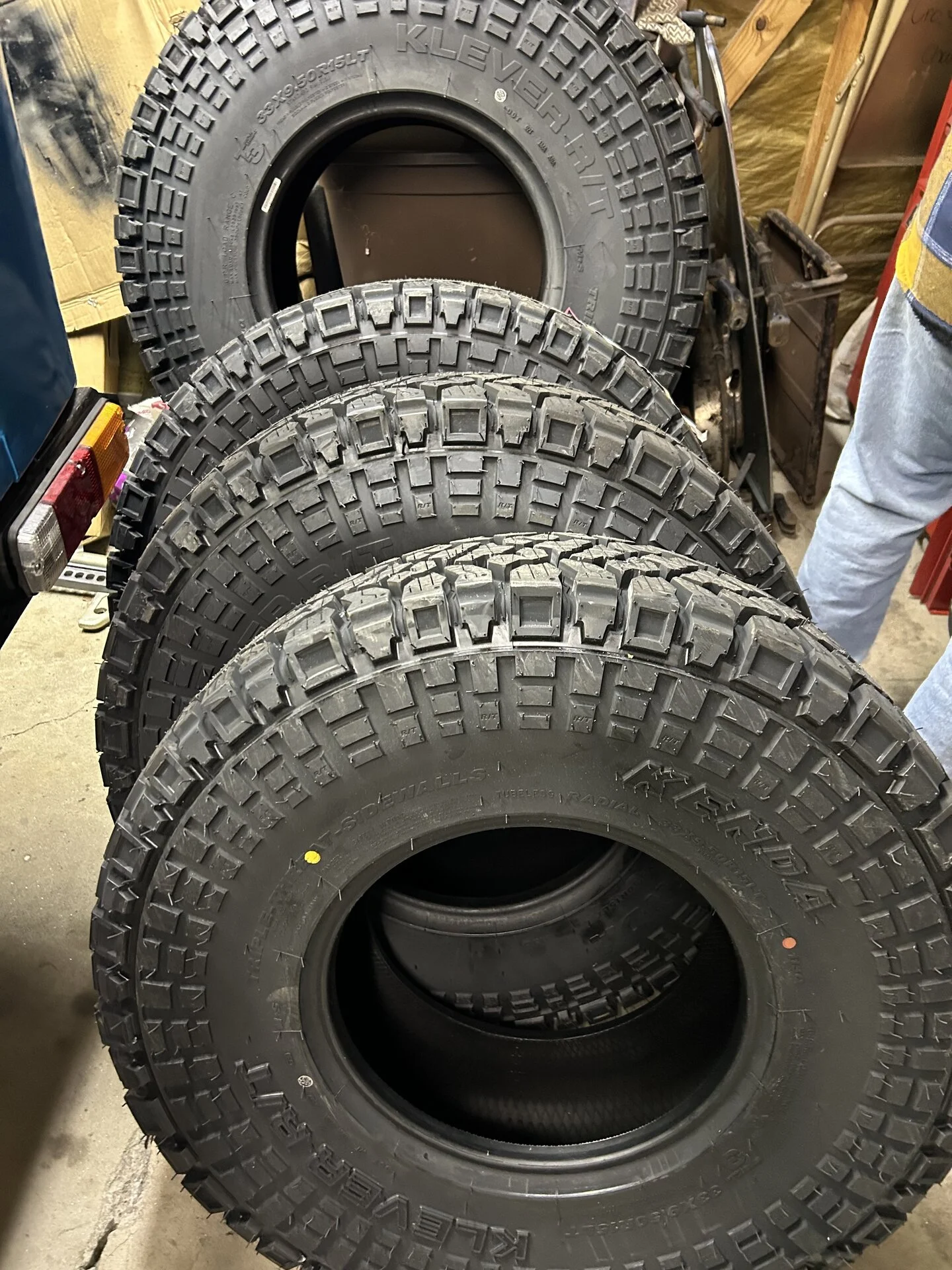

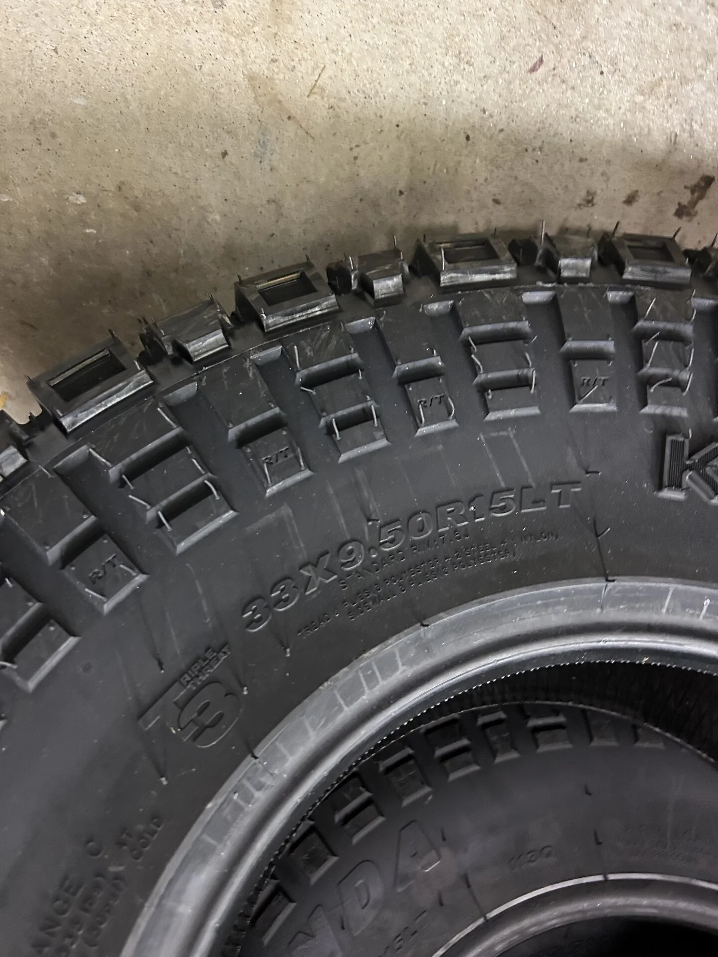

Getting ready to put some new tires on Rusty. I'm going to get the orginal steel rims sandblasted and powder coated "grey" before I put the new tires on, so I put Belle's rims and tires on Rusty for now. It looks pretty good, but will look better with the Kendas on the orginal rims. I hope they fit... if not, I guess I be putting on that 2.5 OME lift sooner than expected.

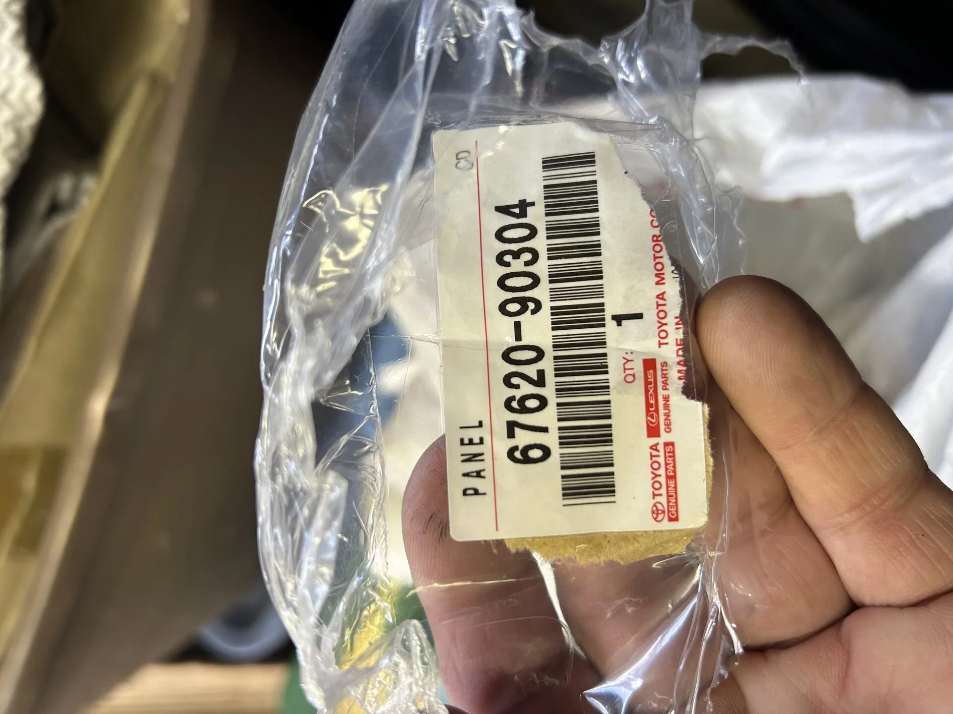

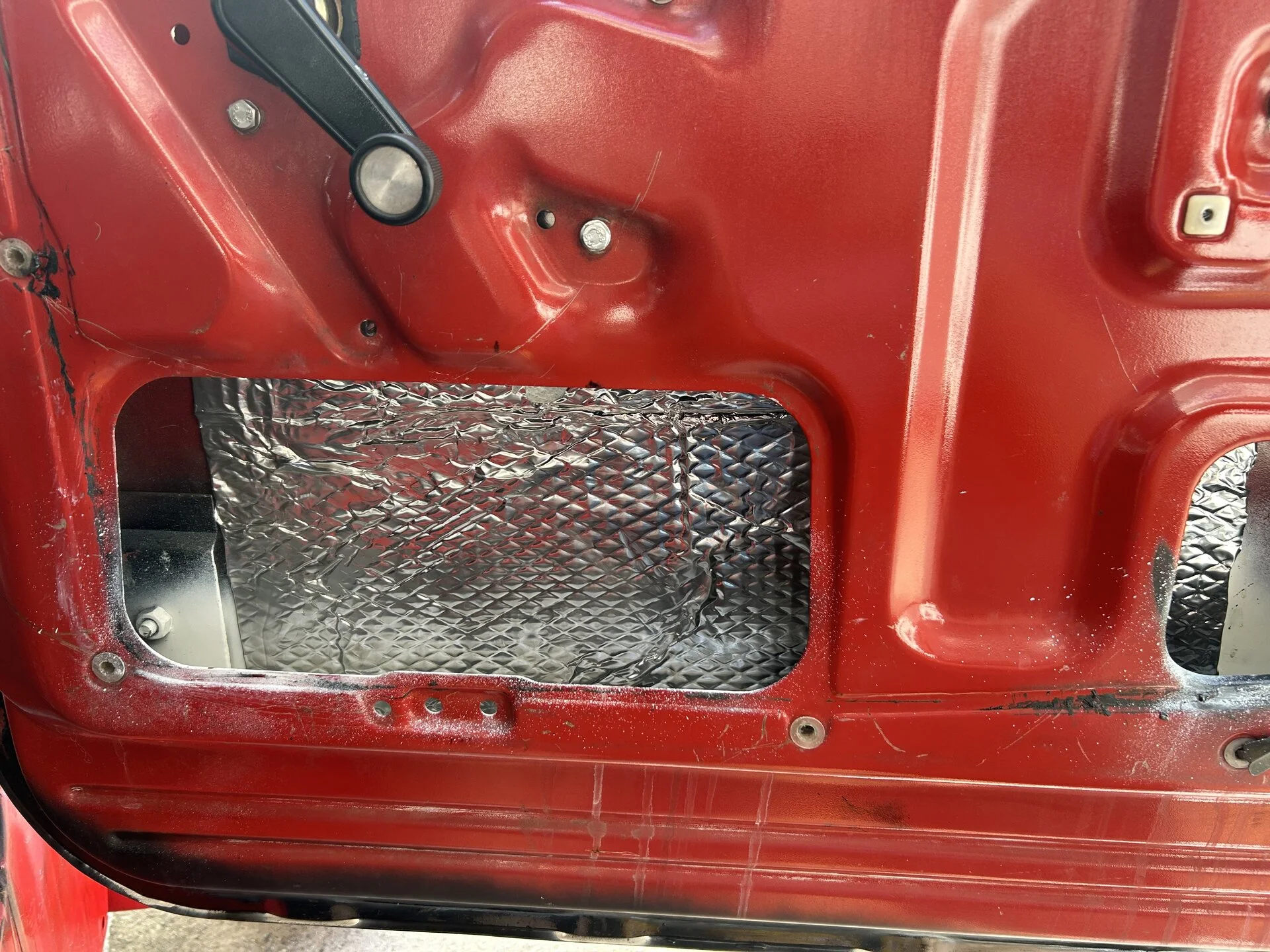

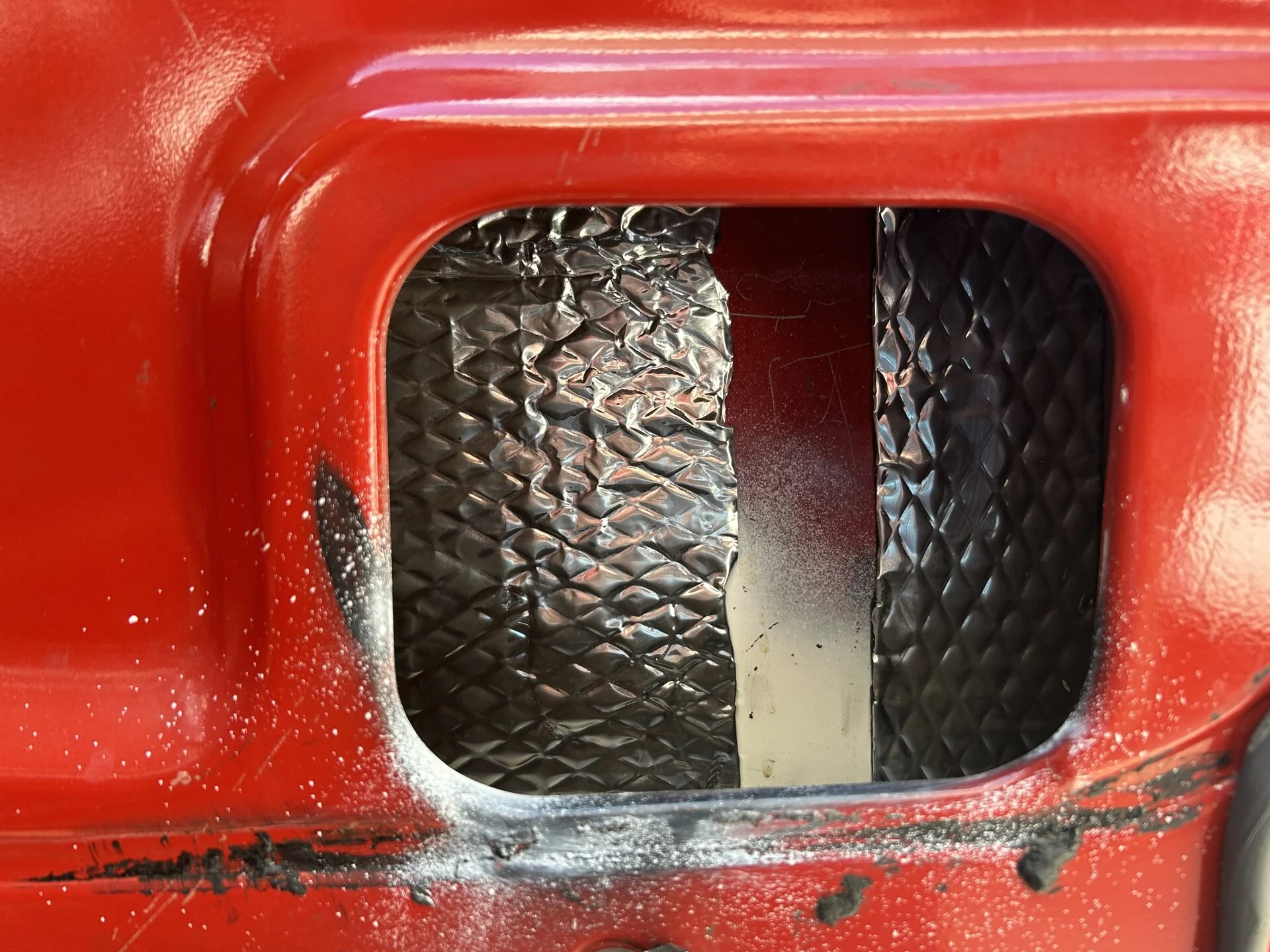

Here is what I did today...
- Unpacked some OEM door pannels
- Painted them black (No sure why you can't order them in black)
- Installed some sound deadner and inslation. Did about 80% of the door.
- Installed new plastic
- Installed new door panels
Merry Christmas to me :)
