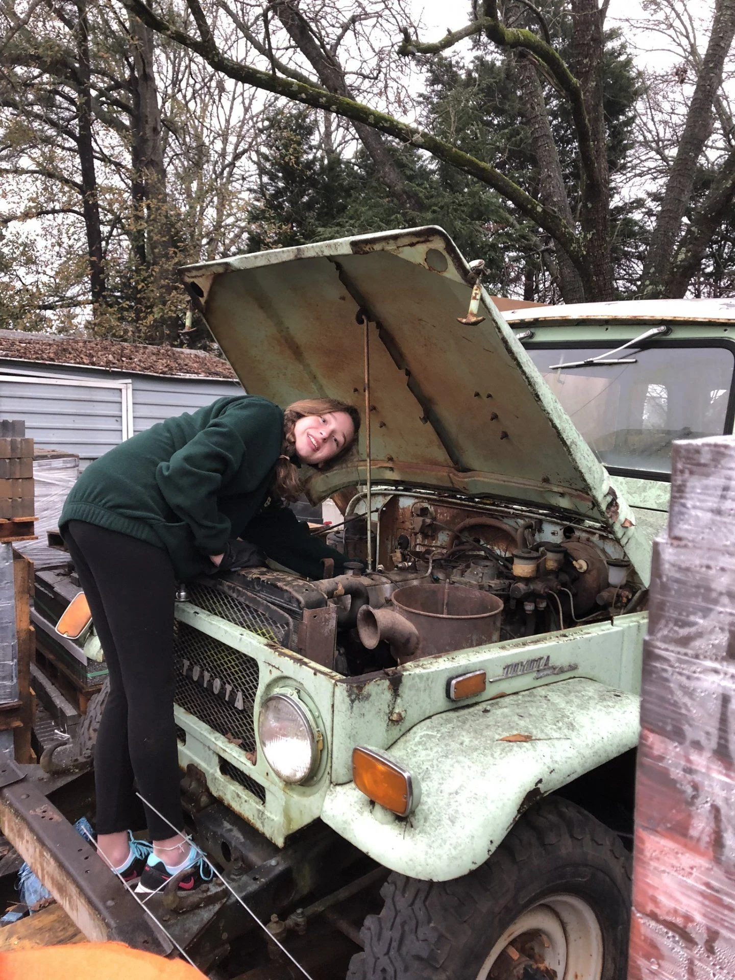

This is a new project for me, but I am not new to Mud. This may be long. My daughter wants to do a father daughter project with the 71 FJ40 I have had sitting since I acquired it in 2006. It actually ran when I got it. I was able to start it and drive it onto the trailer. Unfortunately, I continued the neglect it had received over the years and didn’t pull it indoors like I should have. We pulled the carburetor off some time ago and it has disappeared. The clutch is stuck and when I pressed the clutch pedal something broke and it went to the floor. It is full of rust, but we are not going to deal with that. We want to do a complete mechanical restoration and drive it as a patina rig. So basically all the systems need refreshing. I have never really done a lot of mechanical work, more welding and fabrication. I know we can figure it all out by reading and searching Mud. My question and request for help is how do we decide what to do first? Is there an order for repairs or a place where I can learn how to best get a vehicle back on the road that has been off for a long time. Thanks for the help.

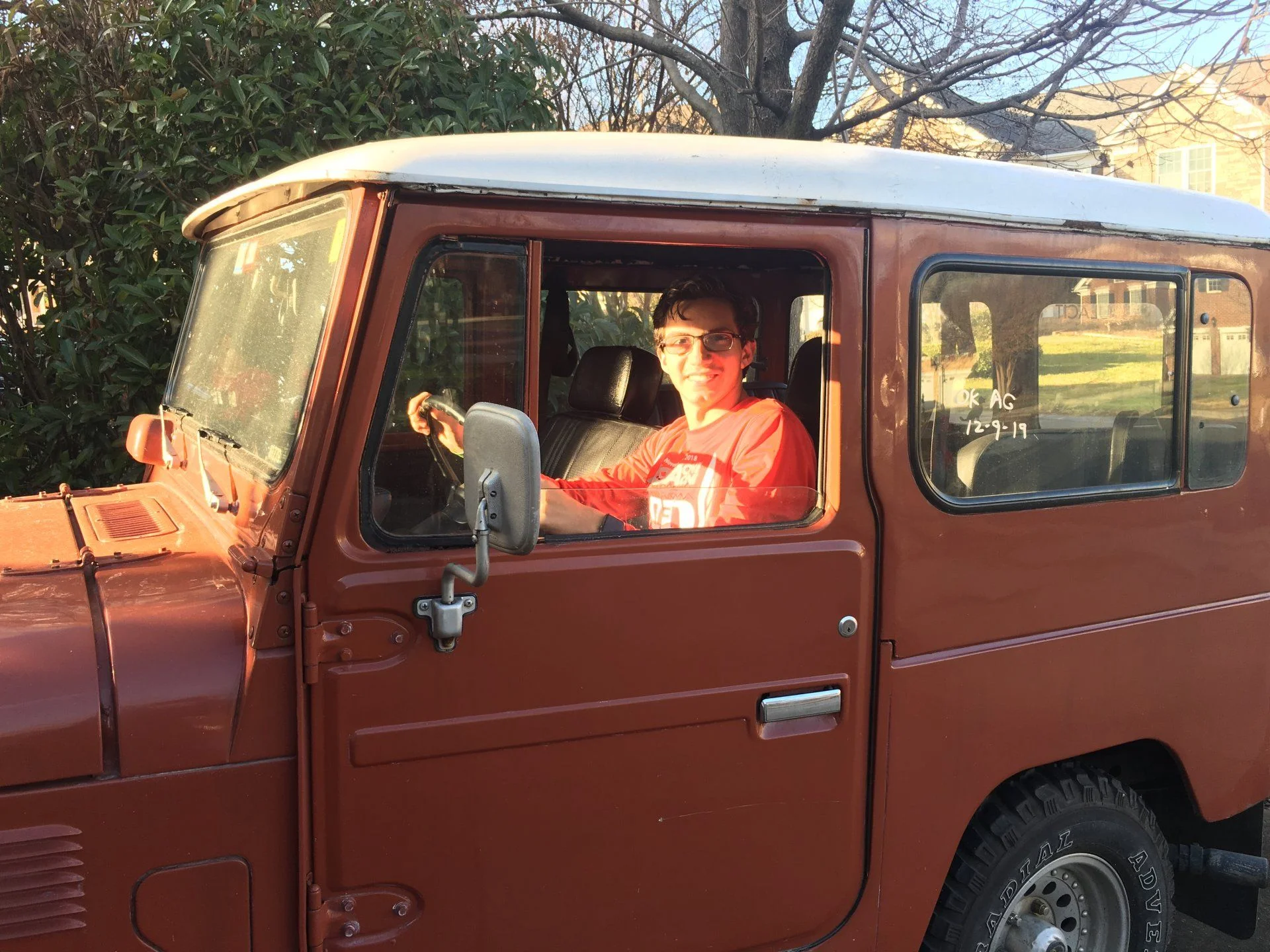

Here is my daughter, Emily, doing something. Funny in this set of pics I see the carburetor so hopefully I can find it. Oh yea, the engine is out of a 78 if than makes a difference. It was rebuilt before it was in SBT the PO.

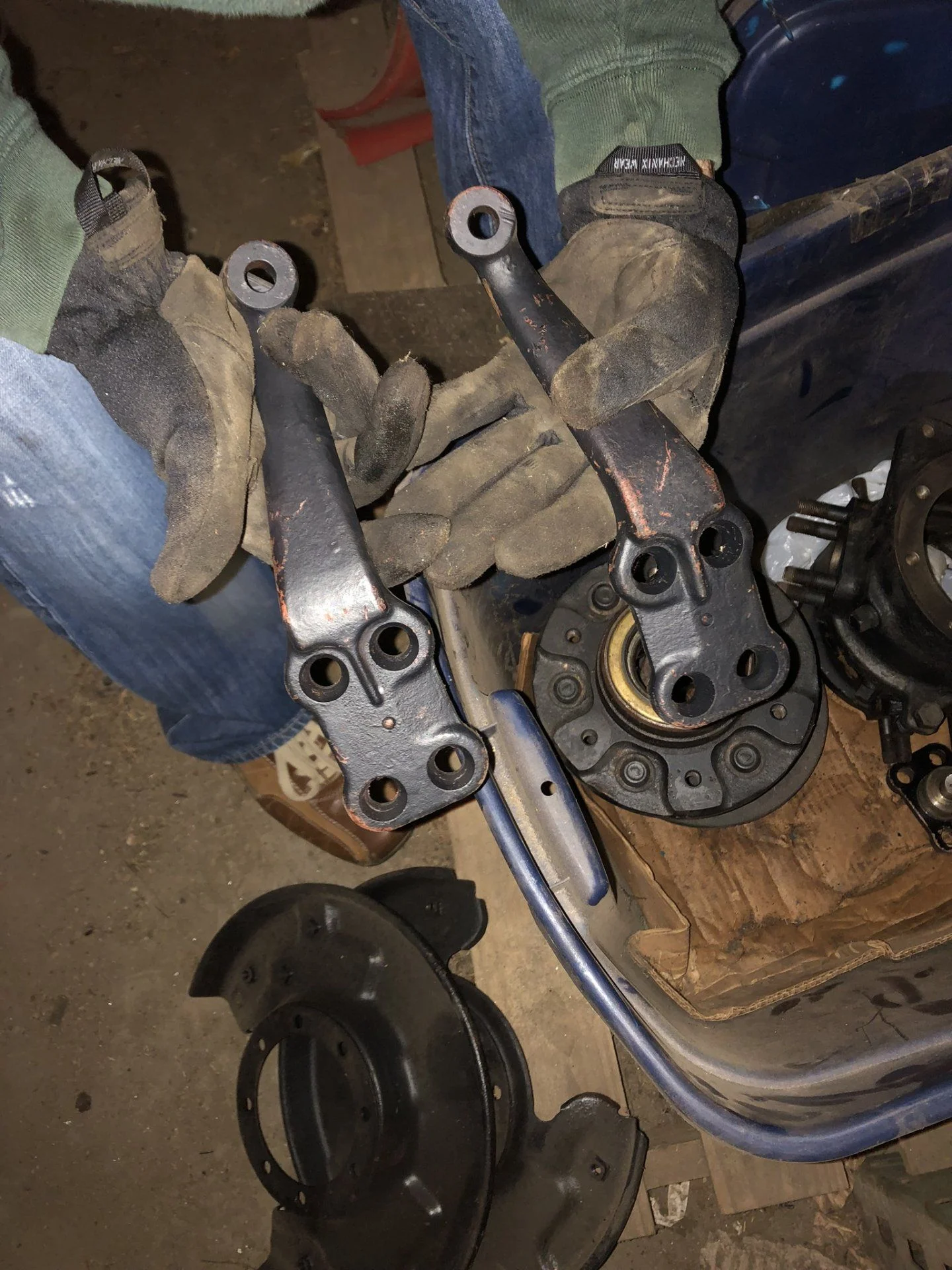

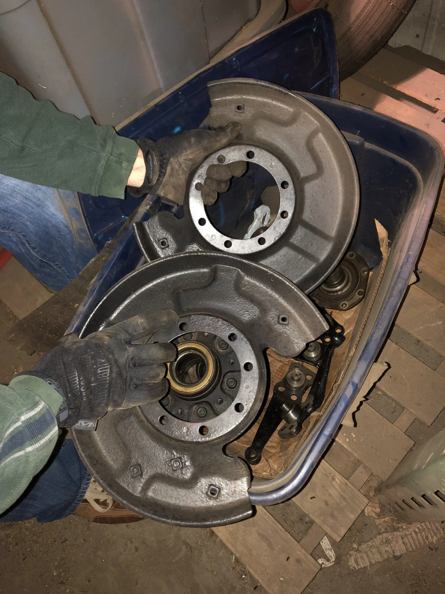

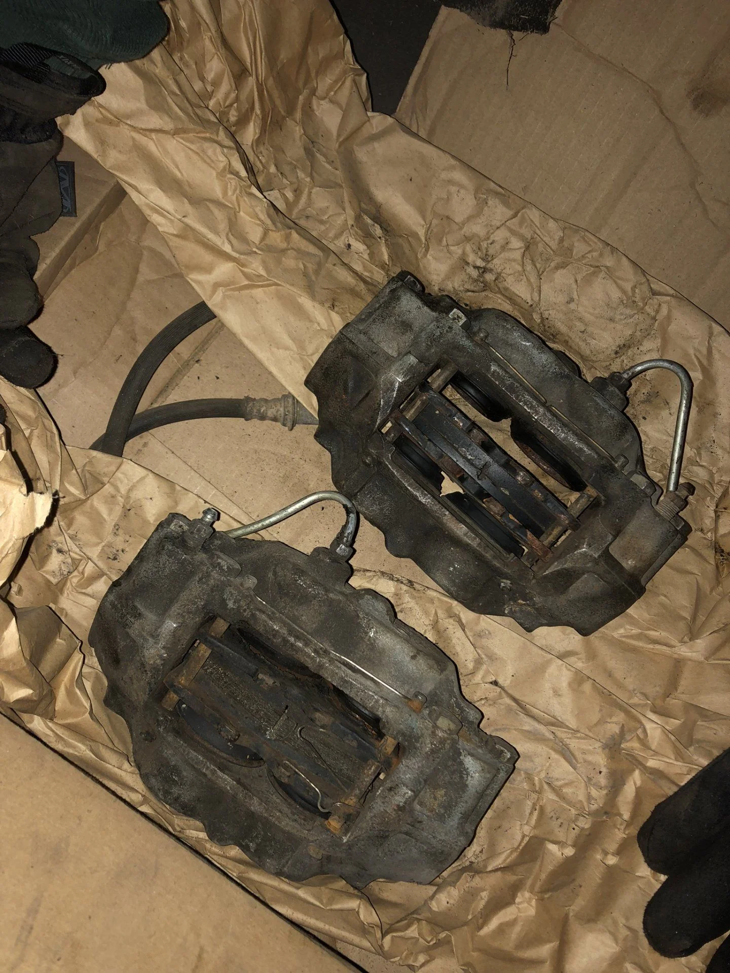

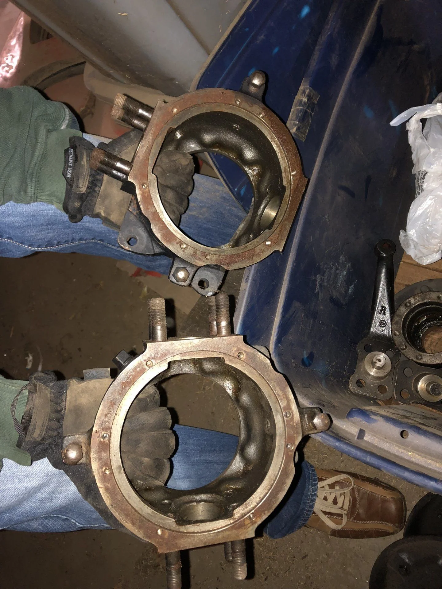

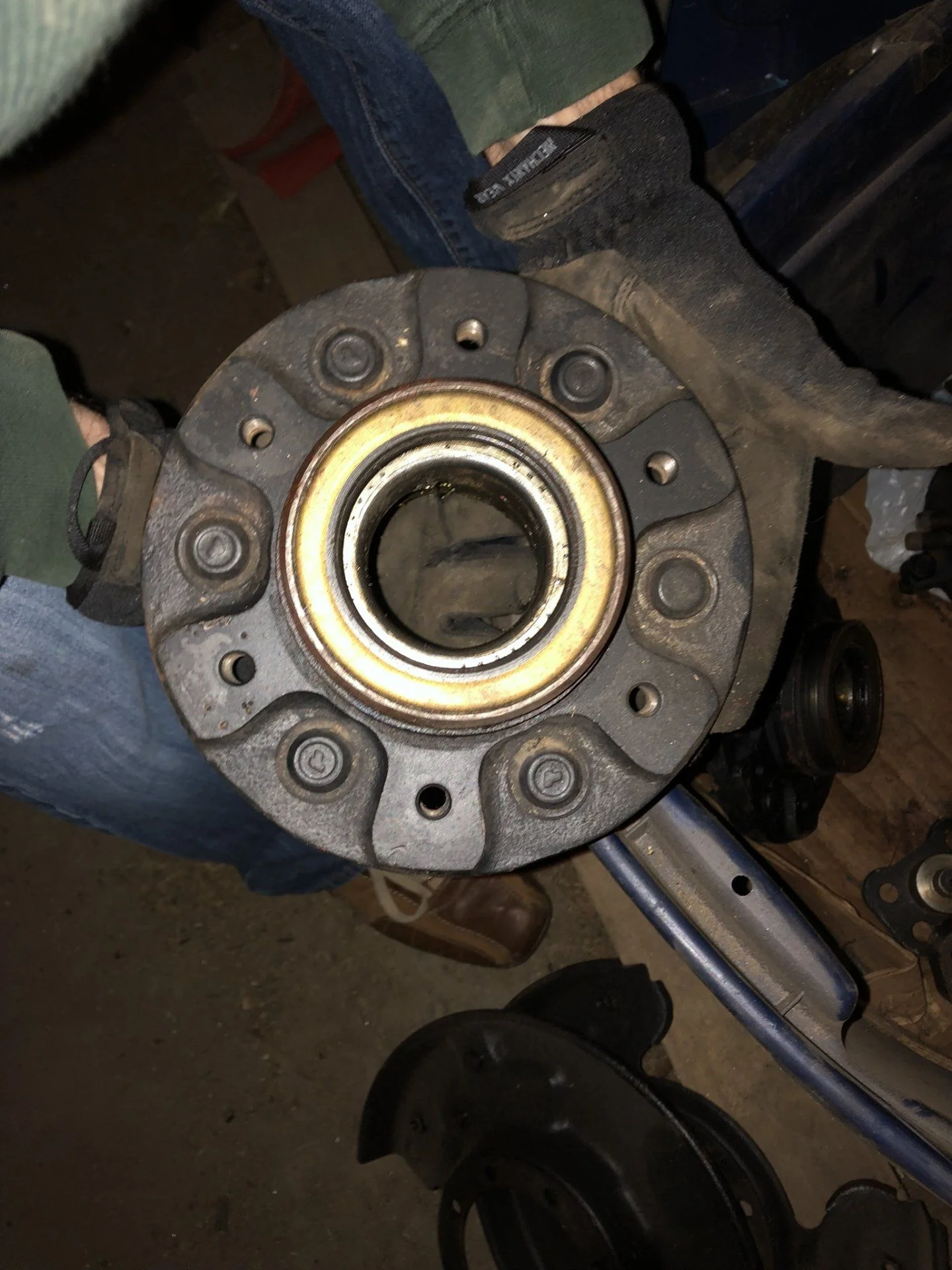

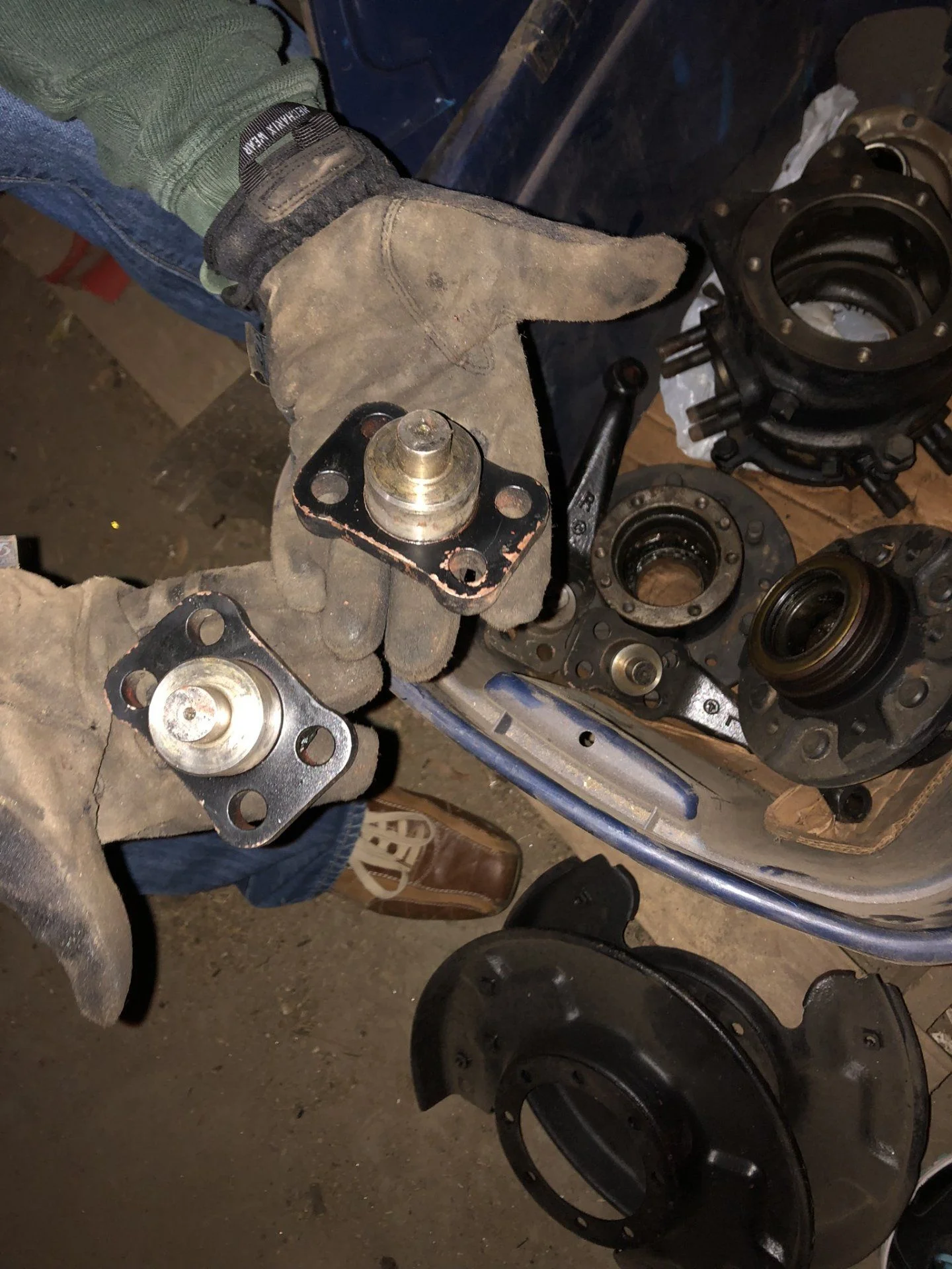

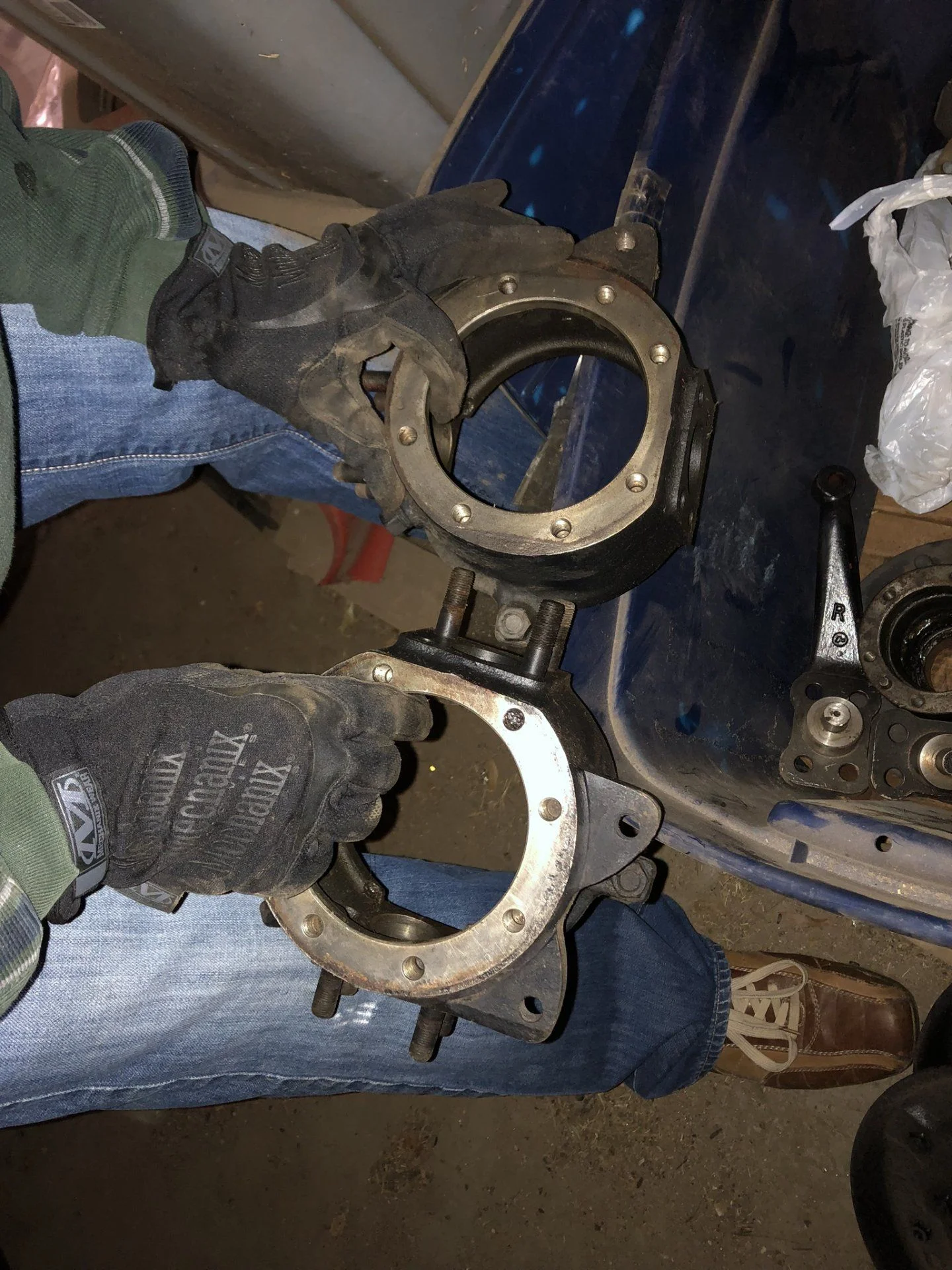

I also would like to upgrade the front drums to disc. I have these parts, which I was told long ago, would work for the conversion. I don’t remember what I was told, too long ago. Maybe it’s easier to source a complete axle?

You’ll want to check your wheels if switching from drum brakes to disc brakes. The riveted wheels will interfere with the disc brake calipers. Either get yourself a set of welded wheels or I believe you can grind down part of the caliper to make it work.

The first thing I did to get the engine running was to change the oil and filter, drain and refill the radiator and cooling system, replace the fuel filter, rebuild the carburetor, clean and drain the fuel tank, blow out the fuel lines from the tank, and replace the plugs/points/condenser/coil. I did a valve adjustment soon afterwards. I haven't checked the front brakes yet because the upgraded axle only had a few thousand miles on it. I have all the parts for another front disc brake axle, so will build that and swap the current one into my '76 FJ40. One option for front disc brakes is simply to swap in an axle from a '76 or later FJ40 as mentioned above.

While not sleeping last night I was going over this exact situation in my mind. I had the idea, couldn’t I weld the seams and then grind down the rivets? Seems like it would work given folks weld wheels to widen them etc. I could also buy 16” from City Racer but that’s just spending money at the beginning of the project that will be needed for other more important items.
