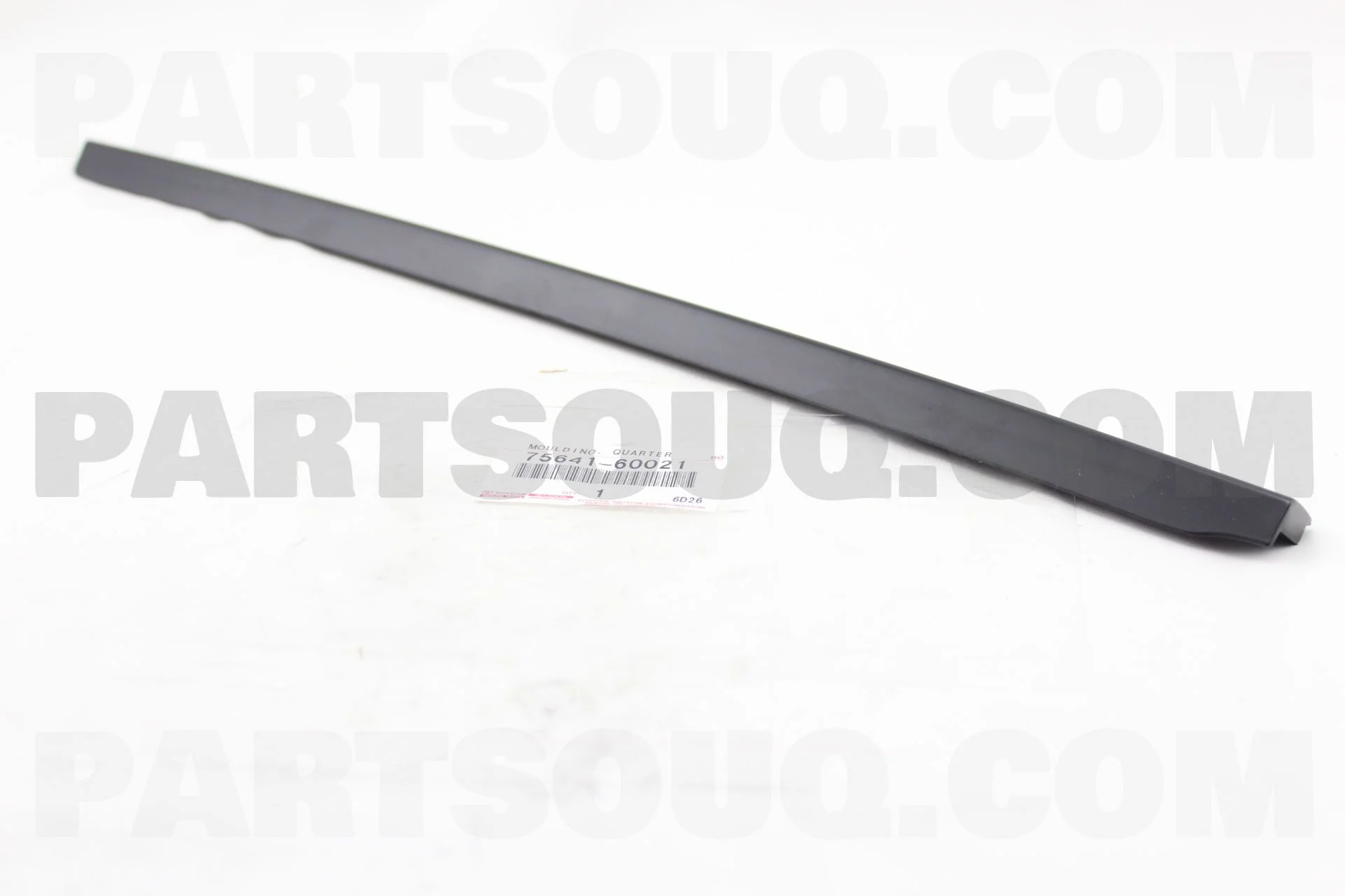

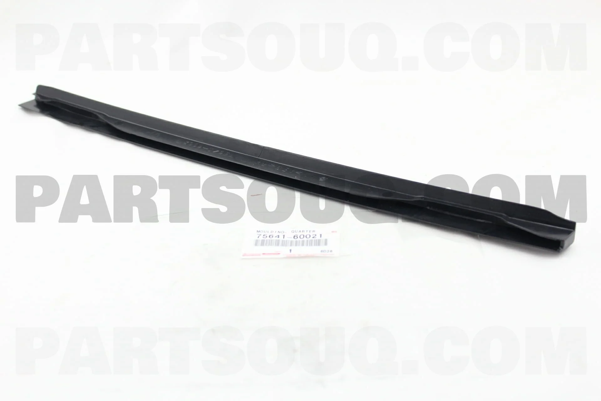

I got hit by a 🦌 and amazingly only that cracked along with an antler scratch to the door. I got the part in hand "7564260021 MOULDING, QUARTER WINDOW, OUTSIDE FRONT LEFT" which just arrived.
It looks like it just slides onto the glass, no holes or clips on the new part. Has anyone attempted replacing this? I gave a little tug on the old piece and it didn't nudge, so I'm guessing there may be some adhesive?

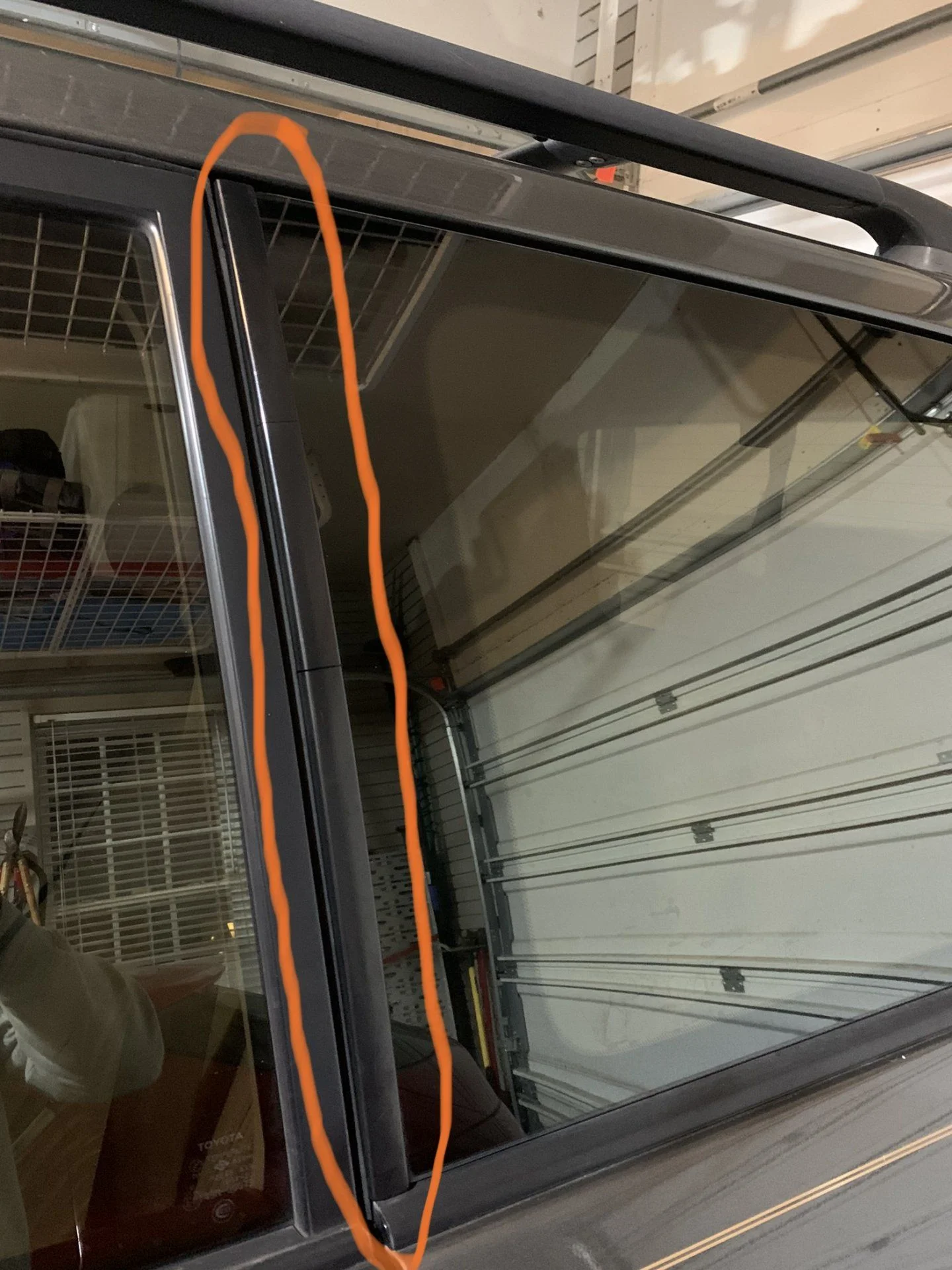

Hey gang, I'm sorry for hijacking this thread but it's the closest I've found to the issue I'm having: I recently discovered that water is leaking into my cab through the passenger side quarter panel glass because the top "hinge" appears to have separated from the glass which doesn't allow it to seal completely. Has any one ran into this issue? Any suggestions on how to fix it? I'm currently in Colombia getting ready to head towards Patagonia so parts availability is slim to say the least, which makes me hopeful that something can be repaired instead of replaced. I looked at the parts diagram but don't see this part listed. I was wondering if it's part of the trim, but this thread makes me think otherwise.

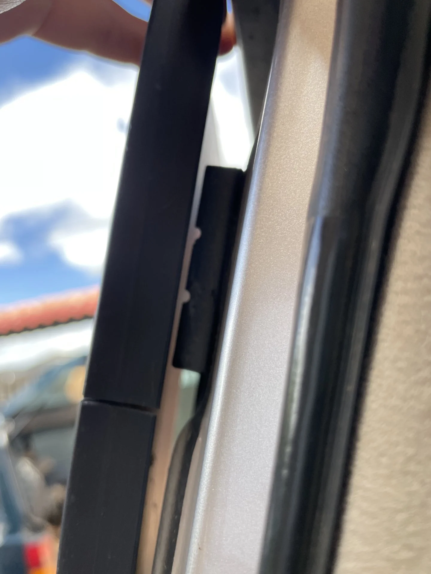

FYI for future members replacing their moldings. I just replaced my molding, part number 7564260021. Like member Smiles mentioned, you do not need to remove the window. The part itself is not secured with anything other than urethane and is strictly aesthetic. You can carefully pry off the existing molding using your non marring tool of choice, and do your best to cut the urethane holding on the cracked molding on. Keep in mind that there are two clips that secure the window to the body, don't pry on these clips. You'll recognize them once you remove the molding. That is the hardest part. Clean up the old urethane off the glass with a nice sharp blade and some alcohol. Use a thin bead of 3M Windo-Weld 08609, $16 at the local Blains Farm and Fleet, on the new molding to secure it into place. You can use the existing molding to see where to apply the urethane on the new molding. Its an easy job, removing the windows overcomplicates this process and may keep future members from replacing ugly cracked moldings.

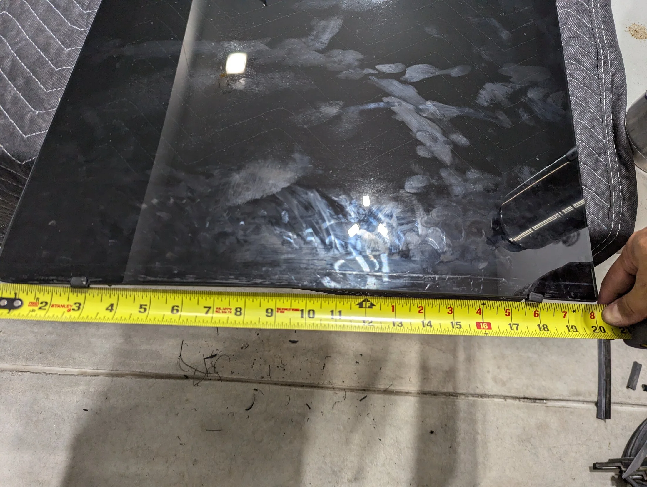

First, look out for the tabs. Here are a few measurements. Otherwise, use force to pry the trim pieces away - don't be afraid. Even though you can bend them back in pace, try to minimize any damage to them. The first window took me longer because I was trying to be careful, but once I knew where the tabs were, the other one took less than a minute to pry open.

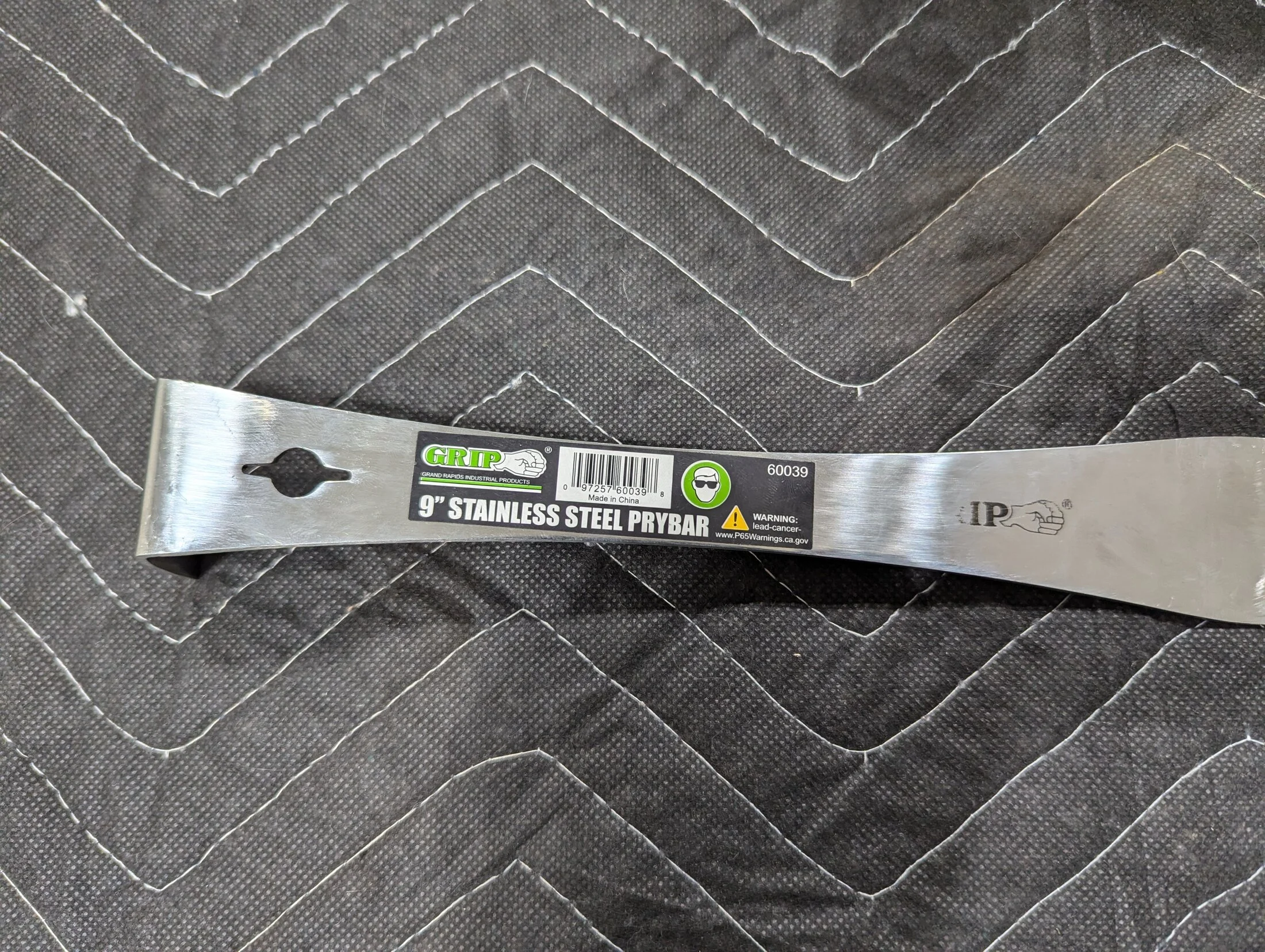

The best recommendation and tool to use is this thing that I had laying around in the garage:
The prybar was edged like a knife, making the job much easier.
