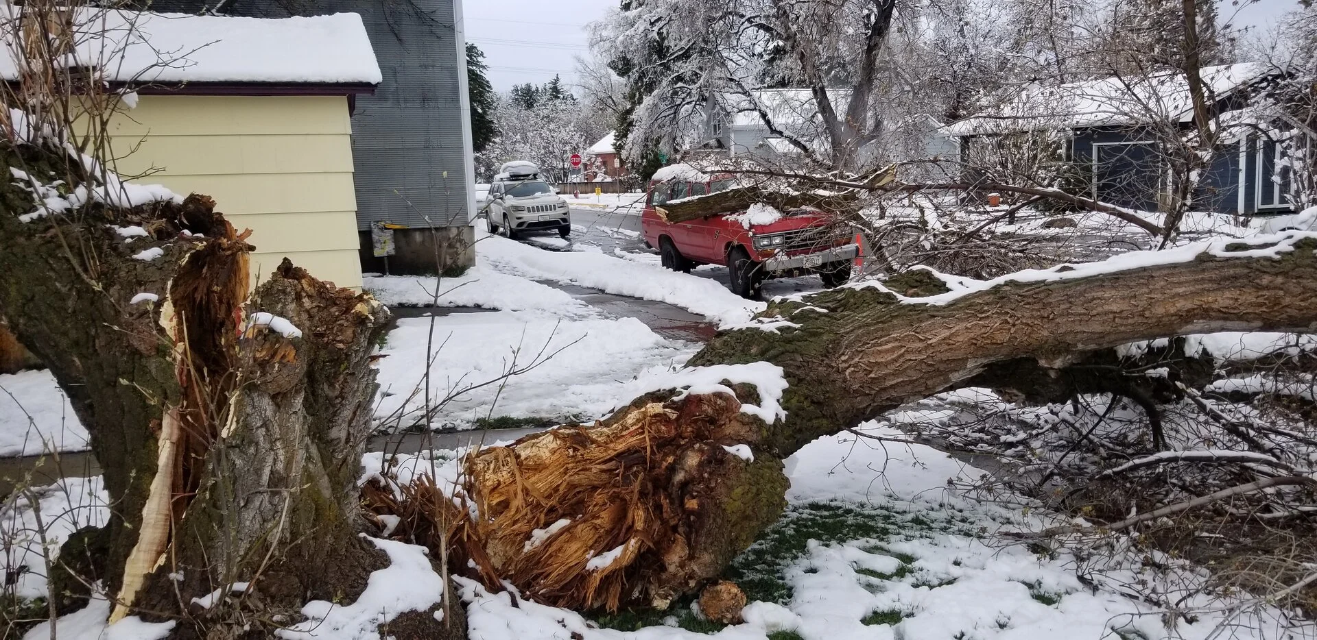

Yo! My landcruiser got crushed last May during a heavy snow storm that split a large box elder tree in half. I wasn't there when it happened. Half of the tree landed on my house w
thumbnail
here my daughter was sleeping. Luckily she was completely uninjured and didnt even wake up. The house was hardly even damaged. Half the tree crushed the A Pillar and fenders and hood on the driverside of my 1989 fj62. Has anybody replaced this A pillar before? I plan on documenting what I do. I do steel fab, but not bodywork, so I have tools but could use some support. Thanks guys! Carlos

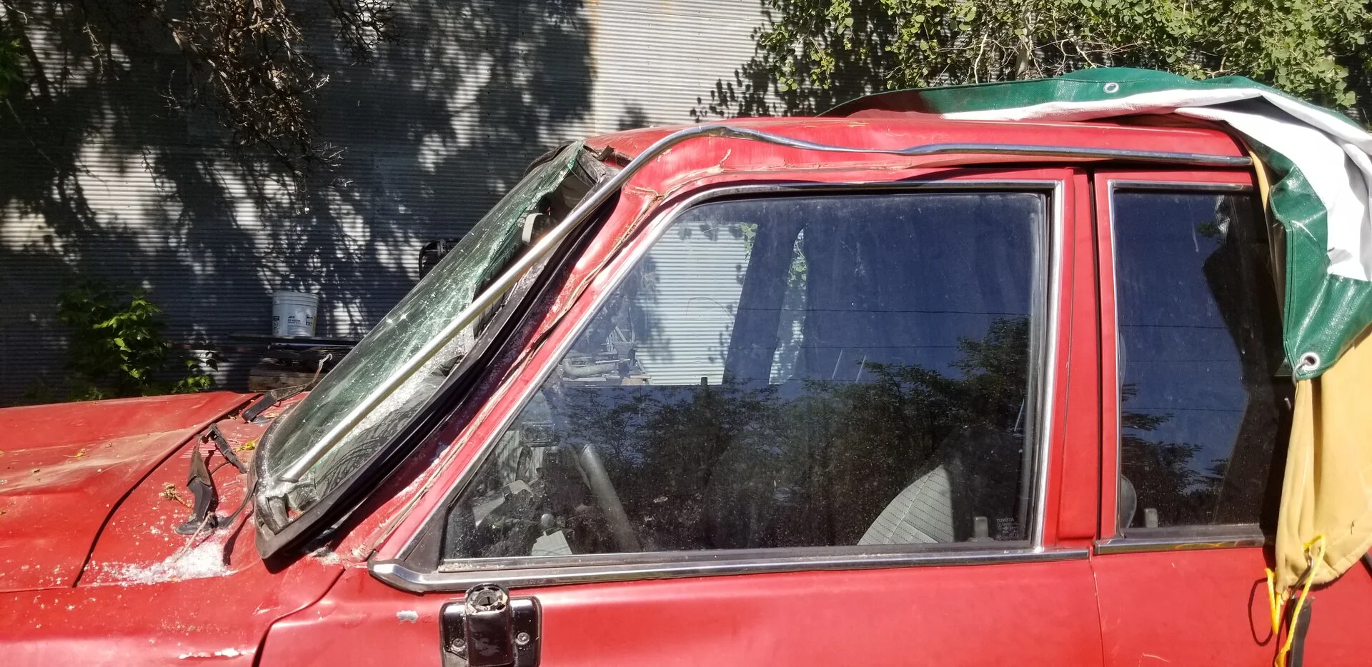

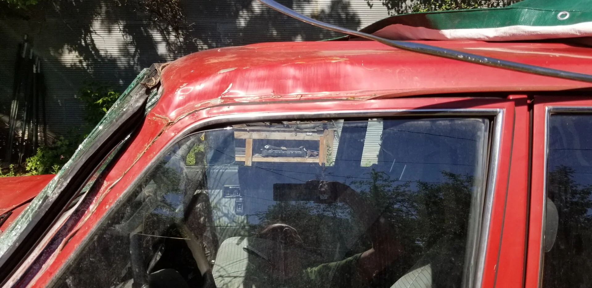

I attached a couple more photos. I have not cut into it yet of the holidays but as you can see the roof above the door is damaged. The A pillar is pushed in probably 3/4". The door also took a hit and has some deformation. I think I need to find someone with a doner vehicle. Then I can cut out the damaged roof, A pillar and part of the door frame and give it to them so they can oversize it and cut it out of the doner. Then fix the door and fenders etc...
