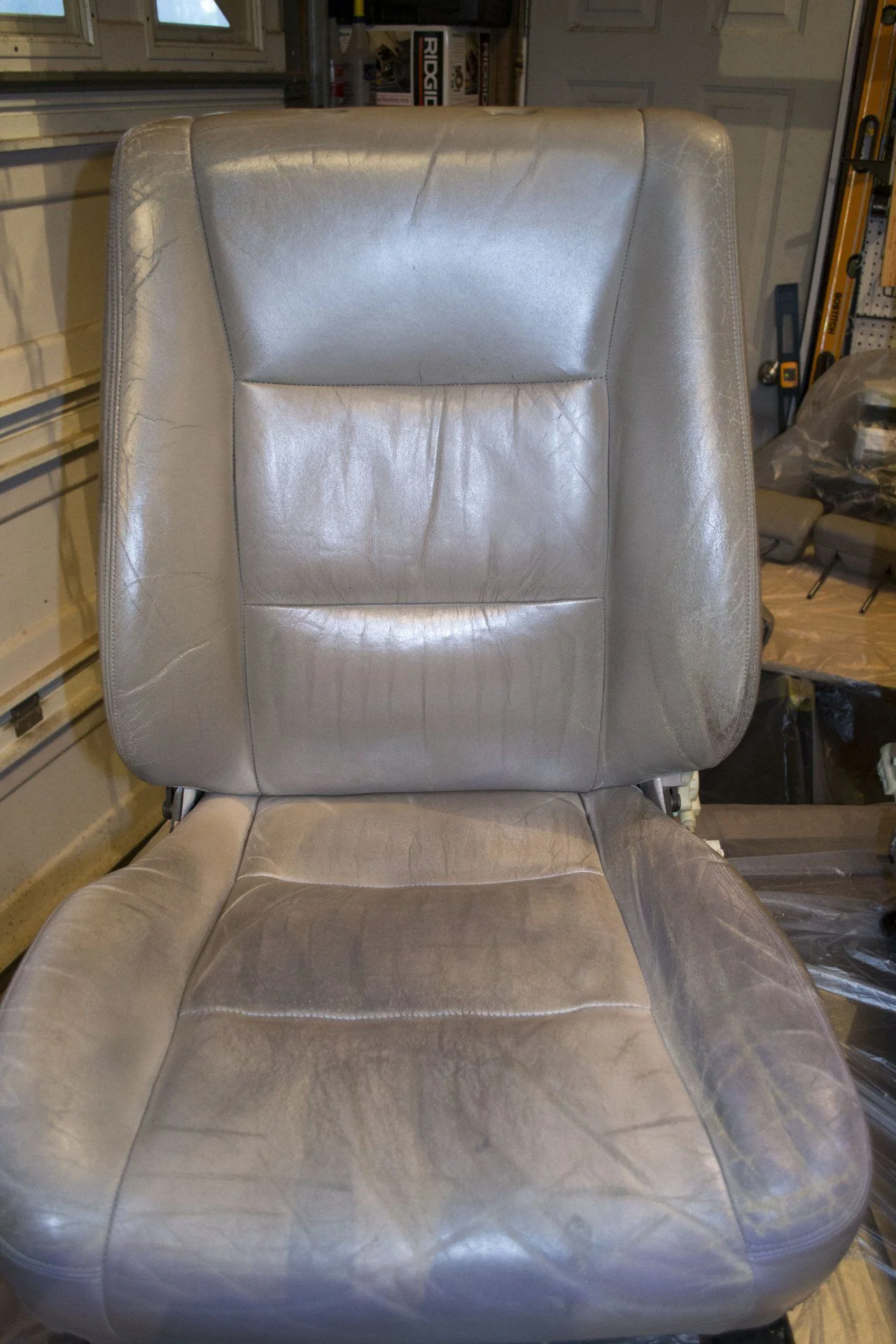

For the backstory, I did a write-up on restoring the leather in my truck using Leatherique‘s products. It turned out great and held up for a while, but now it’s got a couple gashes and is starting look bad again in the high-traffic spots. If the OE leather was thicker, it would have worked better.
Did leatherique rejuvenate those seats like that?
Leatherique and many hours. It’s labor intensive. I should have also pulled the covers, replaced the DS foam and reinforced some of the worn leather by gluing leather patches on the backside. It would have held up better that way, but if you’re going to all that trouble then new leather is probably the way to go.
