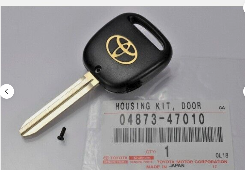

His post says he tried partssouq. I tried a variety of google searches - JDM Toyota single button key, found a few different styles.
Unfortunately that’s all I’ve found as well, the key blade is the wrong style.
