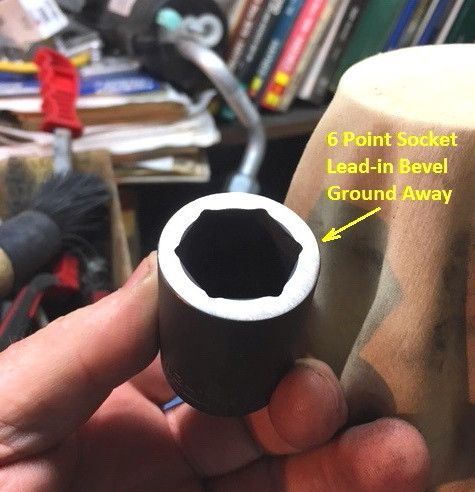

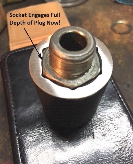

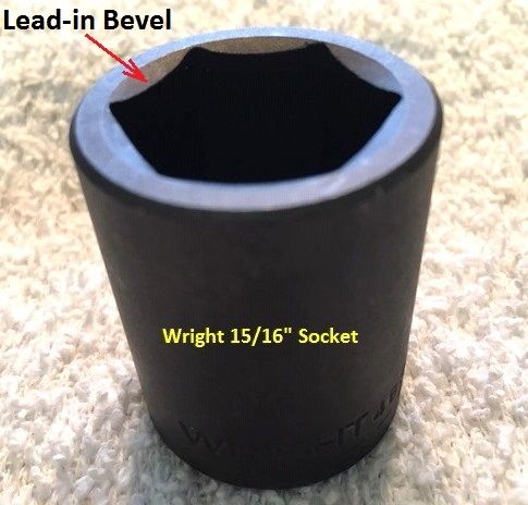

I used the side of a grinding wheel on my bench grinder to do that to a socket I use for removing the fill plugs on the Tcase and Diffs on my 80 series. The heads on them are very shallow and you don't make full contact because of the bevel (lead-in). So the same thing could be done to make a flat surface on a socket for a press tool. Just be sure to grind it (using whatever) 'square' so you have full contact on the lip of the bushing.
Do you have one of the new tech grinding stones on your bench grinder. Which are designed for all side use, and handle harden steel?
It has been my understanding, to never use sides of grinding stone. Doing so can cause stone to crack. With the high RPM speed of most bench girders. A cracked grinding stone can become a grenade, sending chucks in all direction. Or am I wrong?
Shop safety as you said, is important!

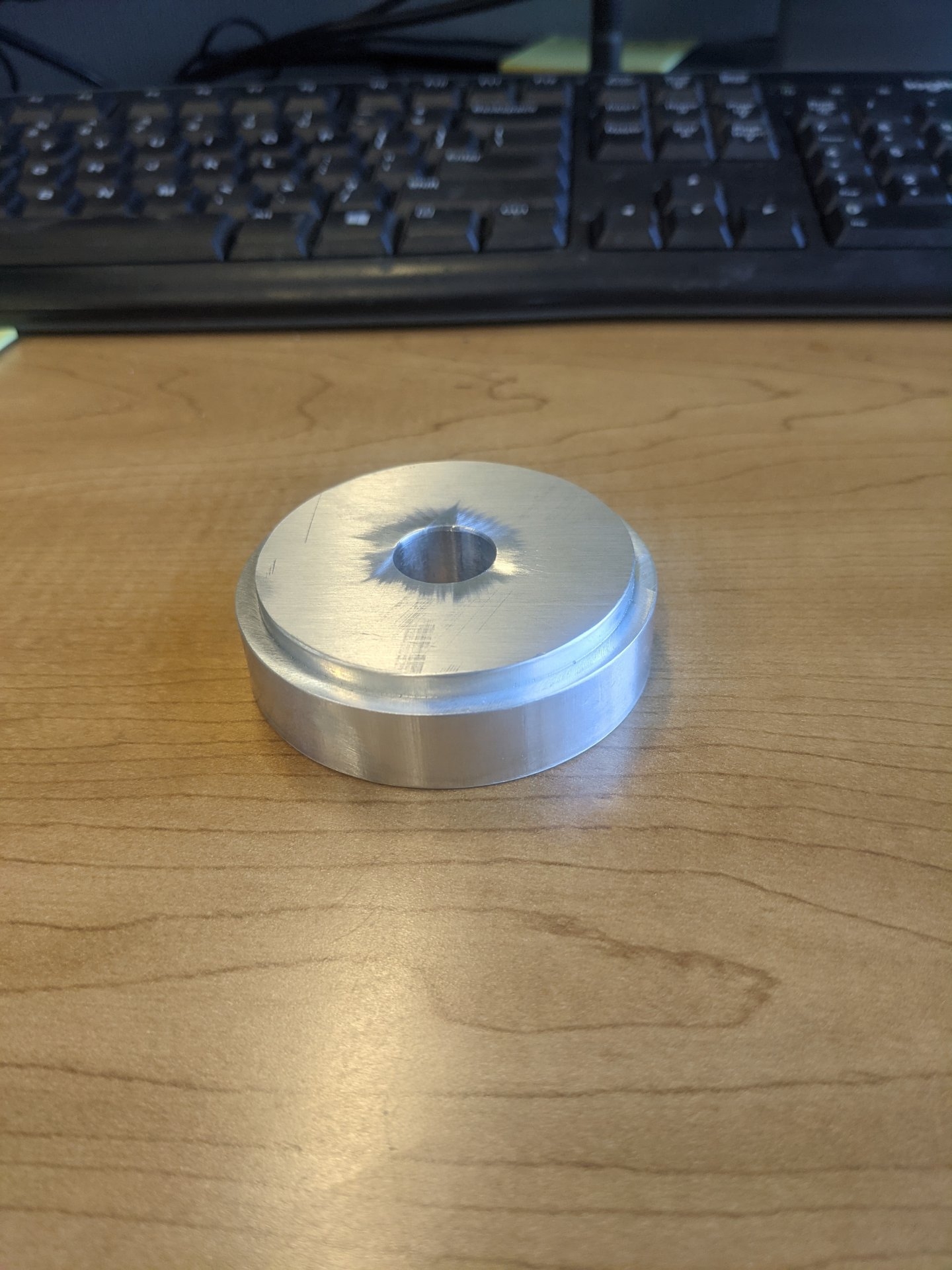

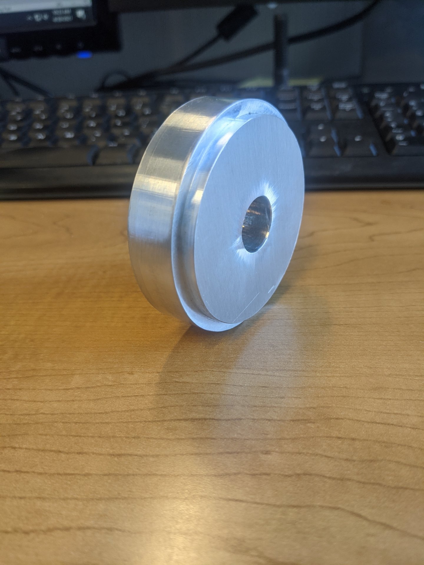

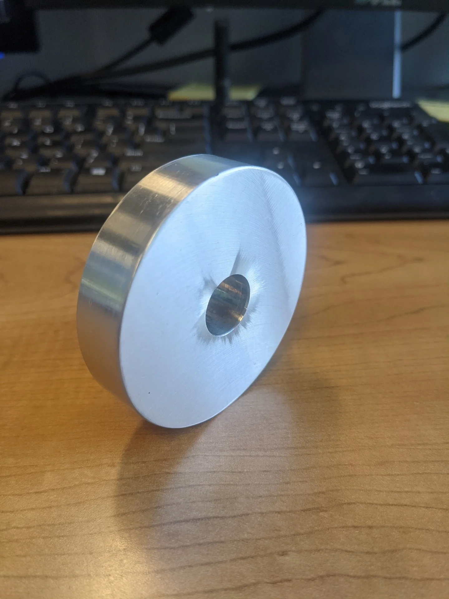

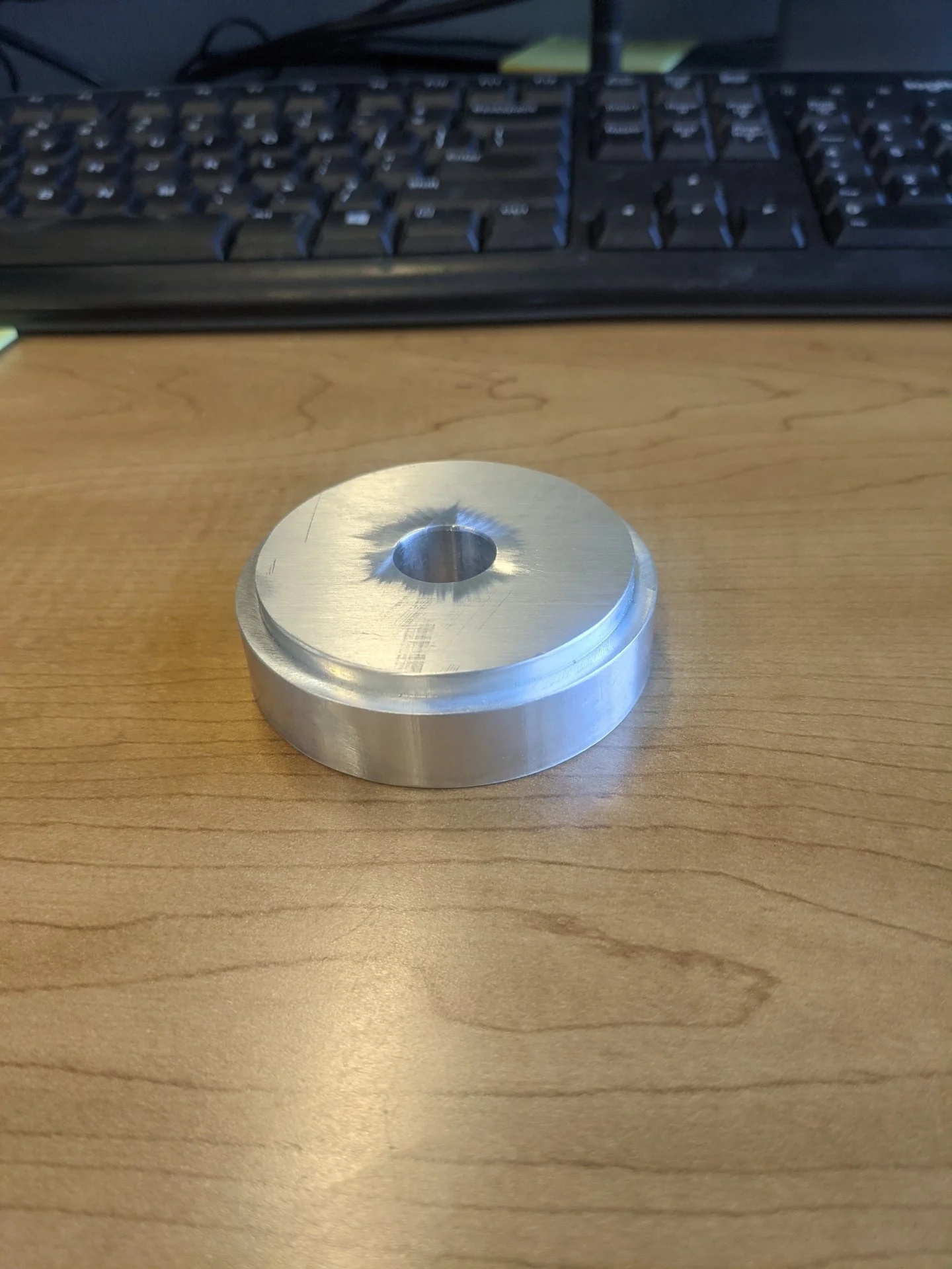

One issue you may have with this slug tool, is alignment. As you start pressing, you'll first build pressure at center core bushing on tool as it lacks opening/hole to compensate for protrusion of core of bushing. If not lined up perfect, as it come up to outer cup of bushing, it may take some tapping on side of slug with a steel hammer to align. Or you could cut out core removing, and start press slug dead on bushing.
You'll also need and extra ~1 or 2" in receive cup, as core will press out further in receiver cup.
I plan on cutting the center core out first! And I have a large cup in the form of a large socket. I hope I can meet up with this guy today. Haven’t heard from him in a few days....

Still.....as stated, it is generally not good practice to apply axial pressure to a grinding wheel, for safety reasons. That is what I DID with my equipment. I also sharpen chisels, scrapers, etc....along side the wheel I have. AGAIN....not recommending this!
But yes, using light pressure.... I ground down the lip of a socket (for another project than this) on the wheel of my bench grinder. NOT a 'how to' or suggestion for others. So everyone....use your best judgement.

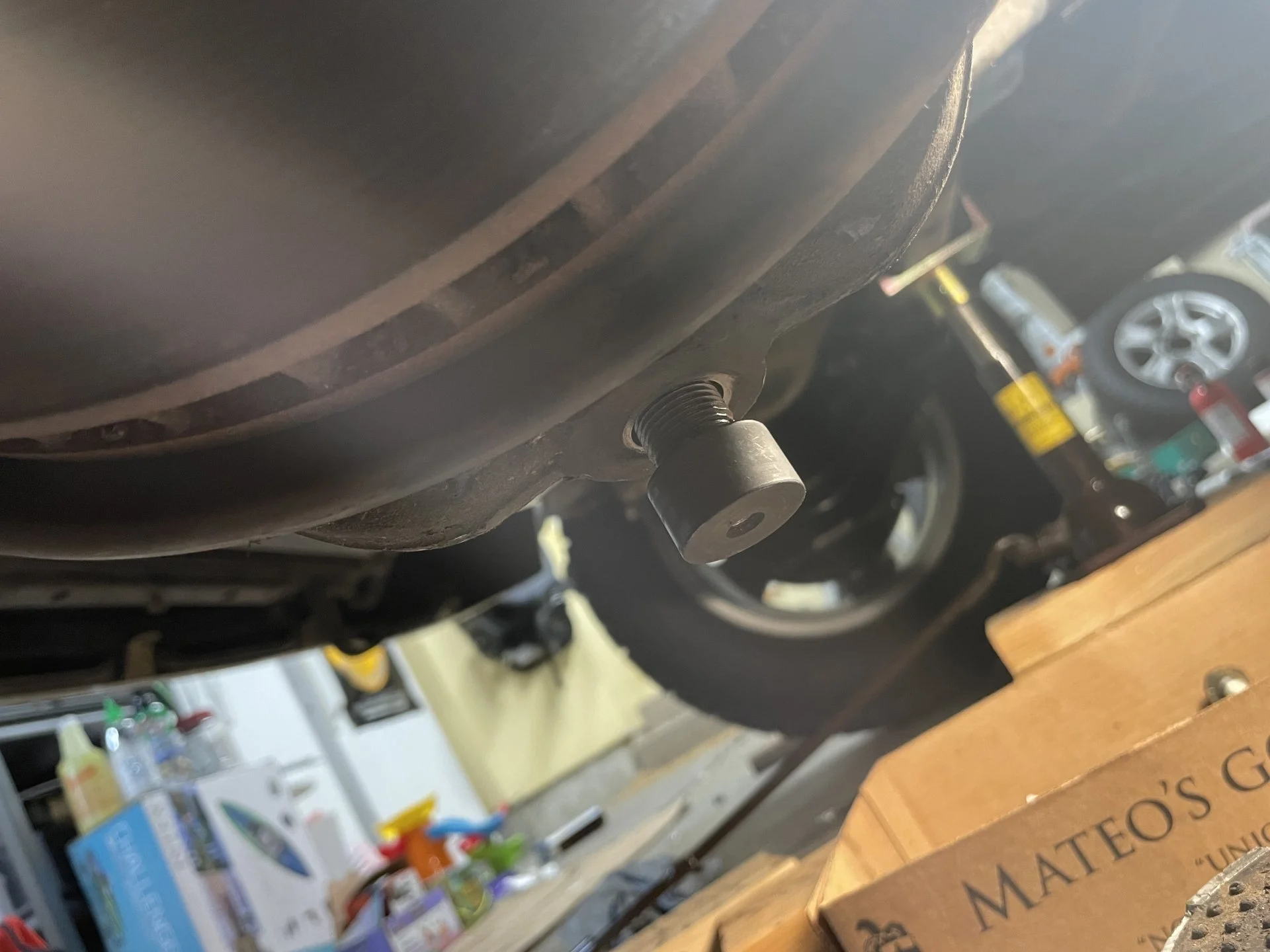

Update: I got the new lower control arm on the passenger side installed and now I’m doing the driver side. All the control arm bolts came loose super easy with the breaker bar.

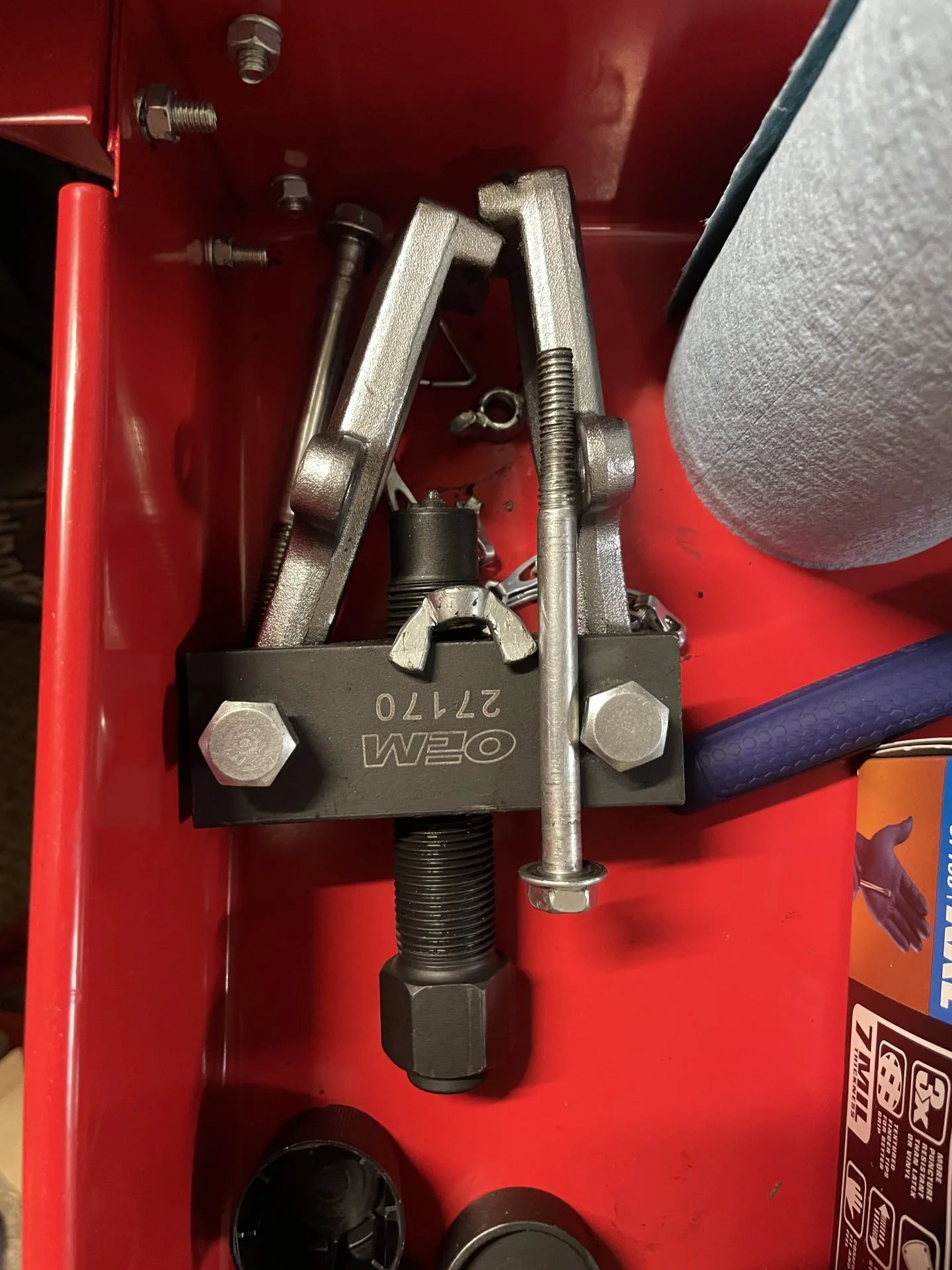

The issue now is that I rented this puller tool to get the ball joint out and it worked in that the ball joint is now loose. But it comes with this centering piece and it’s stuck hard to the bolt!! I’ve tried a pry bar, hammer and brass drift and it’s not budging. Any thoughts on how I might get this thing off? I can just saw through the bolt but then I still need to get that little piece off so I can return the tool. Maybe a torch and a pry bar??
Clamp Vice grips onto the piece and then hit the Vice grips with a hammer. Might be able to get more striking area in the direction you want like this.
Pickle Fork and heat. Heat the centering cap and then force the pickle fork between it and the steering knuckle. Pickle forks are inexpensive and you should have one anyway. Ball joint is loose now....so you can just rap the end of it once the centering cap is removed.
