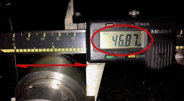

Looking at the bushing Press Tool I turned down....I came up with the following diameter.
So....anything close to this that has a FLAT end should work well enough to contact the shell of the bushing (discounting minor tolerance issues with the bore in the frame).

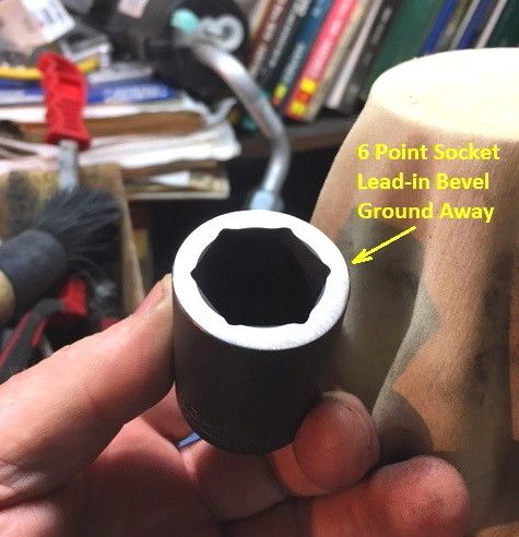

Any suggestions for getting the bottom end of a socket flat? Could you use a grinding wheel on a Dremel maybe?
I used the side of a grinding wheel on my bench grinder to do that to a socket I use for removing the fill plugs on the Tcase and Diffs on my 80 series. The heads on them are very shallow and you don't make full contact because of the bevel (lead-in). So the same thing could be done to make a flat surface on a socket for a press tool. Just be sure to grind it (using whatever) 'square' so you have full contact on the lip of the bushing.

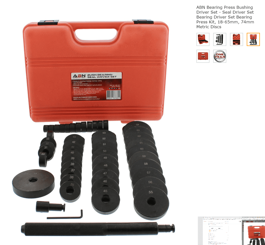

I wonder if this kit would work if you drilled out the center part of the bushing? It's got a 46mm plate which looks like it would work. The only question I have is the center hole size for the plates. It looks like it's only 1/2 inch.
Coincidentally, I ordered a similar kit just two days a ago. I'll measure the 46 & 47mm discs to see how accurate they are when it arrives.
Amazon product ASIN B076HRSYSP
I bought it for a different purpose....but the thought crossed my mind as well that it 'might' be able to be used to remove the #2 bushing. As you say...the center would need to be drilled out first.
I guessing the bore in the frame is meant to measure about 47mm. So the 46mm disc should fit easily in the bore (being roughly .050" smaller). How fully it would contact the shell of the bushing....I can't say since I don't have a new one to measure.

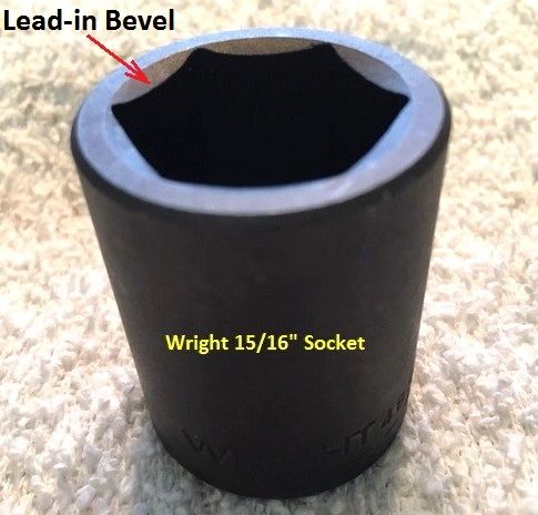

@2001LC has it figured out. The ledge/lip machined into this socket is the ticket to keeping it centered and immovable to the bushing. Thinking of options to get the cost of making the tool reasonable (on a repeatable scale), I think if its possible to machine and step down pieces of 2" DOM tube on a lathe you might be able to make this for a reasonable cost if you can make 20 -25pcs at once.

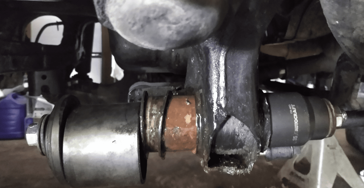

When you see this, you will be filled with joy. An ACME thread shown above would have made it easier.

So that Autocraft socket fit the bore? Interesting. I measured all the impact sockets at harbor freight, autozone etc and they were all too big.
I see I can order one on Amazon or through wal-mart but they both come from a place called Tool Liquidators. Crazy thing is the business address on Amazon is in Tacoma, WA like 20 minutes from me. I might swing by and see if they have it in stock. I’ll need to get some longer threaded rod but that Acme thread looks like just the ticket.
I see I can order one on Amazon or through wal-mart but they both come from a place called Tool Liquidators. Crazy thing is the business address on Amazon is that in Tacoma, WA like 20 minutes from me. I might swing by and see if they have it in stock. I’ll need to get some longer threaded rod but that Acme thread looks like just the ticket.
Surprisingly the sockets I used during the operation I already had from replacing Nissan FWD CV axle nuts. So I didn't need to buy anything. I borrowed a press kit from Advance to get a receiver cup. Not that I'm a great lover of Advance tools, but they are close and open on weekends when I get in a jam and discover I need a tool.
Once I pressed the bushing out, the socket was so tight inside the tube that I had to do a reverse press to push it out. I had to use another smaller socket to push out the 35mm with a big piece of pipe that I use as a cheater for the reverse receiver. I'm sure there are more precise fitting tools available.
I just went with what I already have in the toolbox, grimaced and got the job done.
It could have been easier if I had used a torch to heat up the frame mount. I did use an electric heat gun to expand the tube. I have a touch, but with the oil that was leaking at the time I did the refresh, I was afraid I would set the oil on fire. Ha!

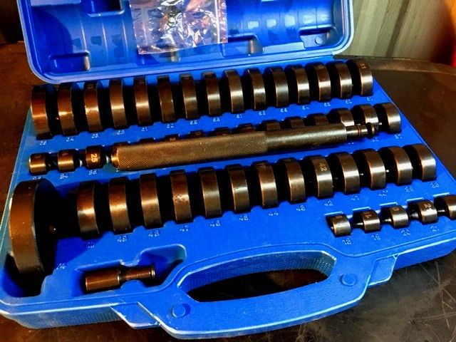

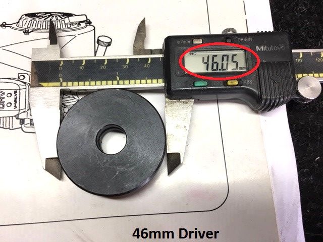

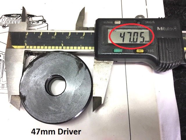

Mine showed up today. Good news and bad news.
Good news is the set is of pretty decent quality (better than I expected). I measured several of the drivers and they are pretty darn close. Just a bit oversize but consistently so.
The Bad news (for anyone wanting to use these as a 'press tool' is that the I.D. is not 5/8", nor is it 1/2". Mine are just a hair under 1/2". It could certainly be drilled out slightly and a hardened 1/2" ACME threaded rod used, but it wouldn't fit the driver handle for use as a seal/bearing/bushing tool very well after that.
Not an issue for me...since I didn't buy it for that purpose, but passing this on for sake of posterity.

I read that as well about the one I bought. 12mm is the hole size on these. I might drill it out but I’m also talking to a guy local to me that does this kind of thing about producing something to do exactly this. Not sure if there is market for it but if a tool was available specifically for this purpose I would have bought it by now.

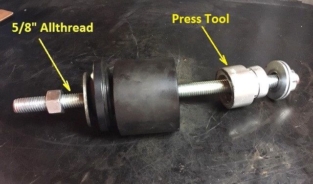

I turned down an aluminum adapter I had sitting around to use for my press tool and it worked fine. Suffered only a slight amount of scarring where it contacted the lip of the bushing shell, but barely noticeable. However, my bushings were not 'welded' to their bores with rust as some are bound to be.
